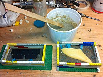

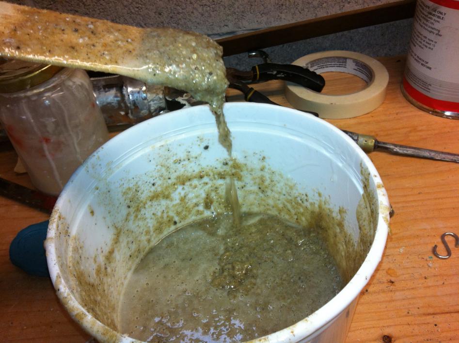

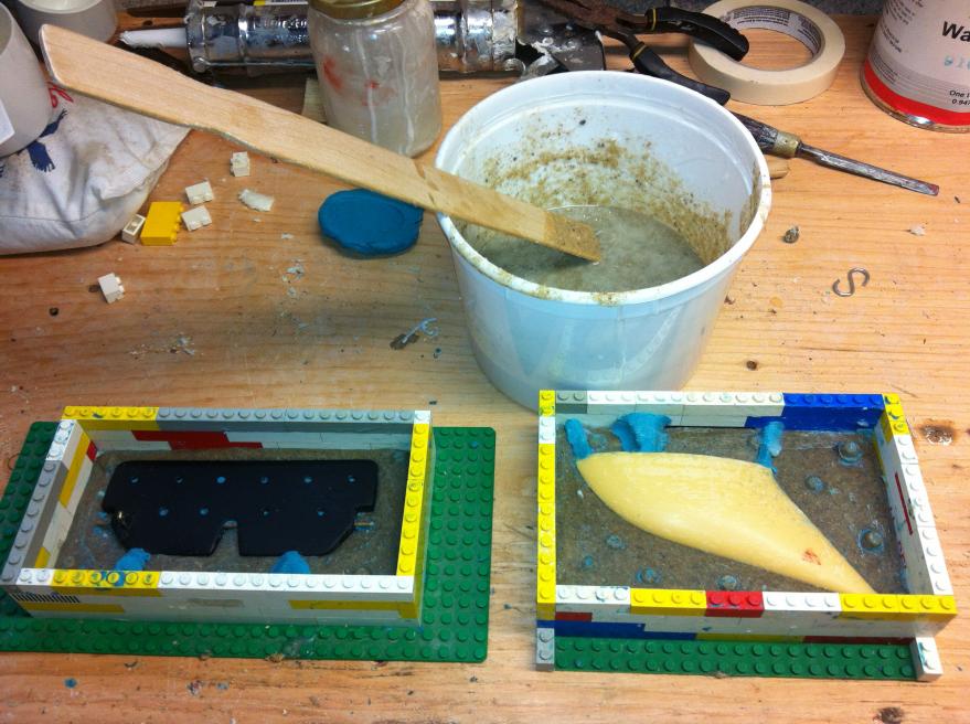

                      I'm making the other half of the molds here. Firstly, I'm mixing very dry and sharp sand into the epoxy resin to make a resin rich sloppy mortar. I've never had a bubble or defect doing this and I think these are the reasons why.
                      1. The sand acts to cut through the resin as its mixed and it helps the air pockets, bubbles work free.
                      2. The sand particles are each dimensionally stable. As they touch each other, they make the resin dimensionally stable too. Zero shrinkage on cure. Imagine a bucket full of marbles. Each marble resting against another in every direction. Then pour resin in, all the resin does is glue each marble together and fill the gaps - simple.
                      3.The sand makes the mold harder and more resistant to wear. It is also less likely to warp or distort.

                      Here you can see the sloppy mix I use. You could also use polyester resin. I doubt mortar made this way would shrink using a sand filler.

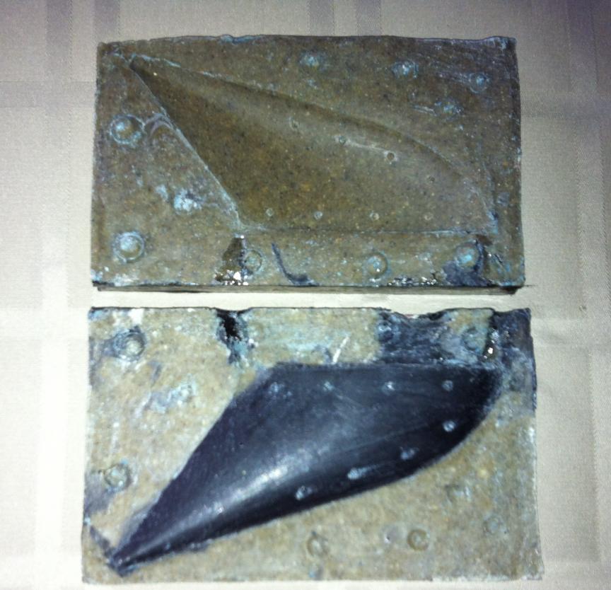

                      Here are the 2 molds, surfaces duly waxed up and ready to go.

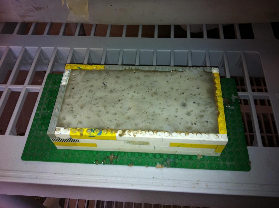

                      The finished pour.
                      After pouring, I shake and rattle the mold on the work bench to help remove any bubbles. Notice them on the surface of the mold.

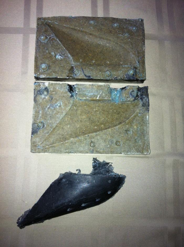

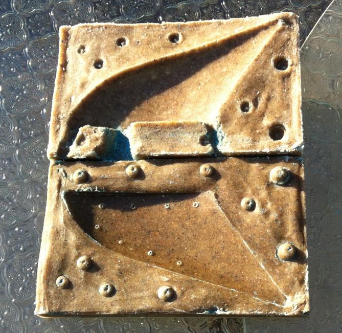

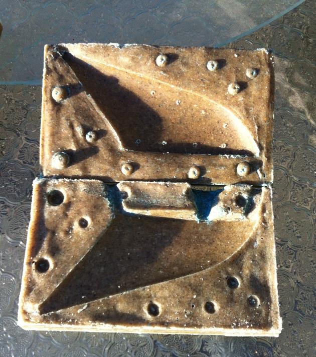

                        And now! The moment of truth as I prize apart the molds and remove the plugs!
                        Ta! DAAAA!
                        Here is the dive plane. I placed clay cones in the lower section before pouring the resin, to give me vents and pouring holes. Before I make the actual product, I have to cut a length of 3/32" rod and some 3/32" id brass tube. This will be slotted across the plane to encapsulate the tube. If you look at the upper mold, then lower left, you'll see a small slot. This will house the brass control arm with the brass tube running through it.

                        Here's the horizontal stabilizers - chicken legs - or dive plane thingies. Note that I marked the holes and partially pre-drilled them.
                        Yes! That was a good mornings work! I've earned a beer!
                          My first pour of resin into the new molds came off pretty well. I mixed up some phenol novolac epoxy and added some black dye, and then added a little chopped strand glass. It didn't work out quite like I thought it would as the resin gelled up a little and didn't pour well. However, all was well and the thicker material glugged its way into the mold and saved the day.
                          The spew needs to be cleaned off, but the casting is -- G O O D !
                          NEXT!

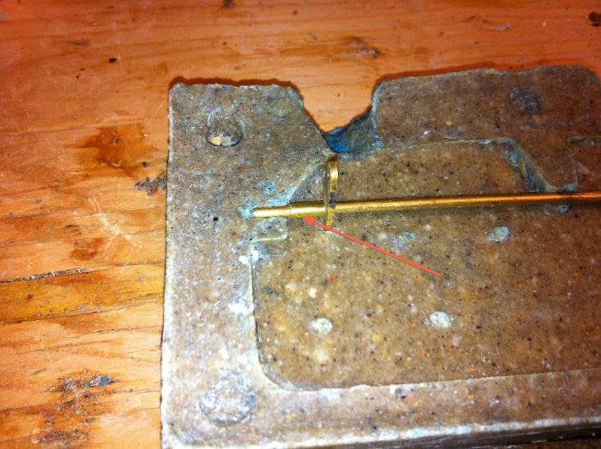

                          I set the brass-work into the mold, the control arm fits tightly into its slot, and the dummy shft is well greased up with release agent.
                          Note the bushings at either end of the shaft. They are not waxed, as they need to be bonded into the dive plane. The bushings are simply short pieces of brass tube.
