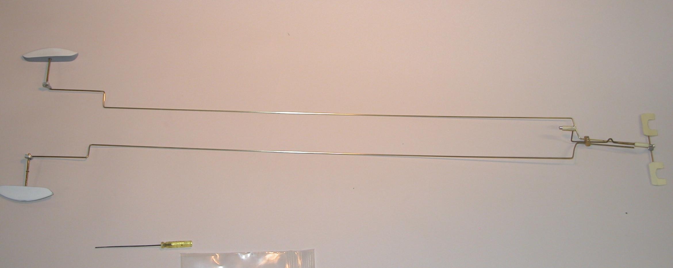

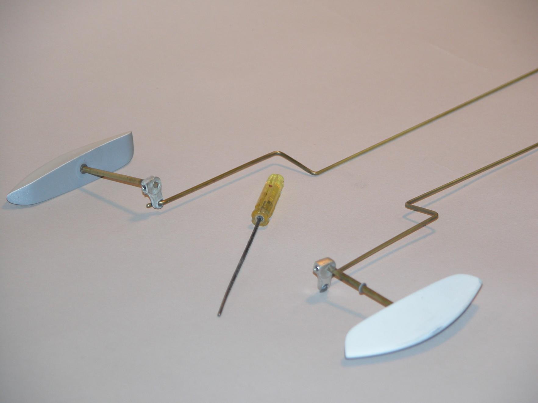

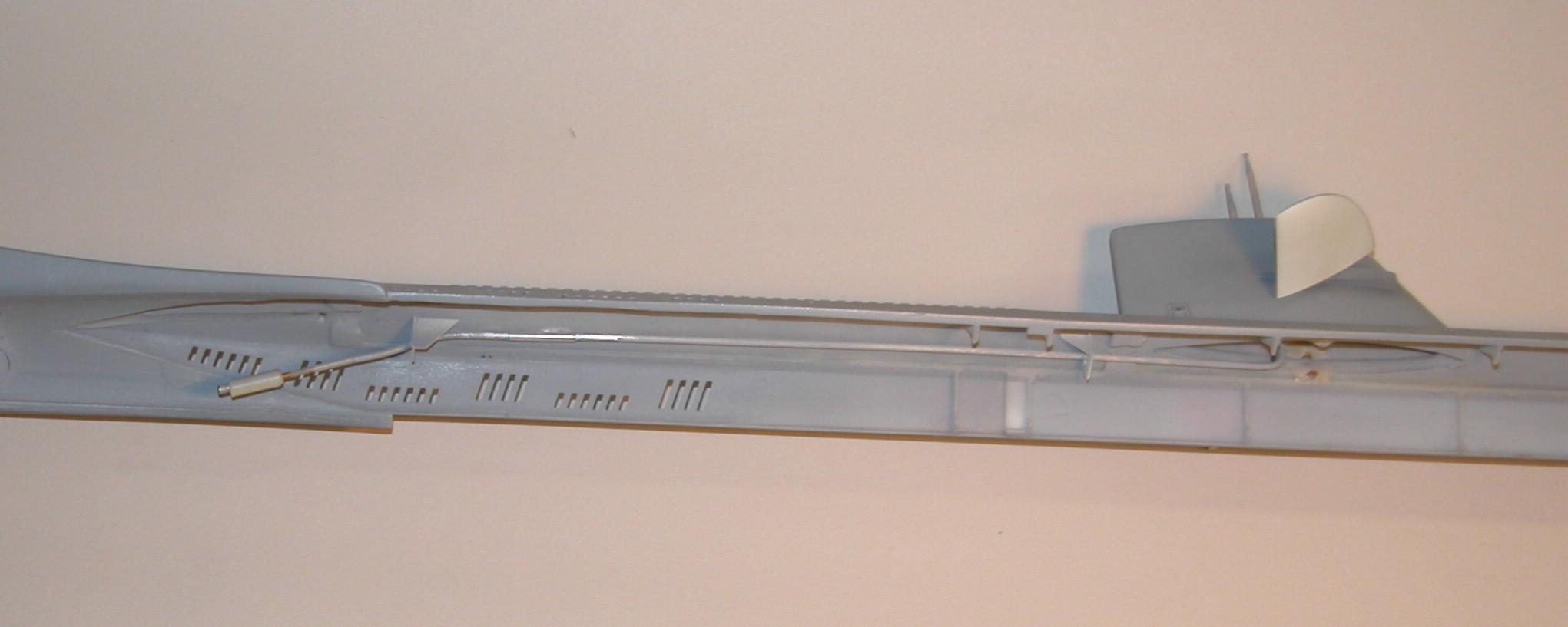

    Sorry about the delay. Below I've laid out how the linkages are arranged within the SEAVIEW:
    (just took the measurements off one of the two bow plane-stern plane pushrods)

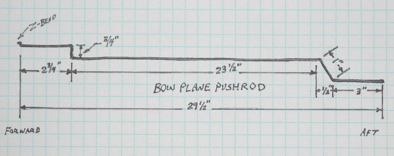

      • 13998
      The pushrod measurements:

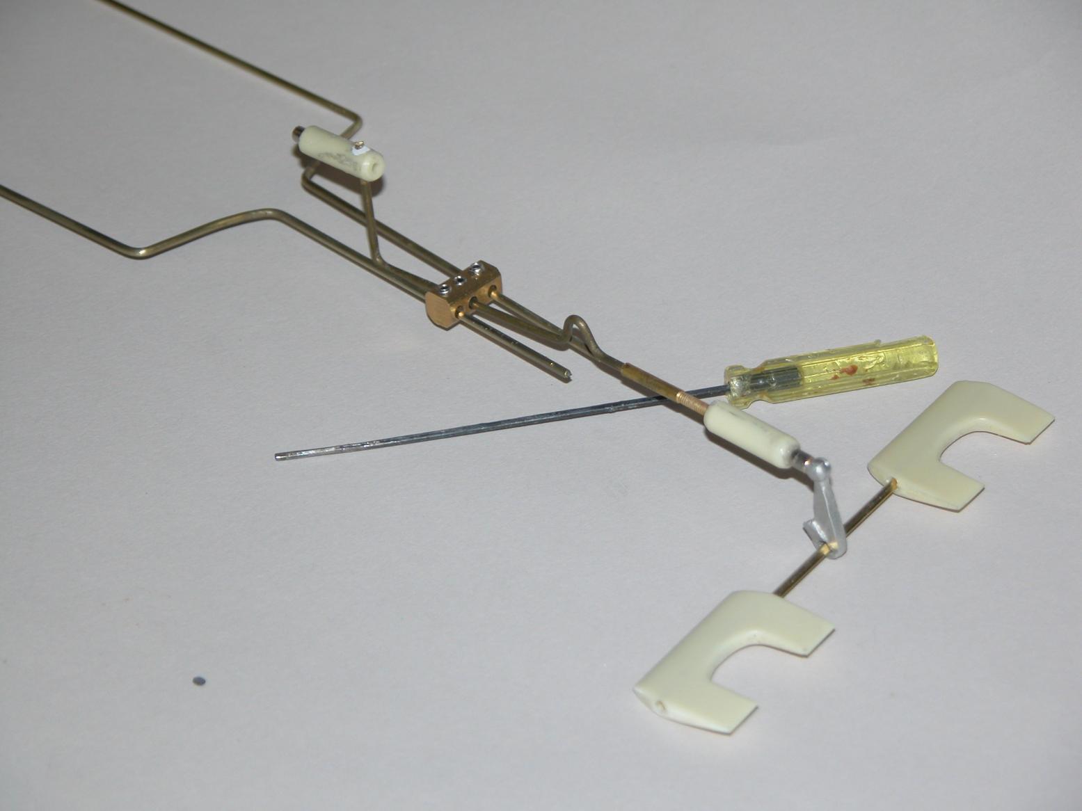

        Dave
        Thats a neat coupling your using to tie the bow and stern planes. I was going to solder small collars together to make one.
        Steve
          • 13998
          Originally posted by SteveJ
          Dave
          Steve
          Yeah, the pushrod coupler I made makes individual adjustment of the four (2-stern plane, 2-bow plane) control surfaces easy and sure. But, you can get away with a 3/16"i.d. wheel-collar to gang the three wires together.

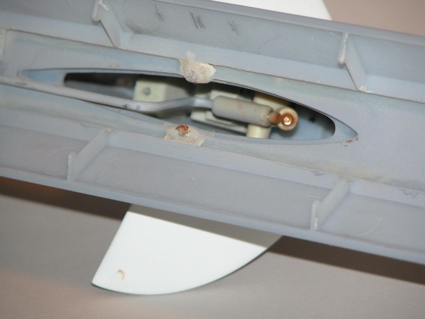

            Hi Dave
            The rust evedent on the klickons , is that a result of chlorinated water?
            Does it affect the magnets?
            Rick
              • 13998
              Hi Dave
              Rick
              That's good old Iron oxide, Rick. Though the magnets are Chrome plated (I assume its Chrome), if they get nicked the Iron quickly oxidizes and you get rust. No big deal ... call it, 'weathering'.

                Please sell us your 3 Push Rod Connector fitting?
                Ever thought of adding the pushrod coupler you made for the Seaview to the SEAVIEW's Fittings Kit (or sold seperately)? As you stated "dividual adjustment of the four (2-stern plane, 2-bow plane) control surfaces" makes it easy to account for slippage over time of the three different pushrods.

                  Yes, but dropped the idea as it increased the coast of the fittings kit. So I let the end-user figure that one out. A 3/16" wheel-collar will get the job done.

                      3-way bow/stern coupler
                      Hi Dave:
                      Can I purchase that neat 3-way bow/stern linkage coupler yet?
                      The collar coupler works, but what a pain. I need and desire the indivial bow plane ajustment it affords. Seems like you adjust one bow plane and the the other side falls out adjustement. Cannot get that neautral setting of the bow planes with the collar it seems.
                      Please, please I hope I can purchase the 3-way now or real soon.
                      Thanks
                      Stan
