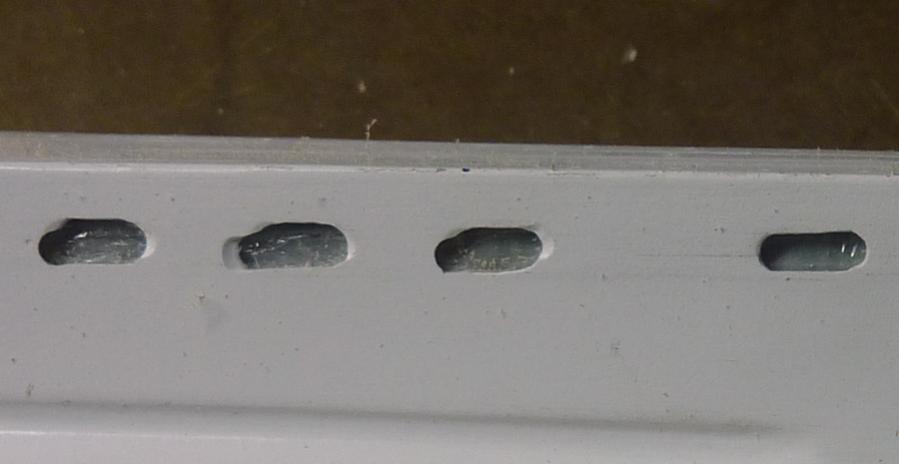

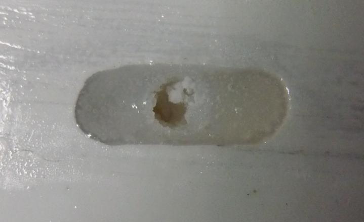

    Fixing the FUBAR limber holes - Epoxy repair kit plus micro balloons
    Don't forget I have the Caswell epoxy repair kit (A & B) plus micro balloons. What if I put some clear tape over the back of the hole to keep the epoxy from just falling out and then put some epoxy repair with micro balloons (thickened like paste) into the hole - wait 24 hours - sand sort of flush - and start over with a brand new hole?
    Is that approach better or should I just go the CA + baking soda route?
    I really appreciate the time you're taking to keep/bail me out of trouble.
    Dan

          I can't get it hard
          David and All,

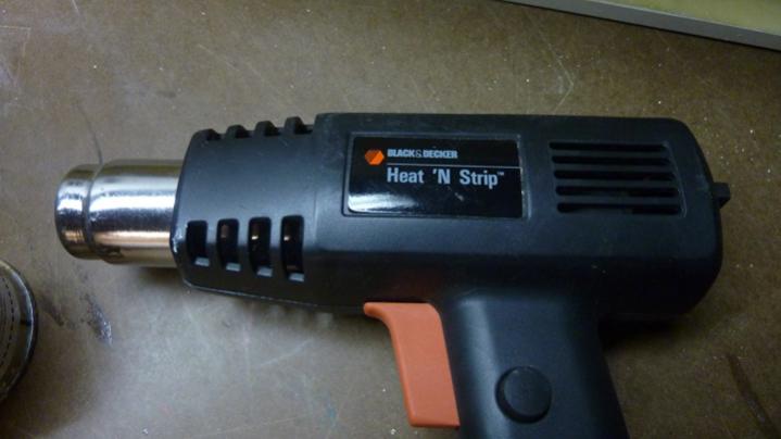

          I wanted to learn about the Caswell epoxy repair kit so I used some of it to fill in the FUBARed limber holes. I mixed it to a specific 2:1 ratio, as specified on the can, and added some Cabosil to thicken it up a bit. I carefully used some heat from a heat gun, keeping the gun about 2 feet away from the work. I tried that for about 1 minute. Set the whole thing aside but checked on the hardening every 12 hours or so. After 3 days it doesn't seem to be rock hard but I don't think it's going to get any harder either. Tried drilling a hole in it just to see how it would look. The drill is entirely gummed up with epoxy repair "stuff".
          Did I do something wrong? I tried the CA + baking soda trick on some other holes but wasn't really satisfied with that fix either.

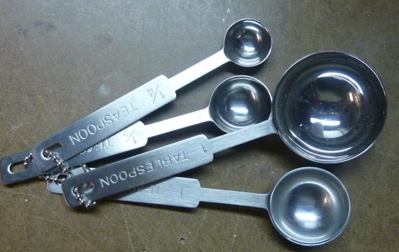

            How much did you mix up? Small amounts can easily be easily incorrectly measured out. I didn't like the look of those 1/4 teaspoons, far too little material. At least I would mix up 2 tablespoons of A to one of B. Leave them for 10-15 minutes after mixing to allow the reaction to accelerate. Make sure you scrape all the material off the spoons to ensure volume accuracy.
            Your results are a direct result of either insufficient mixing or incorrect mixing ratio.

              I used the 1/2 and 1/4 tbsp sizes. It was more than enough to fill in the existing bad holes. I thought I mixed it thoroughly but I did not wait the 10 - 15 minutes to allow the reaction to accelerate although I fail to see how that can be a problem. Wouldn't the reaction just take place after I placed the mixture into the hole?
              Anyway, I'll try it again being careful about the ratios (although I was very careful the first time, I thought), mix thoroughly, add just enough Cabosil to make it thick, wait 10 to 15 minutes, and then place the mixture into the hole.

                  I think this is your problem - incorrect mix ratio. Those small spoons and the tiny quantities involved are the culprits. Mix up in tablespoon quantities. Warm the resin to 80f before measuring out, it will be much runnier and not stick to the spoons so much. Also, the 80f will kick off the resin. This material is not a fast cure, (it's a high strength epoxy) and so thin cross section, small amounts, and incorrect mix ratio will all add to the problem. Better to waste a bit but get the ratio right. Put the Cabosil in 10 mins after the initial mix.
                  Of course, you could mix up the Cabosil into each separate component A & B so you have 2 pastes. Then you simply mix 2 parts of A to one of B as and when you need it. Make sure you put the same amount of Cabosil into each resin part.

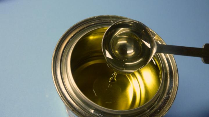

                    Caswell Epoxy repair - the better way
                    All,
                    Well, Mike, you were correct. I'm not surprised. Here's what I did to fix the incomplete epoxy cure problem:

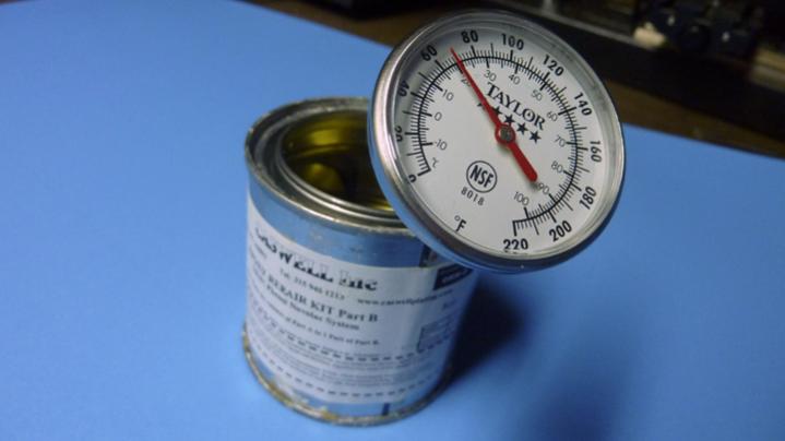

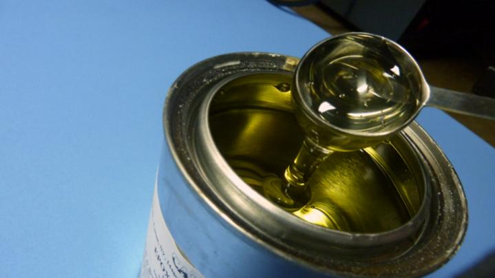

                    1) Epoxy Part B at 66F is OK to measure and pour as its viscosity is low enough.
Name:	006-1 Epoxy part &#66.jpg
ID:	58432Click image for larger version
Name:	006-2 Part B pour&#115.jpg

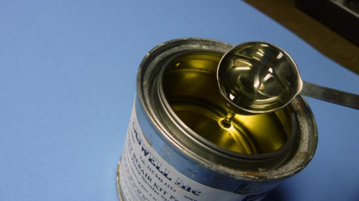

                    2) Part A, on the other hand, at 66F ( My Michigan basement) is way too thick to measure or pour.
Name:	006-3 Epoxy Part A.jpg

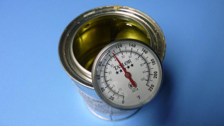

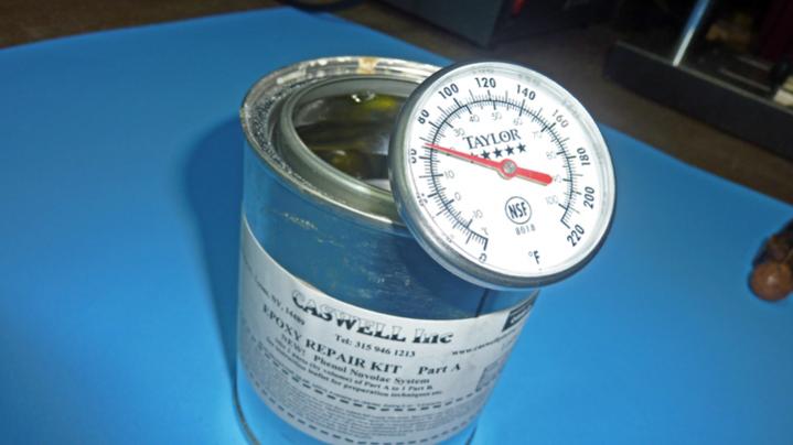

                    3) Heat Part A in a water bath to about 106F - measures and pours well.
Name:	006-5 Part A at 10&#5.jpg

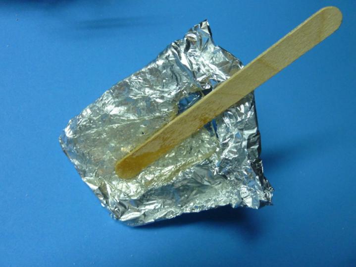

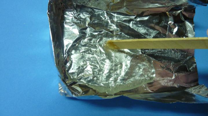

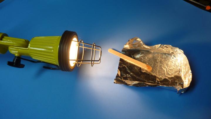

                    4) Mix well - heat with lamp for 24 hours.
Name:	006-7 Mix well..jpg
ID:	58438Click image for larger version
Name:	006-8 Cure under &#1.jpg
                    5) Epoxy is rock hard

                    Next step is to do it again with Cab-o-sil and fix the FUBAR holes

                      #40
                      Yup! Bin Thur! Dun That! Lotsa times!
                      The cure time under a lamp for could be cut down to a minimum of four hours at approx 150 f (surface temperature of model) and you will achieve what is called a 'post cure'. This means the resins will initially cross link to create a solid state, then a while later, a second cross linking will occur, making the overall repair about 10% stronger and more chemical resistant than a strait room temperature cure. However, full cure in both situations will not occur until about 5-7 days, only approx 90% of full cure occurs in the first 24 hours.
