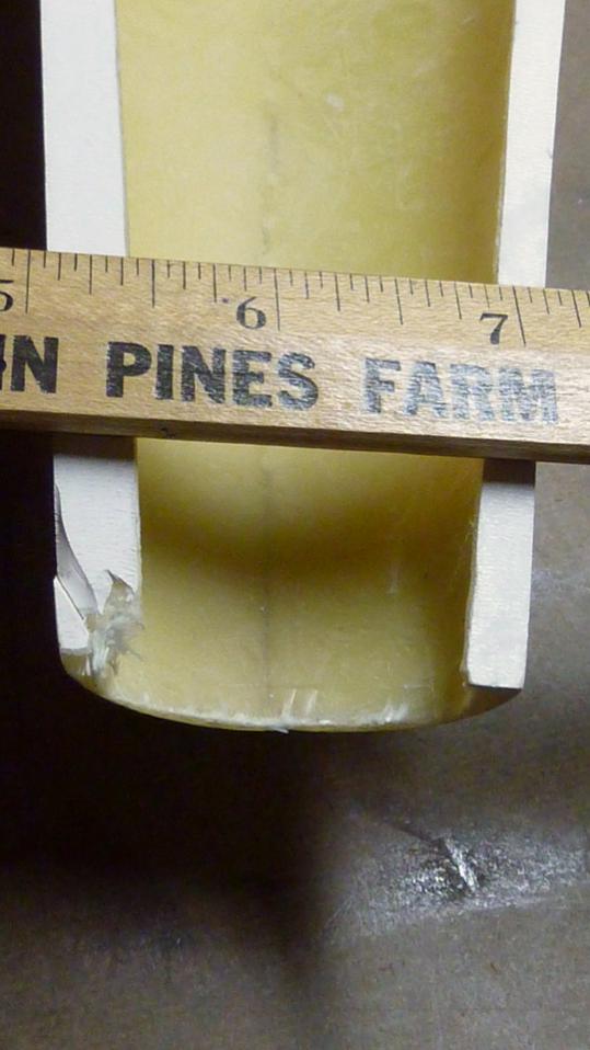

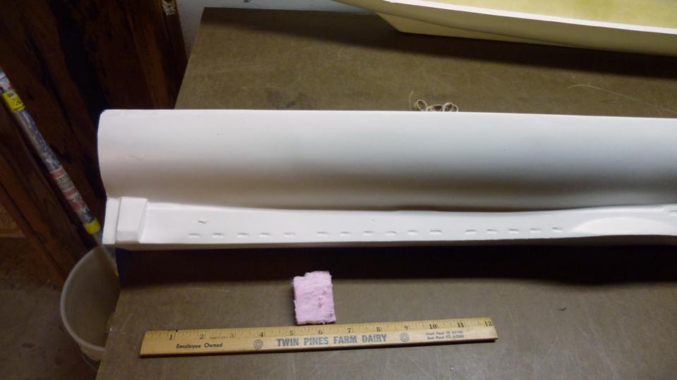

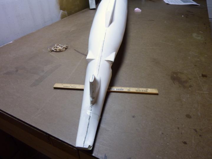

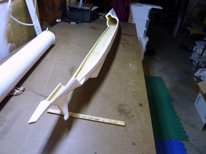

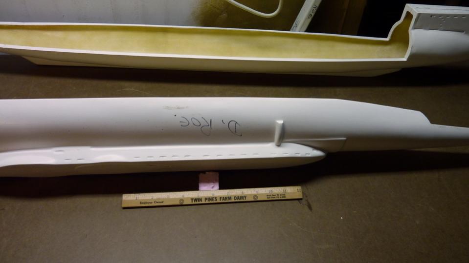

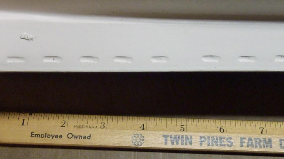

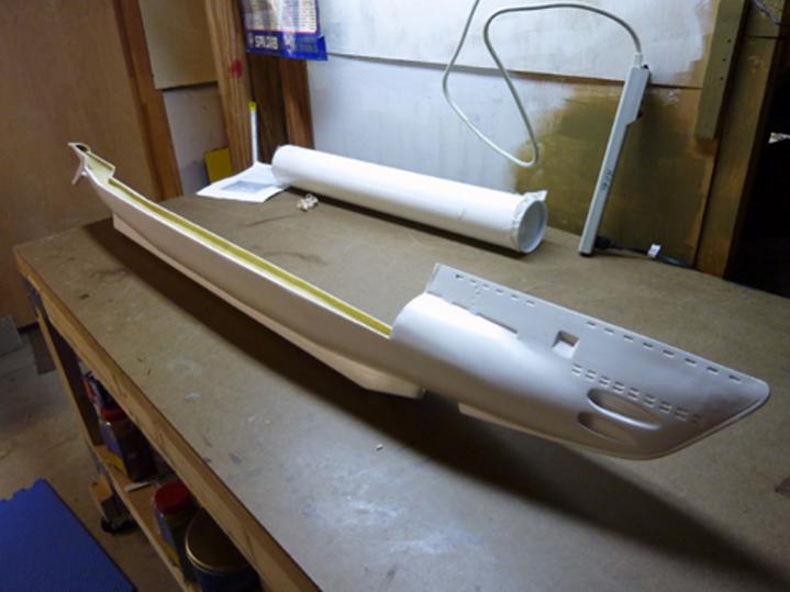

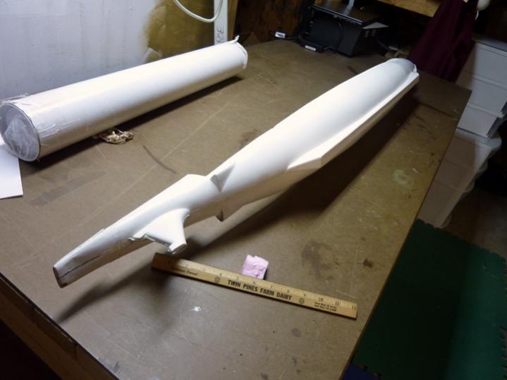

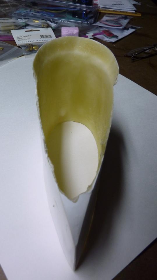

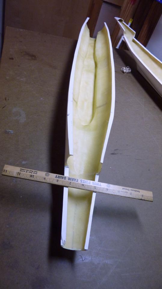

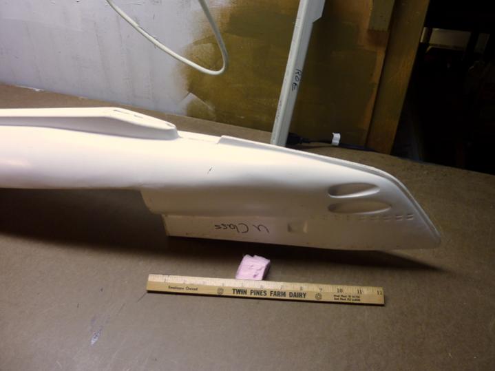

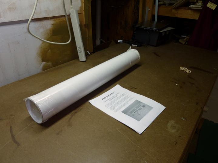

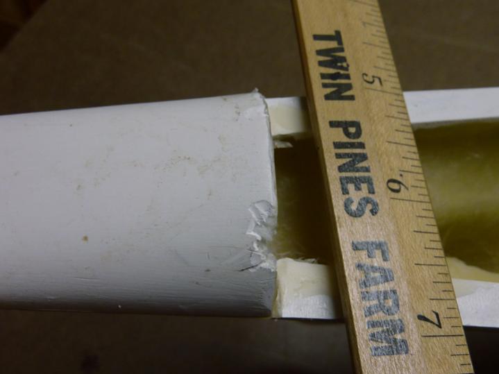

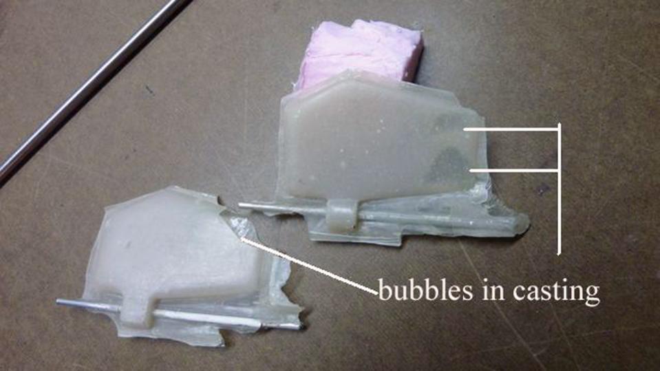

    First here are some pictures of the hull. Some pictures show slight damage - no big deal - I'll fix them later. The forward dive planes have some bubbles in them but I don't intend to use them anyway as I'll make the planes out of sheet brass.
    Dan

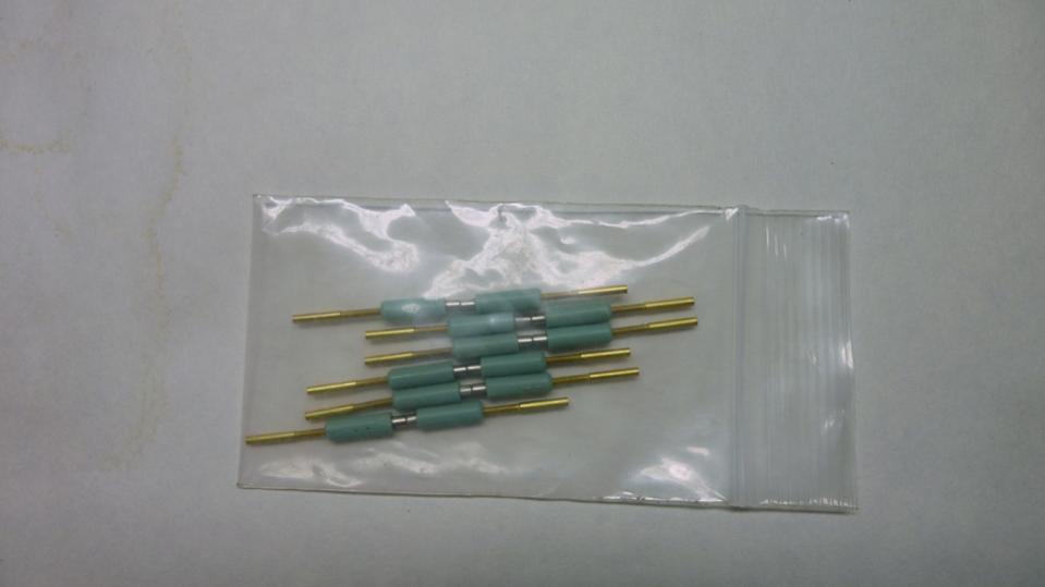

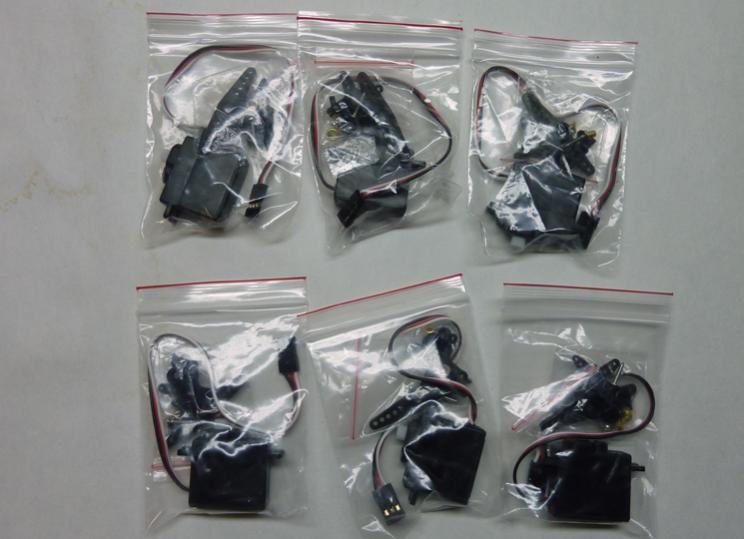

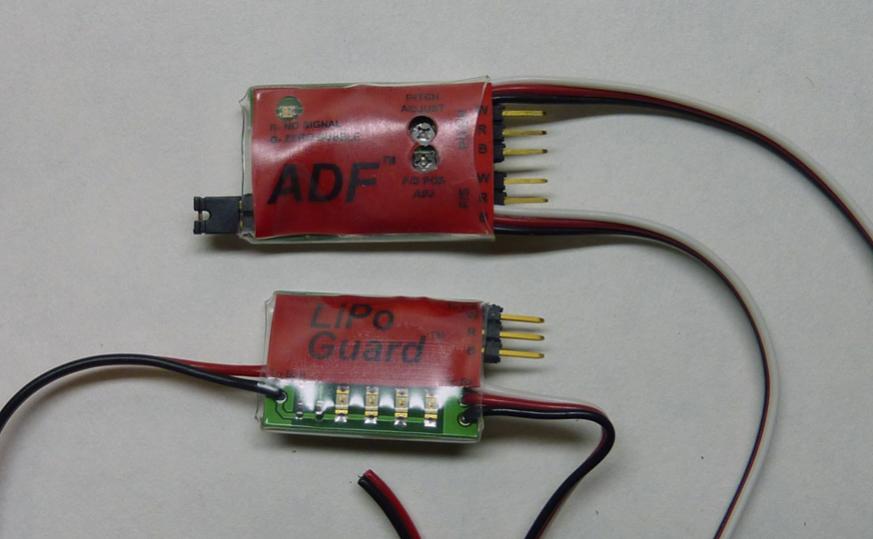

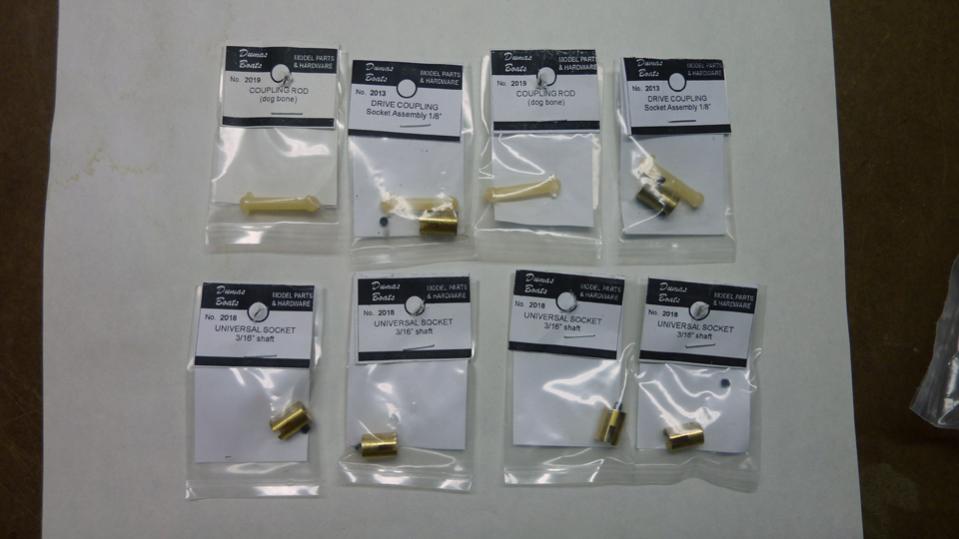

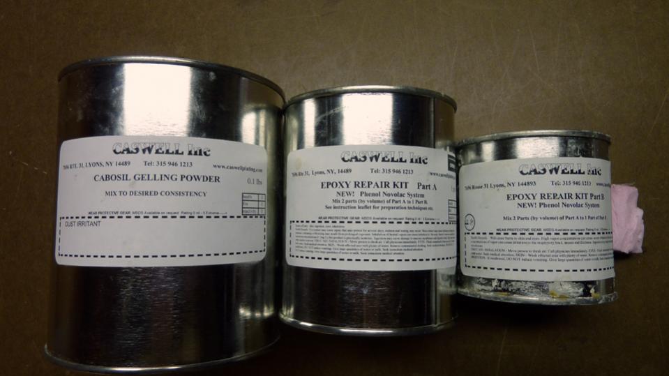

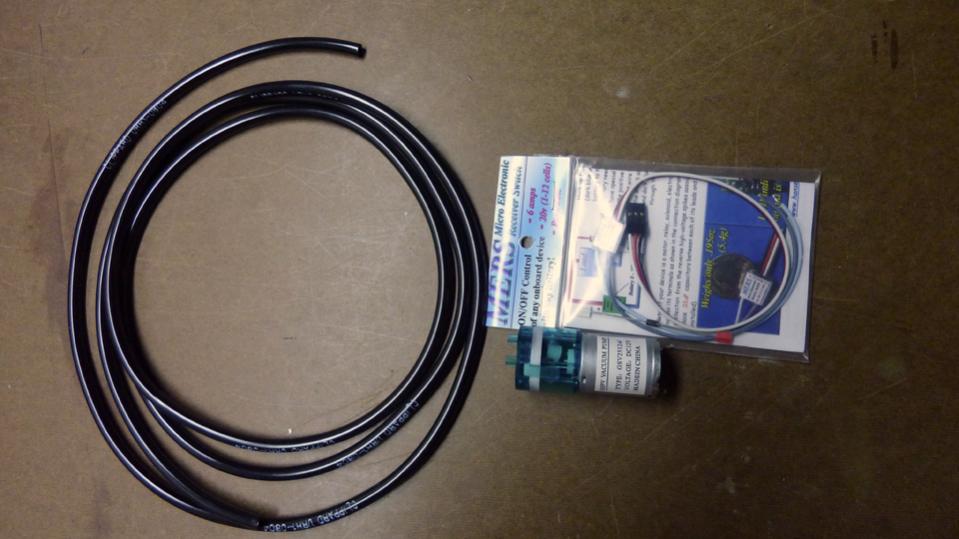

      Next I'll show some of the supplies acquired for the build.
      Dan

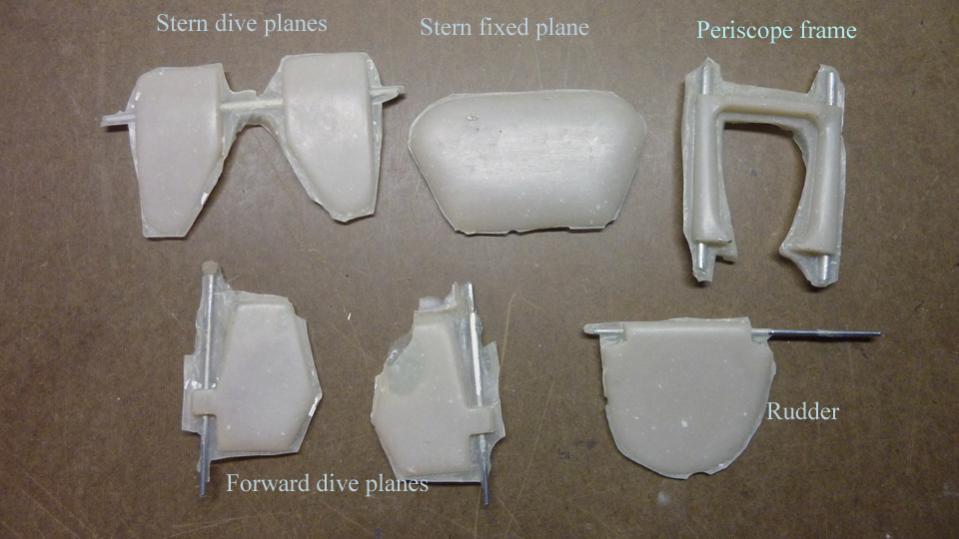

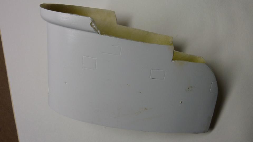

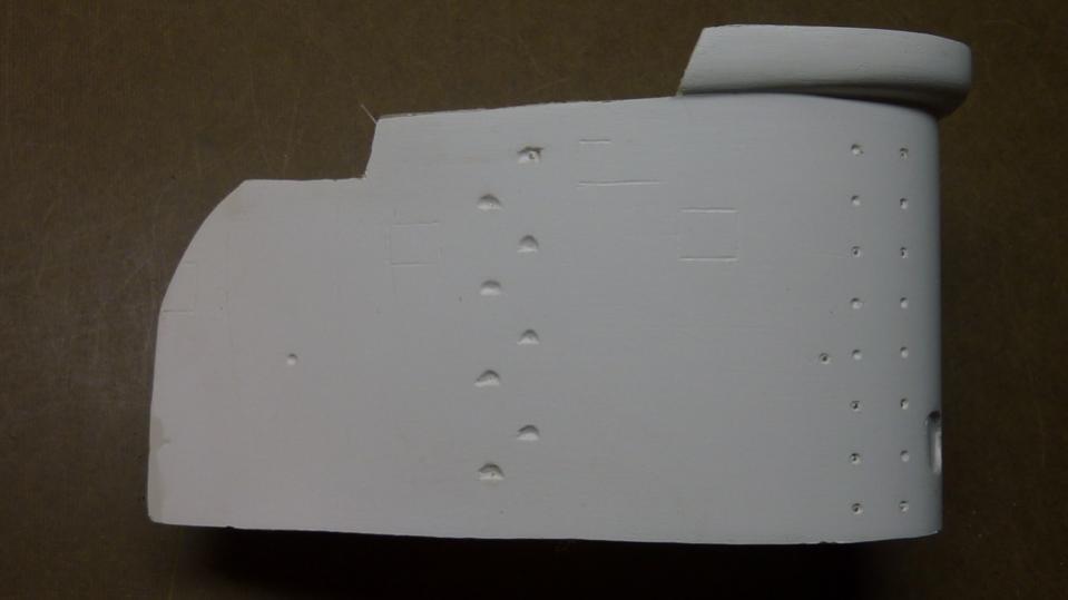

        Finally some pictures of the sail and a group picture of the running gear.
        Dan
              Dan
              That is one rough looking kit. Fix the damage at the stern and the radial flanges with the epoxy/filler pack provided with the kit. Those resin appendages look like they were mash-molded using left over catalyzed laminating resin. Awful!
              Other than the damaged stuff, how well does the white gel-coat adhere to the underlying fiberglass (which looks like a heavy single-shot of sprayed on resin and chopped glass)?
              I have the feeling that a full-scale boat builder is employing the tools and techniques of that trade to produce model kit parts from much smaller tools -- not always a good transition, as you are abundantly aware of by now, Dan.

                      Epoxy repair parts A and B - required ventilation
                      Well enough, I guess. I don't really know what criteria I should use to test this. None of the gel-coat appears to be flaking off.
                      I have looked at the instructions with the epoxy repair kit and while I'm sure it'll work, I'm not thrilled with all the ventilation warnings. As I said, I'm in Michigan where it's cold and snowy which means I don't have access to an outside area to mix and apply the epoxy. Furthermore, my work area shares a part of my basement with the central heating furnace. I'm not so worried about flammability as I am about the furnace pumping the fumes throughout my entire house when the heat kicks on.
                      Epoxy repair kit part A health warning 3 out of 5.
                      Part B health warning is 2 out of 5
                      Is there another less toxic way to fix the structural damage?
                      Dan

                        Then I guess we can safely assume there is no problem with the gel coat.
                        We supply MSDS sheets that are accurate and truthful. If you take the proper precautions, wear gloves, remove material from skin etc. you will have no problems. Consider that MSDS sheets are designed for industrial use, where people could be exposed to these materials all day, every day.The ventilation requirement is minimal as there are no solvents in this material unlike polyesters (car body fillers etc) and many other goops. You're more likely to be hit by a bus than have problems with this.
                        How did you come up with the 'ratings'?

                          The ratings and all the warnings are the label Caswell applies to the cans. I'm a retired Chemist and after several years of inhaling fumes that would drop a horse I tend to read labels a little more than the next guy.
                          I'll give it a try although the label mentions an instruction sheet for application techniques, ets. Is this a .pdf file available for download?
                          Dan (still breathing)

                            Stop whining! I'm sure you have not gotten your daily minimum dose of carcinogens from the basement Radon, Dan. So, suck it up, crack the lids to the epoxy and breath in the fumes. Get to work! And share the hobby with the rest of the family, you selfish so-and-so! Crank up that heater.
                            Here's the gel-coat test in one simple operation: break out the drill and Dremel bits and open up some of those limber holes. If the surrounding surface gel-coat does not chip next to the holes you're punching, then the gel-coat is good. Simple.
                            Listen, you only have to worry about epoxy toxicity when you start evidencing neurological damage which presents as unreasonable aggression, sarcasm, mean spiritedness, and a total disregard for the feelings of other. From your writings I see none of that. So far.
                            Listen, pal: I've been working with this stuff for decades and it hasn't done me any harm at all. So ... stop *****ing about the epoxy ... or I'll go over there, kick your ass, then make posts about how funny you dress. Don't make me do it, Dan!

                              Aha! That chemist thing explains a lot! :-) I'm glad you brought this up as most people don't even look at the labels. The MSDS is for a Ciba Geigy resin system and they tend to go overboard with them, as they make a lot of products used in body implants, contact lenses etc. The 2 & 3 rating, if I remember correctly, is a fairly low assessment. I'll have to do some homework, because I forget. Maybe it's the paint fumes from remodeling my house?
                              The Instruction Sheet is really for use as a Fuel/Gas Tank Sealer, and refers to the techniques we have developed to deal with that problem. You only need to mix the material together 2:1q ratio and then add Cabosil until the material turns to a paste that is consistent with your requirement. ie: On vertical surfaces, make a stiff mix, on shallow areas, make it a little sloppy, so it wets out the substrate properly. Use it in a room at 70f or more for best result. I often place an illuminated 60 watt light bulb close (6-9") to the repair to speed up the cure. It will set in about 15 minutes like this. Depending on the heat applied, you could be sanding the repair down in 30-60 minutes. I usually leave it overnight. If you think the repair may slump, place a piece of polyethylene sheet or Gladwrap over the are, to hold it in place.
