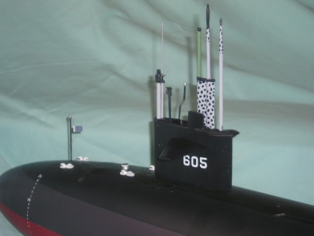

      Hi John,
      Looking at your bottom picture of the masts from left to right:
      The first scope is the new BRD mast, it goes in the mini sail
      The old BRD mast, number 7 from the left is not used anymore
      Number 10 is the UFF IF antena and is not used anymore as the mini sail takes it spot. That antena is now the wart on top of the snorkel (number 9)
      Number 14 the last mast on your picture is the new observation scope. This is now located where the old BRD mast was right in front of the attack scope
      Number two is prop dunce cap
      three is a hull mounted light
      Four and Five are flagstaffs
      Six is the helical sail mounted rotating light
      Seven and eight are not used on your sail
      Ten is the radar
      Twelve is the MF/HF antena and still goes where it used to
      Thirteen is the attack scope and still goes to the same spot
      I hope this makes sense?

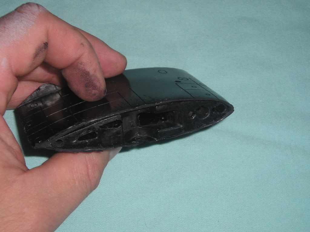

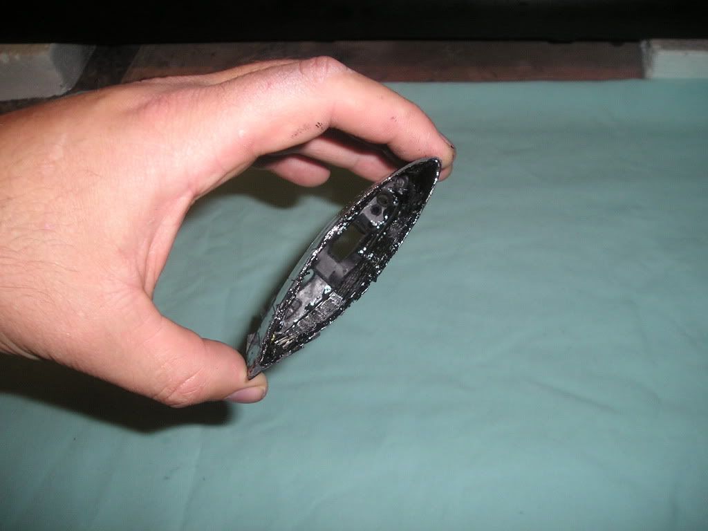

        As for the rack itself, it is imperitive that it is installed correctly before going onto tthe sailplane bearings. Cut out all your mast holes on the sail first, you have to ensure that each mast has room to fit into it. The holes should be slightly larger than the scope shaft just like on the real boats.
        Next you can install the rack. It should be able to slide in and out of the sail without much trouble. If not you can use some heavy grit sandpaper on a wood block and do a little trimming. You don't want the rack to distort the sail walls if you have to force it in Slide to the top and place your scopes in and check for straightness in relation to the sail. If the angle is off (it was slightly on my Jack) simply remove the rack and block sand along the top and side opposite of which way the scopes lean. Then sand along the bottom and side of the rack on the opposite side. I opened the cockpit on my boat and you have here too. The scope rack should come flush to the front of the cockpit opening

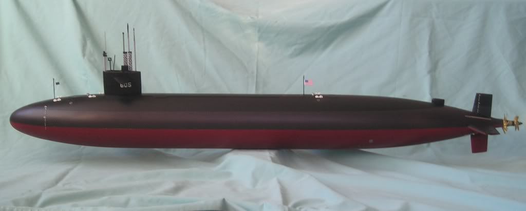

                      The USS Plunger is coming along nicely - and its been about a month or so since I updated this thread I hope to have an update in the next day or so.
                      The excuse - Tales of the South Pacific - been walking in the footsteps of James A Michener's war time experience on Vanuatu's islands and the islands of New Calendonia
                      If you have an opportunity do so or perahps check out the 1948 Pulitzer Prize for Fiction "Tales of the South Pacific". A ripping yarn and a great work of literature.
                      See: http://en.wikipedia.org/wiki/James_A._Michener
                      The USS Plunger work completed thus far:
                      HULL:
                      -upper and lower halves mate - indexing lips fore and aft install - side
                      indexing lips installed.
                      -Tabs -no need on your hull to use them - its too perfect - yes guys the alignment is that good.
                      -screw connections fore and aft installed
                      -rear stabilsers and planes installed
                      -openings drilled out
                      -torpedo tube shutter openings installed (the Merriman tubes will telescope inside).
                      -shaft bearing installed

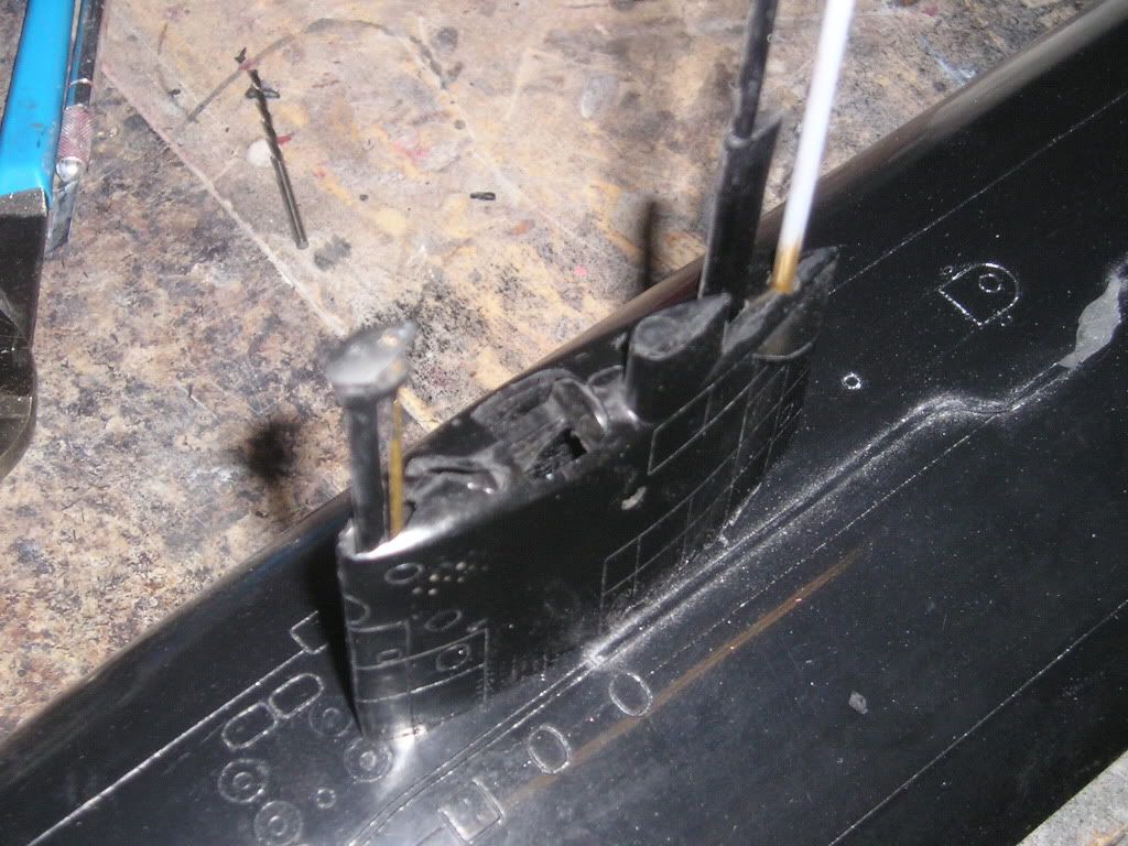

                      SAIL:
                      -upper opennings
                      -scope rack installed
                      -screws for mating to hull installed
                      -bearings installed
                      -sail planes installed and linkage to low hull
                      Anyway film or pictures at 11.
