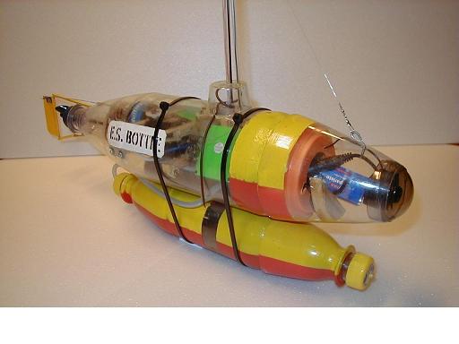

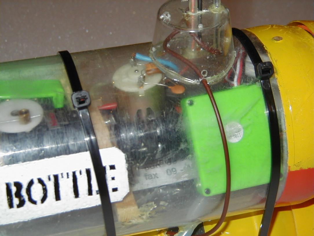

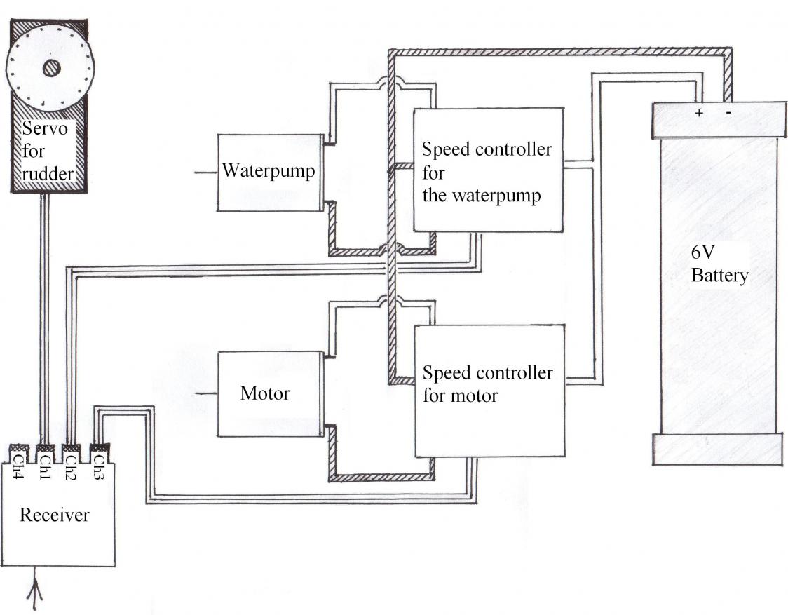

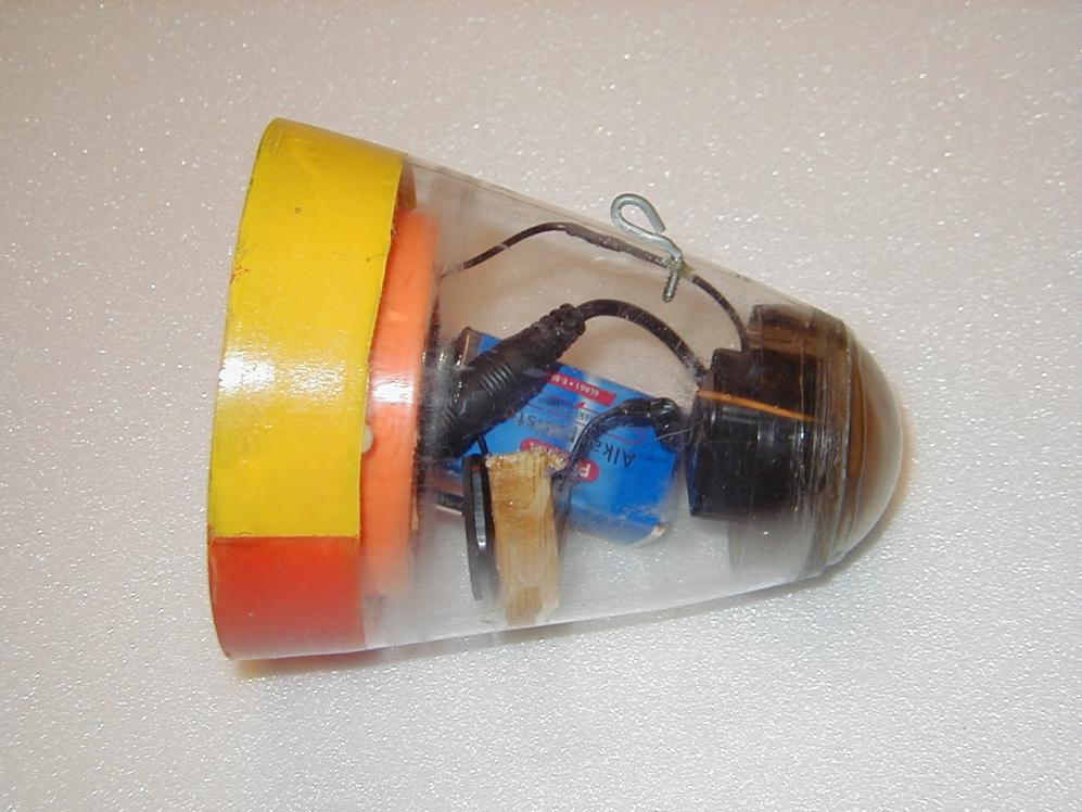

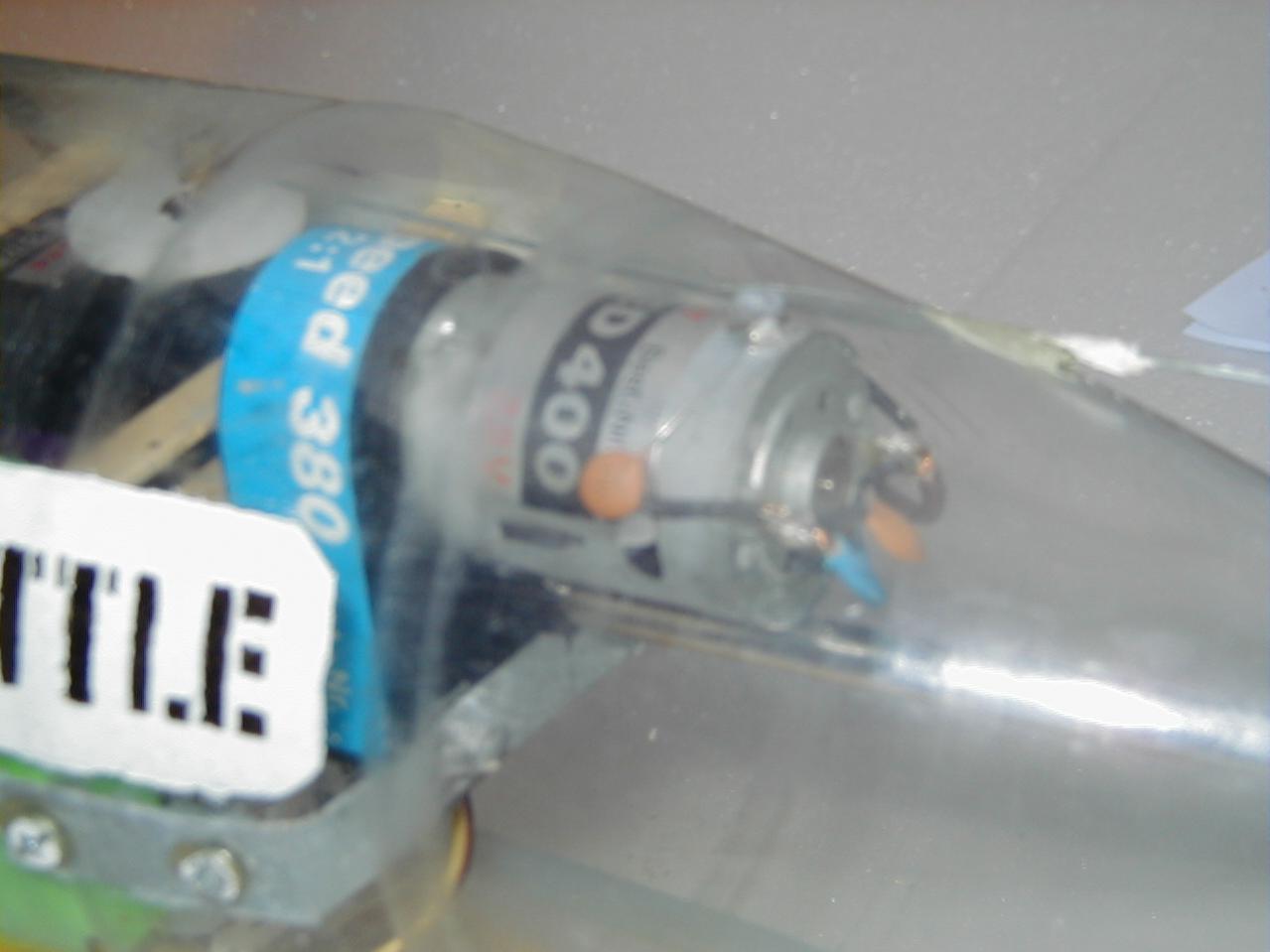

    Talked with the builder, he was kind enough to send me some photos.
    It uses a vented tank/ water pump ballast system.
    No dive planes.
    Wireless camera in the bow
    Lower bottle holds the battery pack.
