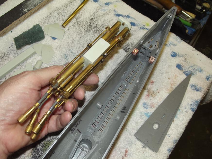

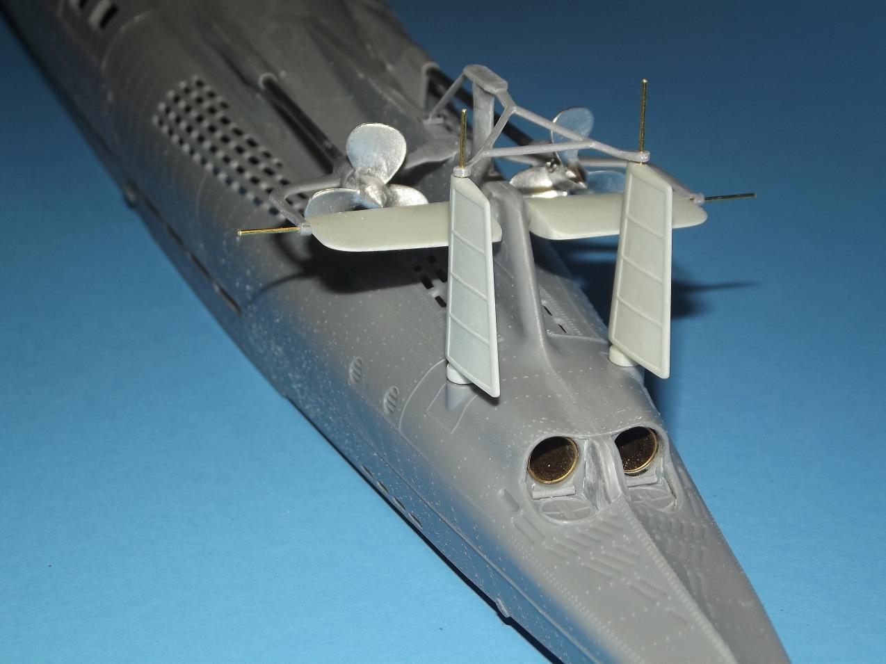

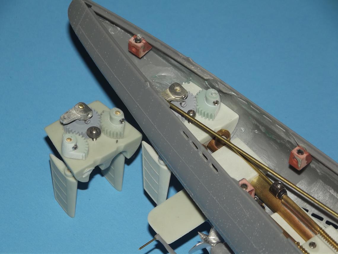

      Asap i'll post some photos of my ship, actually i'm working at rudder shafts, hull and, maybe next week, the wtc.

          Very interesting photos, thay gave me some ideas...
          I was in trouble for the the motors sealing shafts: simmerring? Grease?

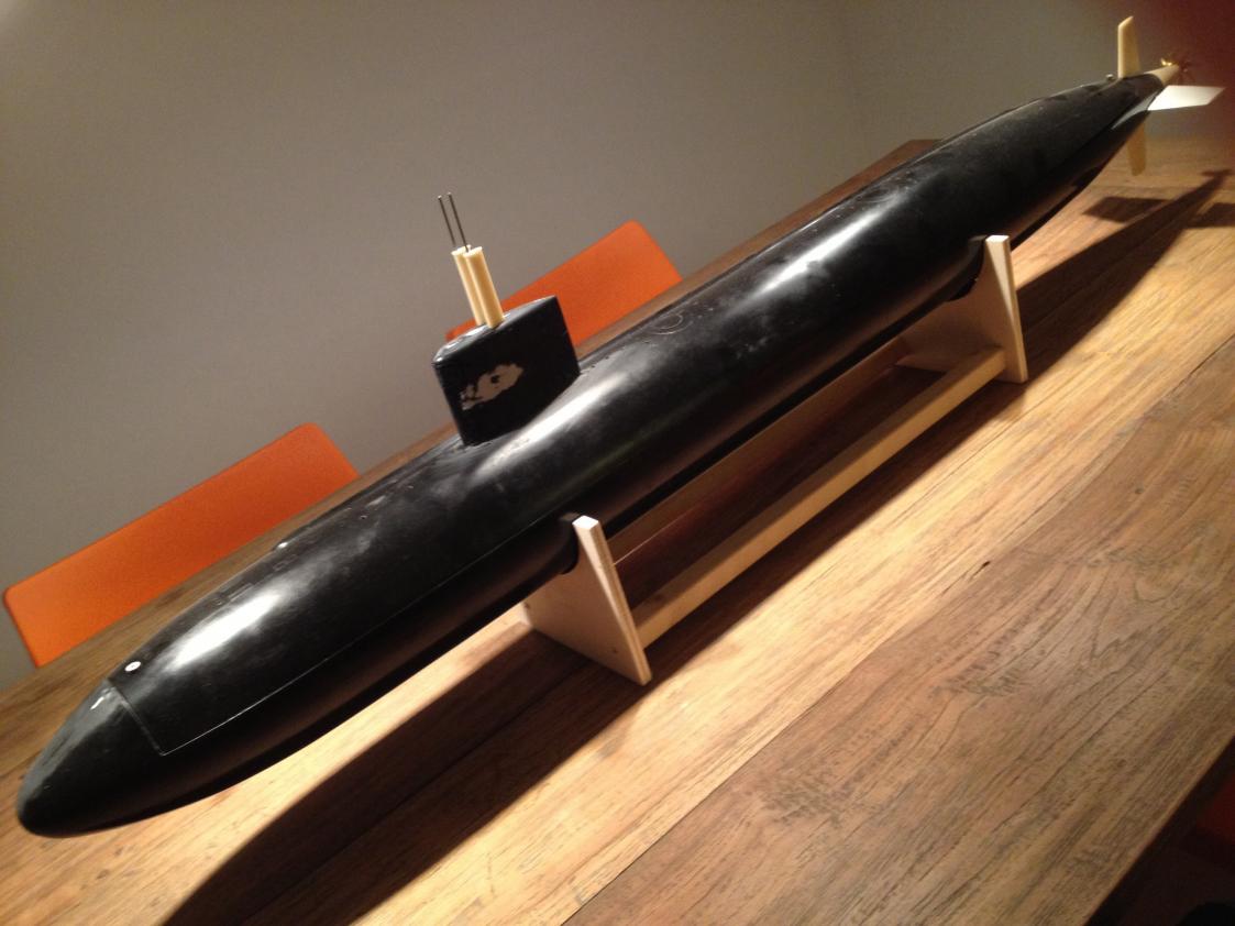

                        My LA class...
