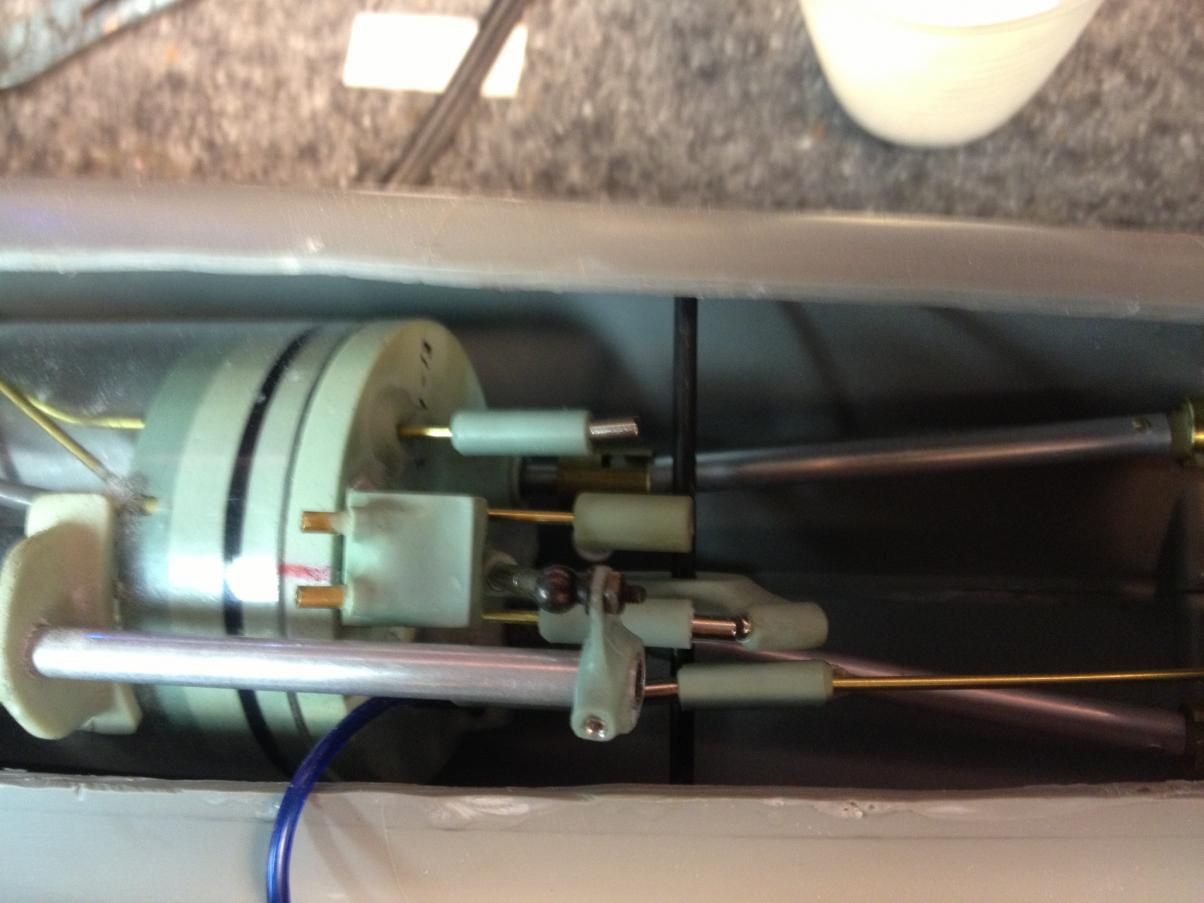

    The drive shafts seized up after a high speed run. Traced it down to the stuffing tubes through the hull. I have since ran a shaft through them with polishing compound and the props spin free by blowing on them.

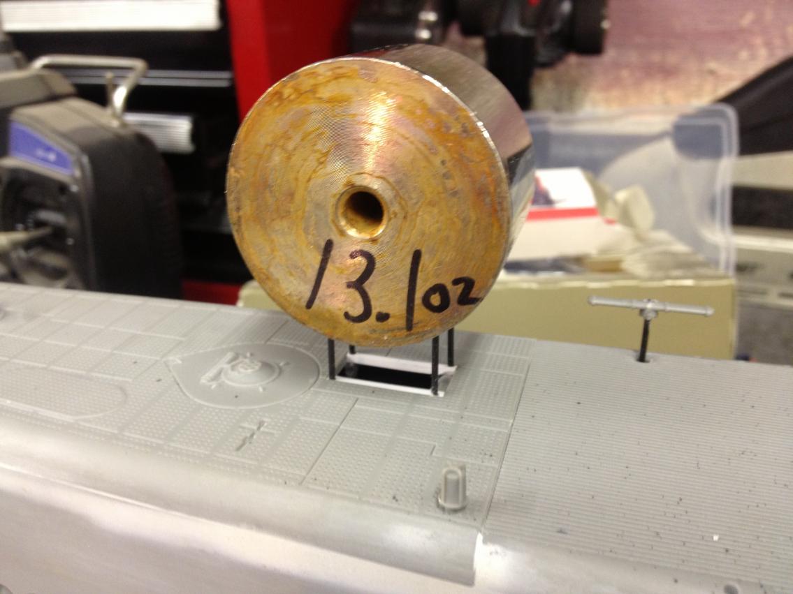

      Extreme testing of the magnets holding the sail on. Yeah it would have sucked had it fell upside down.

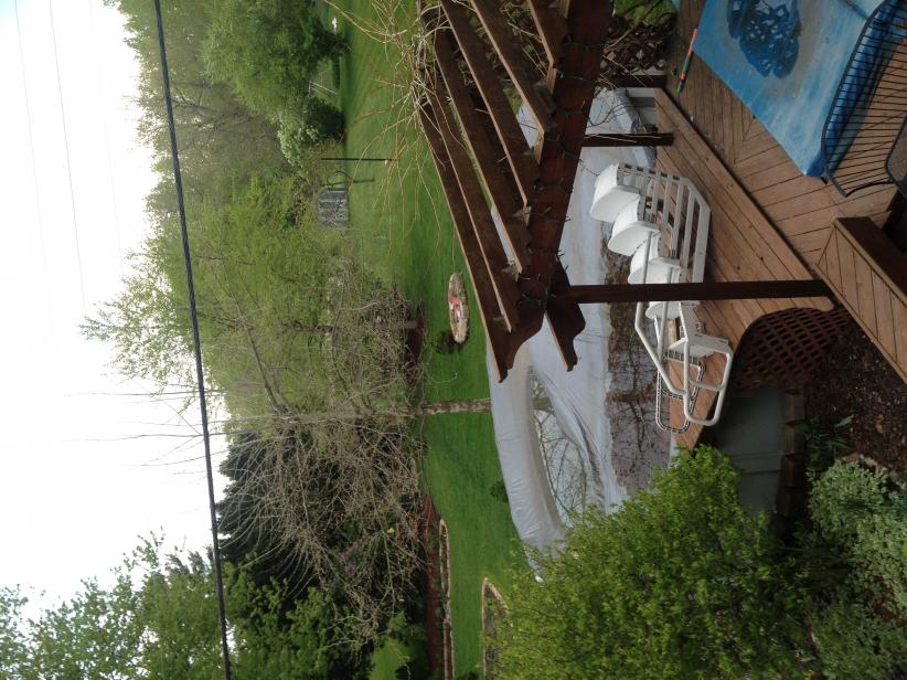

ID:	81039 My three test tanks. Behind the tall center tree is my 40 by 90 pond.
          • 14010
          This hobby is, by its very nature, problematic for the end-user. I can take things only so far. But, you obviously are a problem solving sort of guy. I like that. Three bodies of water!? I hate you!

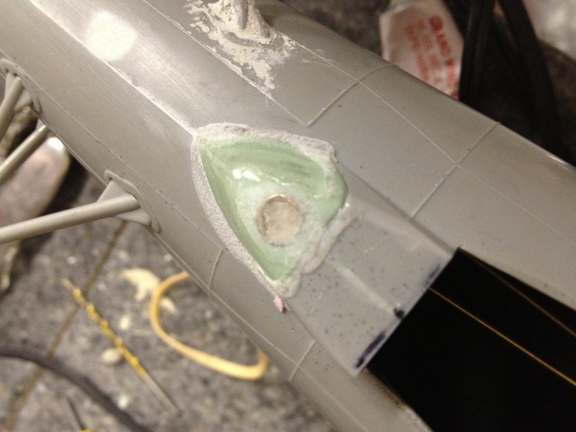

            Changed over to magnets to hold the deck on. Works great. And no visible fasteners now.

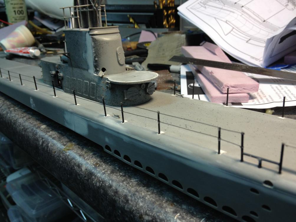

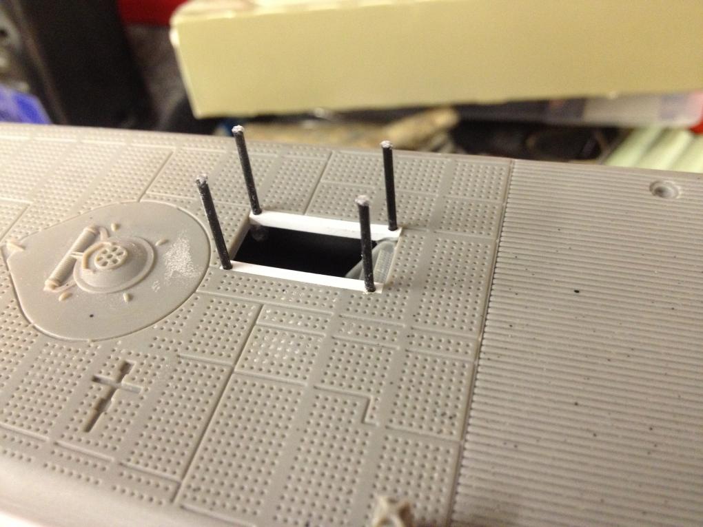

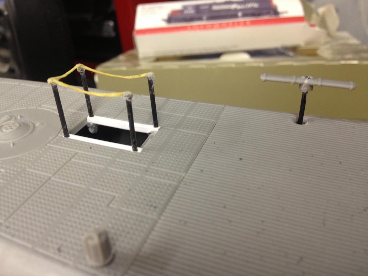

                  And here's my solution to the railing for the stairwell. I drill the holes clear through. Take a rod of carbon fiber and put a drop of CA on the end. Then I dip it in baking soda. Slip the rod in from the backside. Add more CA and baking soda while setting it straight. Then I measure and cut with a dremel cutting wheel.
                  • Buellman1
                    • 93
                    Used some Kevlar thread to make the railing. A bit of sanding and paint and hopefully it'll look good enough for a running model. The weight was set on there to form the Kevlar until it dried.

                          The breather is gone David. It's base made for a fine filler of the hole anyway.

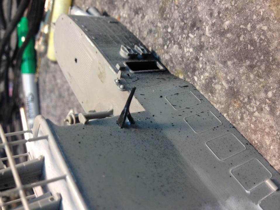

                          Working on stanchions and cable today. Would like to get some paint on this thing soon. The stanchions aren't going anywhere, but using the kitted string. Decided the Kevlar was way out of scale.
                            • 3770
                            I do not know if you have a fishing store that has a fly fishing section or an Orvis fly fishing store near by, but there is a kevlar thread used in tying flies that is pretty thin, as thin or thinner than the thread in the kit. Especially if you spin the thread tighter. I can explain that more if you go that route. You could spin your current thread to make it smaller too.
                            If I might make a suggestion, get your boat trimmed first, put that hassle behind you. I found myself breaking the bits and pieces (which added to the trimming frustration) and then I decided to follow HWSNBN, or whatever the initials are, maybe it is time to change his name to M, very Bond chic, it could mean Master or Merriman or Modeller or ?? and easily memorable, anyways, advice and add those other things after. Although your nuclear blast resistant railing is really cool looking and very strong, I would hate to see it broken before she gets a chance to sail.
ID:	81245Thanks Tom, I will heed the advice. I'm jumping all over the place on this build I know. It has ran and I know the bugs I need to work out.

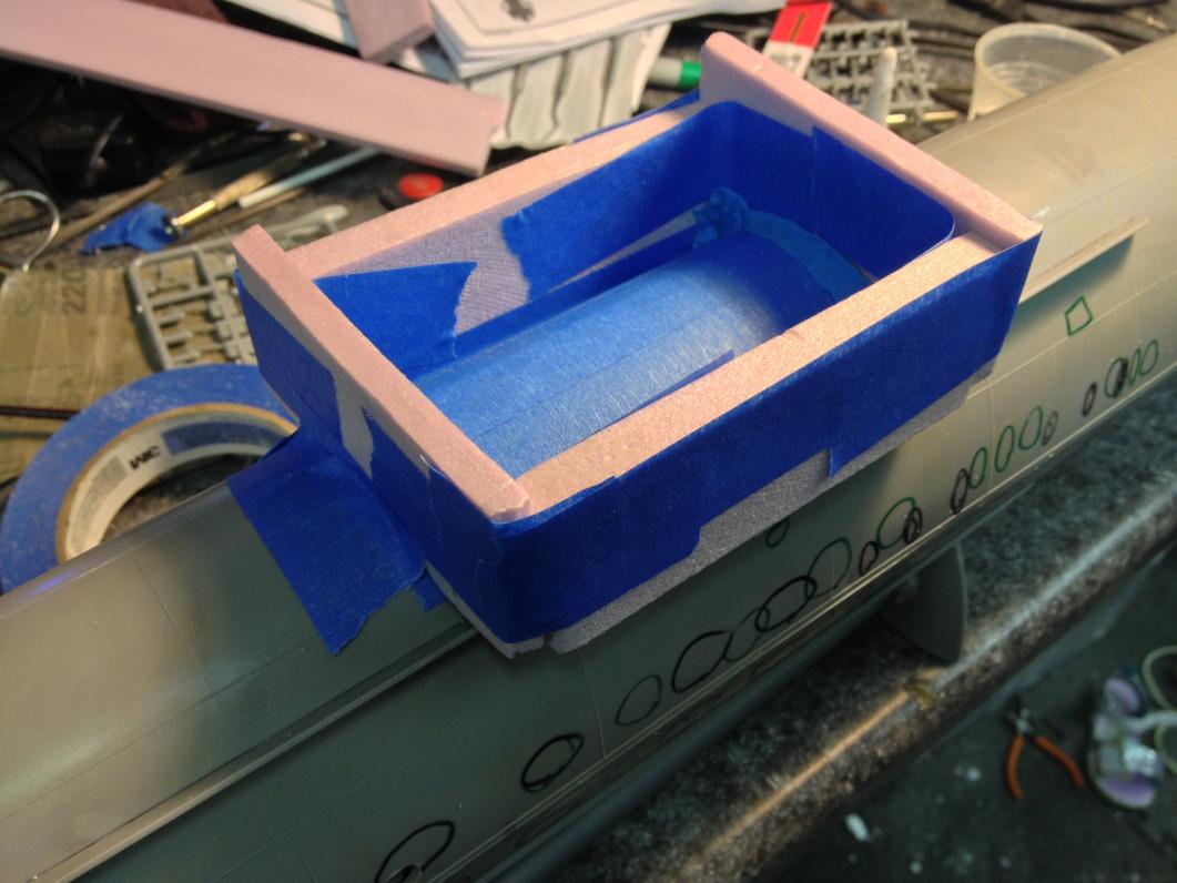

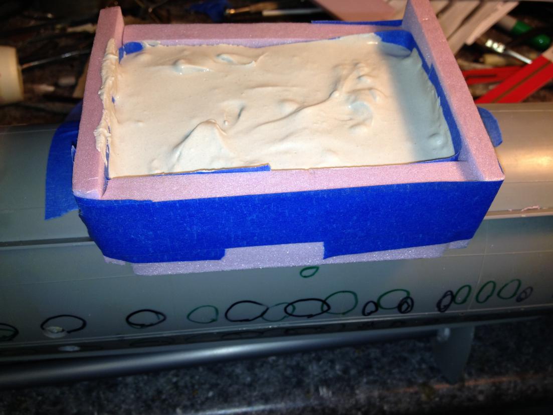

                                The railings are strung already and should they not survive, I'll rebuild I guess. As a side note, my 3yr old tried climbing onto my lap as I had a needle in one hand and CA in the other while stringing the rails. She grabbed the railing and pulled the whole thing to the ground. Expecting the worst, I found no damage. I've since primed the deck and have a few spots to touch up, but I'm happy with it.

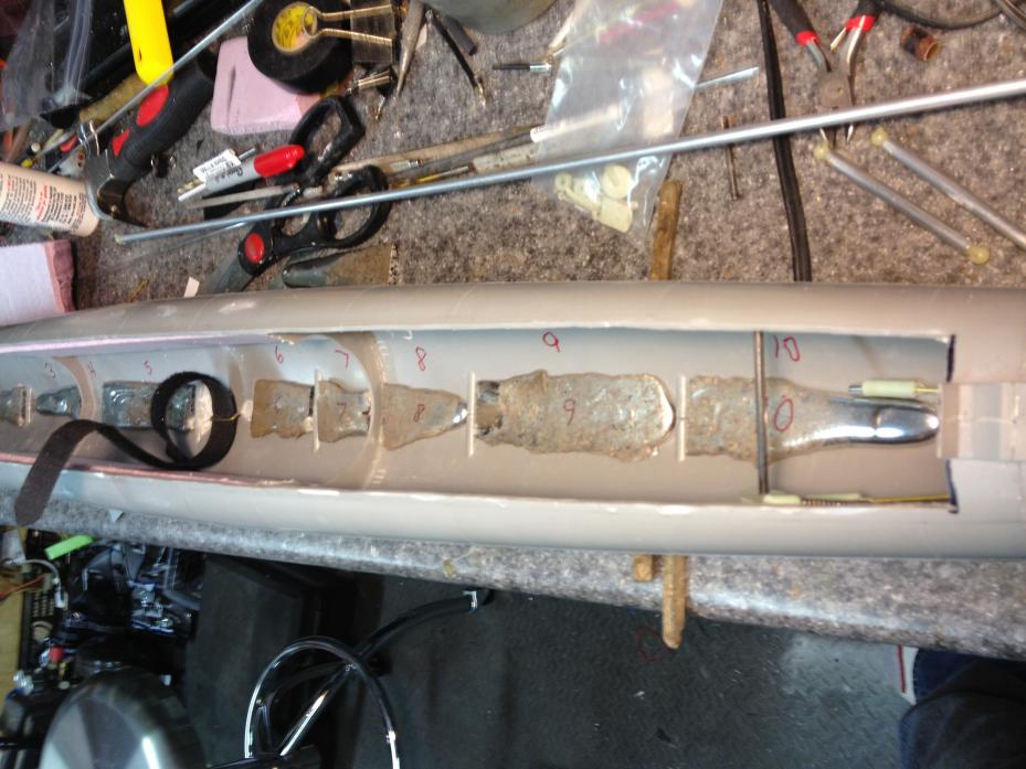

                                Now I'm onto getting the foam tucked tight into the sides of the hull. My approach is in the pics of making the sanding form. Don't mind the kid like drawings on the bottom , they mean nothing.
