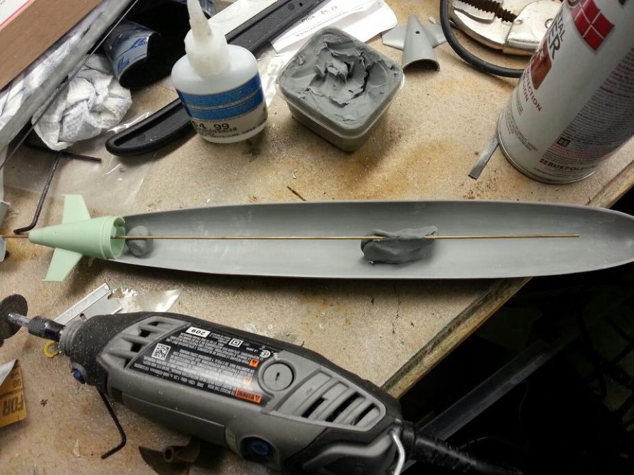

              well started sawing away at the sub today heres a pic of the progress.Click image for larger version

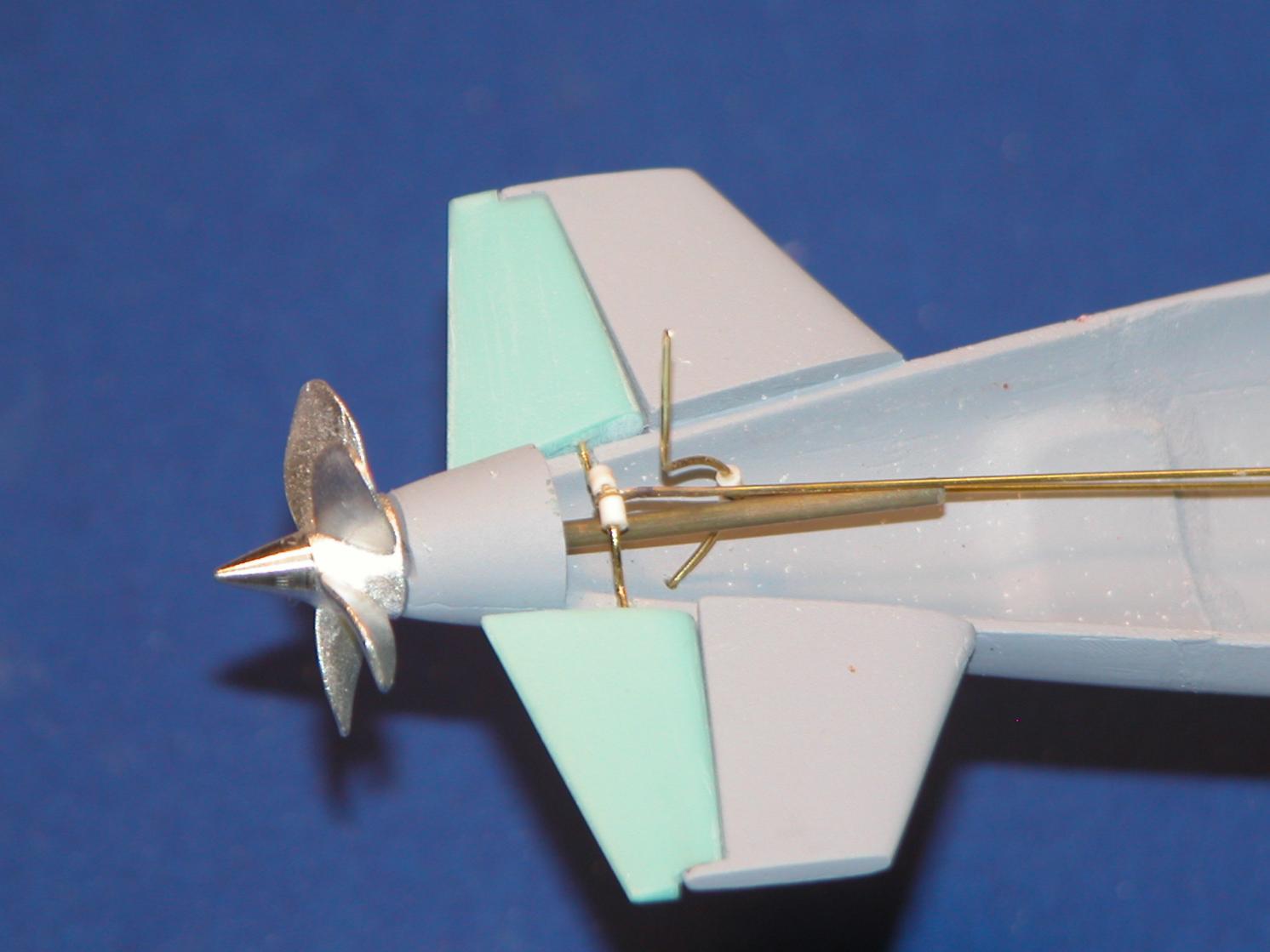

                well got the top hull all fitted to the rear one question what do I use to glue the rudders on the rear to the push rods? I would think it needs to be something where I can get them off if I need to service that area. I am thinking RTV but I am not sure. I would like to have it roughly together by Tuesday so I can take it for a static display one of the local clubs is putting on. David I am hoping to get a few dirty looks lol.

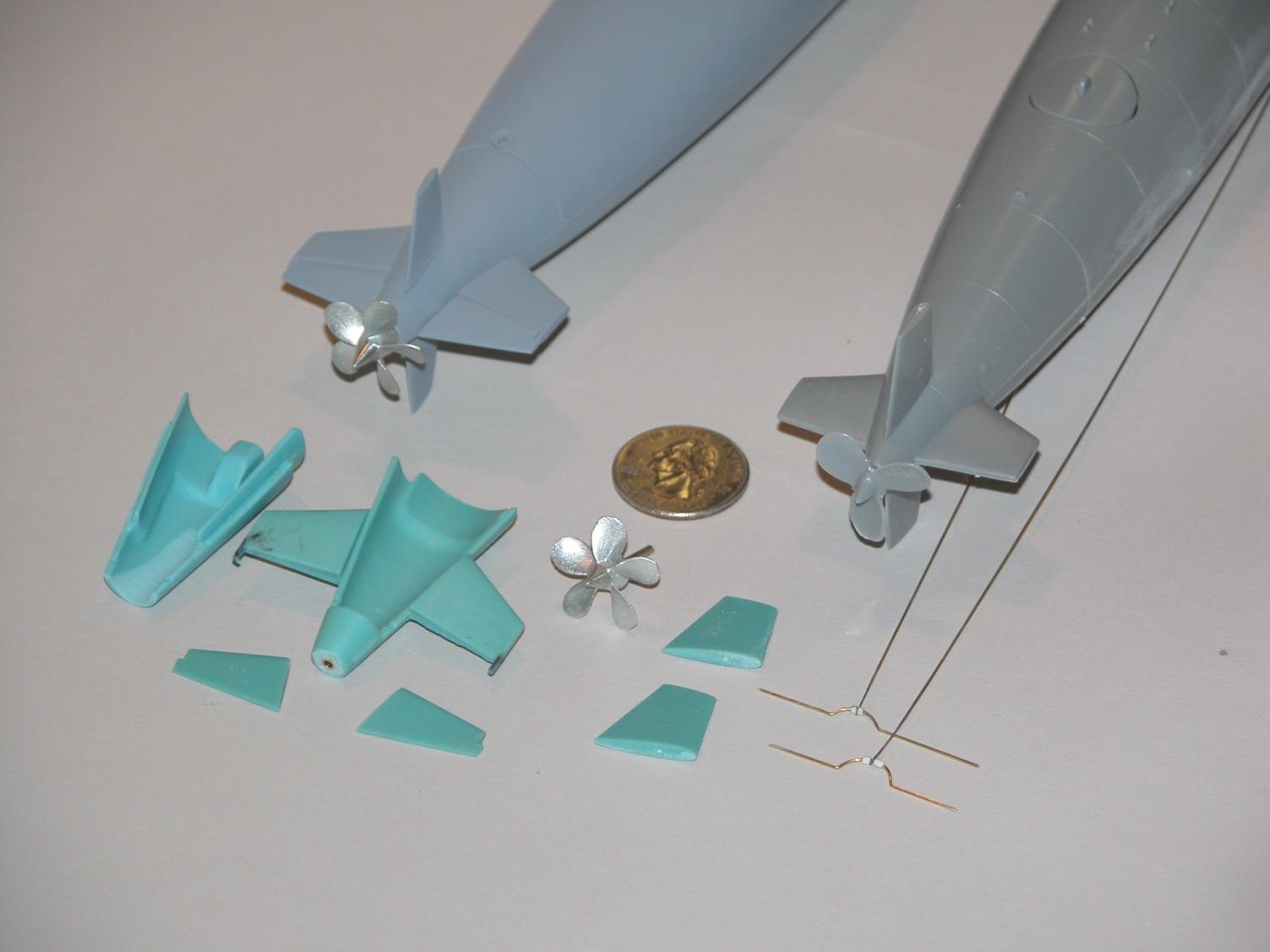

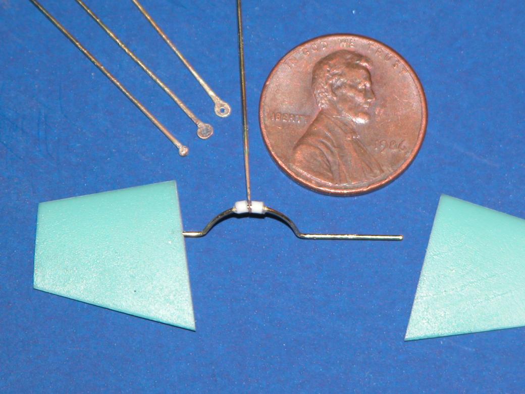

                  Dirty looks are always good.

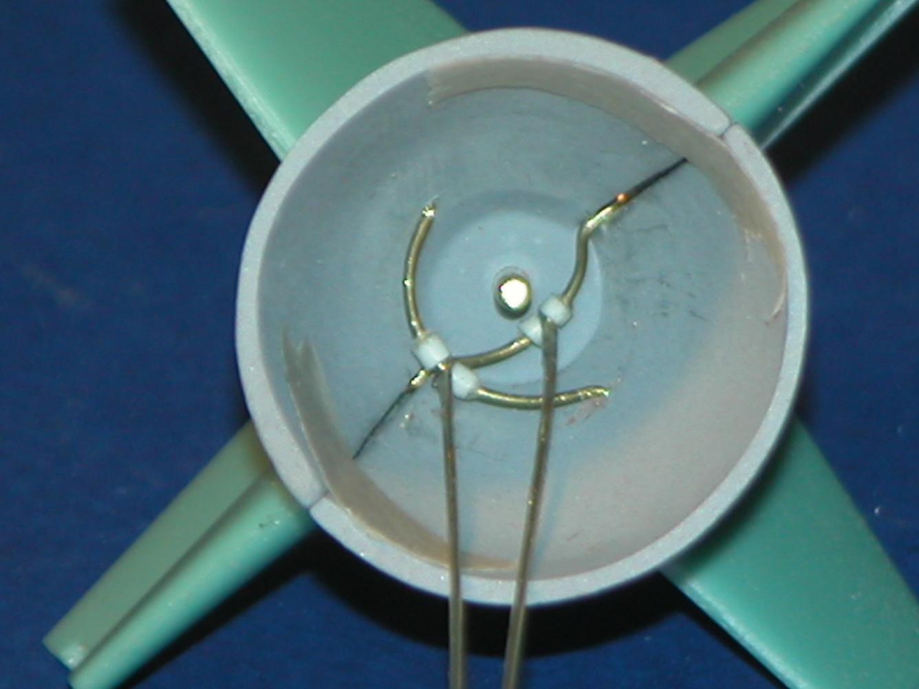

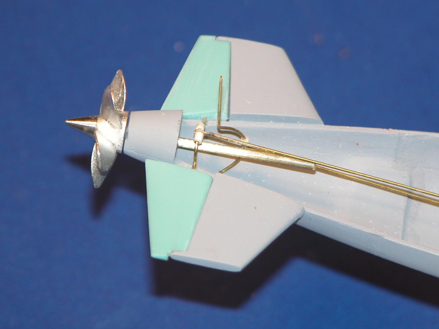

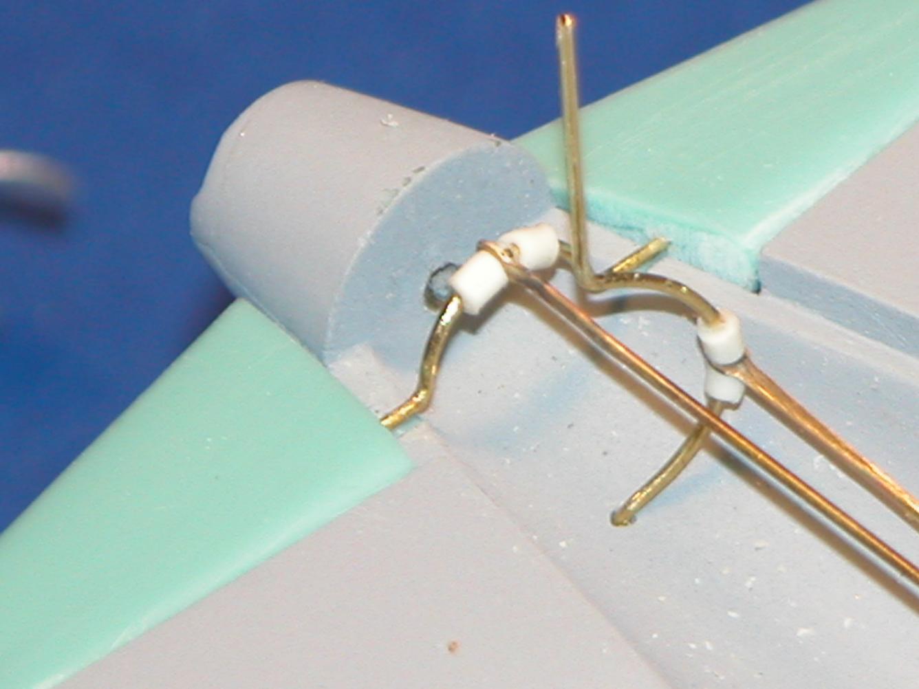

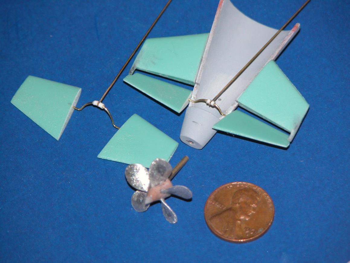

                  Don't glue the .014" brass operating shafts to their respective control surfaces. You bend a slight 'chink' into the brass wire that will cause the wire to stay in the little bore hole within the control surface. This is enough to hold the shaft and control surface together for most of the torque forces they will be subject too. But, with a very little effort you can pull the control surfaces away from their operating shafts for adjustment or repair.

                      started to mess with the boat and not sure about where the kink should go should I put a small v in the middle of the control rod or at the end like a hook? I am probably overthinking this but don't want to mess up the delicate parts.
                        • 14014
                        In the middle of the bore.
