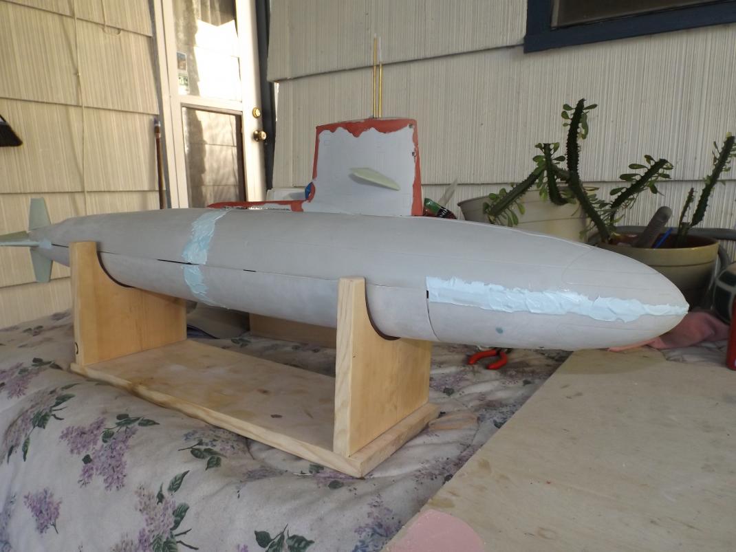

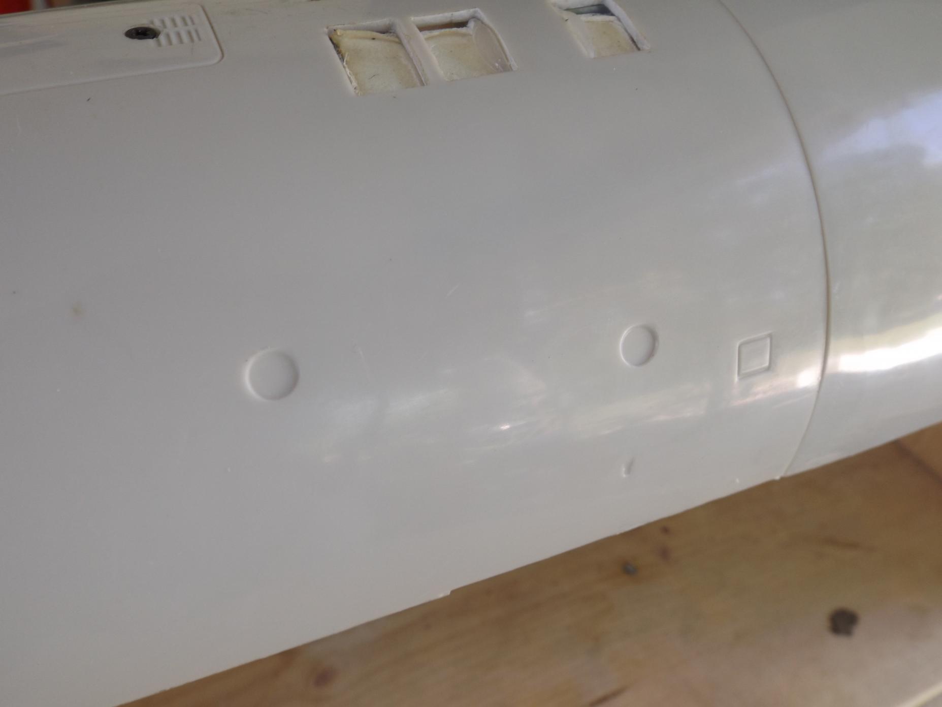

                    As for the painting of this fellow, Im just now started hitting the seams with filler and giving the whole thing a rub down with sandpaper. What are these round dimples in the hull? Should I drill them out or fill them in? Your comments please.Click image for larger version

                      #535
                      Auxiliary and AC suction-discharges. Open 'em up, Mark.

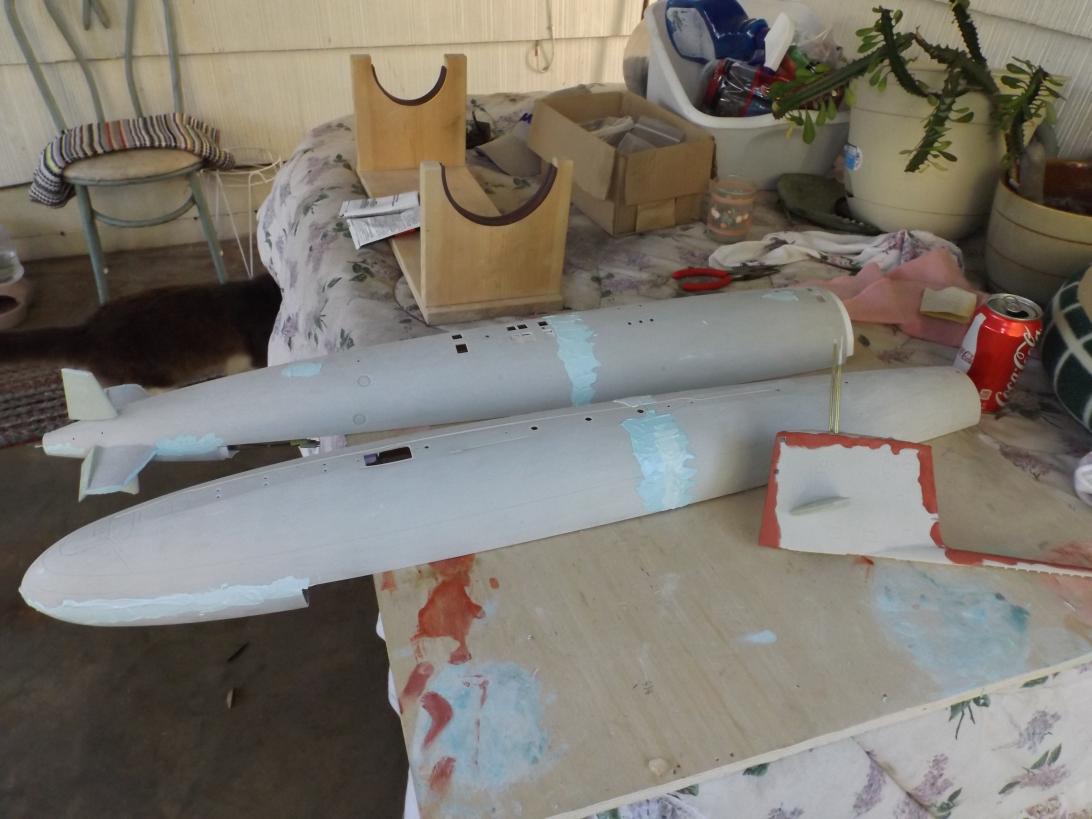

                          Anybody recognize it? I hit the whole thing with 220 sand paper, ill go back over it with 320 before painting. Evercoat Easysand and some off brand red spot putty.Click image for larger version

                            Could you possibly get any sloppier with the putty and filler applications??
                            Looks like you applied it all with fire-crackers!!!!
                            Next time first mask off the areas you don't want the putty/filler, then apply the putty/filler with a spatulla with some frig'n care!
                            You people!!!!!!!
                              #539
                              Now thats a good idea. Ill do that.................next time. My only excuse is that this stuff becomes unusable pretty quick, so Im trying to get it on. Ya Know. If I had more time id smooth it out more.

                                #540
                                Mark try some thinners (not a lot)in your fillers to keep your wet edge a little longer or just cut back on the hardner. But I will admit that I don't use the evercoat brand down under, but I'd assume cutting back the catalyst a bit should still work with the evercoat range. I also found with the stuff I use cutting back on the catalyst takes longer to harden but it gives me extra sanding an shaping time when I get heavy handed
