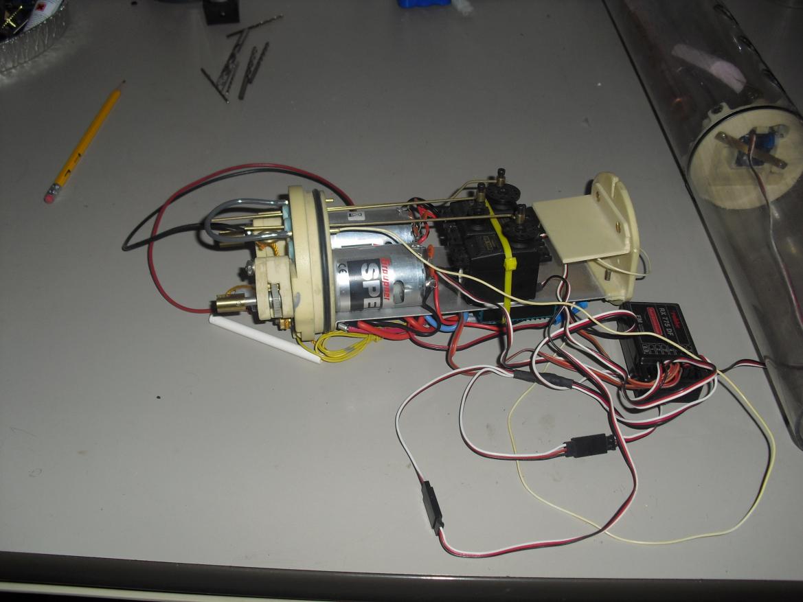

    I see that you are using 2 speed-controls???
    Are you trying to use motors for steering instead of rudder, or both?
    Do you know that you can connect the motors in parallel on a single Speed-Control?
    I have that type SC and it will handle the current of 2 of those motors with no problem.
    Man, there's a lot of wires to connect up with 2 SCs! :D

      I have a Robbe Navy F-14 Radio (6 channels installed) with the dual throttles installed, so... Why not? I should get better control at slow and reverse speeds.
      It's a static diver, with a snorkel and gas, why not finish it have dual trhottle control? I started life as an electrician... I like wires and stuff like that!
      If it was easy, anyone could do it and it wouldn't be special.

        Okay, Great, :)
        I thought you knew what you were doing but Just thought I should check.
        Those are Good sealed speed-controls. I'll drink to THAT!

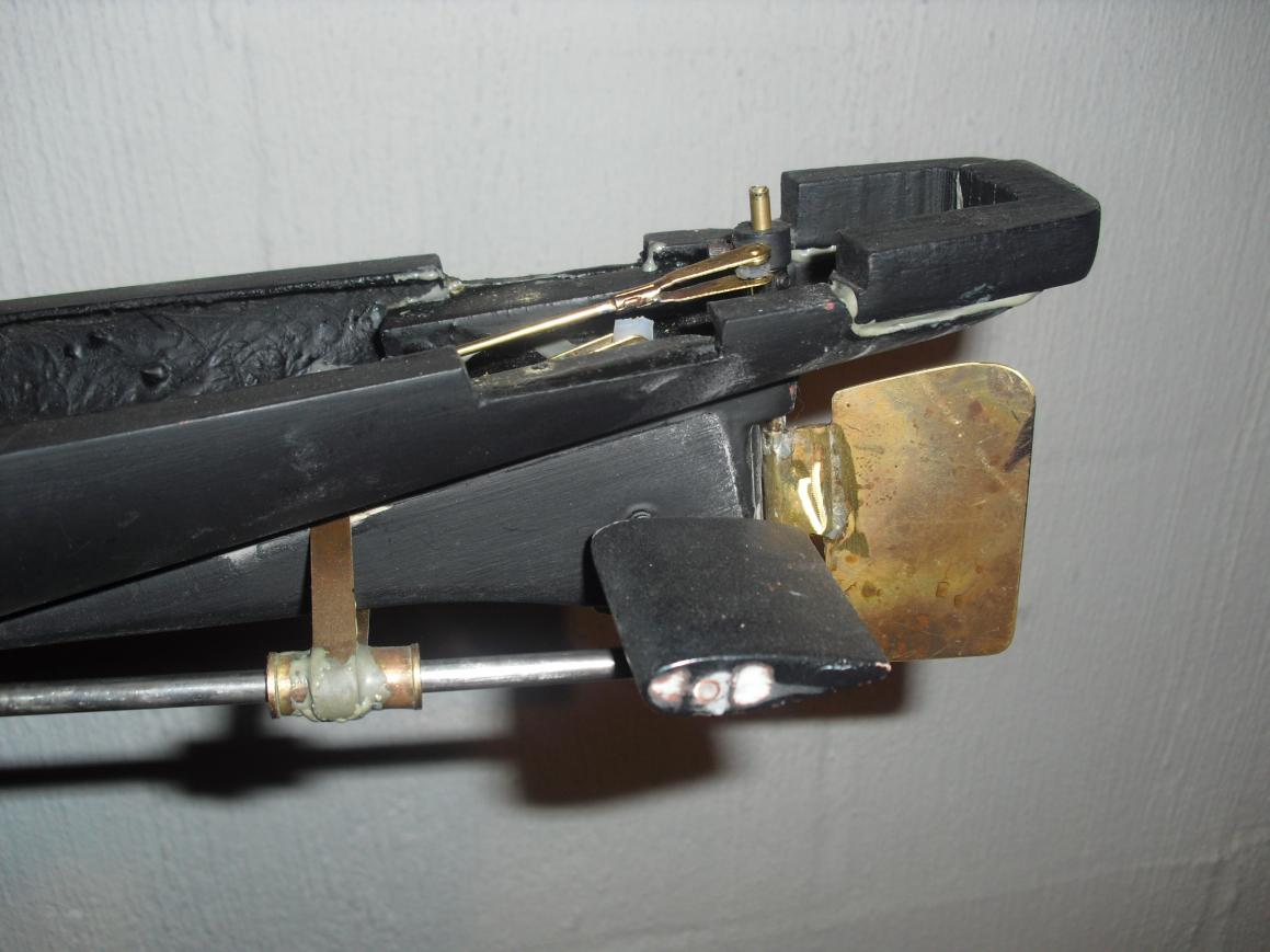

                    Well heck yes I did use enough heat. I started with a soldering gun, went to a MAPP torch and ended up with an Oxy Acetylene torch to braze the parts… It way too thin and wouldn’t stay in shape. I think it was the flat stock. The solder would stick to the tube, but just ran off the flat stock. The bearings are not soldered in. I cut a small groove into them and pressed the tube into the grove. They lined up well and the shaft rotates freely.

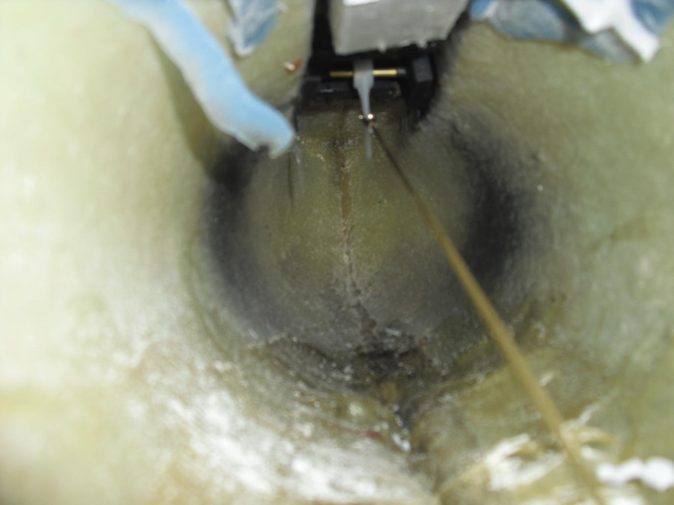

                      In late Feb the sub hull had an major accident and was knocked off the workbench in the garage. It split the hull and damaged all the planes on the port side as well as destroying the rudder. I had to re-glass the hull and make all new planes and a rudder. It all came out pretty well.
                      The Sub Driver is almost complete and the shaft struts, planes and rudder are installed. Now it's time to fit the SubDriver in the hull and hook everything up. It will have functioning forward planes too!!

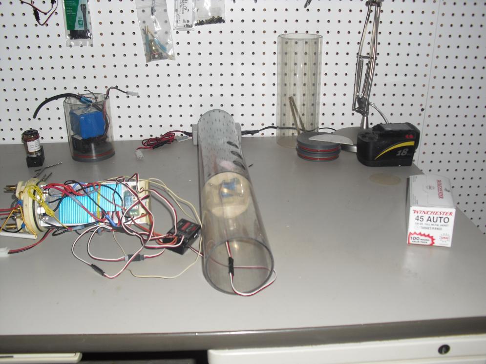

                        Here are a shot of the Robbe U-47 that is coming.
                        A Red lead bottom? What was he thinking???!!
                          • 14012
                          Unfortunately, if I remember right, the cylinder of that kit is a vital structural element, the armature in fact, off of which all the hull frames and other foundation pieces are glued. Sorry, pal, you're stuck with that tube as your water tight space.

                            Bummer,
                            Guess it's an Engle tank or I will see if I can figure out a modified snort/gas/balast tank type of system. If all else fails, it stays a dynamic diver
                              • 14012
                              The kit supplied direct-drive motors were awful. Go with two geared 380-400's. Use about 3000mAh of Lithium-polymer battery and you'll have plenty of room for an inside hard tank so you can make it a static diver.
