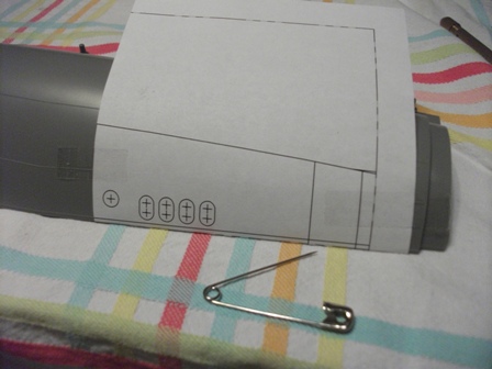

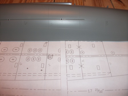

    Marked the numbers on the hull to correspond to the drawings for the floodholes.
    Cut the drawings along the lines that is numbered to the lines on the bottom of the hull, folded it in halve and taped it in place.
    Took the safety pin and used it to mark the two center points of the elongated floodholes.

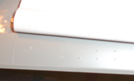

    With the paper folded back you can see the pin prick marks. I used a pin vise with a small drill and made
    pilot holes on these marks. I used a 1/4" pilot point drill bit to follow the pilot holes. Cleaned the holes I
    made with a rat tail file. This works OK but I am still trying to make it easier. I have completed about twelve
    holes on one side.
