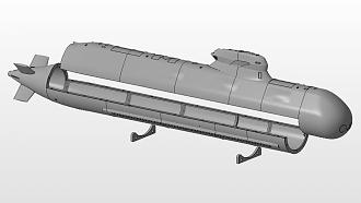

    I made a modification to the bow. Split the bow so I could throw a screw up from underneath, but I have made another change to the aft end that (I will post later) I may not need to fasten the front down.

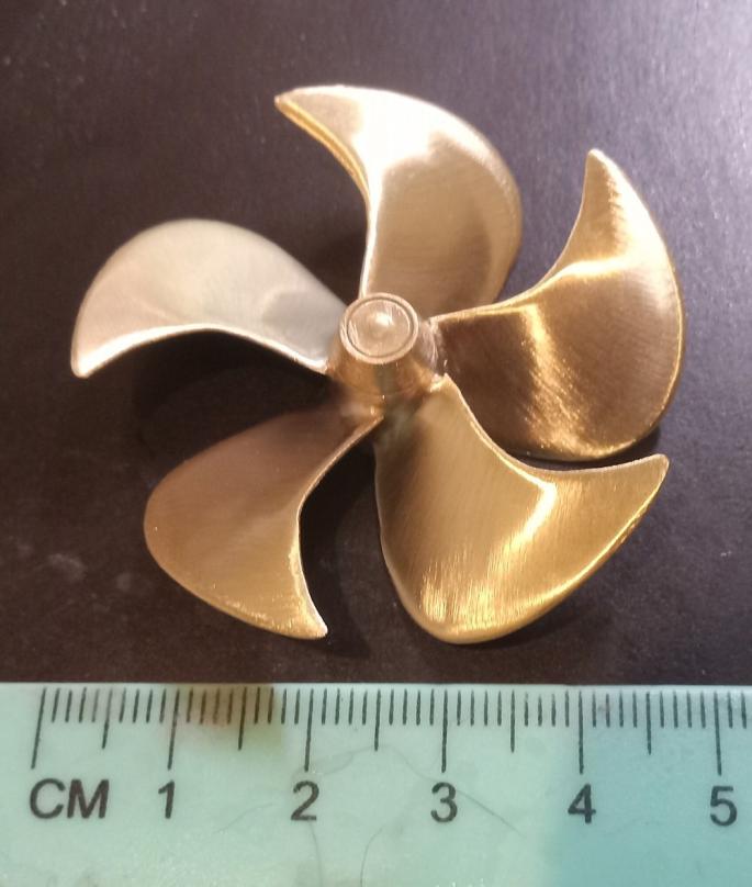

    Using my 3D Walrus Propellor (I never used it because I had a brass prop made) and modified it for this sub. It has chunky blades and I do not mind. I am not sure of the performance as this was one of my first props I made in Fusion 360.
Name:	A26 Propellor.png

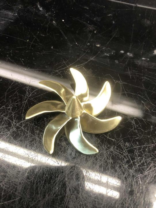

    If you aren't happy with your prop planned for your A-26, may I suggest an excellent source for high-quality timely model sub props Mr. Keith Bender. Here is the Améthyste SSN prop Keith made for me in a only two weeks! My old English source for props I have had to sadly forsake, because they don't even reply to my emails in 2 weeks (if ever!)
    Click image for larger version  Name:	be.jpg Views:	0 Size:	51.9 KB ID:	198173
    Below is a Los Angeles class Flight 1 prop made by Keith bender made for good friend Jeff Apps new USS Dallas.
    Click image for larger version  Name:	IMG3154933241189194123_311923663439030.jpg Views:	0 Size:	68.1 KB ID:	198174

      Since we are talking about my Walrus, it sports a Keith Bender prop! I have had a couple of props done by him. This sub may have one too in the future.

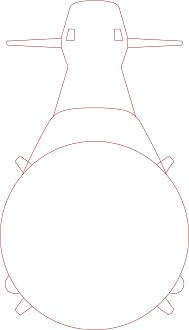

          My A-26 STL files are in 1/48. Here are two images of files composited together of the cool distinctive sail shape. Sweden Navy has ordered two. Polish Navy has ordered three subs. SAAB re bought Kockums back from ThyssenKrupp of Germany in 2015, and is again independent and Swdish.
          I am not building a A-26 at present but may sometime in the future. Focusing now on my French models, assisting what I can in Marimans CB sub model and in the near future an American 1st generation SSN in 1/48. That's enough for this lifetime to me.
          Click image for larger version  Name:	A 26  sail.jpg Views:	0 Size:	77.7 KB ID:	198181

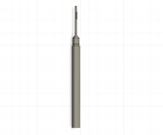

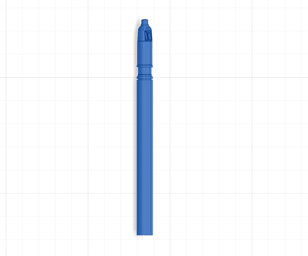

            This is a roomy sub. As it is, I am installing a 3.5" WTC taking my cylinder out of the Alpha to use for this sub.
            There are some additional pieces I made for this build, the scopes. How they will be arranged or even exactly what will be used is not certain.

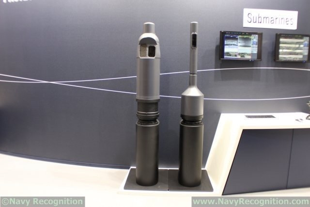

            There was an article saying a manufacturer got the contract and these scopes are what they manufacture.
            I am sure much of what is going on and in this sub is classified, so all I can do is use the images they supply and imagination to make mine semi-accurate.
            From what I can see, these scopes (radar, optronic scopes) are in an inline arrangement. U.S. subs seem to set up scopes side by side or in pairs, that does not seem to be in this design.

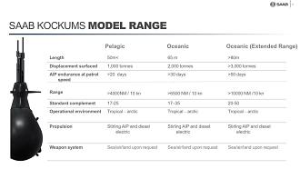

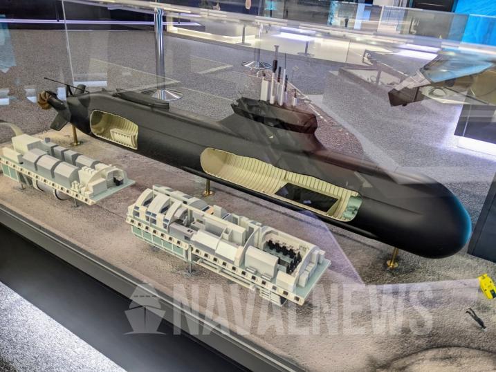

              What do we know about the A26?
              AI says:
              The Saab A26 (Blekinge-class) is the world's first fifth-generation conventional attack submarine, designed and built by Saab Kockums for the Royal Swedish Navy and Poland. [1, 2, 3, 4]
              Key Specifications
              • Displacement: 1,925 tonnes surfaced; 2,100 tonnes submerged
              • Dimensions: Length of 66.1 meters and a beam of 6.75 meters
              • Complement: 17 to 26 crew members (up to 35 with special forces)
              • Propulsion: 1 shaft, Stirling air-independent propulsion (AIP) engines (4x Kockums MkV V4-275R), and 2 diesel engines
              • Speed & Endurance: Over 18 days submerged using AIP; top submerged speed of around 20 knots
              • Armament: 4x 533 mm torpedo tubes, 2x 400 mm torpedo tubes, naval mines, and JSM-SL anti-ship/land-strike missiles [1, 2]
              Core Capabilities & Features
              • Stealth & "Ghost" Technology: Features a low-observable hull design, distributed raft-mounted machinery, and signature management to reduce acoustic, magnetic, pressure, and infrared signatures.[1]
              • Multi-Mission Portal (MMP): A 1.5-meter-diameter, 7-meter-long bow lock-out system that allows for the launch and recovery of uncrewed underwater vehicles (UUVs), remotely operated vehicles (ROVs), and special forces divers. [1]
              • Seabed Warfare: Built to operate quietly in shallow, acoustically complex waters like the Baltic Sea, monitor critical undersea infrastructure (such as pipelines and cables), and conduct intelligence and surveillance missions. [1, 2, 3]
              Operators and Program Timeline
              • Swedish Navy: Two units (HSwMS Blekinge and HSwMS Skĺne) are under construction at Saab Kockums in Karlskrona, with deliveries scheduled starting around 2031. [1, 2]
              • Polish Navy: Under the Orka program, Poland ordered three A26-type submarines in a major defense agreement valued at approximately SEK 47 billion, with deliveries planned between 2031 and 2038. [1, 2, 3]
              Images are scarce or repeated.

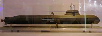

              Here is what I have:
              Click image for larger version  Name:	A26 Swedish Orka - 1 of 33.jpg Views:	0 Size:	34.1 KB ID:	198318 Click image for larger version  Name:	A26 Swedish Orka - 2 of 33.jpg Views:	0 Size:	93.2 KB ID:	198319 Click image for larger version  Name:	A26 Swedish Orka - 3 of 33.jpg Views:	0 Size:	22.9 KB ID:	198320 Click image for larger version  Name:	A26 Swedish Orka - 4 of 33.jpg Views:	0 Size:	22.6 KB ID:	198321 Click image for larger version  Name:	A26 Swedish Orka - 5 of 33.jpg Views:	0 Size:	96.8 KB ID:	198322 Click image for larger version  Name:	A26 Swedish Orka - 6 of 33.jpg Views:	0 Size:	51.2 KB ID:	198323 Click image for larger version  Name:	A26 Swedish Orka - 7 of 33.jpg Views:	0 Size:	62.5 KB ID:	198324 Click image for larger version  Name:	A26 Swedish Orka - 11 of 33.jpg Views:	0 Size:	74.4 KB ID:	198326 Click image for larger version  Name:	A26 Swedish Orka - 12 of 33.jpg Views:	0 Size:	75.5 KB ID:	198327 Click image for larger version  Name:	A26 Swedish Orka - 13 of 33.jpg Views:	0 Size:	78.3 KB ID:	198328 Click image for larger version  Name:	A26 Swedish Orka - 15 of 33.jpg Views:	0 Size:	33.8 KB ID:	198329 Click image for larger version  Name:	A26 Swedish Orka - 16 of 33.jpg Views:	0 Size:	64.7 KB ID:	198330 Click image for larger version  Name:	A26 Swedish Orka - 17 of 33.jpg Views:	0 Size:	71.4 KB ID:	198331 Click image for larger version  Name:	A26 Swedish Orka - 26 of 33.jpg Views:	0 Size:	18.1 KB ID:	198332 Click image for larger version  Name:	A26 Swedish Orka - 28 of 33.jpg Views:	0 Size:	34.3 KB ID:	198333 Click image for larger version  Name:	A26 Swedish Orka - 27 of 33.jpg Views:	0 Size:	15.9 KB ID:	198334 Click image for larger version  Name:	A26 Swedish Orka - 25 of 33.jpg Views:	0 Size:	72.0 KB ID:	198335 Click image for larger version  Name:	A26 Swedish Orka - 30 of 33.jpg Views:	0 Size:	57.5 KB ID:	198336 Click image for larger version  Name:	A26 Swedish Orka - 29 of 33.jpg Views:	0 Size:	80.8 KB ID:	198337 Click image for larger version  Name:	A26 Swedish Orka - 31 of 33.jpg Views:	0 Size:	72.4 KB ID:	198338 Click image for larger version  Name:	A26 Swedish Orka - 10 of 33.jpg Views:	0 Size:	81.3 KB ID:	198343

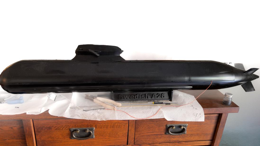

                I printed this in ABS. Other than the bow, it is straight from the files.
                sturdy and well designed. I soaked the seams with acetone and used bolts/screws to keep the sections together. I 3d printed some pegs to replace the screws and for aligning the top half with the bottom.
                • JHapprich
                  • Oct 2017
                  • 1114
                  A star trek submarine! Cool!
                  ...i need a printer..
                    • 3767
Name:	Image 10-25-26 at 7.10 PM.png
                    The outside was primed with Rustoleum Primer and then let set for several days. Re-scribed any details and used NitroStan for larger imperfections. Wet sanded the hull and 1st coat of gloss black. This made the surface O.K., not perfect, but it will work for me. When I get to final paint the surface will get another wet sanding then application of paint..
