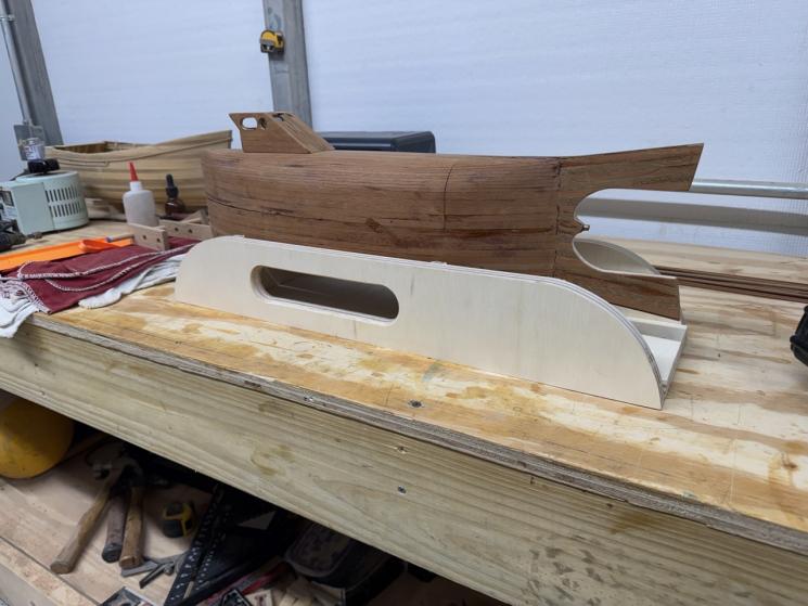

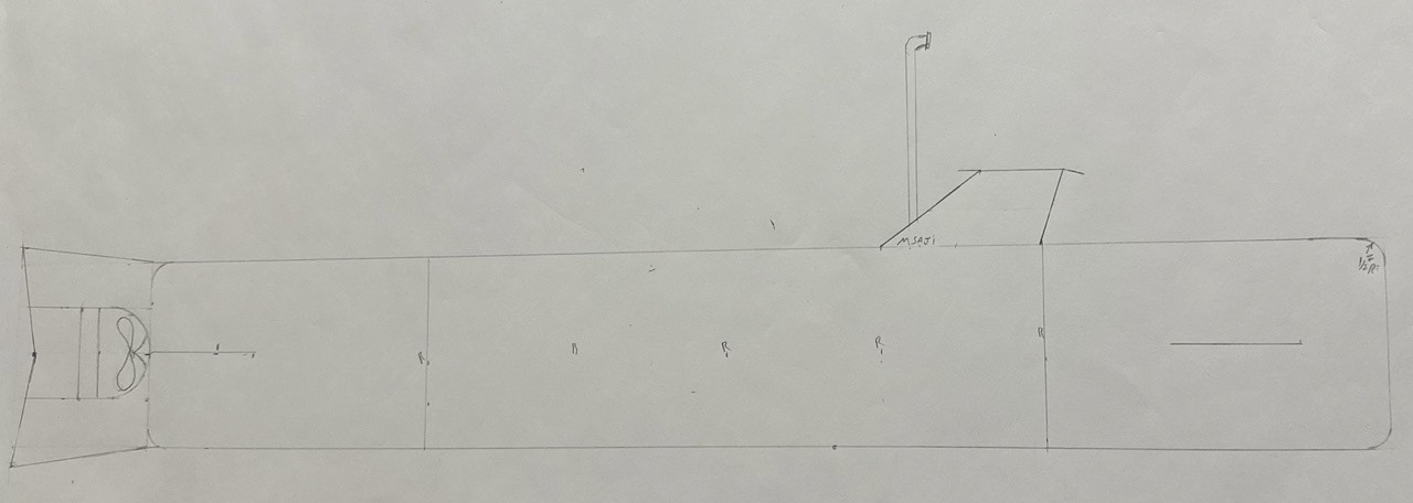

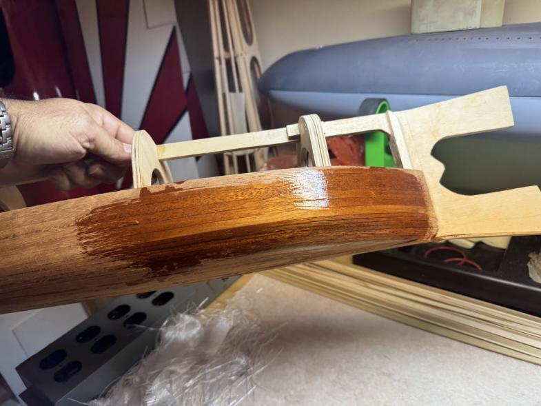

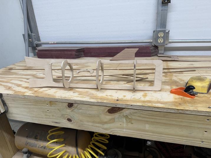

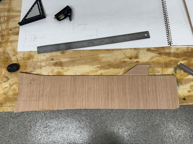

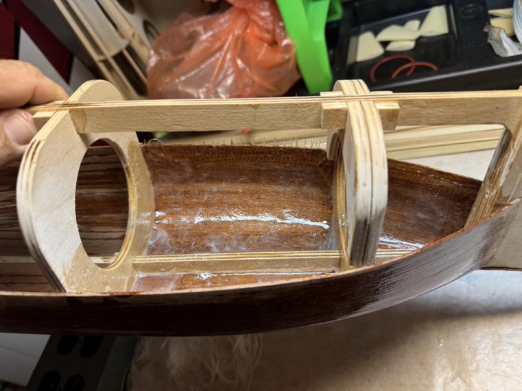

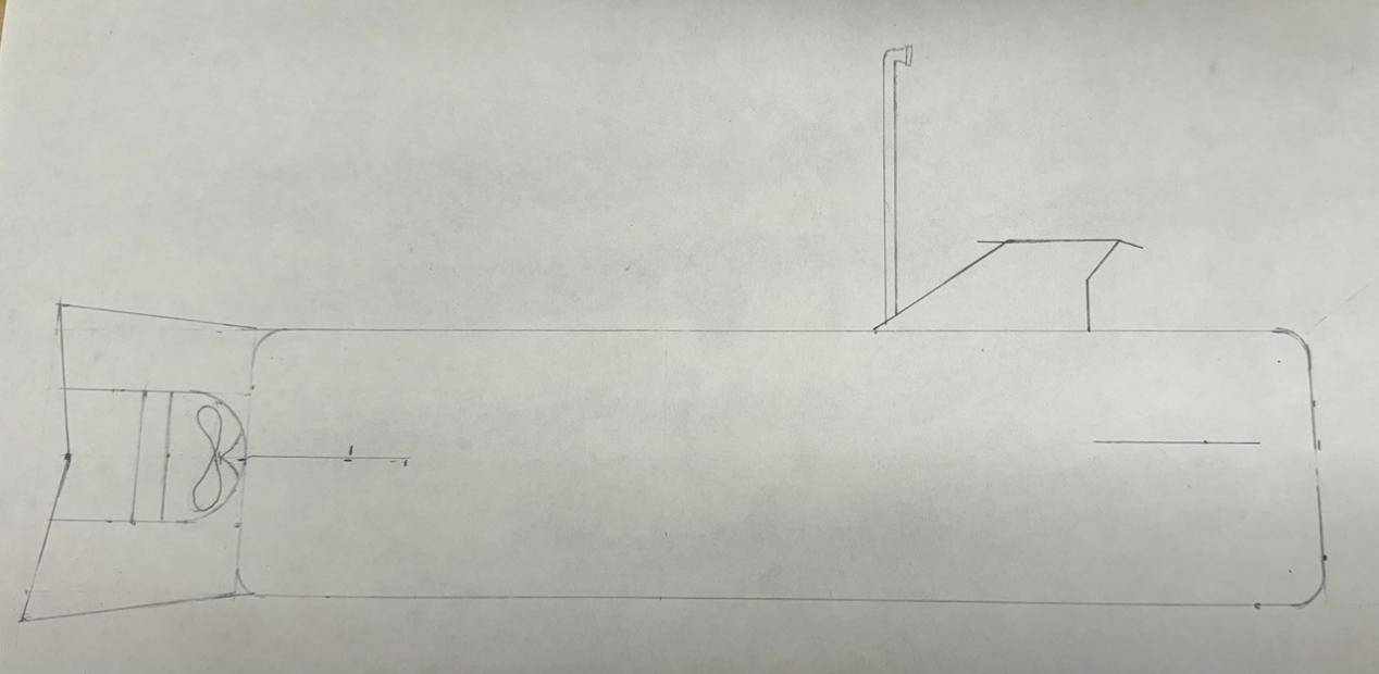

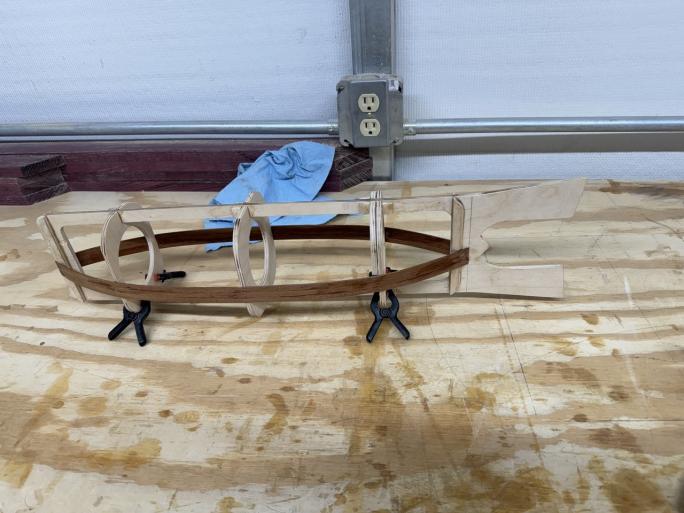

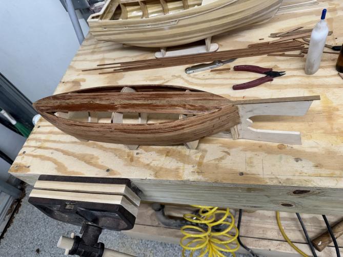

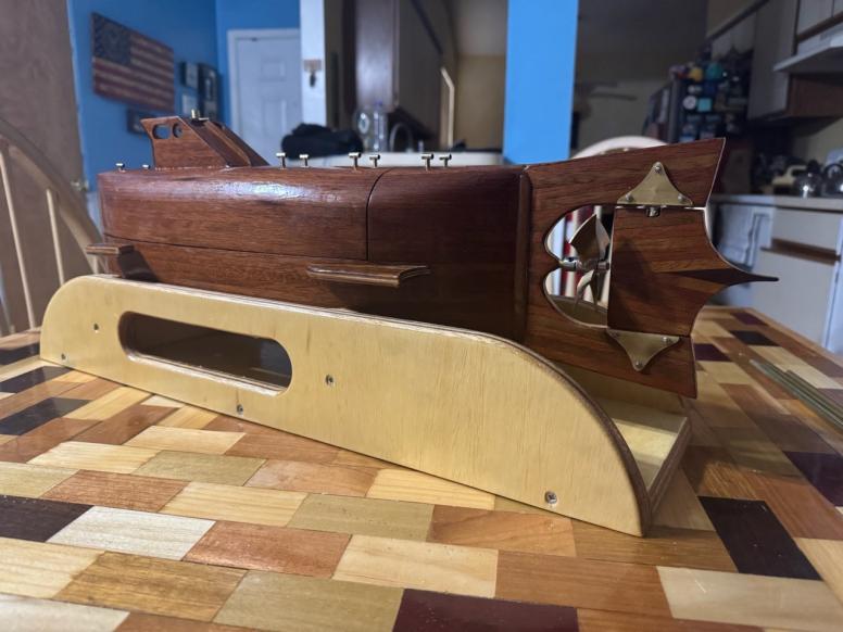

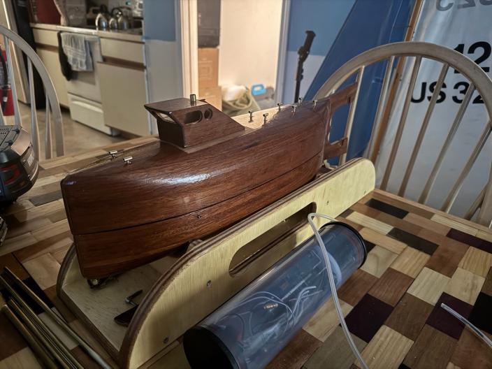

    I've been asked a couple of times to write something and post pictures of my little wooden sub, "Luck" so here goes. He was designed as a submerging tugboat, fully designed and scratch built by yours truly. I really didn't think anyone would have interest in it, but I was obviously wrong. Truly, I'm rather proud of my little sub and it is a joy to play with in the water. To start with, I started the design and build as a complete rc submarine rookie (not that I'm not now) right after I was introduced into the submarine world. We were working the estate of Warren Wilson and that is where I was fully introduced to the hobby. In working his estate, a few of us gathered his subs and get them running. I ended up with a 1/96 USS Nautilus and a Jules Verne Nautilus. In doing so, I found a slew of videos online to help with some general knowledge, and one person in particular, Bob Martin, stuck out as having the most videos readily available. One day (September 2024) watching one of Mr. Martin's videos, he mentioned that "wood is an easy material to work with but should never be used in rc submarine applications" not a direct quote but close enough. I paused the video and in about 15 minutes I finished my first iteration of what became "Luck". Within a couple of hours I had a redesign, patterns then keel and ribs cut out to start planking;"Luck" is plank on frame. I very much agree with Bob in that, any little crack, imperfection, or any exposure of the parent material to water can and will cause absolute chaos on the hull, but I knew it could be done if done right. "Luck" is 1/4" birch ply keel and ribs with Sapele planking for the majority of the hull. There are accent planks of Teak and the "stinger" on the rudder is Peruvian Walnut. Of course, Luck wasn't done for Subfest due to way job and the storm that postponed Subfest until the Redux. Having met all the guys out at Subfest, we had a wonderful time and once I got home, I got back to work on Luck's hull, hardware and driver. He Maiden'd at our local club regatta in October 2025, first launch by Ken Griffin. The complete build took me about a year. Original design was for a 36" model, but then I wanted to shorten it up to look more like a tug and also, a bit more maneuverable. I'll follow up with more on the story of the build as I post pictures as well.

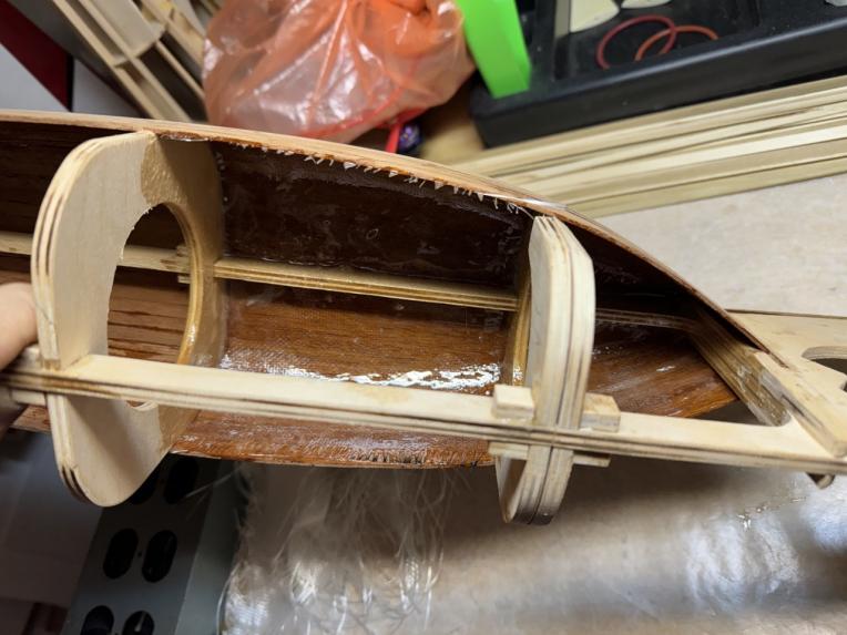

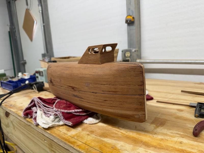

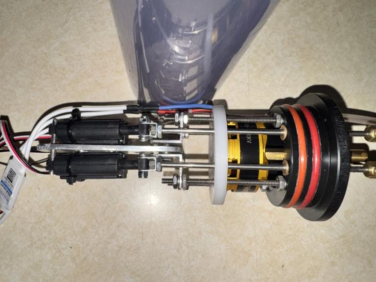

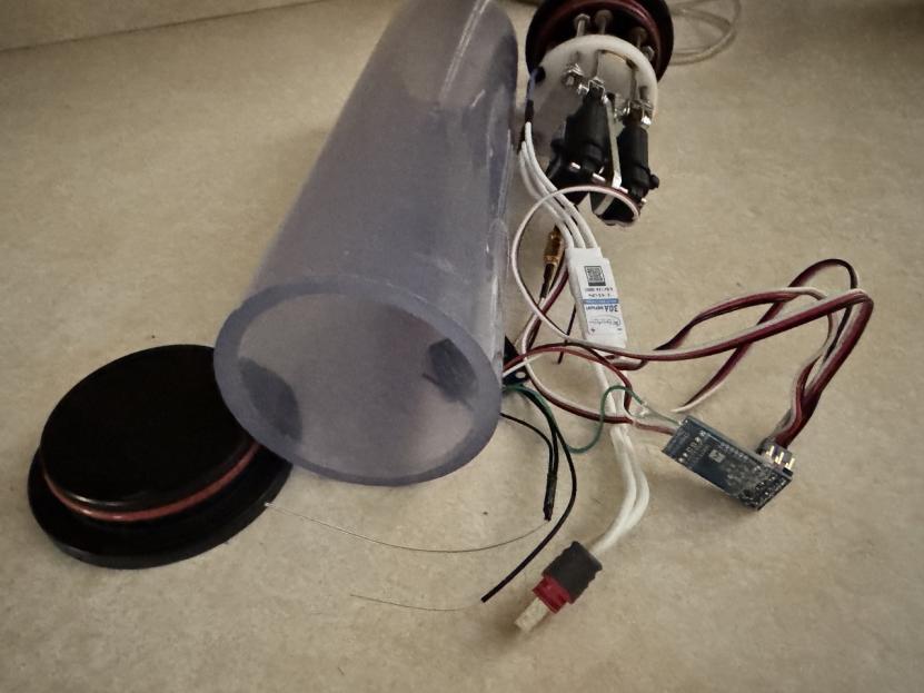

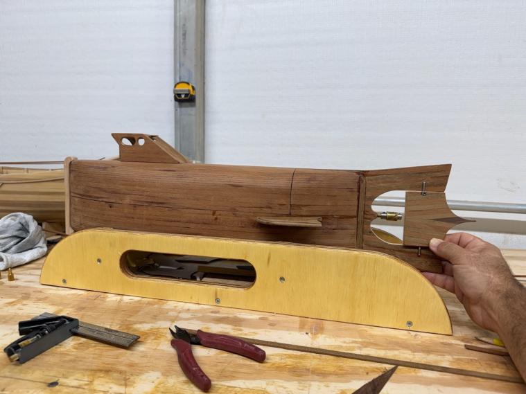

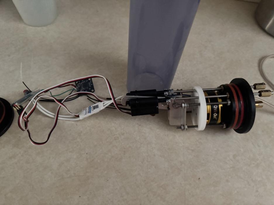

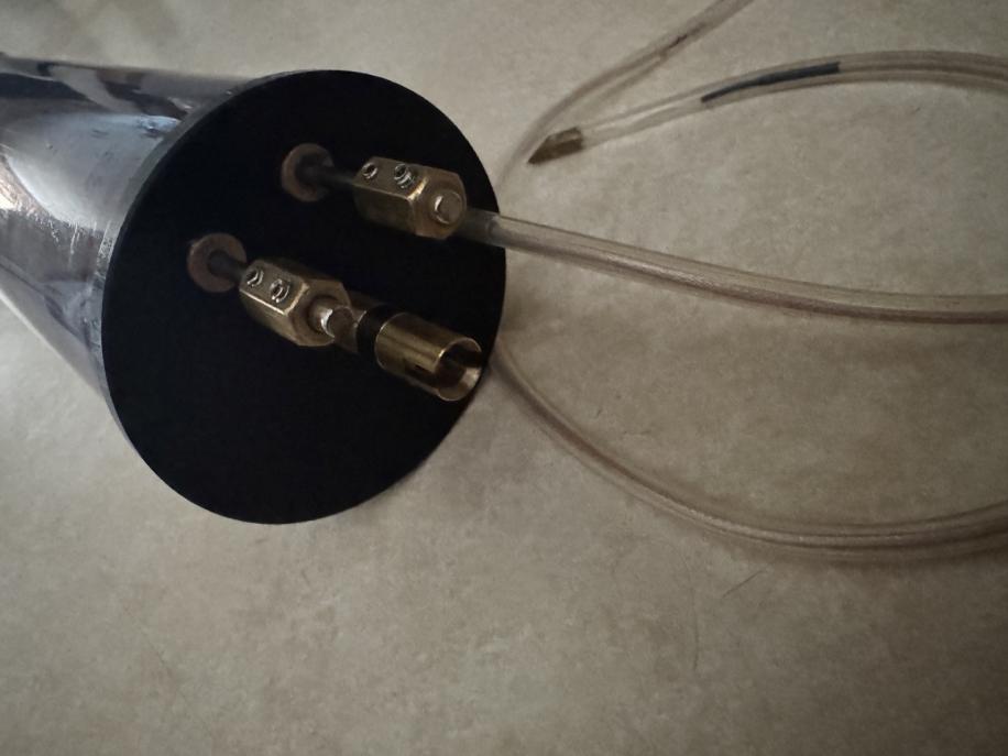

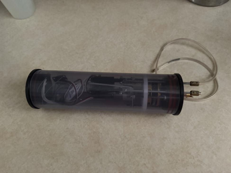

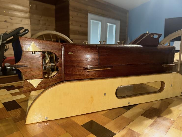

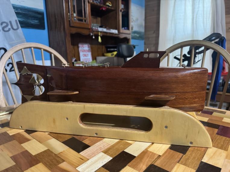

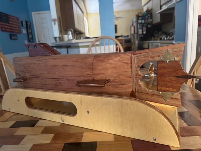

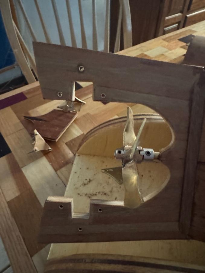

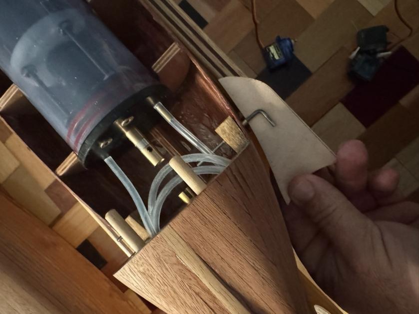

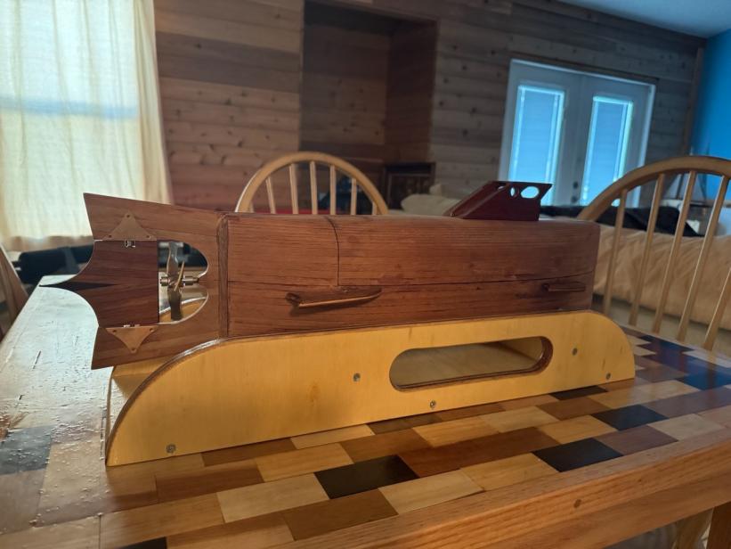

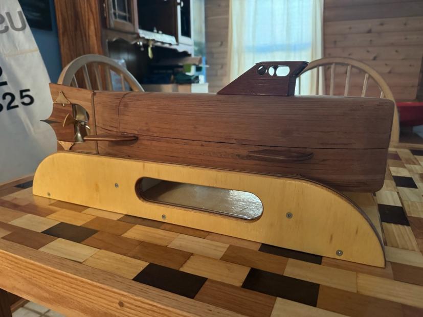

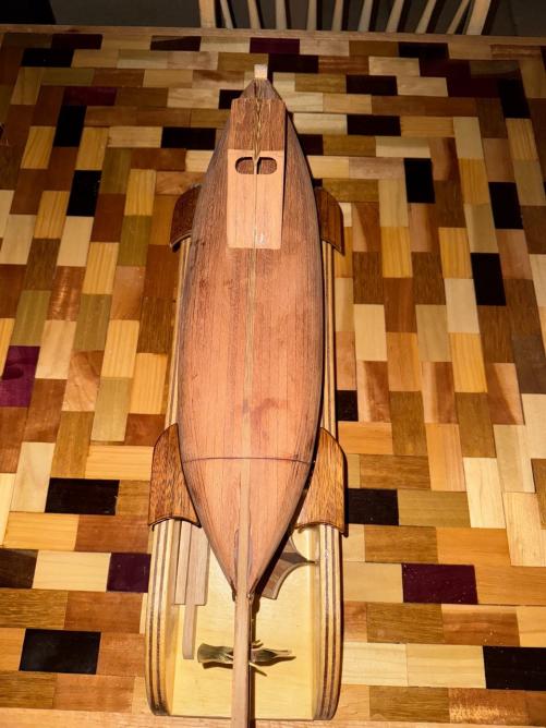

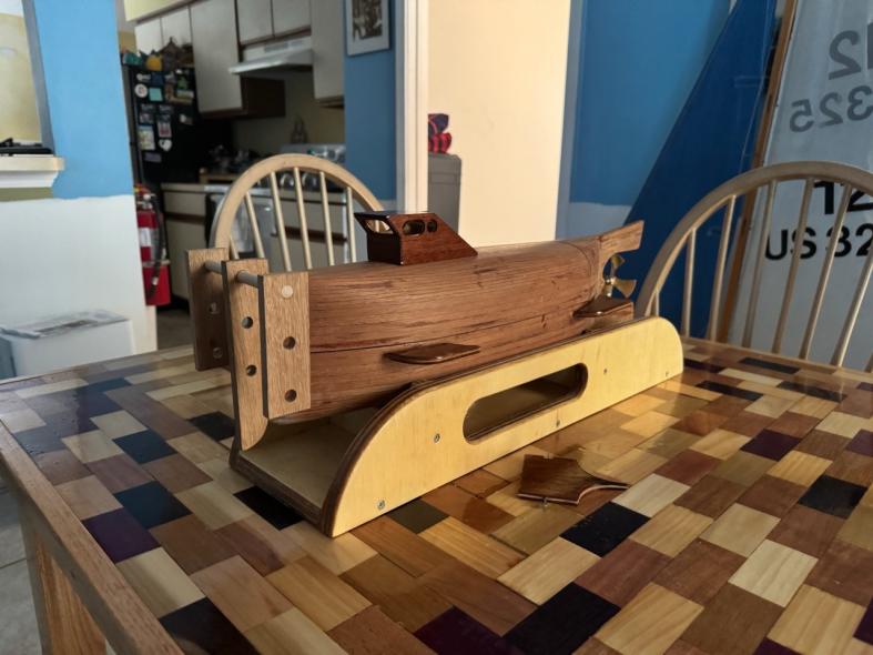

    The original ship length was reduced to 24" as mentioned in the first post, I just like it short and chubby. Gives him a better Tugboat look. the driver is 3"dia and 12" long. The "Tube" is transparent PVC and the wall thickness is probably about 3/16" or so. The original motor I used was an Mtroniks 1100KV and it worked ok, but I'm swinging a 3" prop as well and I like it to swing slow so I wanted a way slower motor, I found a 580KV motor where the can just fits in the allowable space and it runs great. The servos are actuonics linear servos, they work well, a bit slow, but I'm in no hurry. The motor has enough torque to move the prop well, even with a vessel in tow or pushing. "Luck" has made at least 8-9 recoveries so far, even without the push knees I originally put on it, but I really did not like how they looked. He earned his eagle for recoveries and he displays it on the pilot house (I'll find or get a picture of it).

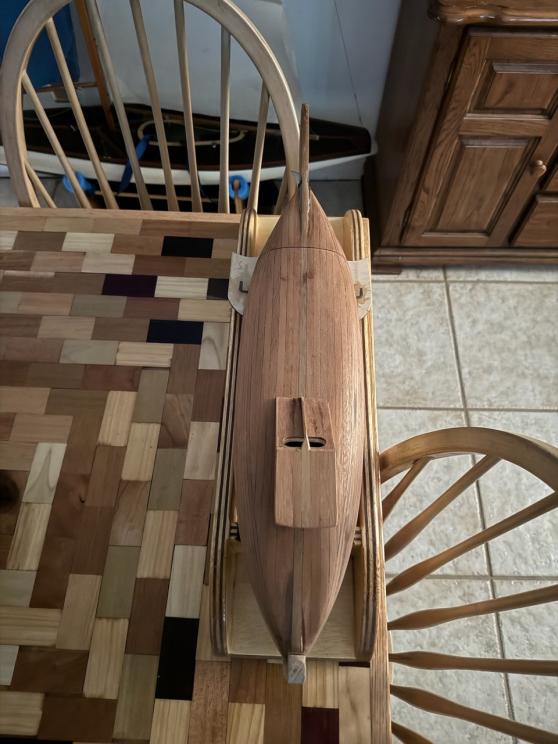

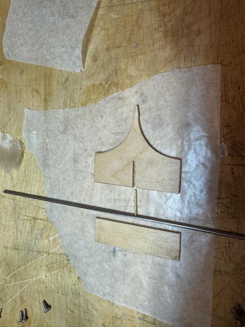

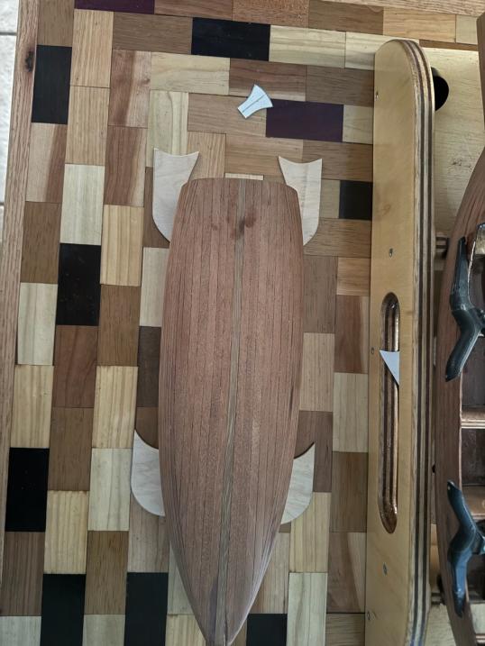

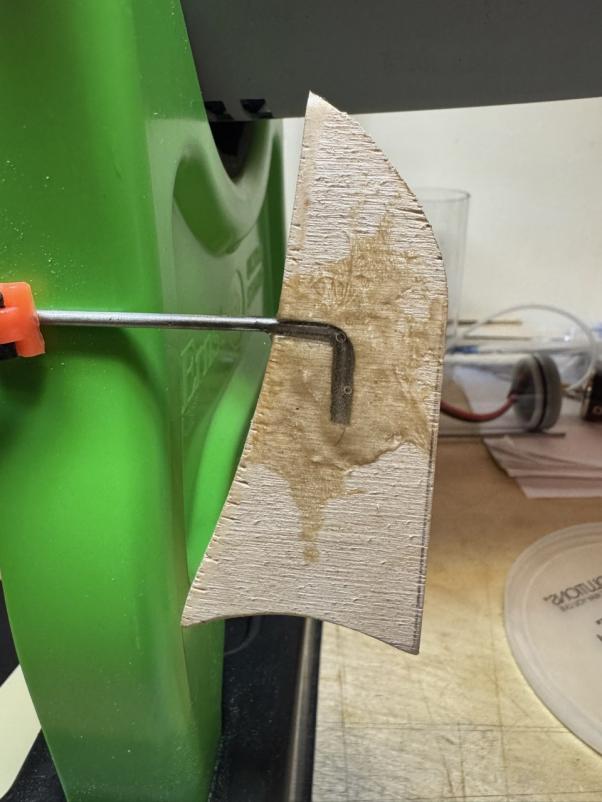

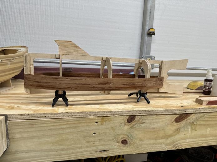

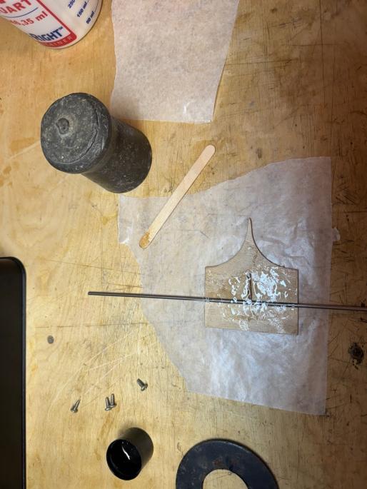

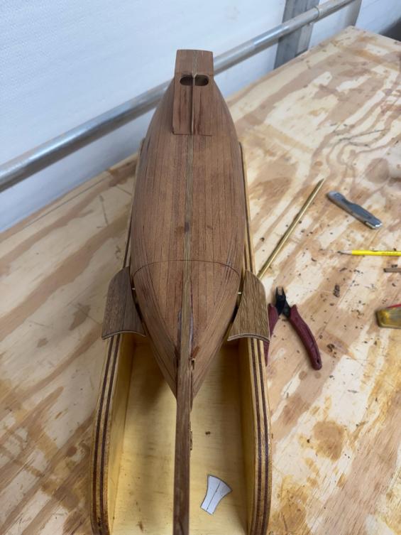

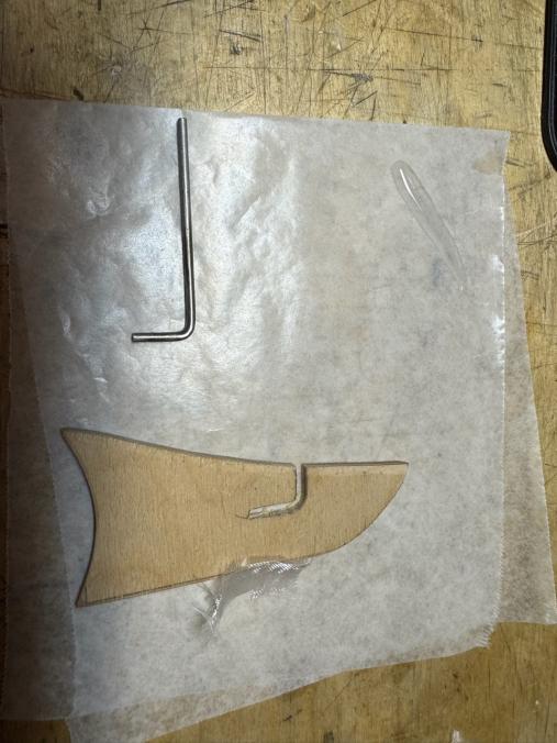

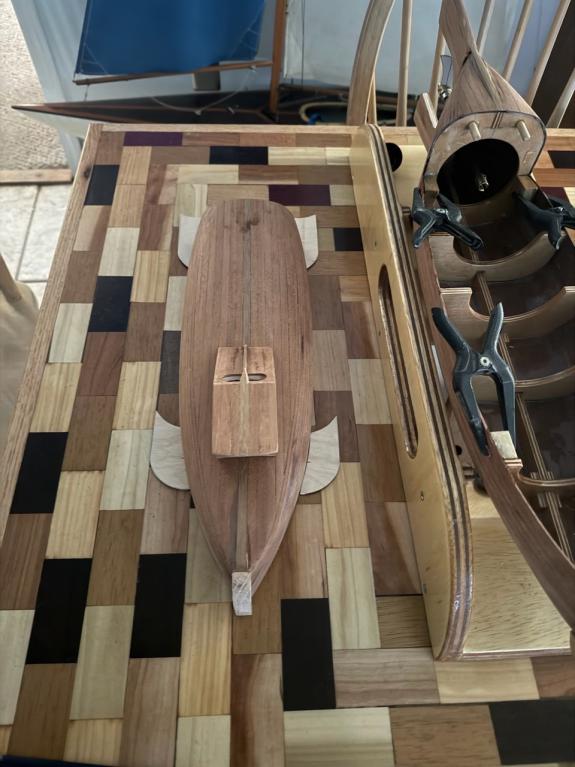

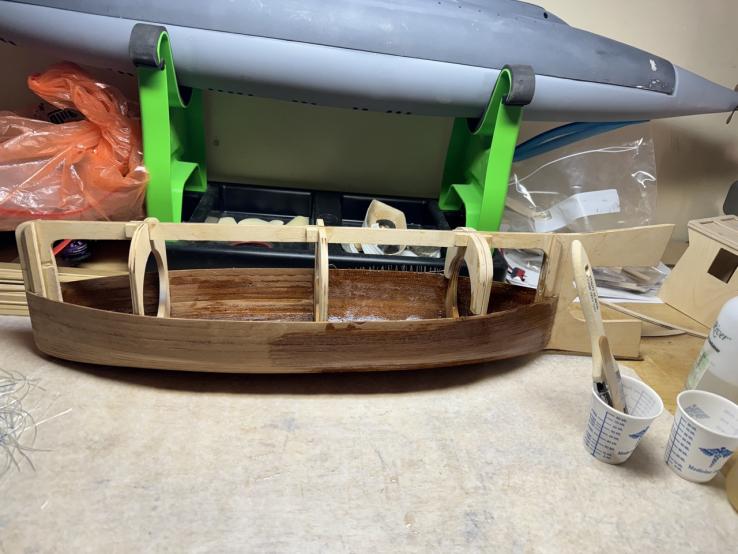

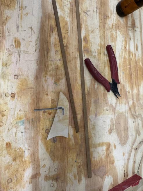

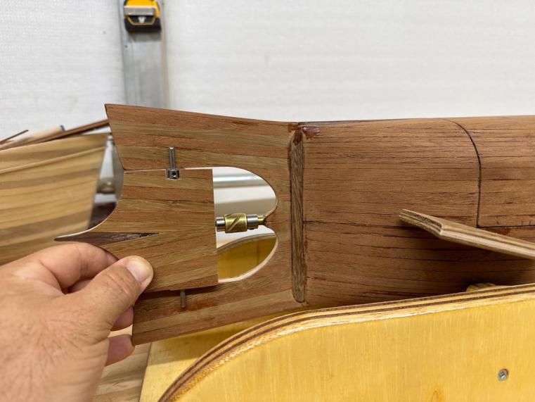

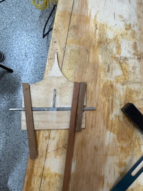

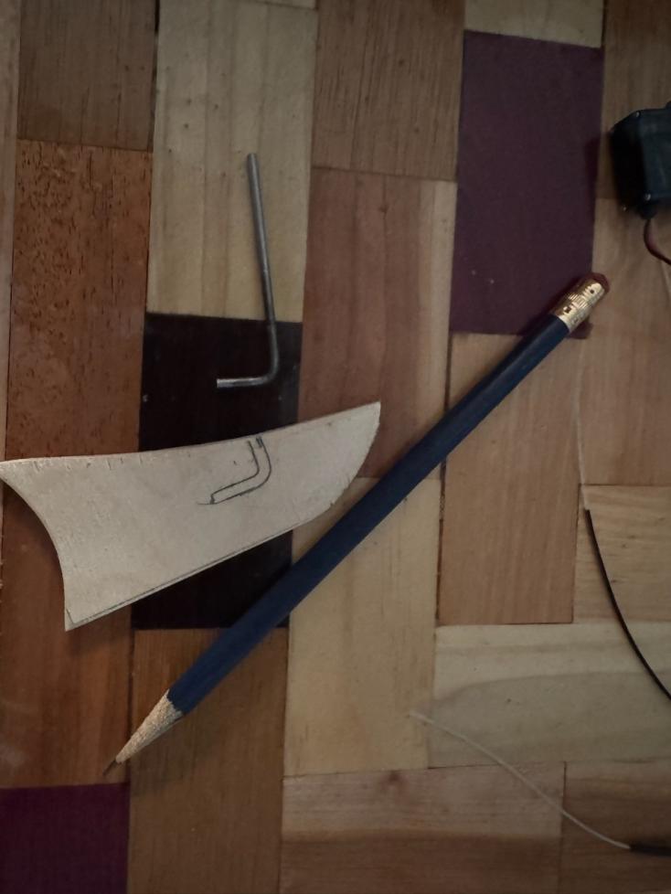

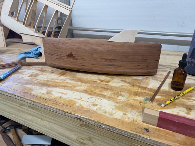

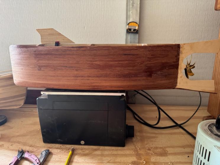

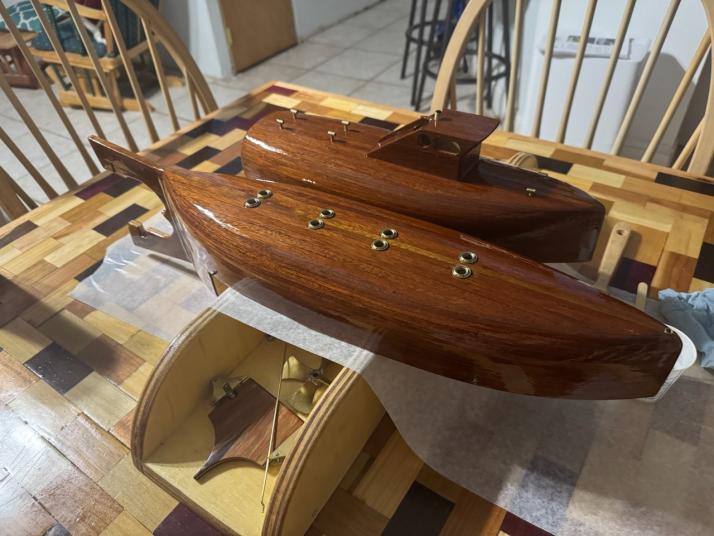

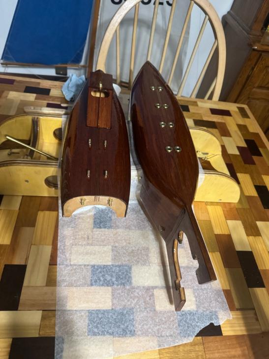

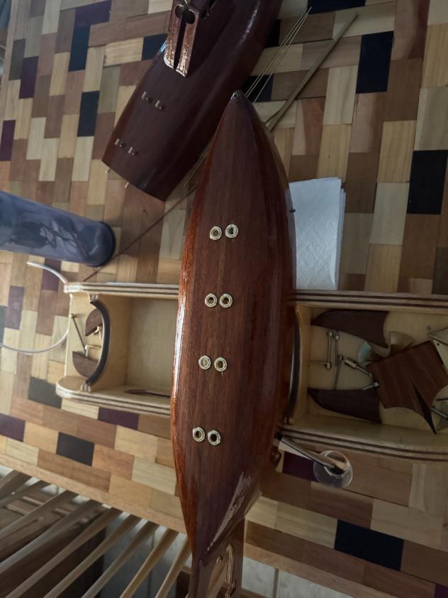

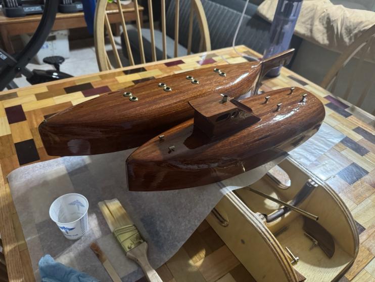

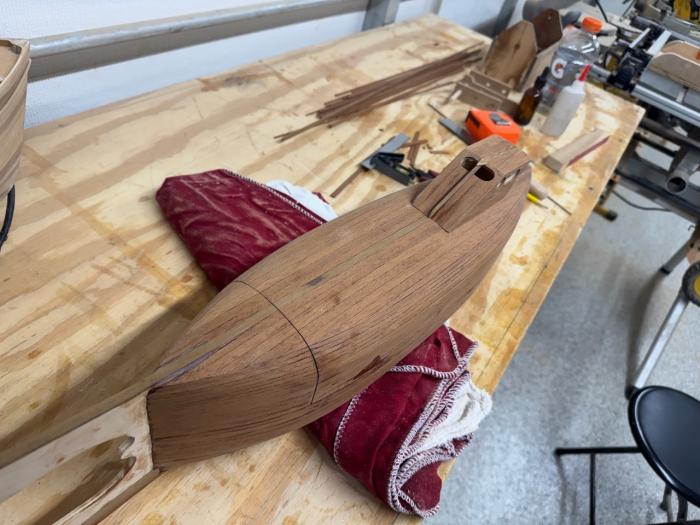

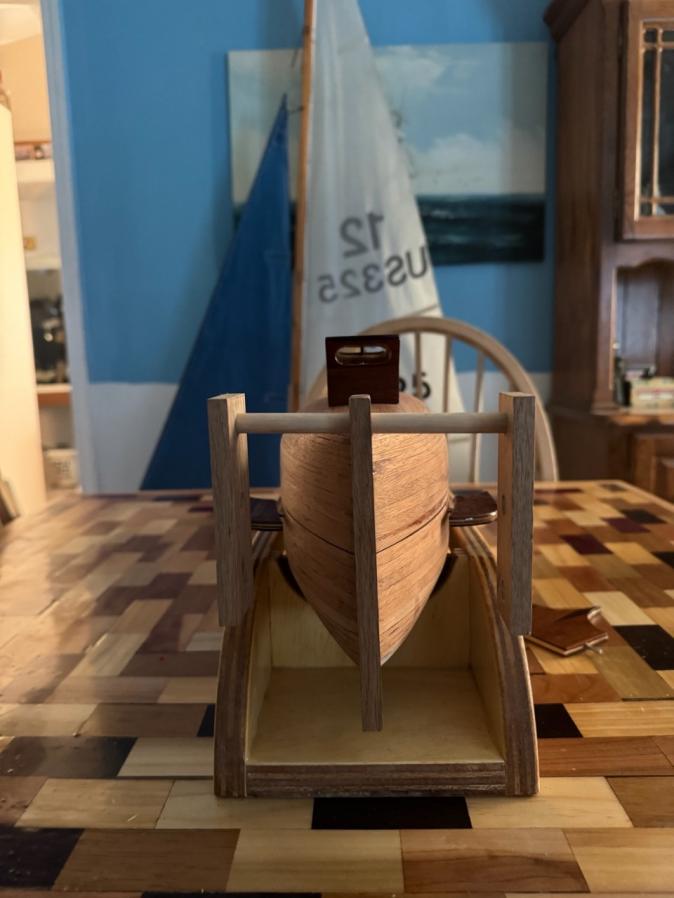

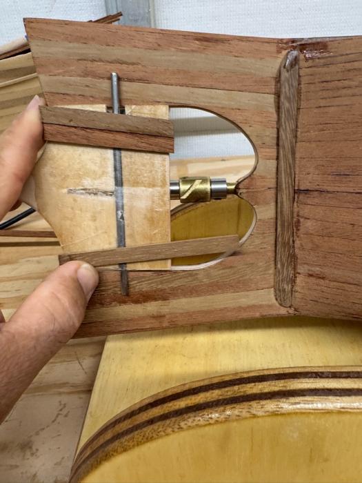

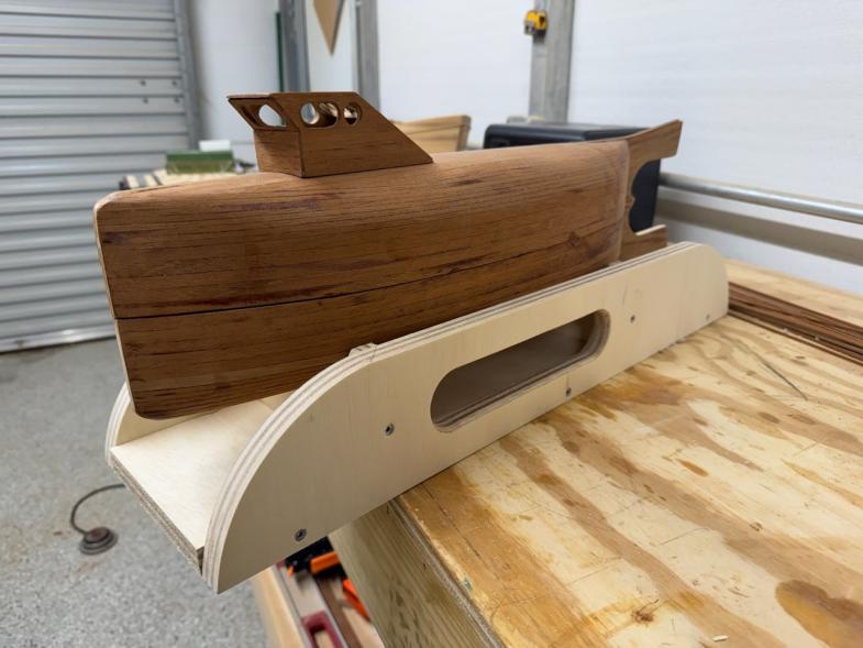

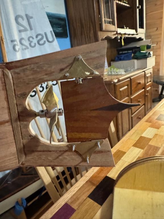

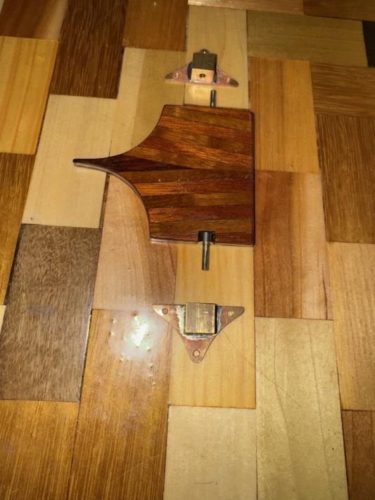

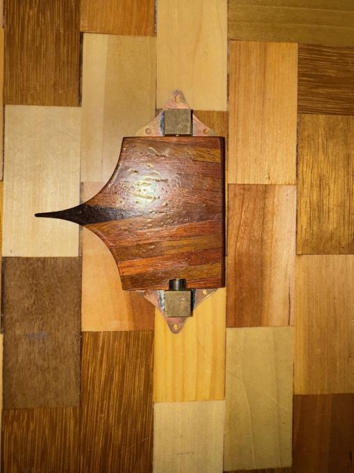

      Here I finished the hull and made the control surfaces.

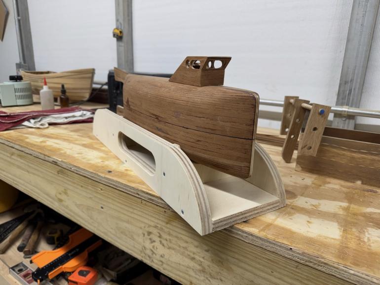

        Looks a bit like the "Brandtaucher"; https://en.wikipedia.org/wiki/Brandtaucher

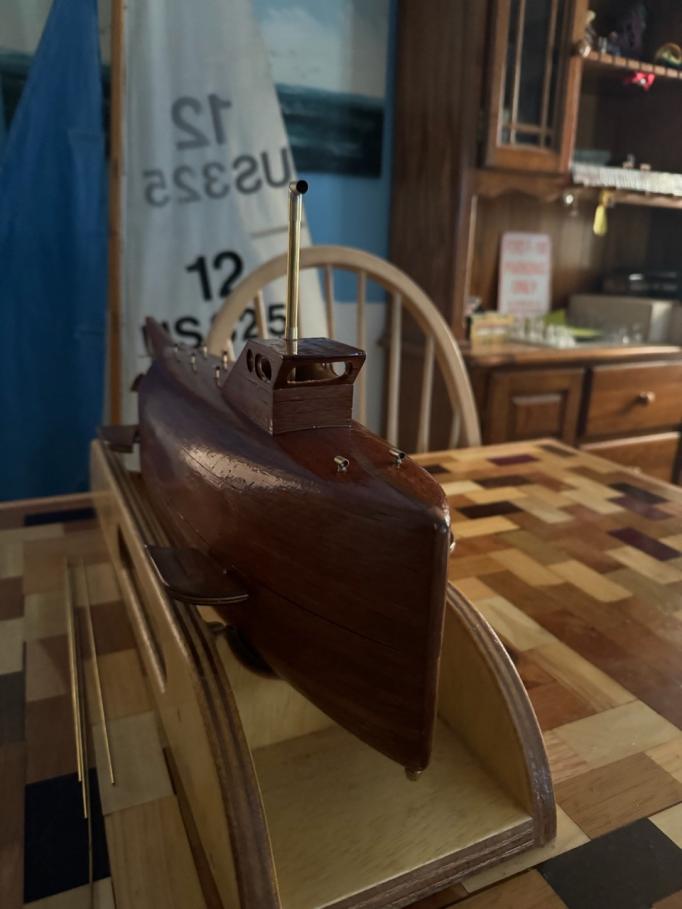

          Uni-cylinder no visible ballast system-Dynamic diver?
          • Lockleer1
            • May 2025
            • 42

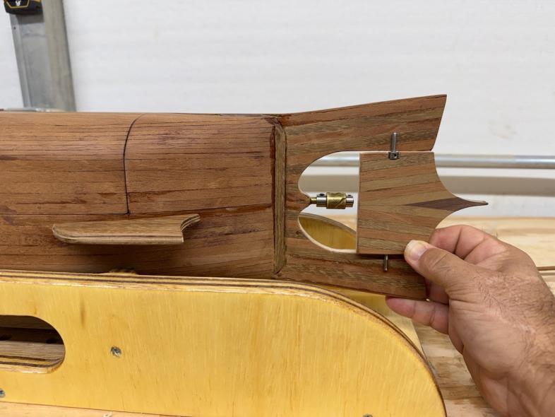

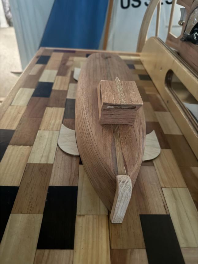

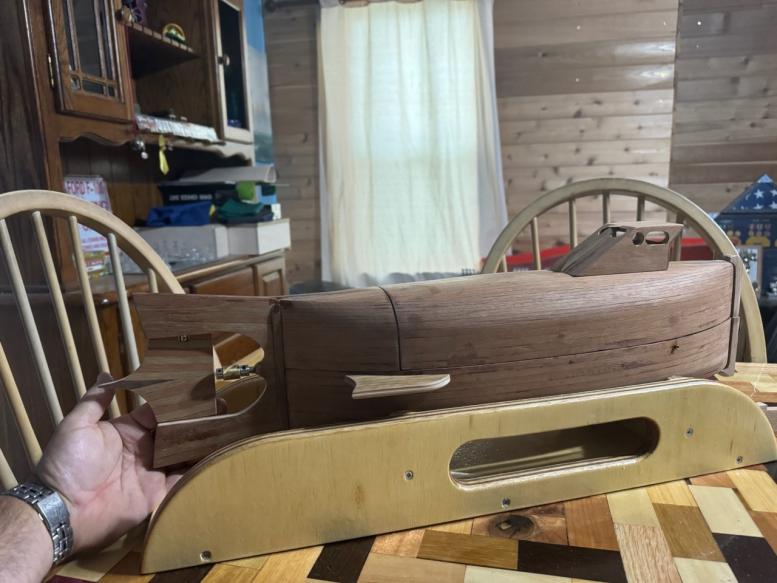

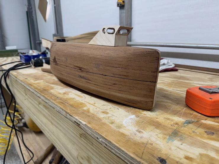

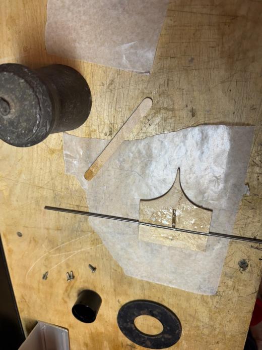

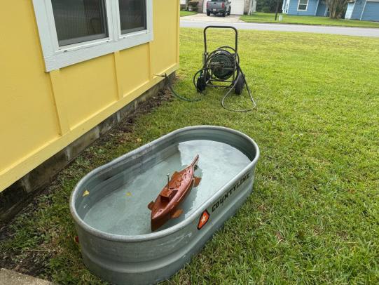

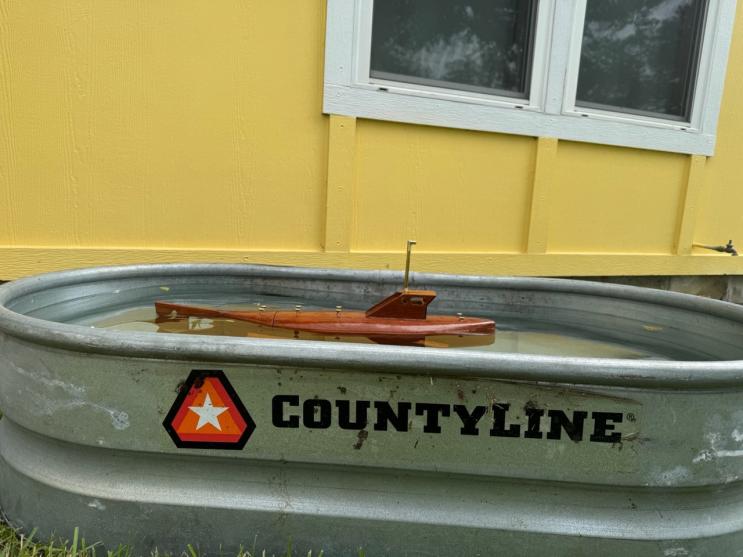

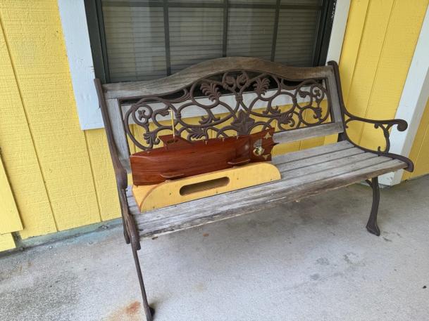

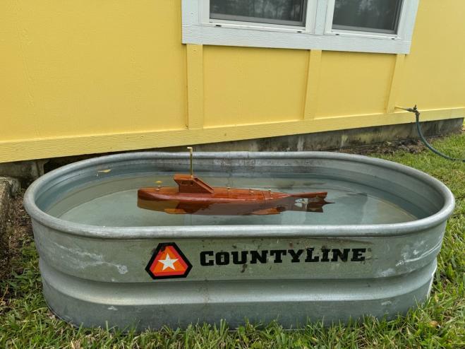

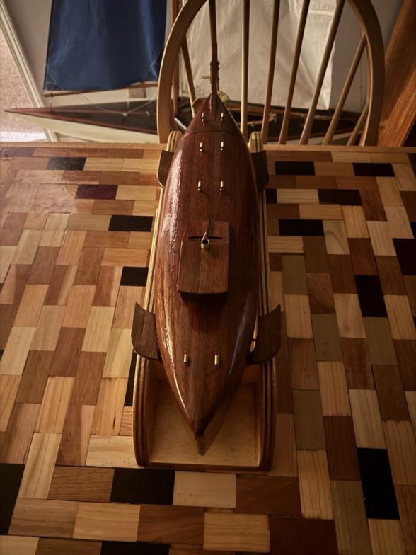

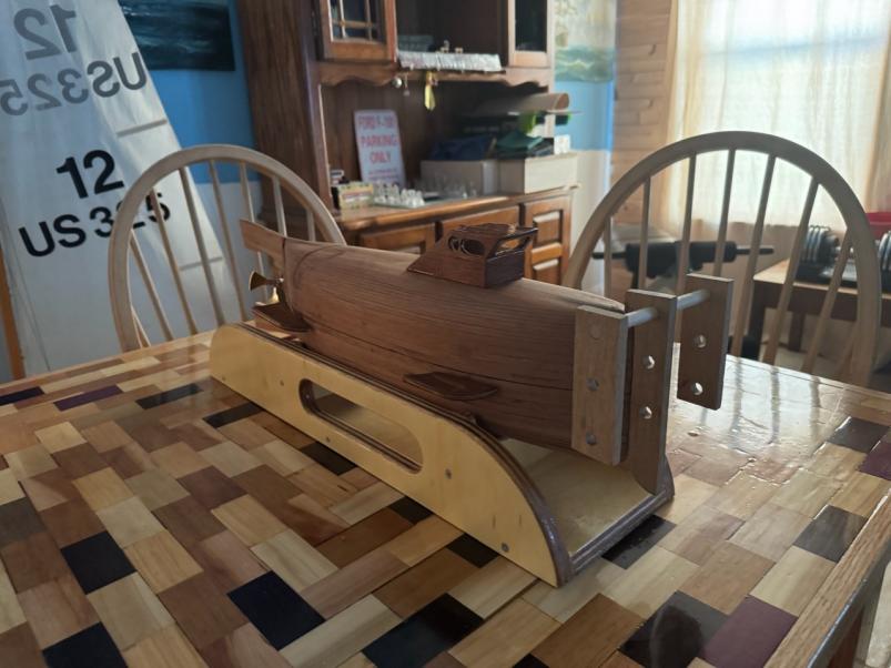

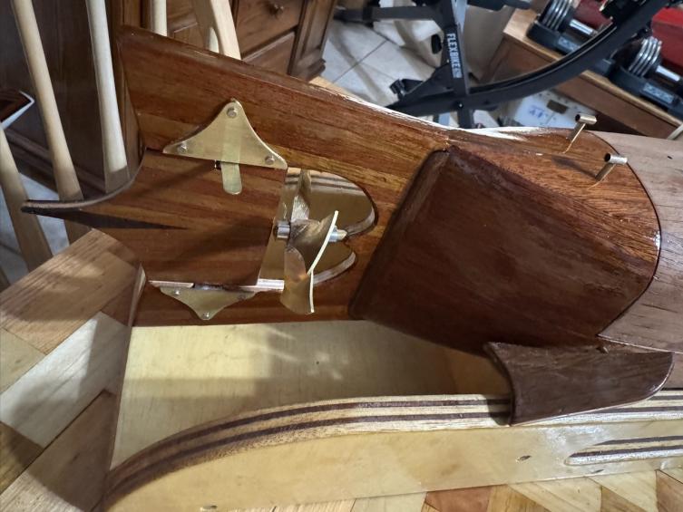

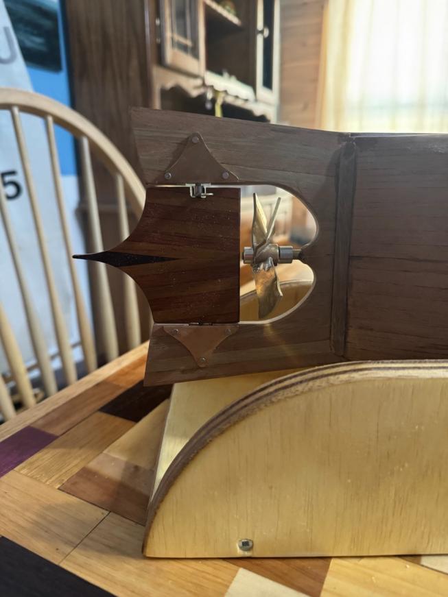

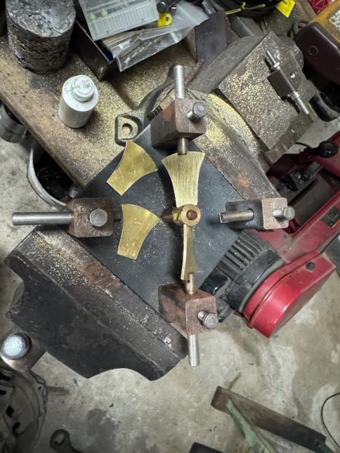

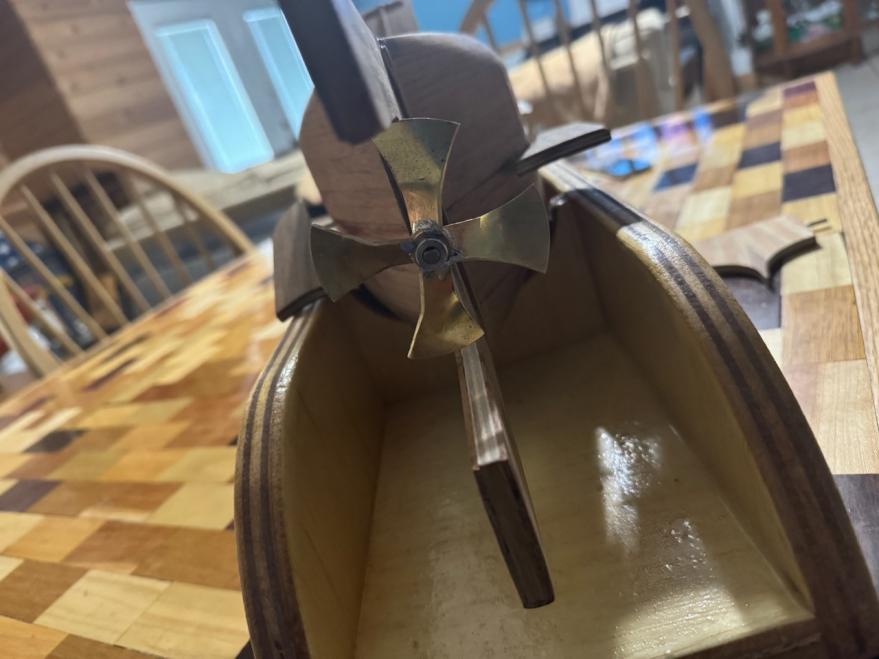

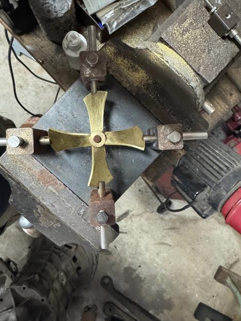

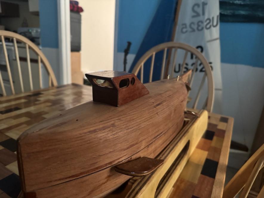

            The driver has no ballast system, it was the very first driver I built from scratch and wanted to keep it as simple as possible for reliability and servicability. The boat is ballasted for surface at most pond runs, but I do ballast him for diving when the water is clear enough, as I really would not like to loose him after the effort I've put into him. As you can see in a couple of pictures, I did intend to put push knees on him, but took them off almost immediately as I didn't like the look at all. but he still does function as a working boat. The original prop was a 3" scimitar but I figured I'd scratch make one as I've done in the past for other projects.

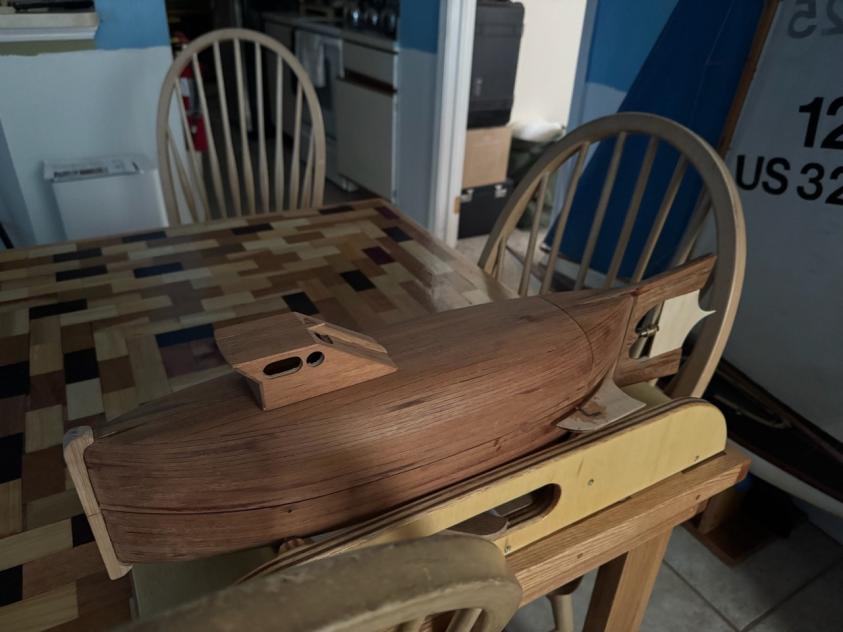

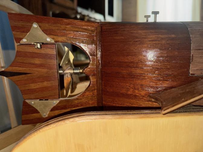

              Could add some brass eyelets as portholes or deadlights.

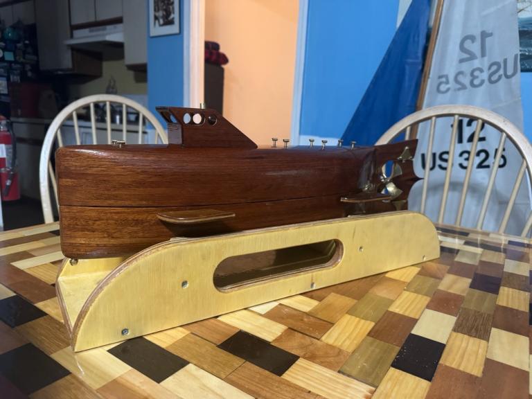

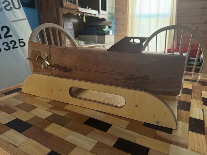

                I’ll add some of the final pictures tonight after work, but I think I may add some deck fittings and keep him how he looks. Very neat looking in the water too.

                    I hate to go all Vulcan on you, but how would a submerged tugboat function in practicality that a surface tug cannot do already? It doesn't have any visible means to rescue a submarine model, except join it being lost too in the briny deep.

                      No worries sir, happy to elaborate, mostly aesthetics I suppose, but got lucky in the building process. Besides the information that I stated early on the post as far as design and why I built it, I designed it to be different more than anything else, non combatant submersible that has the look of a tug is all. And it so happens to have some capability in pushing/pulling when the need arrises. Appreciate your attention and time, I really didn't think anyone would care about knowing or discussing anything about this build, but was asked by more than a couple of curious minds to write and show pictures. I have a few more pictures to post and a few videos.
