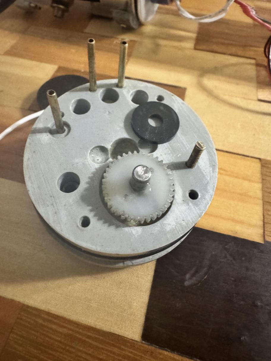

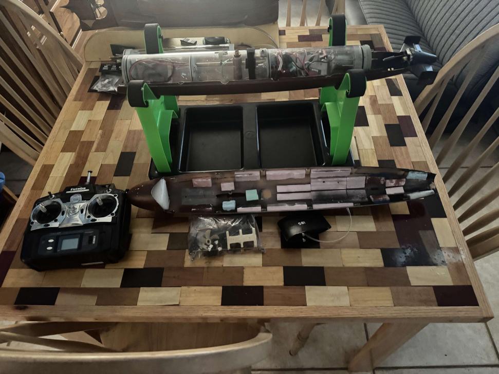

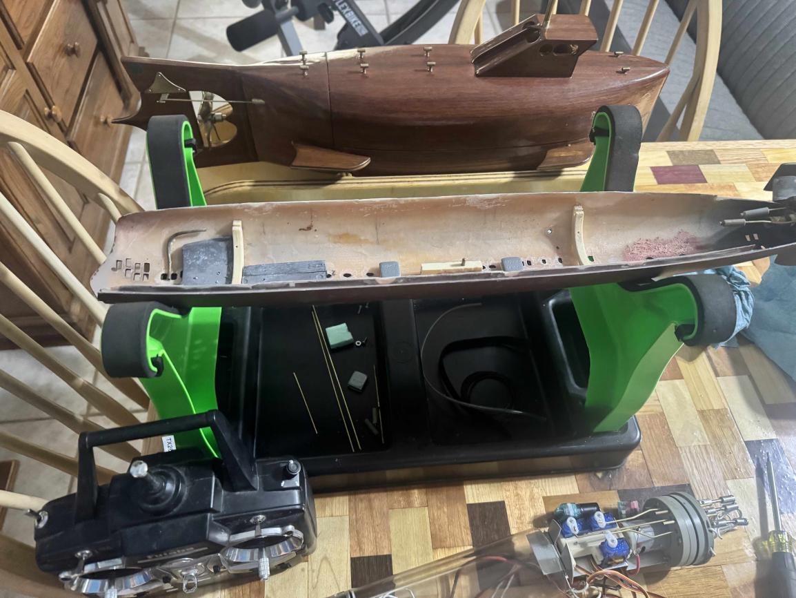

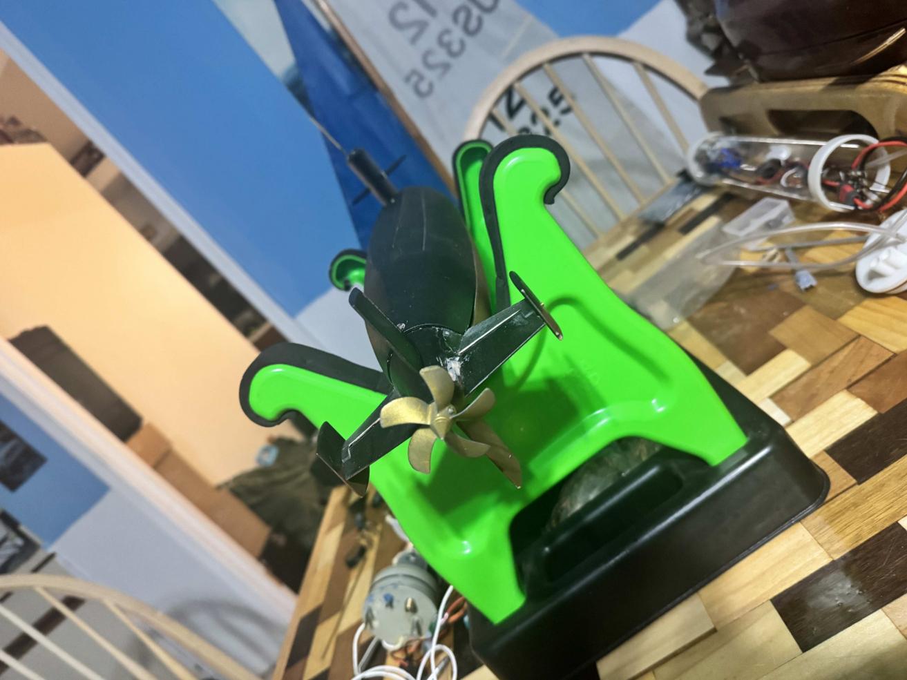

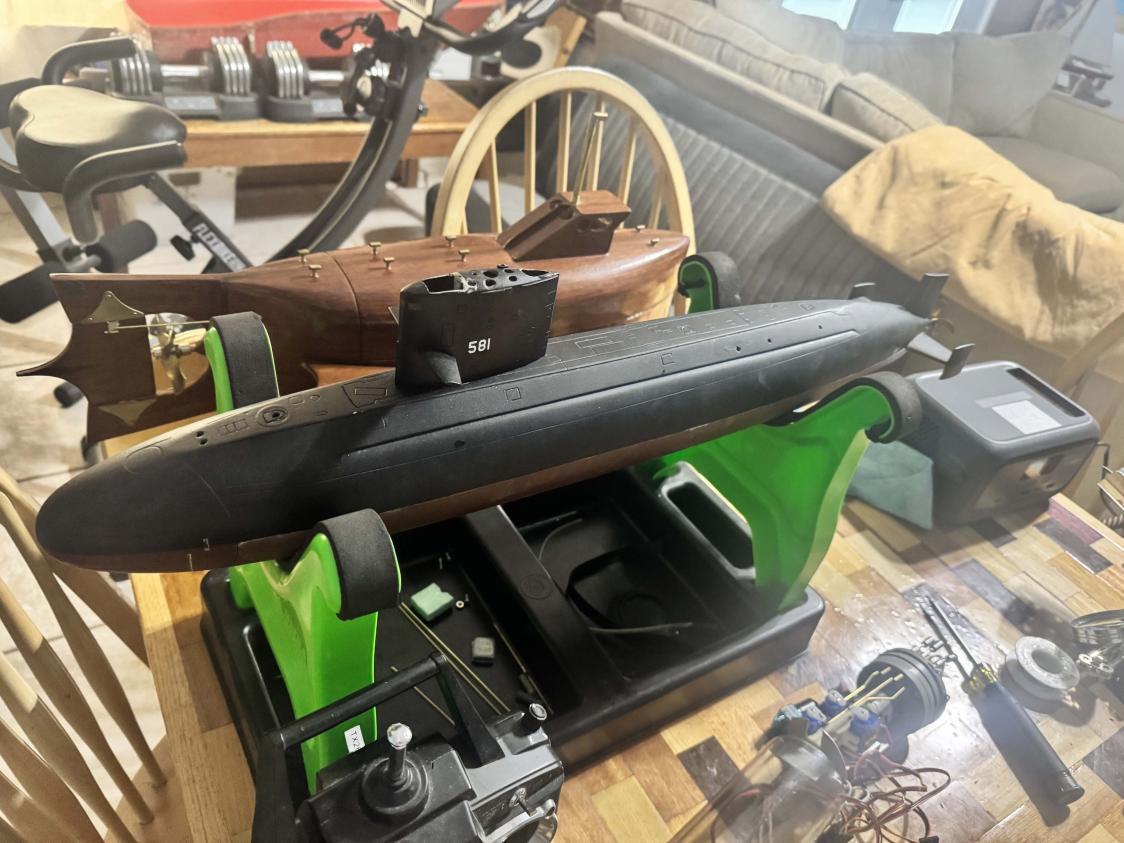

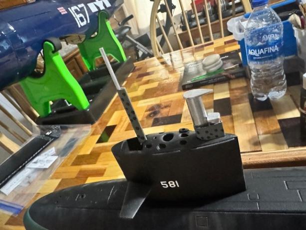

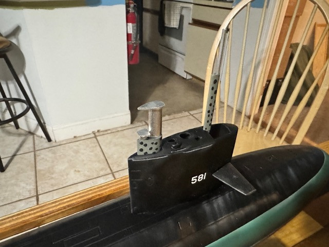

    I was recently lucky enough to acquire a special little boat. I'm hoping to get her in fighting shape in good order pretty quickly and now that I've learned a bit about detail painting, I hope to have it ready to go for Fleet run and Subfest 2026. First night she arrived, I unpacked and set up her tail feathers and screw, just wanted to be able to look at her in 1 piece for a bit before I started work.

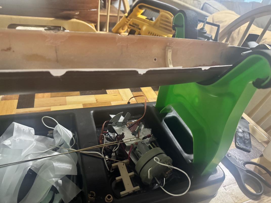

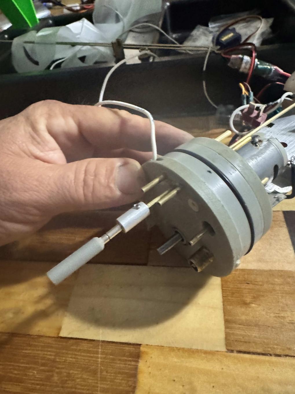

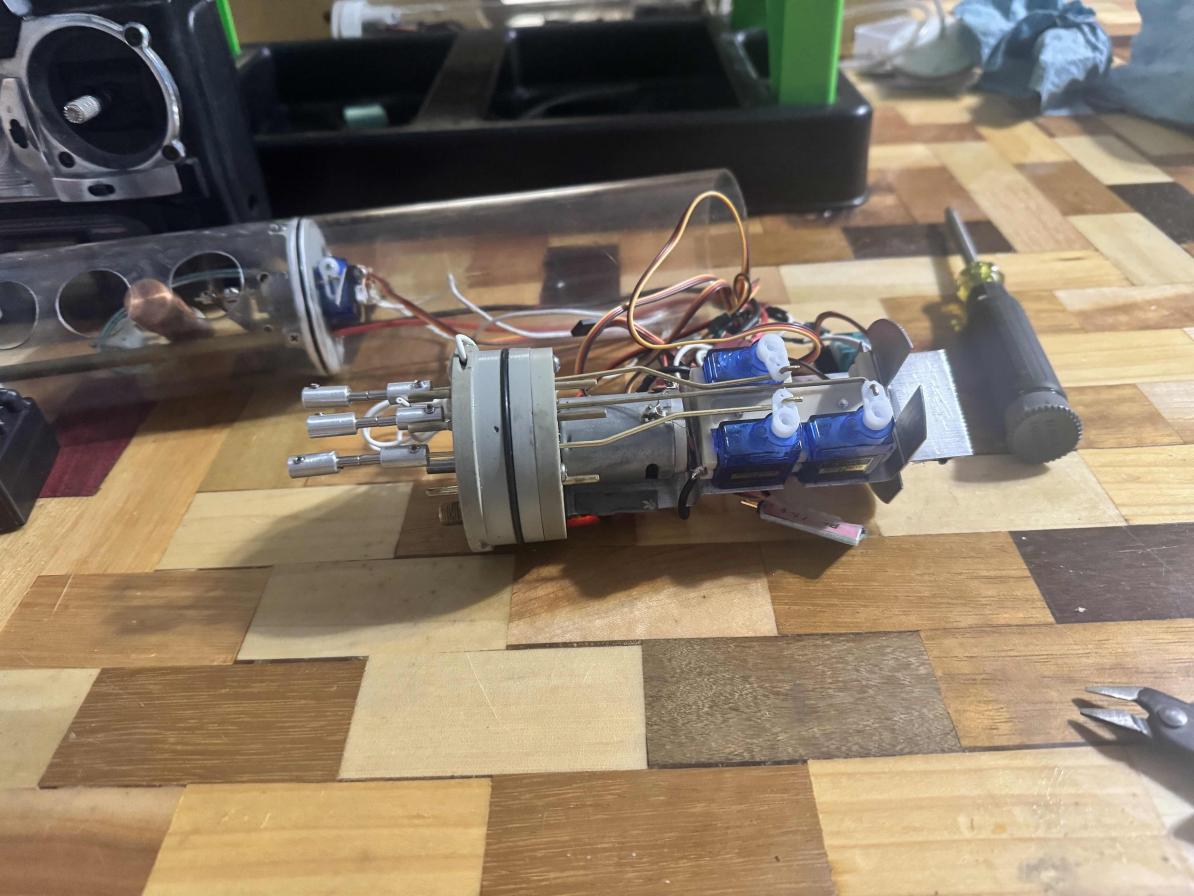

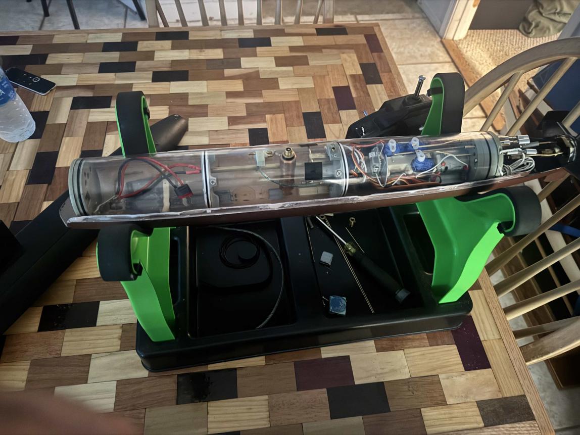

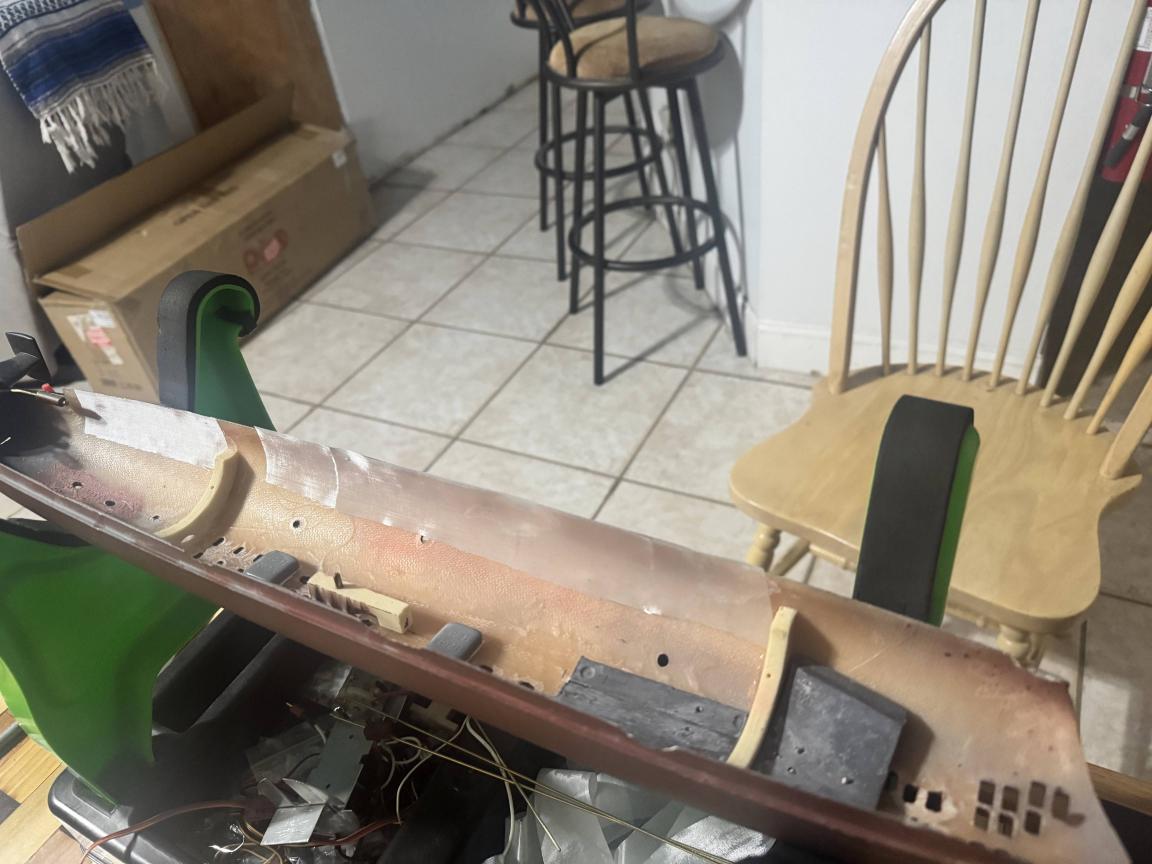

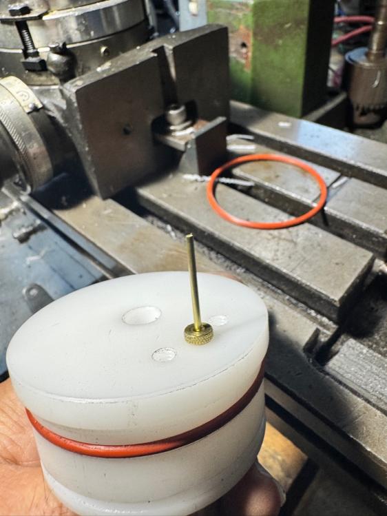

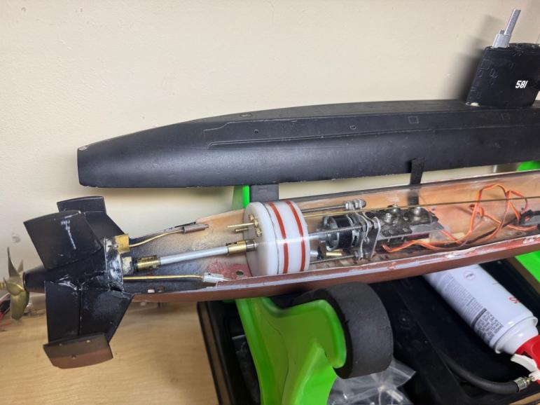

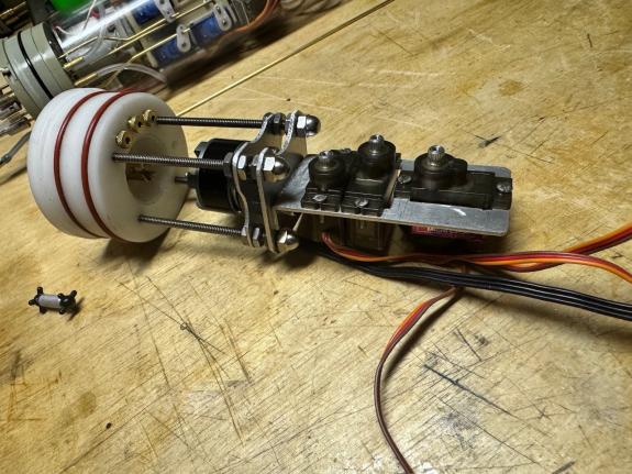

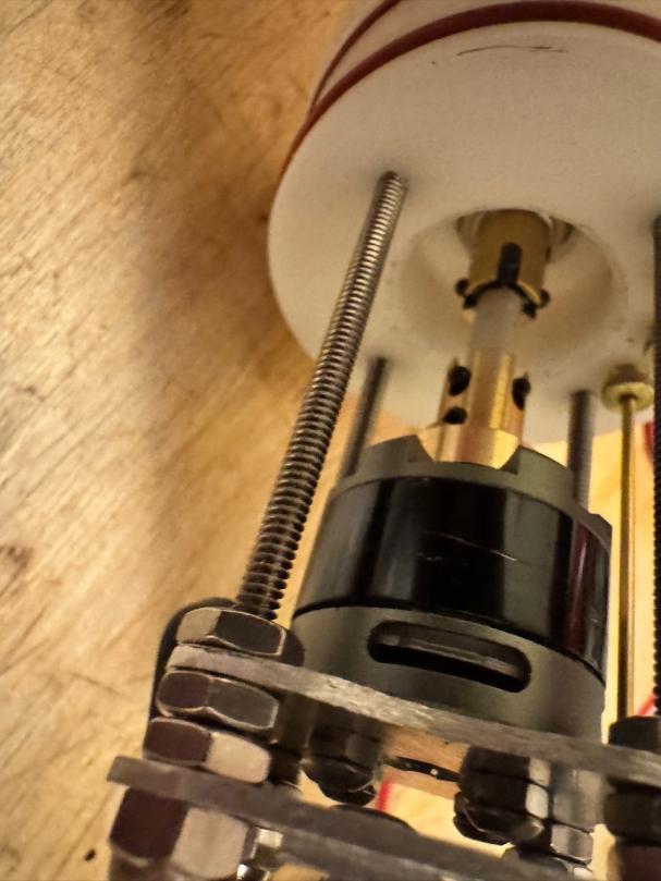

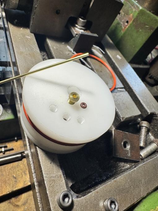

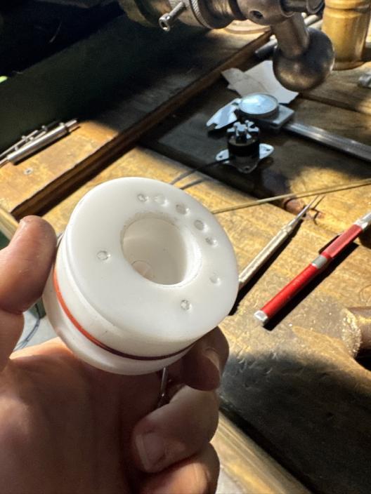

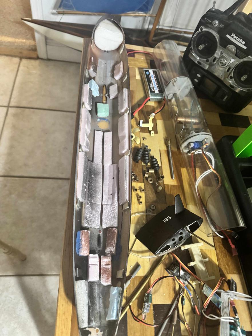

    The driver needed to be put back together and the lower hull had some chunks missing where the upper and lower hulls join. Hull repaired and driver is put together ready for dunking. once I have the driver ready with the battery I intend to use, I'll start trim and ballast. I ended up making new magnetic connectors, I've made quite a few by now for all the subs I've worked on and some for friends. I wanted to be able to remove them for any maintenance if required. I re-used the magnets that came with it along with some replacements as some were missing. Goal is to use as many original parts as I can. I'm also considering building a second driver, easy driver, for pond running/spare just in case.

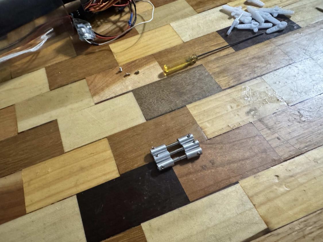

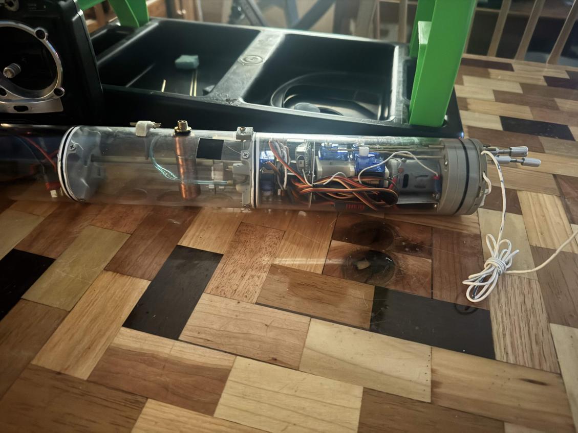

        Driver is leak free, all control rods are in, including Fairwater planes! and I'll have to add some foam. but she may be ready for shakedown on Saturday.

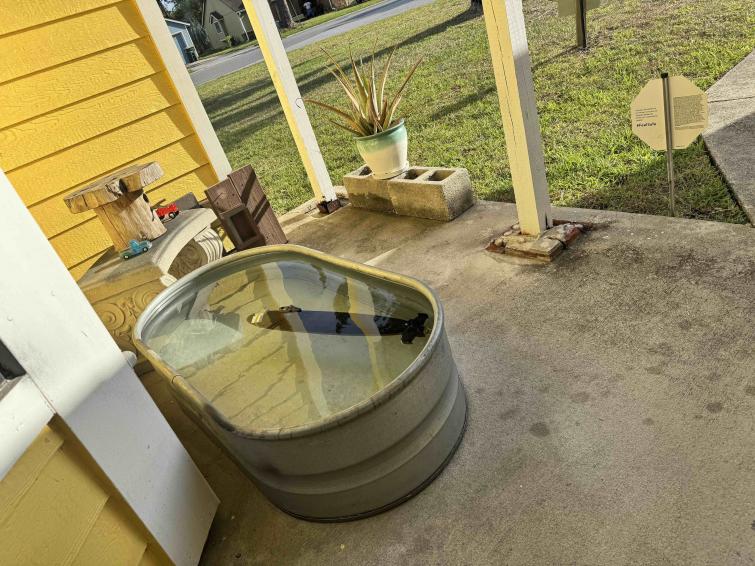

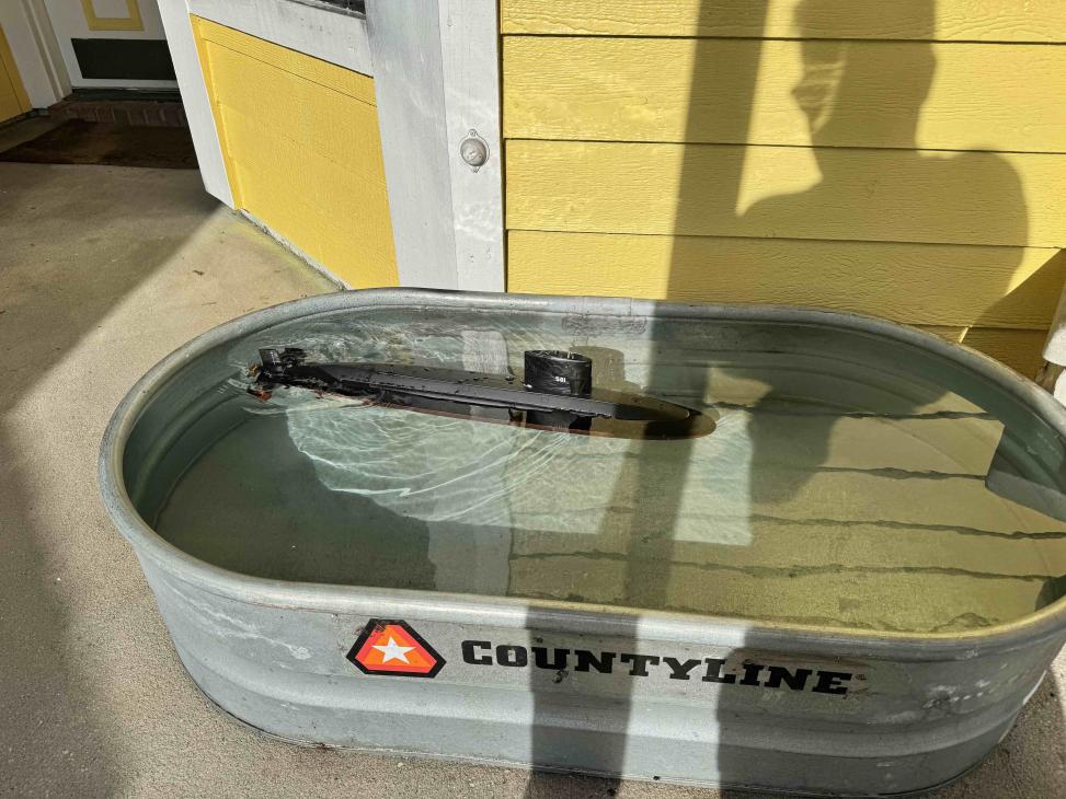

            first dive

              second dive

                second shakedown cruise good to go! Time for drydock for paint and maintenance.
                  Can you post your scratchbuilt wooden sub too?
                  • Lockleer1
                    • May 2025
                    • 58
                    I’ll gather photos and such so can get it posted

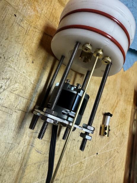

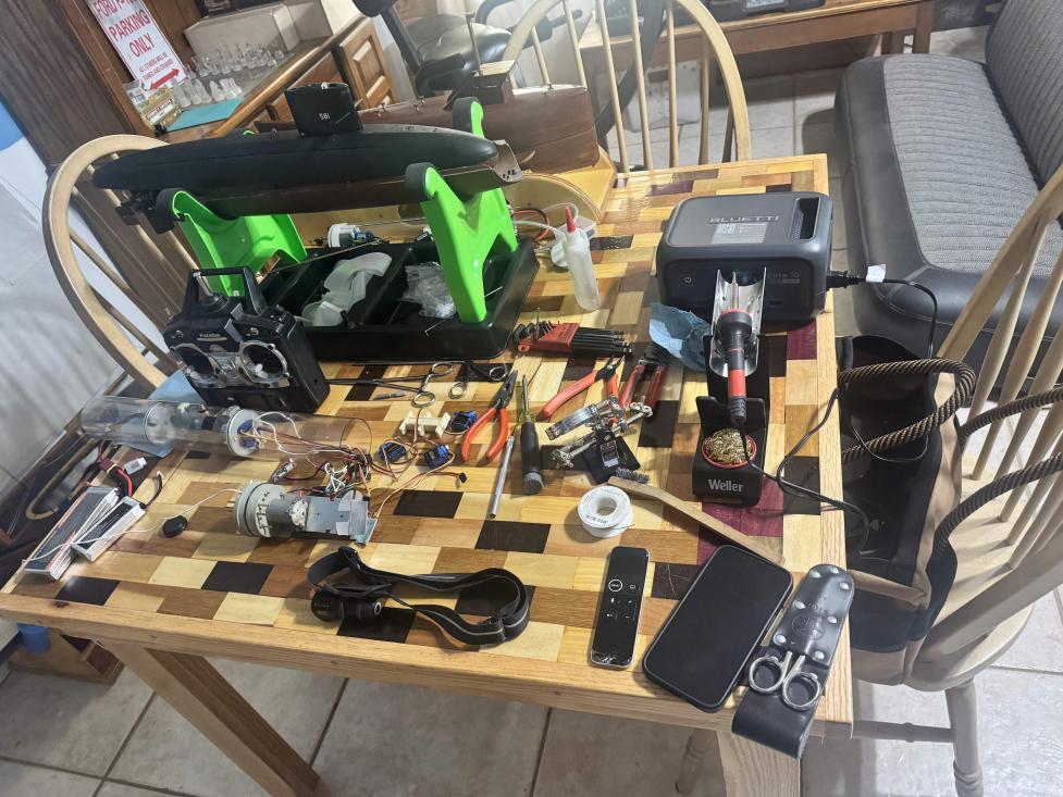

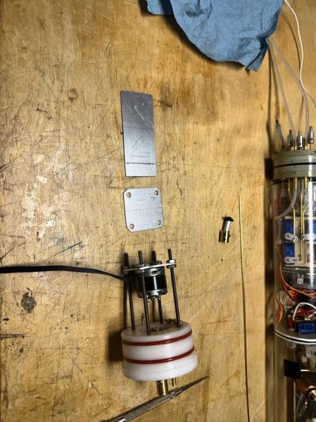

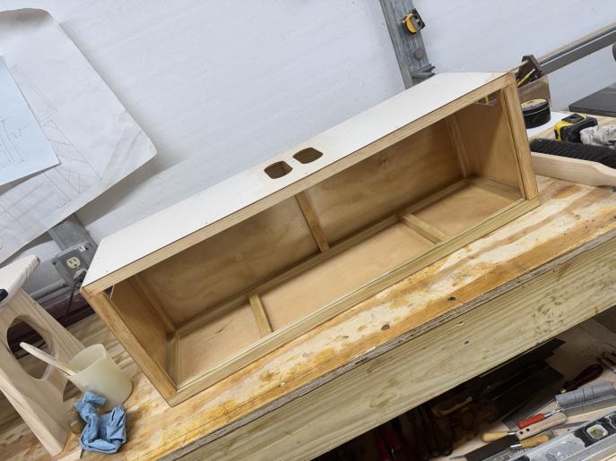

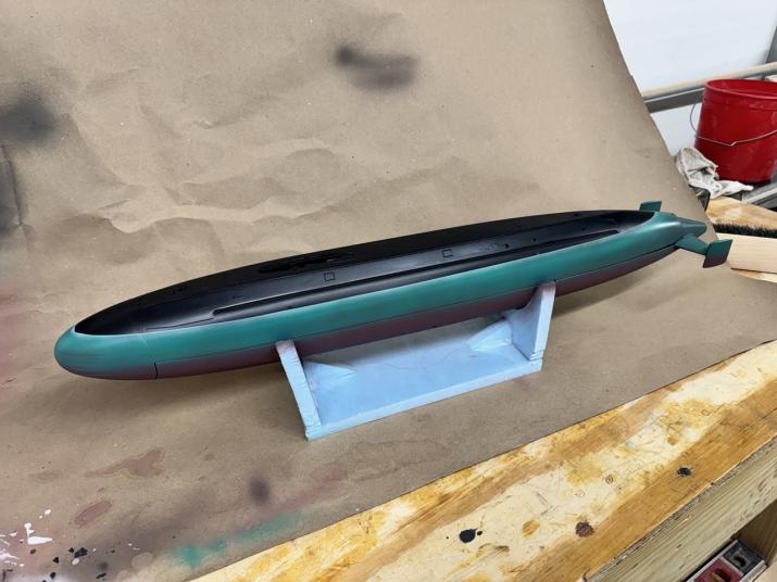

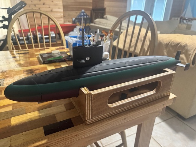

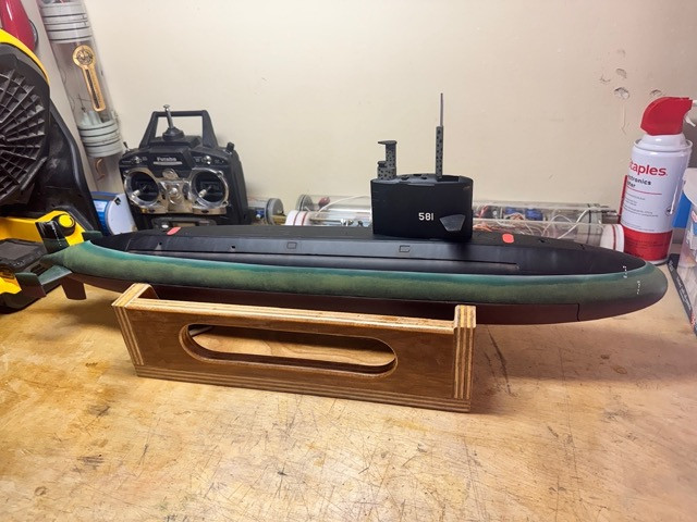

                      I've gotten the Blueback in Drydock while I build a second driver (dynamic for simplicity and running dark water ponds) and also a good box to keep the model safe.

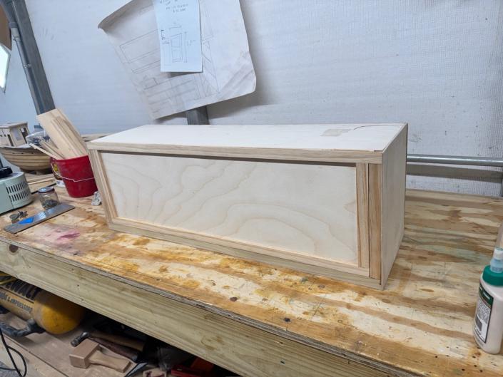

                      • Lockleer1
                        • May 2025
                        • 58

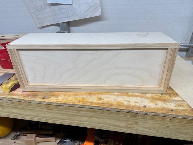

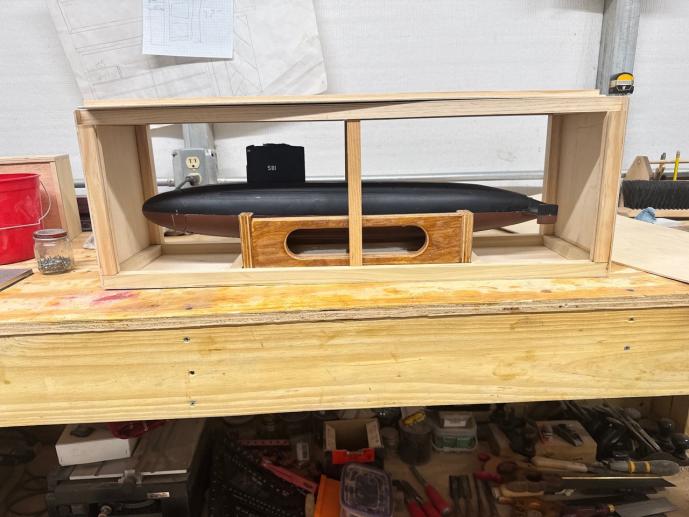

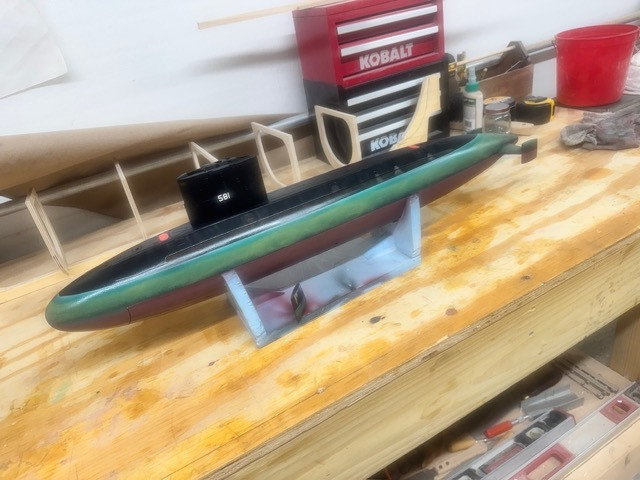

                        Today I got the first coat of epoxy on the interior of the box. The top handle holes can be seen, there are 2 more, one on each end at the top for handling. the door is just a slide down to keep things easy. The first box I built was for a 1/96 USS Nautilus and I used a piano hinge on the bottom of the hatch. Works ok, but I like the sliding door much better.

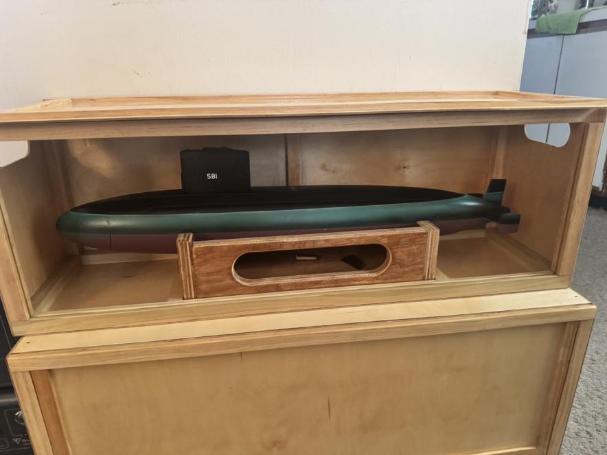

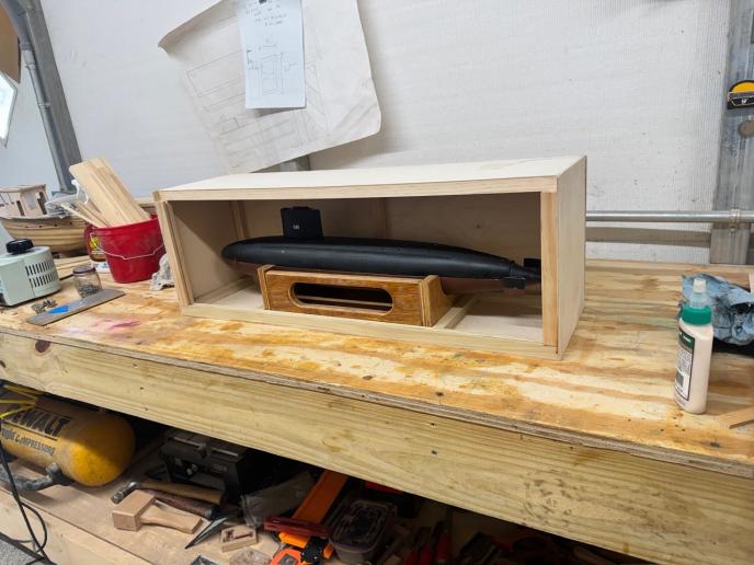

                        • Lockleer1
                          • May 2025
                          • 58

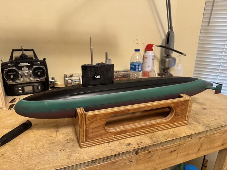

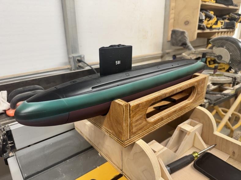

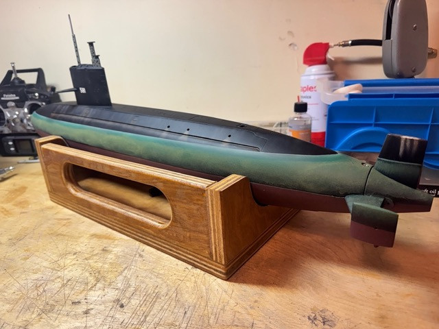

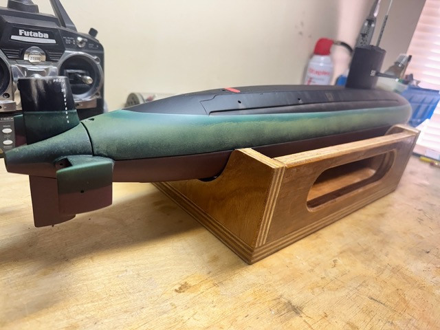

                          Finished the box and started paint. still have some work on the paint but so far all is good.

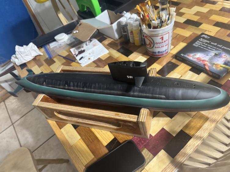

                          • Lockleer1
                            • May 2025
                            • 58

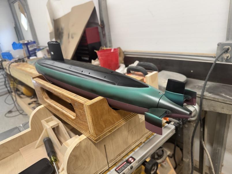

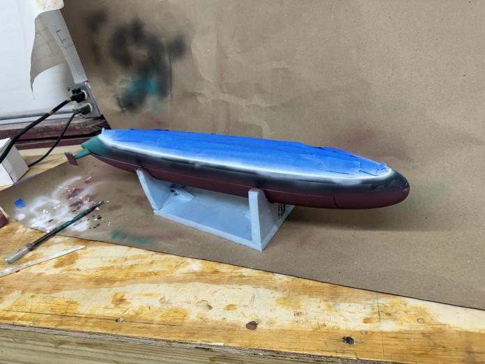

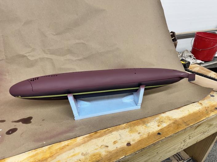

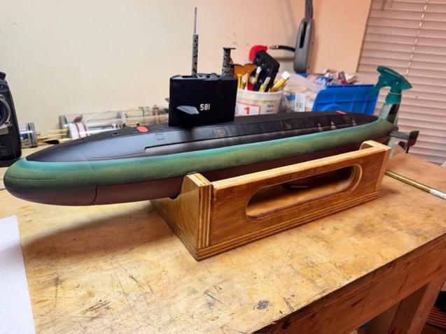

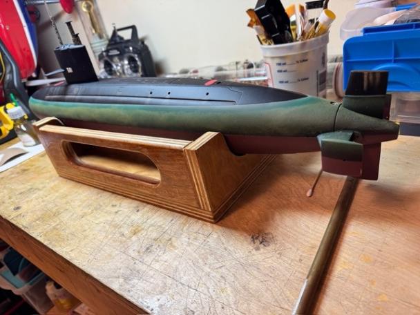

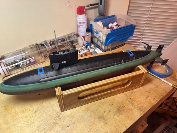

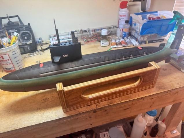

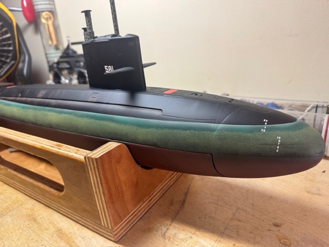

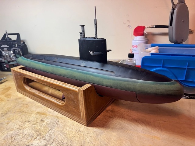

                            Shading and some other paint work done, still have a few more details to work on before the final clear coat.

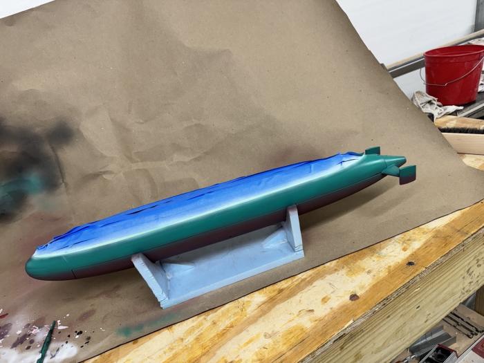

                            • Lockleer1
                              • May 2025
                              • 58

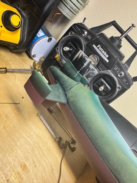

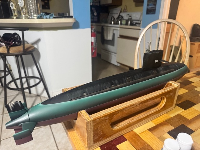

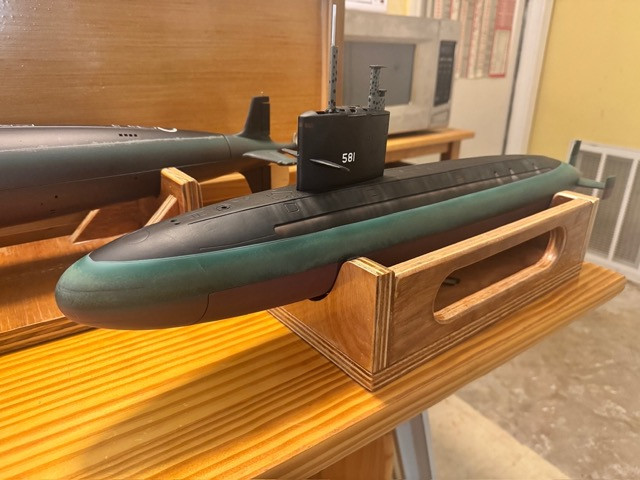

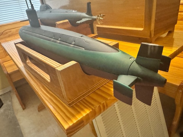

                              I made quite the mistake about 3 weeks into doing/learning the paint job I really wanted to adorn the boat with, but luckily, the torpedoman whose work I'm plagiarizing quickly corrected me. I followed the instructions of my coaches on how to do the paint and was able to fix the issue quickly and get back to the task at hand. I've only got a couple of steps before she's ready for Subfest. I'm very much looking forward to see friends made from last time and just shoot the breeze relaxing with a sub in the water.
