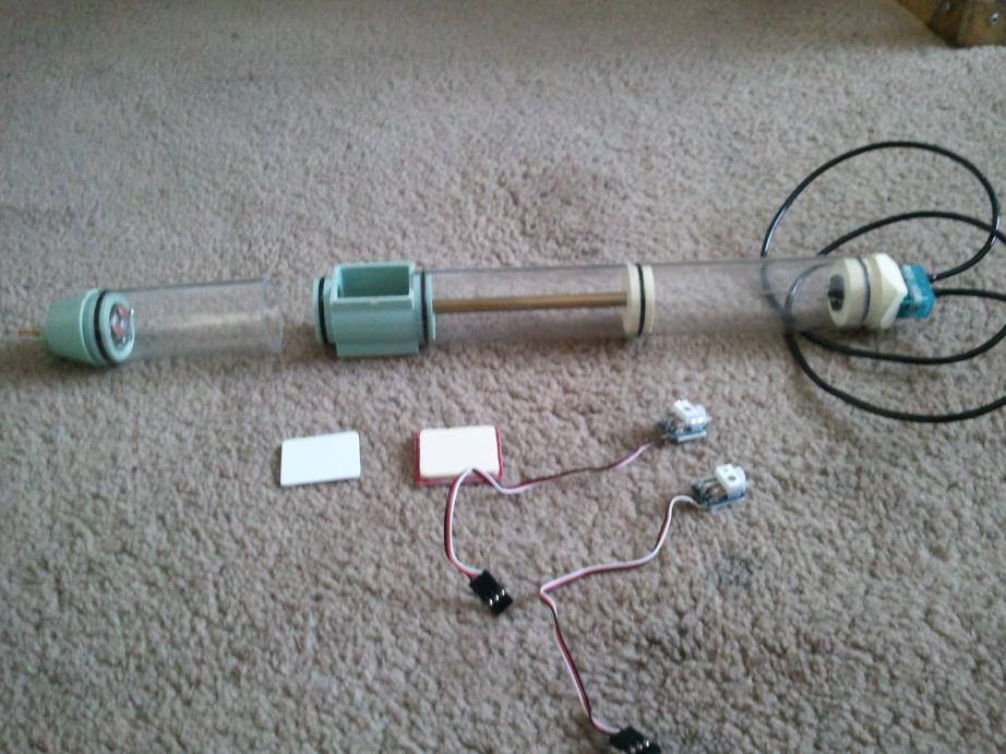

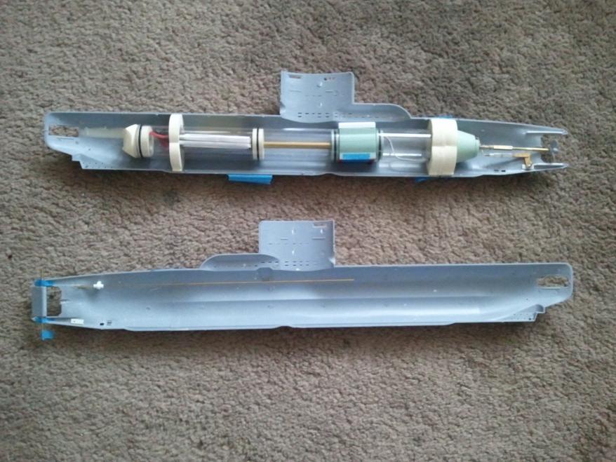

            I started my Type XXIII in 1/72 scale.
            Here are some picsClick image for larger version
Name:	2013-03-03 10.55.04.jpg
ID:	76572Click image for larger version
Name:	2013-03-14 18.14.40.jpg
              I am seriously jealous. That looks really sweet and a great use of the 1.25" sub-driver! This will be a fun build to watch and learn from.

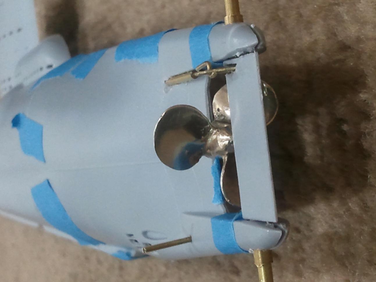

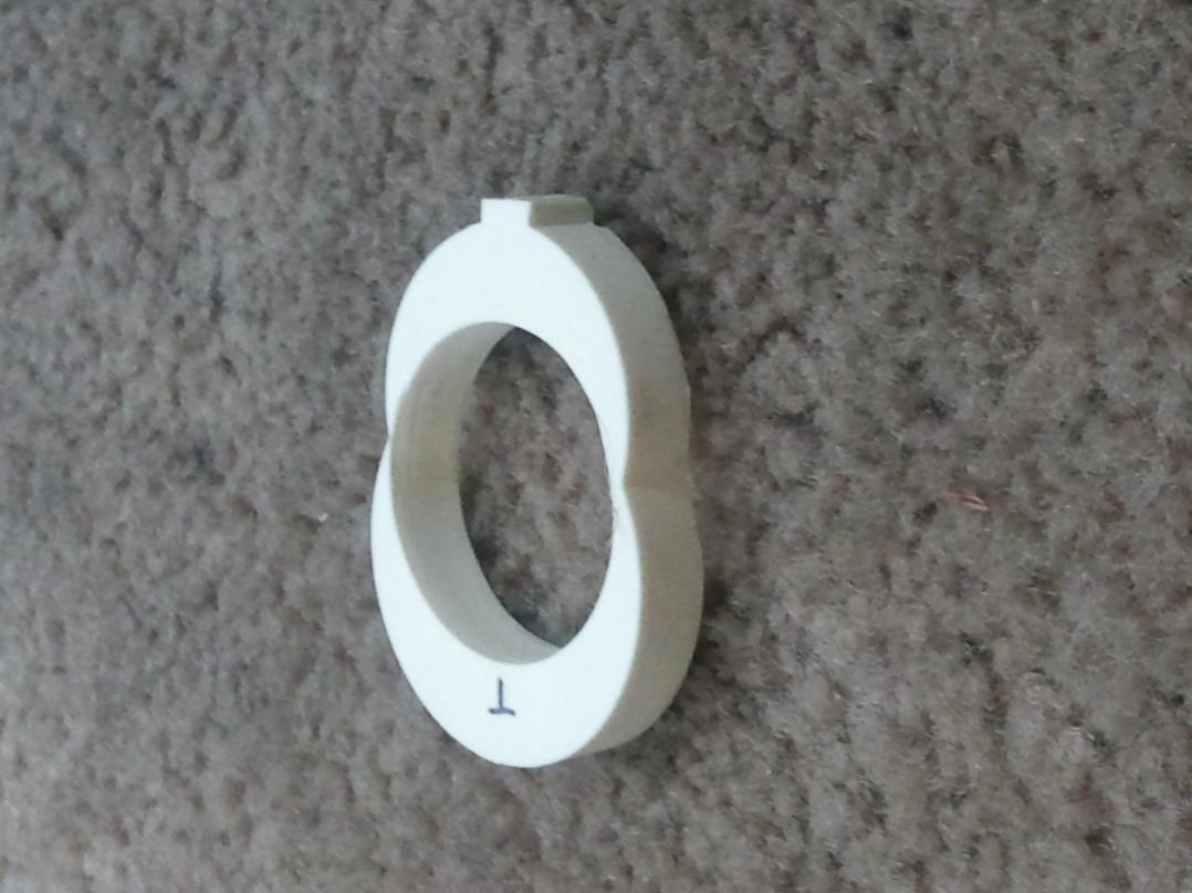

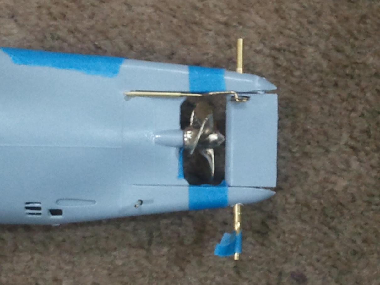

                Got my New prop from the prop shop today.
                Could not wait to put it in place to see how it looks.
                I also cast a sub driver mount.Click image for larger version
