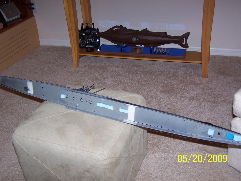

I simply discarded the excess plastic. Yes, the deck sections were reinforced with strips of styrene plastic. Not sure if you are able to see them in these pics. They are white in color. Once you click onto the photo, continue to click onto the pic to enhance further. Al,

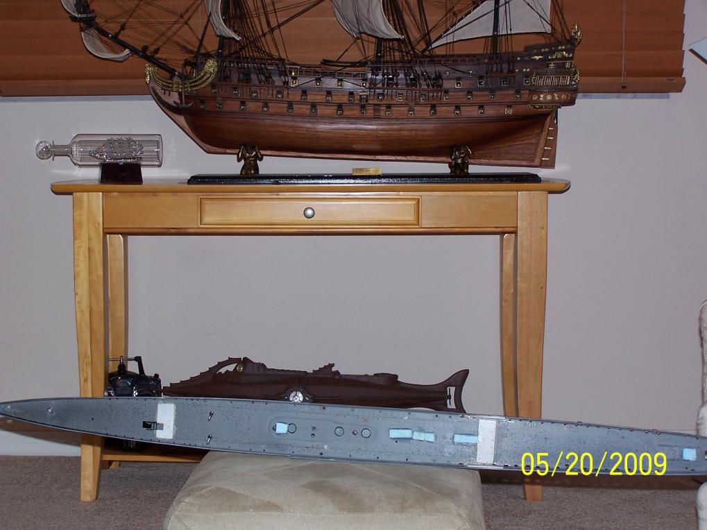

Another look at a WWII Gato Class Submarine
