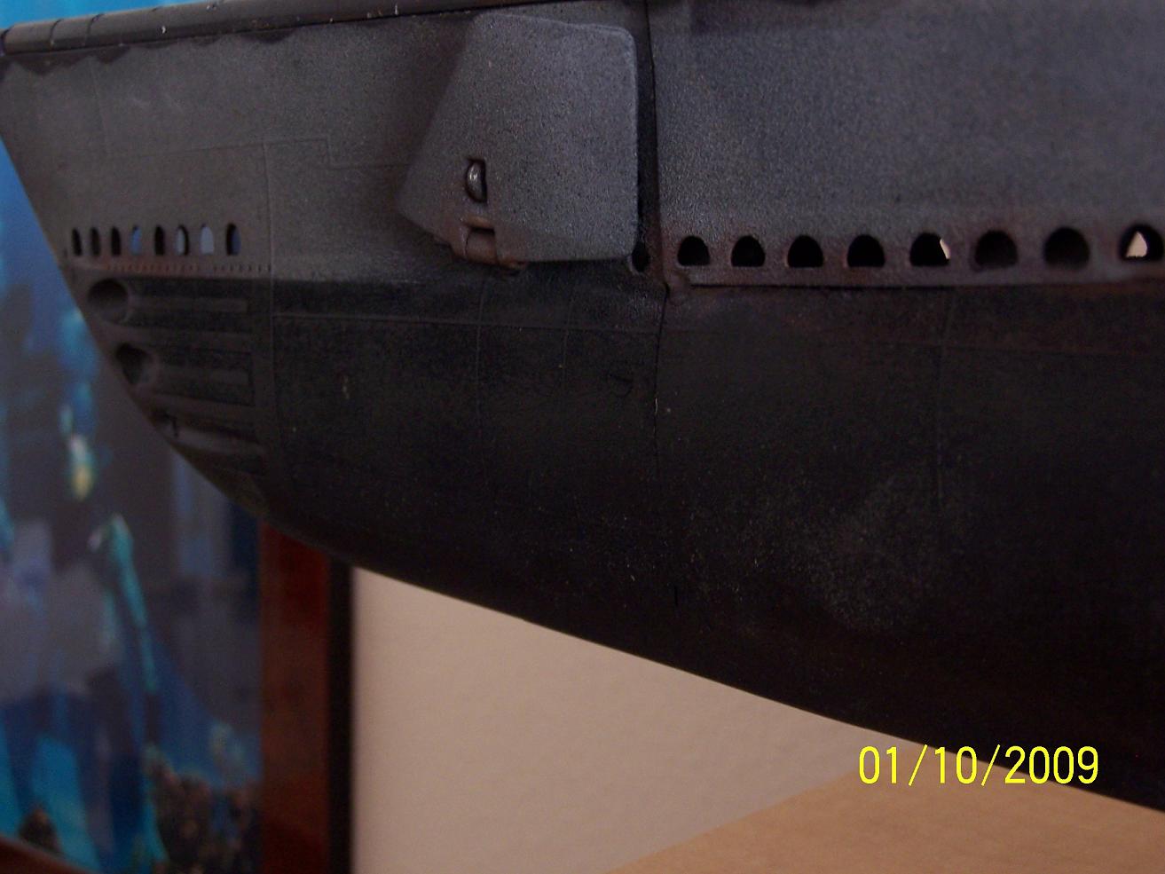

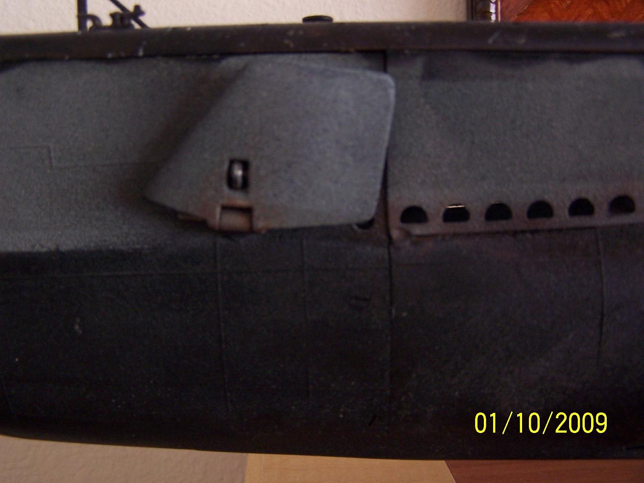

                Hello Rick, Your right I probably could have provided further comments regarding the various build pics. To answer your question, I've found the wtc to fit quite nicely. In my humble opinion I don't really see the need to open the hull further than what has been shown. I would however, secured the stern portion as I did the bow by simply using stainless screws within the lip of the main hull and the stern cone instead of cementing the stern to the main hull. This would have permitted easy access to the rudder and stern plane assembly should repairs be necessary. I'm also satisfied with the manner I've secured the deck & tower to the hull using a couple countersink stainless screws painted over. I had built the boat as a working boat, and while I've tried to be as accurate to detail as possible It was never intended to be anything more than a working R/C model to have some fun with down at the pond. :) Regards, Al,

                  In these photos of the bow you have to look closely to see that there are two screws that attach the bow to the forward section of the hull.:) As mentioned this procedure could have been duplicated when attaching the stern cone, providing for easy disconnect of that portion of the hull. Regards, Al,

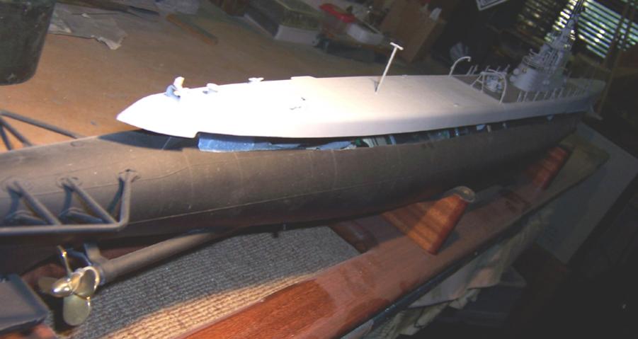

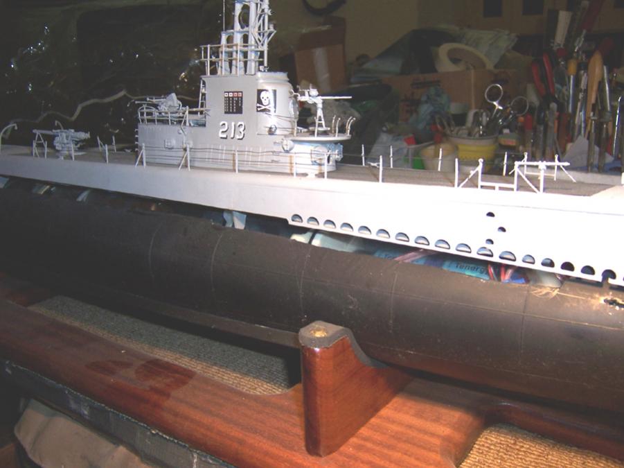

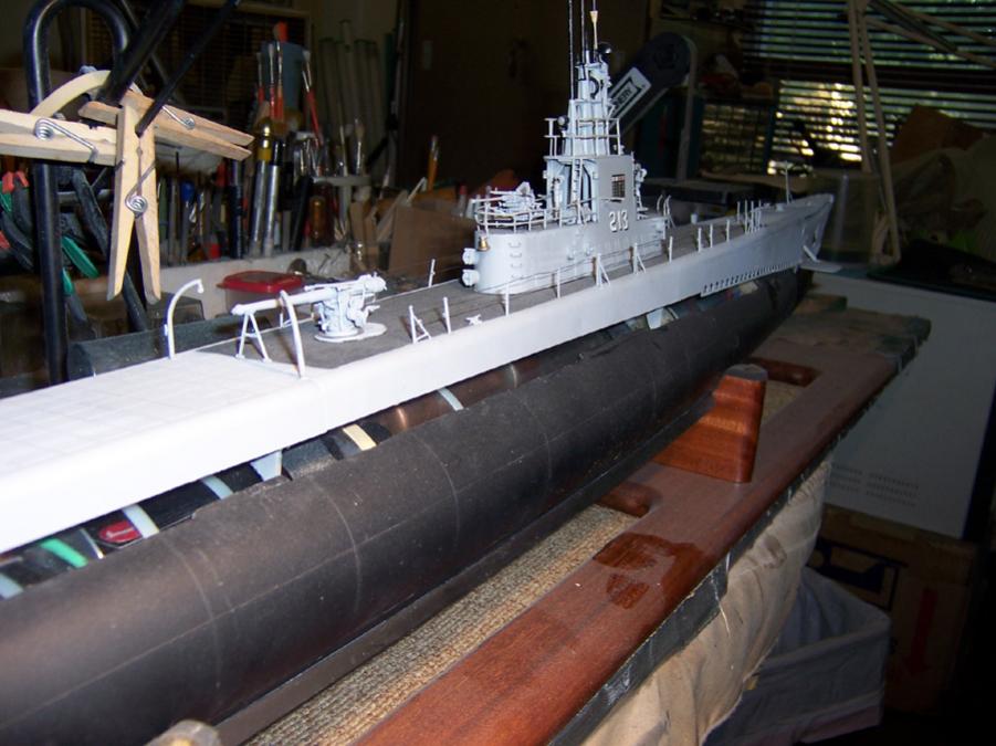

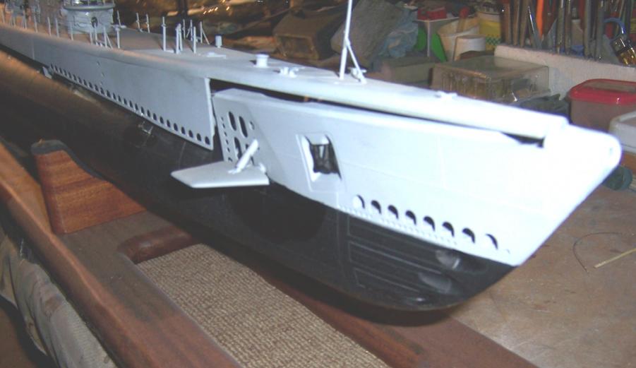

                              Here's some pics of my Gato before it was completed, with deck assembly setting up above hull.
                              These may give some ideas of how I did the separation lines, etc.
                              Sorry about poor picture quality.

                                In David Merrimans gato build he shows adding to white plastic to the bottom three decking pieces at the joint for add support. What did you do that. Or did you have another idea to help support the decking sense we are removing so much hull. What's why I wanted to see the bottom view of Al's the deck. Somebodys deck. I'm pretty much trying to follow Al's
                                build. This is my first sub and the going is slow. There are lots of great Gato's on the form and I'm watch them all looking for solutions to my many questions.
