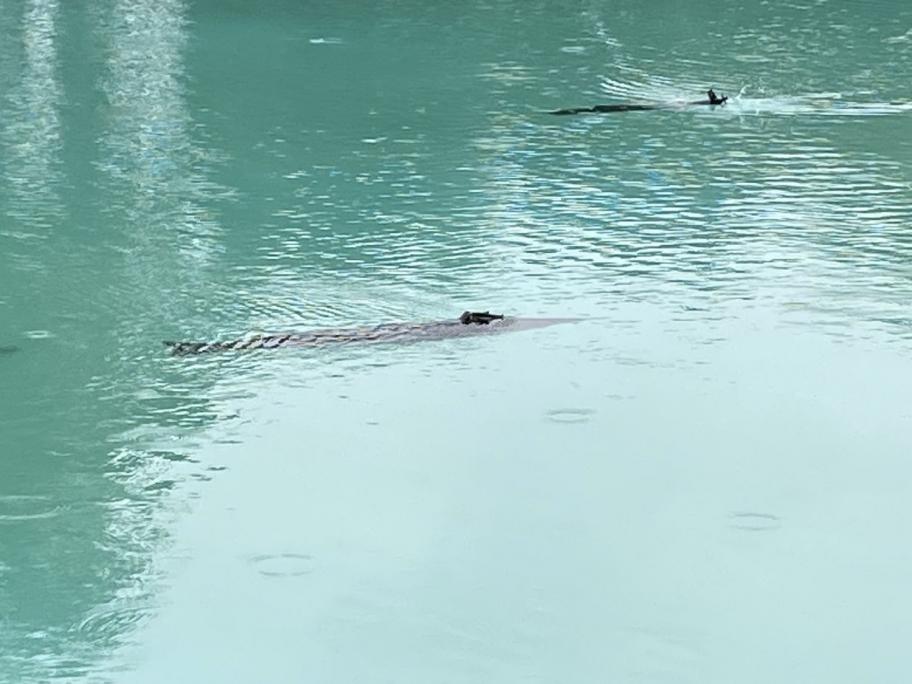

              #81
              For Dave Merriman and me, this weekend was the 'proof of the pudding' of the work of the last year doing the Nautilus. We had bench-tested, and went to a pool that was highly chlorinated that only partially proved the systems, walking away with more questions than answers, but we had no idea what was really going to happen until this weekend. Overall, it worked superbly, and we were both happy with the performance. There are some items to work on, but it performed very well. Got some great video hugging the bottom of the deep end at times. As a result of running out of time, I stuck a glow stick inside the wheelhouse for lighting, and was pretty bright when it finally got dark. Low tech, but it worked.
              • Davjacva
                • Nov 2022
                • 399
                #82
                These are 'proof is in the pudding' photos. Finally have a location to run the Nautilus without any interference. It ran very well and some of the concepts actually worked. As a late response with no lighting, I stuck a chem-light in and ran it for night shots. I was at the mercy of limited video equipment and in-spite of running and taking a lot of photos and video, didn't get a lot, but was thankful I got some. I tried Go-Pro for the first time, and it didn't work well for what I was doing, so I defaulted to an I-phone which took okay photos and video. Driving and taking photos and video really sucks, so Casey helped out, but my phone didn't cooperate and nothing came out. Then Fred had the drone taking video and it didn't come out. Finally Merriman took some superb underwater video and I'll get that this week. See the event page for event photos, this is just Nautilus photos.
