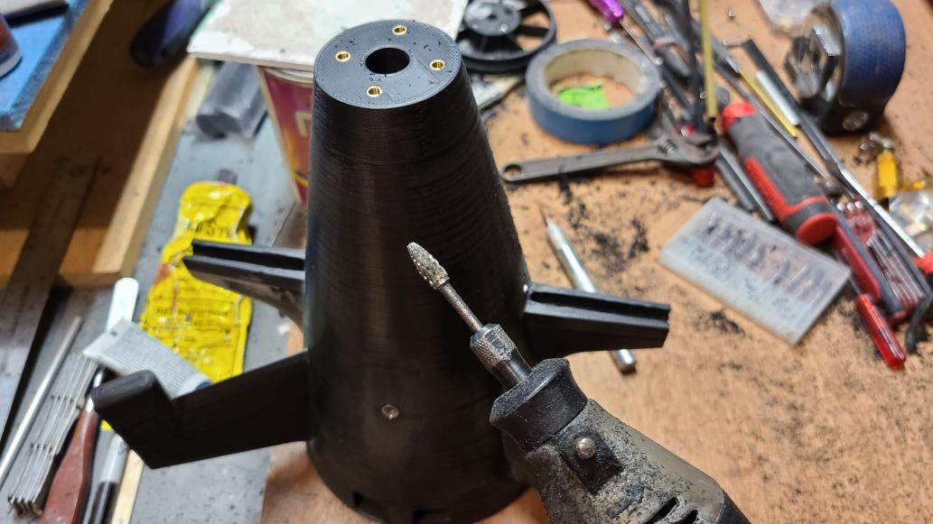

              #66
              David wanted pictures so here is the first one. I milled/ground/blasted/plasma'd but mostly Dremeled the back edge of the fixed planes to accept a tube for the pivot rod to go in. Tube ordered as I didn't have exactly what I needed. In the mean time I will work on the pintle/gudgeon (I had to look that up) arrangement to secure the outer end of the inner planes.
                • 13987
                #67

                Working the trailing-edge of the horizontal stabilizers is a much smarter approach to this problem that what I suggested, Steve. Well done, sir!
                  • 13987

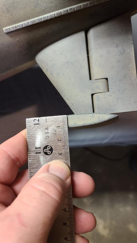

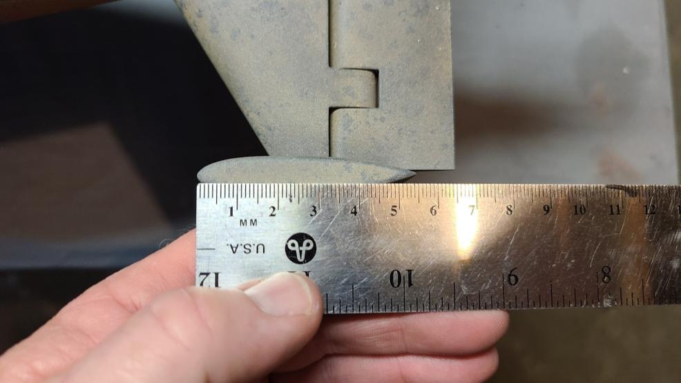

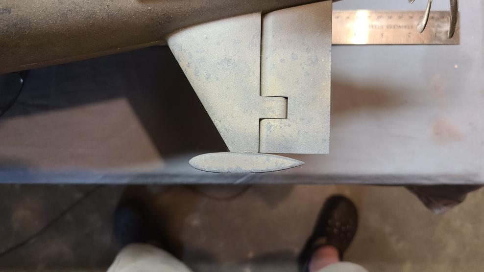

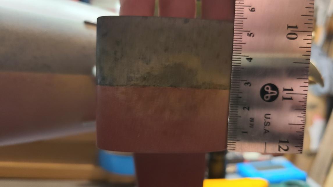

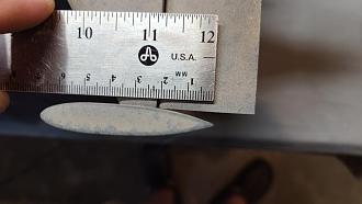

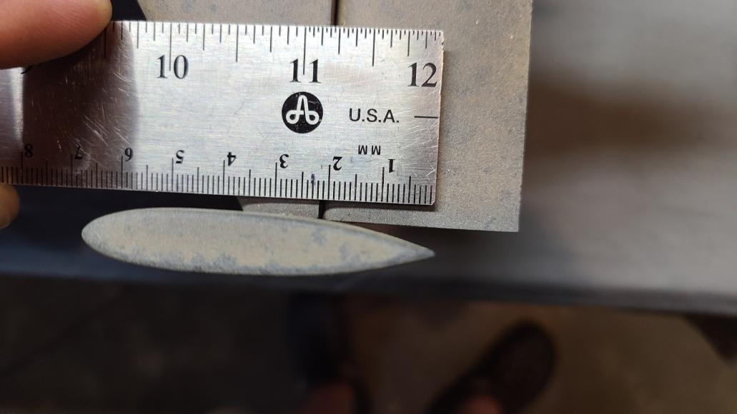

                    How about this? Of course this is what I did for mine. Not saying it is right. Scale is 1/48 and dimensions are in metric because it is just easier. Sorry.
                    Length 55mm
                    Height 53mm
                    Width 10mm
                    Trailing edge to back edge of fixed plane 22mm
                    Overall top view.
                    It is centered vertically with the center of the stern plane.
                      • 13987

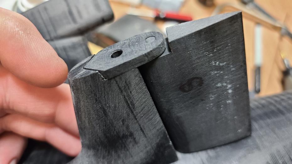

                        You are most welcome. Spent time today designing and printing the gudgeons. Got the starboard side roughed in. They will be secured with small screws thus allowing them to be removable. The tubing I need to install for the tip planes will be here tomorrow and once secured I can sand the gudgeon to its final shape and fill any gaps that may remain.
                          • 13987

                          Nice work, Steve! And looking forward to the final result on those tail-feathers.

                            Echoing Dave, Nice work! That is a good recovery and smart with the screws, allows for easy replacement if required. A lot of our methods don't allow for easy replacement or repair of broken parts

                              Thanks. Yeah as much as possible I try to build my subs with the ability to remove and repair or replace in the event I prang something.
