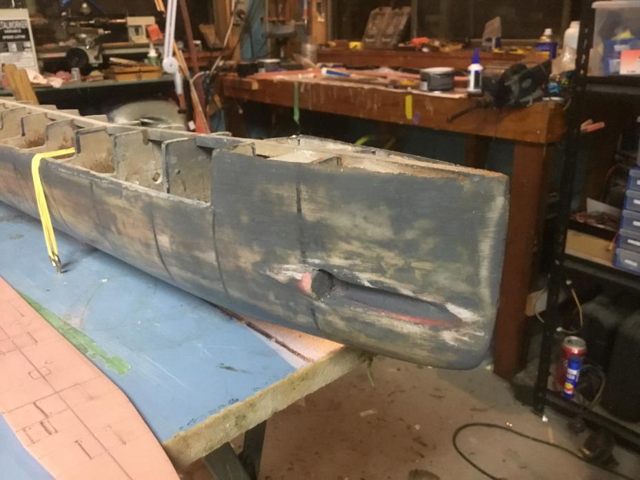

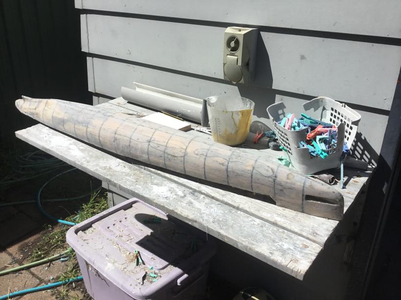

        Thanks for the pics Gantu. That is certainly a different way of doing things. I'm still awaiting to hear from DM if he has any gems about how to go about aligning shafts and working out the shaft exits without making a dogs breakfast of everything.
        After grinding back the sides of the rear hull where the bottom round section of the hull transforms to the emerging Keel and adding extra polyurethane foam on the insides to support it I decided to lay up the hull once again and create the concentric profiles around the hull at the bulkheads. These help give an idea of the consistency of the hull shape and looking down the length allow you to see any areas of deviation in frame profile. I made a vertical profile that I could run a pen around to accurately get the vertical sectional profile of the bulkheads.

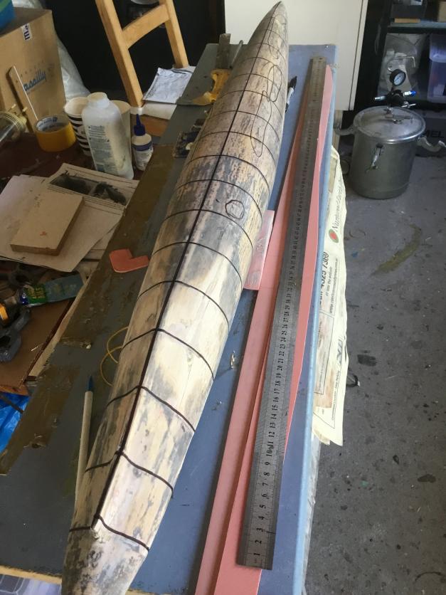

        Once the bulkhead frames have been drawn on and lots of eyeballing later I then filled undulations and low points. Once done more sanding. Particular points are marked with pen just so that I can work reasonably quick before the filler sets. I use a plastic flat surface cut from an Ice cream container and then screed the filler over the low point in a smooth action that creates a very flat mostly smooth surface.

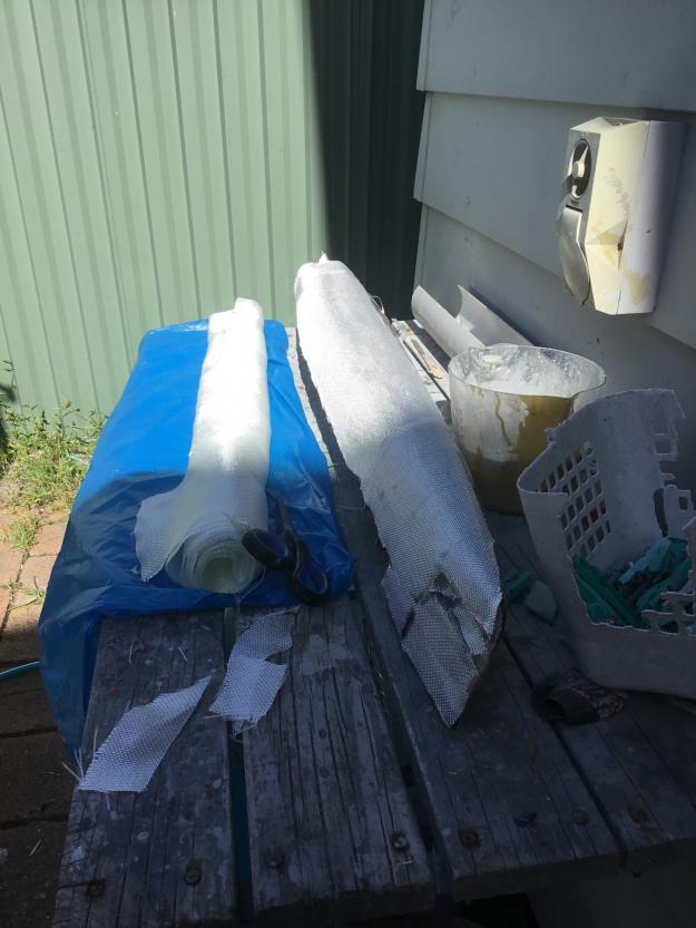

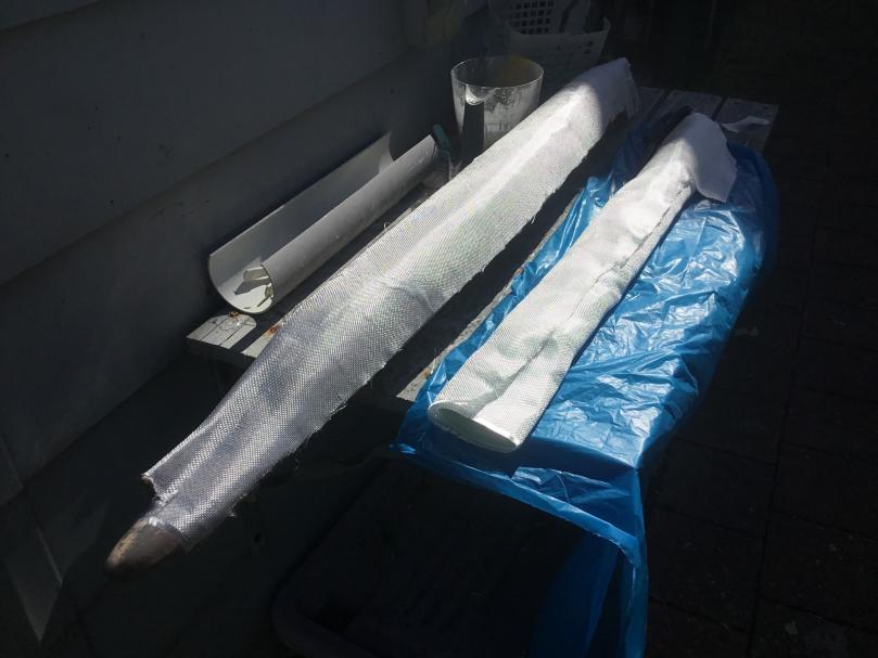

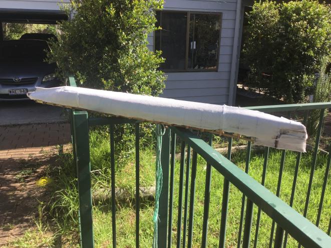

        I eventually came to the point where I would lay down the layer of weave that would greatly add to the rigidity of the hull and further increase and seal the hull and give a little more surface area to sand down and eliminate undulations and low points. After slowly going over the hull and sanding it back thoroughly I mixed up some further resin and brushed it onto the hull and then laid up the 6 oz weave. I did this in sections and whetted it up as I laid it down and then slowly brushed and made sure that there no bits sticking up.
        Initially I laid the weave down before brushing down the hull, in order to get the fit right and minimize overlaying.
        Once done and whetted up I left it outside and let it cure. Even now in March we are still getting residual summer heat , a nice 25 degrees. Once cured, I marked out the high points and then lots of sanding with 80 grit and hardboard backing it. My Biceps ain't bad. This was about an hours worth of sanding. Slowly taking it from 80 down to about 600 grade wet and dry.

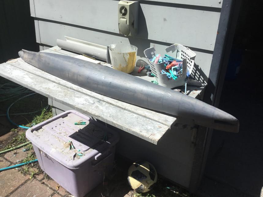

        Once I was happy with this I then gave a light primer coat. This spray did'nt cover over too much of the frame indications.

        Once the primer is dried, it's only a light coat, then I once again marked out the high and low points in the surface that are more noticeable now with the primer and fill and sand. Repeat...
        I really need to start looking at the stern shaft exists. As mentioned in the previous post, I would really love to hear from people as to strategies to make this work without making too much of a mess of the rear end.

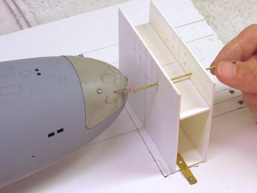

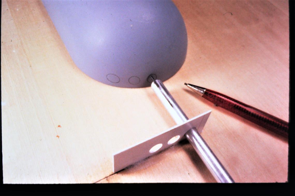

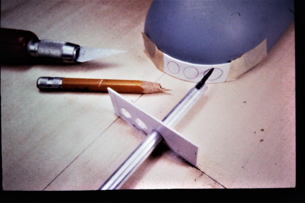

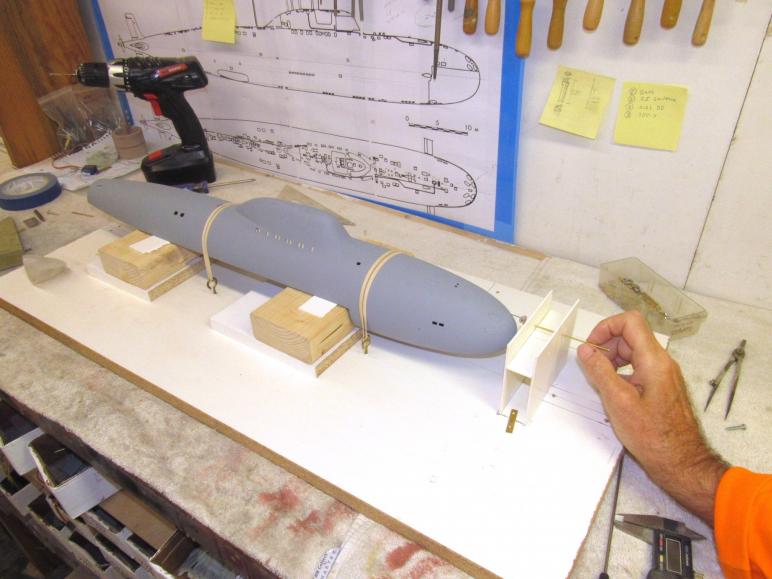

            To establish the toe-in and the other off-sets of propeller shaft-to-hull-centerline hold both shafts at the correct angles in a table mounted jig that establishes the desired off-sets. Plunk the stern down onto the table, sleeve the stern tubes over the shafts, drill holes in the ass-end of the hull, and slide the stern tubes into the hull (the jig tells you where they enter the hull) and glue in place.
            A variation on these torpedo tube shutter-door scribing jigs is what you're after, David.
            Click image for larger version  Name:	IMG_0750.JPG Views:	0 Size:	41.5 KB ID:	148278Click image for larger version  Name:	IMG_0727.JPG Views:	0 Size:	56.1 KB ID:	148279Click image for larger version  Name:	PICT2730.JPG Views:	0 Size:	69.9 KB ID:	148280Click image for larger version  Name:	PICT2729.JPG Views:	0 Size:	76.7 KB ID:	148281
            Who Warships at the Alter of Rube Goldberg

              ‘great jigs, but how do you figure or build the jig to get the torpedo doors where they need to be?
                • 13982
                #37
                You loft the orthographic 'front-view' onto the face of the jig. find the center of the doors, and that becomes the center of rotation.
                  • 3754
                  #38
                  Ah, got it. So, good set of plans is imperative otherwise it is a lot of guess work?
                    • 13982
                    #39
                    If guess work, at least the jig will assure symmetry between the two shafts -- they will be wrong... equally!

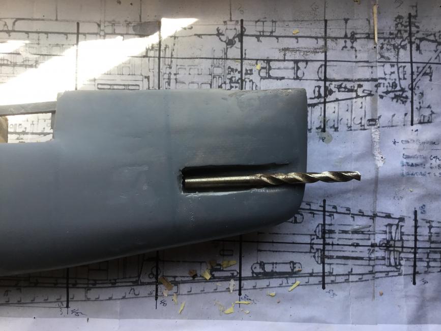

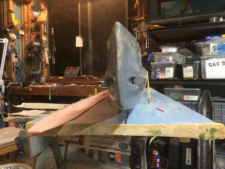

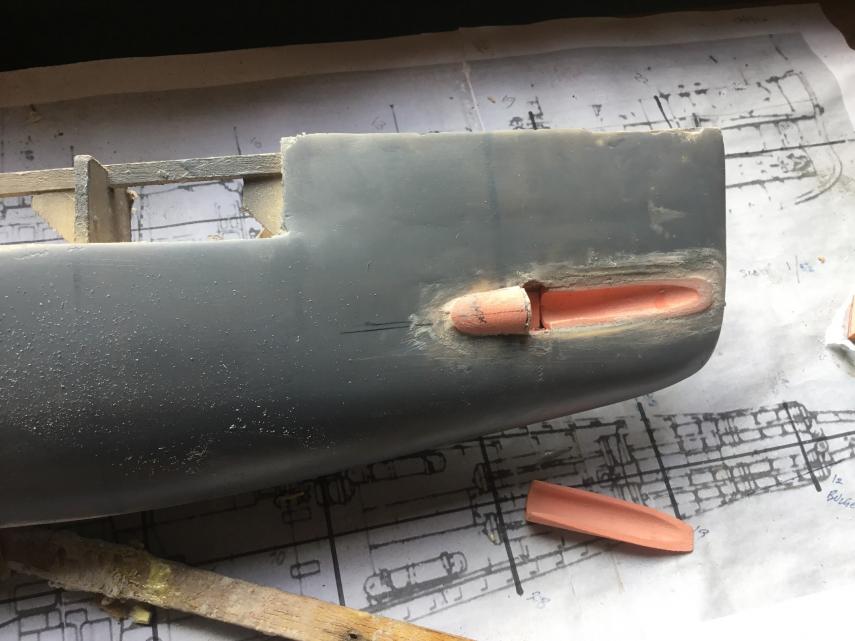

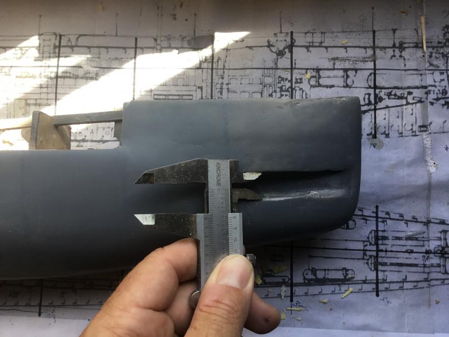

                          The space for the torpedo tubes at the moment currently is a big oversized rectangular box that is begging for something more in terms of details. As mentioned over previous logs I had the dilemma of not knowing whether the torpedo tubes had a boxy appearance rather than having a half round curve. Bernhard Wenzel to the rescue with a picture showing an early U-boat in dry dock with a curved front section of the torpedo tube. The picture looks doctored or even a hand drawing but it was the best I have. The earlier boats such as U-9 have a box like forward tube structure.
                          I decided to start doing some more detail work at the front end of the boat rather than the back end even though I will be going over both. The rear end is especially needing some attention at the moment but I though I would go with the front.
                          I measured the area around the box frame that would make up the tube area and measured the width or diameter of the tubes on the original drawings that I was working off. I used various sizes of drill bits to get a feel of the side and dia of the torpedoes and the corresponding tubes.
                          The width of the torpedo tube space as seen here is about 16mm. This varies as it heads towards the bow. I haven't bothered with sanding and getting the width consistent as it will be filled over with the tube details. I then took a couple of drill bits and placed them inside the tube opening to get an idea of the diameter of the torpedo and tried to get it as close to the original size in the drawing.

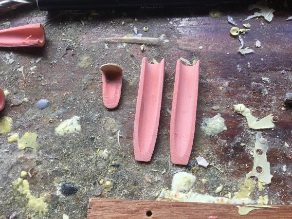

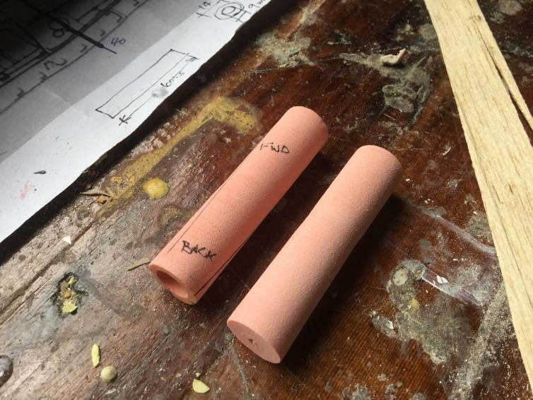

                          To make the curved outer surface of the tubes I decided to take a piece of Renshape and then machine it down to the 16mm width of the outlet then took it a little further just for good measure. I made this piece as long as the length of the outlet. I then took the drill bit shown here and placed in the tail stock drilled a hole through the Renshape to create the hole for the Torpedo.
                          This is the two turned Renshape pieces that will feature in the torpedo areas to be come the front of the tubes or scoops as I'll call them for want of a better term. The second one hasn't been drilled through yet. Back and front denote the back and front end. Once made I then place them inside the recess area for the tube and mark out the line that will see them sliced in half in a gradual curve to follow the profile of the front of the boat and create the scoop. I had to dremel out some of the recess especially at the back of the box section to accommodate the half tube.

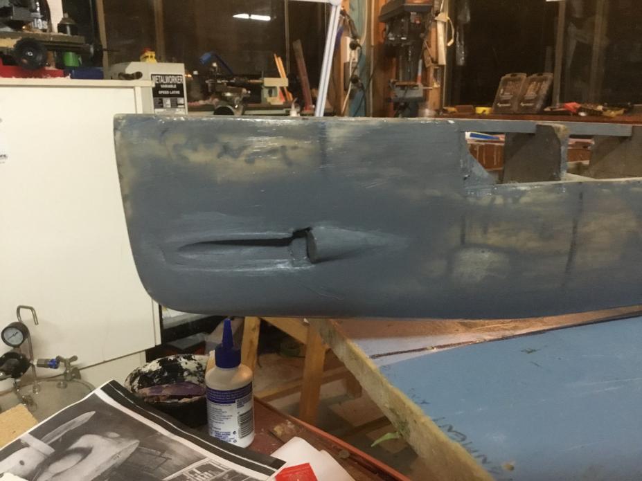

                          I have had to give some though to the geometry of the Torpedo tube doors. On these early subs they seemed to have the door exposed, unlike later and WW2 U-boats there were no outer shutters. As a result it would seem that the doors opened outwards and as far as I can tell they opened inwards with the hinge on the inside of the tube. In order for this to happen then you would need to have space for the door to open which means that you couldn't have the curved section of the tube in the way for this door to open without jamming. As a result I deiced to create a square section immediately in front of the Bow door to give space to the door top open. The torpedo then moves forward sliding past the open door and runs along side the scoop and then on to target.

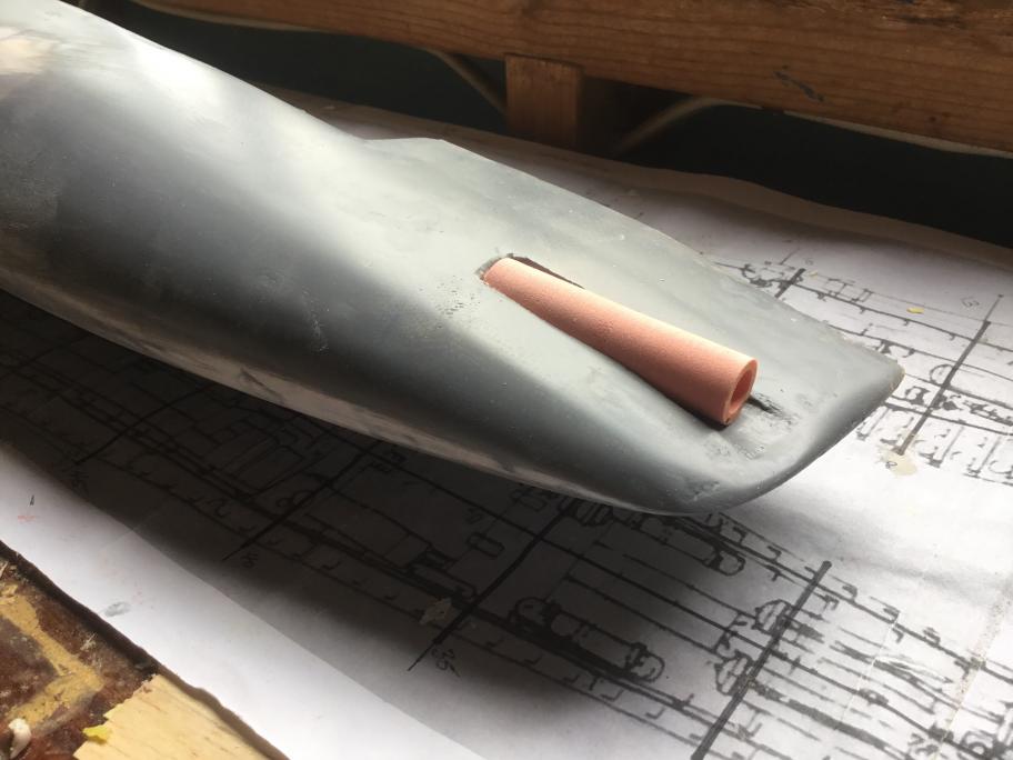

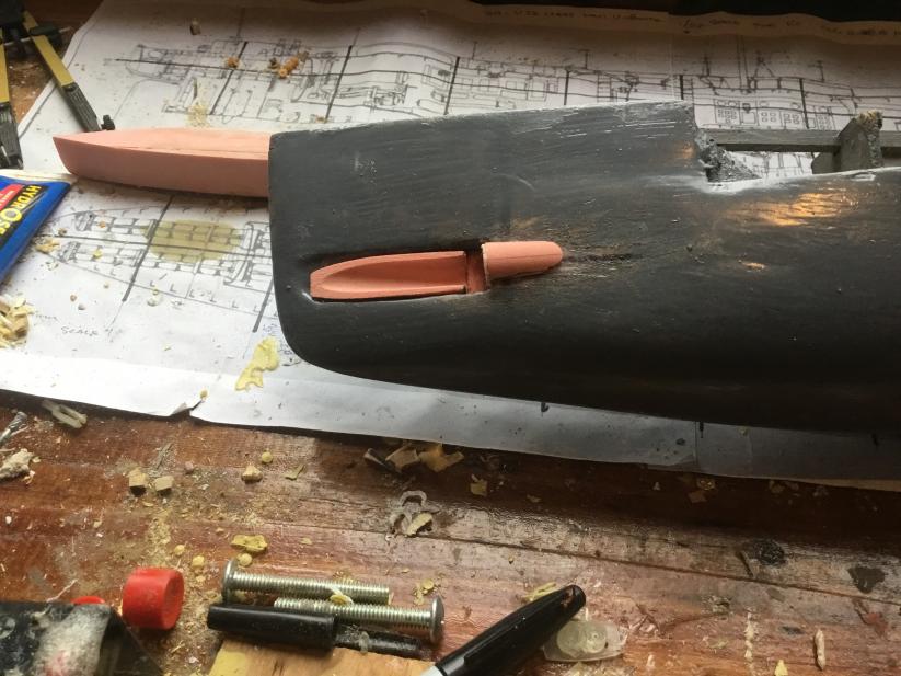

                          The buried torpedo tube terminates with a bulged section as the outer corner of the tube exceeds the curved profile of the hull. As a result there is the bulge that terminated at the door. This was created by
                          cutting a left over piece and shaping it to coincide with the front edge of the tube. I then placed a small Renshape block in place immediately before the tube door outlet and glued into place. This provides the space for the door to swing back. It makes the tube look a bit awkward and not smooth and streamlines but I don't see any other way they could have made this geometry work.
                          The bulge and block in place. The front section needed to be raised at the back end to make sure that it would be in line with the axis of the tube as it comes out of the hull. This meant putting down a bed of filler and at the right time pushing the back end of the tube into the soft filler and aligning it so that theoretically the torpedo wouldn't glance off the scoop as it was heading out of the tube. Then I cut out two small circles of Balsa sheet to cap off the door area and glued them to the bulge sections that would sit as the back of the recess and signify the front of the tubes. Line them up and glue them in place.
                          Early filler, lots more needed.
                          Stay tuned, more torpedo's next week....
                          David H

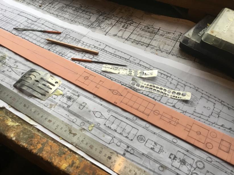

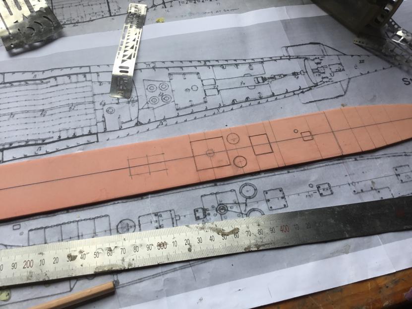

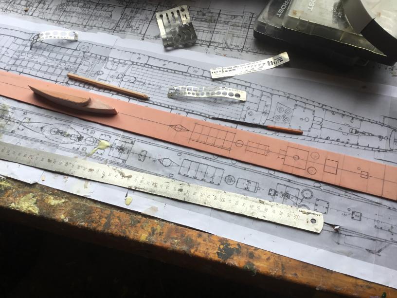

                            For some time I have been working on interpreting the the middle deck section hull detail. Having never built a U-boat before and certain not one that is over 100 years old meant that I was unfamiliar with the layout and parts that would be found on the center deck. Certainly will not find any red and white hatches like I have always worked with on my soviet boats. My inspiration for working out the deck arrangement has come from the main drawings that I have and the images of the U-9 kit that I have had to rely on when the 2-dimensional-ness of the drawings doesn't quite give me enough. The U-9 model has been good for getting the low down on raised items on the main deck. I am going on the theory that from Class to Class there are only incremental changes and wouldn't be a huge change between the U-9 class and U-23 deck arrangements.
                            So I have aligned up the middle section of deck that is made of a 4 mm sheet of Renshape and started marking out the placement of hatches and access panels. Once marked out in pencil I could then start on scribing. I have taken a small fine file and have ground it down to a tiny round point. Renshape is fantastic for scribing into. Scribing on a flat surface is definitely easier than trying to with the Renshape strip already attached to the hull.
                            I have used an array of circle and square templates to attain some consistency. On this boat many of the features seen up front are also duplicated towards the stern.
                            I now have to work through which parts have raised components and which don't. Any more pics that people have of the front deck space would be greatly appreciated.
                            David H
