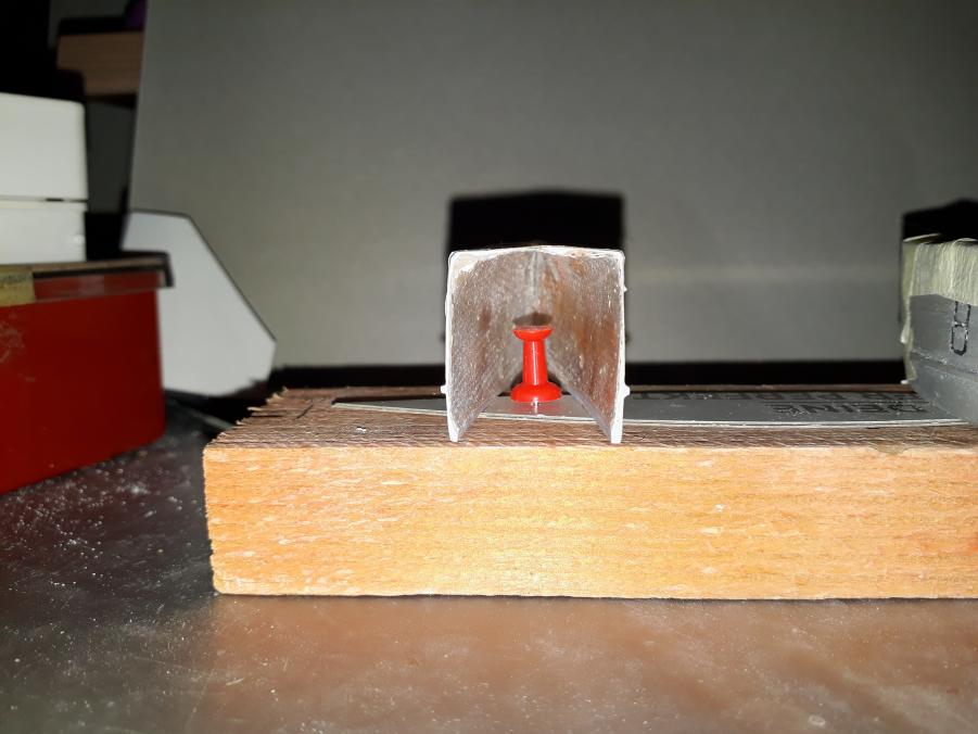

        • JHapprich
          • Oct 2017
          • 1121

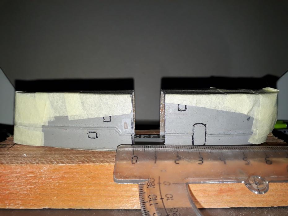

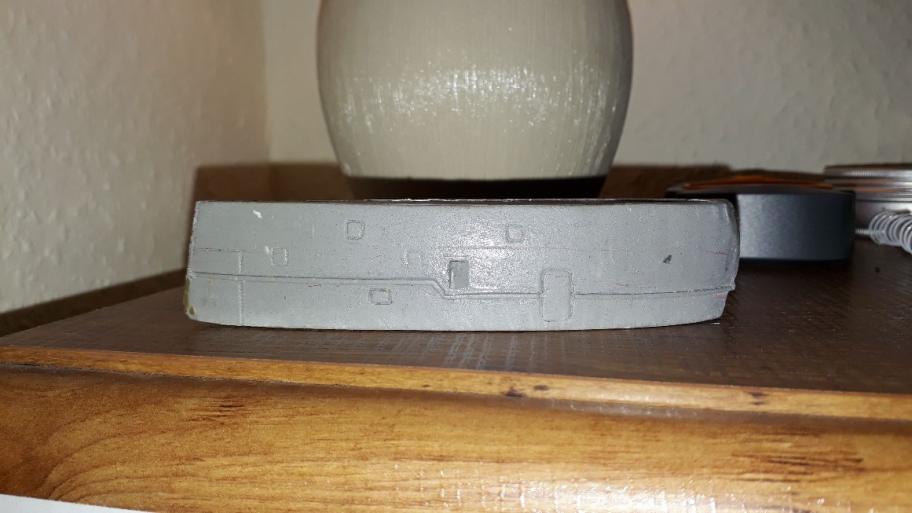

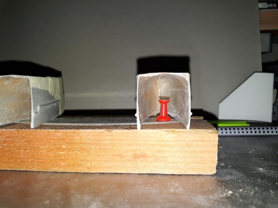

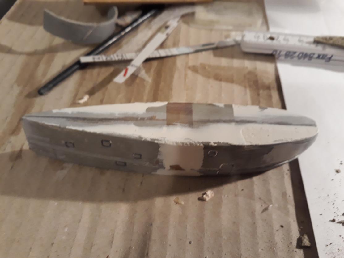

          As visible in the last picture i also cut the conning tower in half after discovering it is 15mm too short. Furthermore, originally the model sail would have slightly inward angled sides.I found several pictures showing sharp 90 degree edges so i would change that as well. So i cut at the widest diameter and made a simple papercard jig to maintain symmetrie. Covered the gap with sticky tape and glassed from the inside ( thank you for the hint, Davidh !). Then filling and sanding. Modified the front contour, too. Still need to work on the details.
          Click image for larger version  Name:	IMG-20200208-WA0003_copy_1161x653.jpeg Views:	0 Size:	48.4 KB ID:	146049Click image for larger version  Name:	IMG-20200208-WA0002_copy_1161x2064.jpeg Views:	0 Size:	52.6 KB ID:	146050Click image for larger version  Name:	20200308_155155.jpg Views:	0 Size:	62.8 KB ID:	146051Click image for larger version  Name:	20200308_155028.jpg Views:	0 Size:	62.1 KB ID:	146052Click image for larger version  Name:	20200308_155017.jpg Views:	0 Size:	59.0 KB ID:	146053Click image for larger version  Name:	20200229_144507.jpg Views:	0 Size:	97.3 KB ID:	146054
          Click image for larger version  Name:	20200313_063510.jpg Views:	0 Size:	60.6 KB ID:	146048Click image for larger version  Name:	20200313_063737.jpg Views:	0 Size:	64.6 KB ID:	146042Click image for larger version  Name:	20200313_063359.jpg Views:	0 Size:	66.4 KB ID:	146041Click image for larger version  Name:	20200318_222135.jpg Views:	0 Size:	66.2 KB ID:	146046Click image for larger version  Name:	20200320_221721.jpg Views:	0 Size:	57.9 KB ID:	146040Click image for larger version  Name:	20201219_213927_copy_2250x1687.jpg Views:	0 Size:	66.9 KB ID:	146037Click image for larger version  Name:	20201219_213915_copy_2250x1687.jpg Views:	0 Size:	62.6 KB ID:	146034Click image for larger version  Name:	20201219_213829_copy_2250x1687.jpg Views:	0 Size:	58.3 KB ID:	146036Click image for larger version  Name:	20201219_213844_copy_2250x1687.jpg Views:	0 Size:	26.7 KB ID:	146038Click image for larger version  Name:	20201219_213906_copy_2250x1687.jpg Views:	0 Size:	57.9 KB ID:	146035

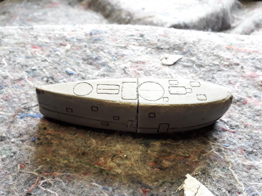

            • JHapprich
              • Oct 2017
              • 1121

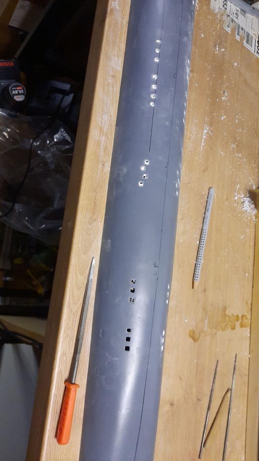

              I continued with opening up the floodholes on the lower hull. The topside will receive a a floodhole pattern different from the provided one after comparision with old detail photos from K-162.
