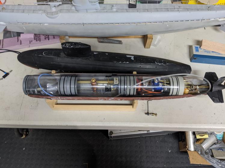

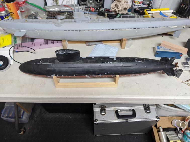

    I finally had time to grind out the all the Bondo that was used as a self forming "saddle" for the original "Small Worlds Models" odd shaped, custom WTC that came with the kit.
    Lot's of dust, I mean LOTS lol. Did it outside with a breeze and still had to remove outer clothing just inside the door per the Admirals SOP (Instead of the aforementioned joke, you can revel in THAT picture!!)
    But as you see, the MSD250 definitely fits! Again great job Dave!

    Now many know she sat for several months submerged in 2016 after a "Grey Lady down" incident, so I need to redo that paint job.
    I'm thinking of stripping it completely as I once did many years ago with the 591.
    Dave, you had recommended if I were to do that, use oven cleaner if I chose not to sand and risk removing detail.
    Is that still the way to go or is the an alternative chemical process used today?

    Back when I used to fool around with HO trains, one of the ways I used to strip paint off of a body was using brake fluid. Dot 3, nothing special. It would have to sit for a little bit, but between that and a toothbrush, I could get paint out of all details. And I would guess the bodies were either styrene or ABS, and it never seemed to affect them.
