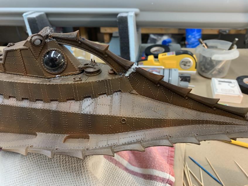

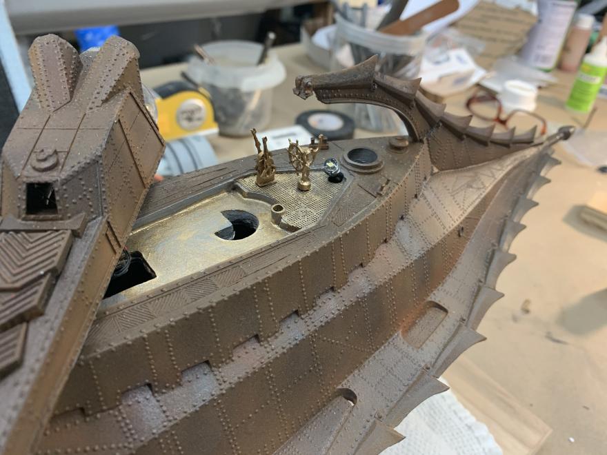

          I was never able to get the rust pigments to show up well after clear coat so I used Nova color acrylics and made up two different shades of rust color and airbrushed a test on the hull with favorable results. I still need a bit more blending but it's working. Clear doesn't diminish it.

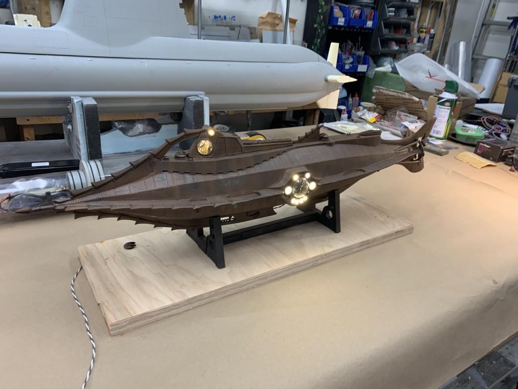

              I started in on the lighting. 20 lights in this little girl. I got in 8 so far. All straw hats 4.5 with 220 ohm resistors and liquid tape to seal off from corrosion. I modified the cylinder as per Bob Martins diagram and it works great. This will never be a true static sit on the bottom diver but it will also never be lost at the bottom of the lake either.

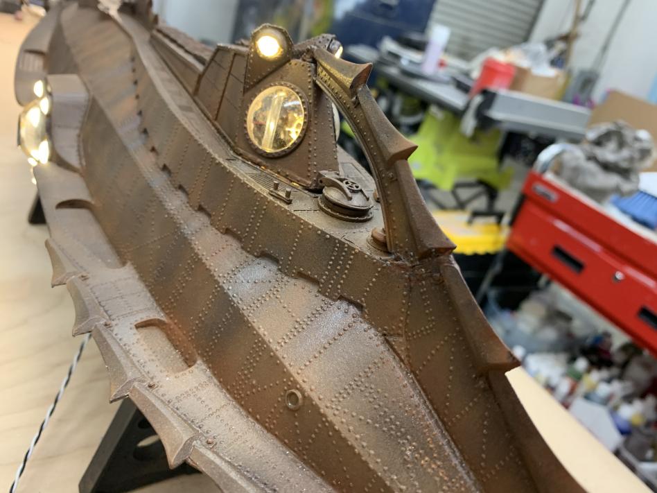

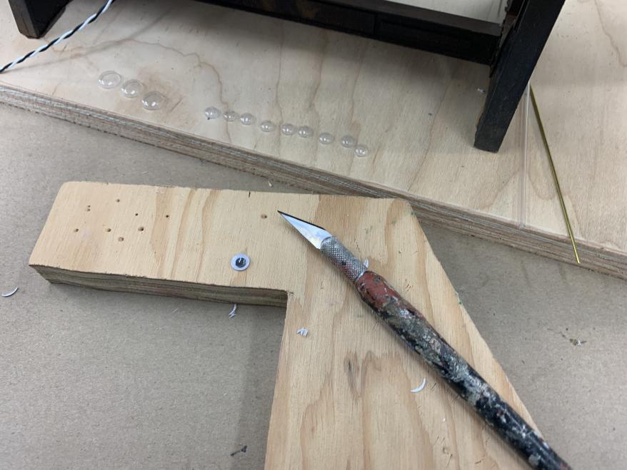

                    Nearly done I got all the lighting in yesterday. Not as neat and tidy as David's but very functional and water proofed with liquid tape. These straw hats LEDs are super bright and will show up on a sunny day at the lake. Once all the lenses are on they will defuse a bit. I used Matt Krylon clear one the googly eyes to frost them which helps.
                    I used warm whites and a warmer one for the wheel house. The wheel house is painted and today I'll add the last of the lenses and wheel house parts and call this boat done. All that's left to do is the WTC wiring and add some ballast and foam.

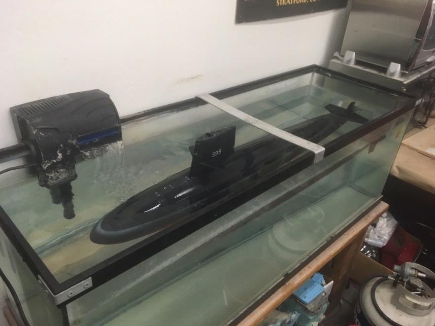

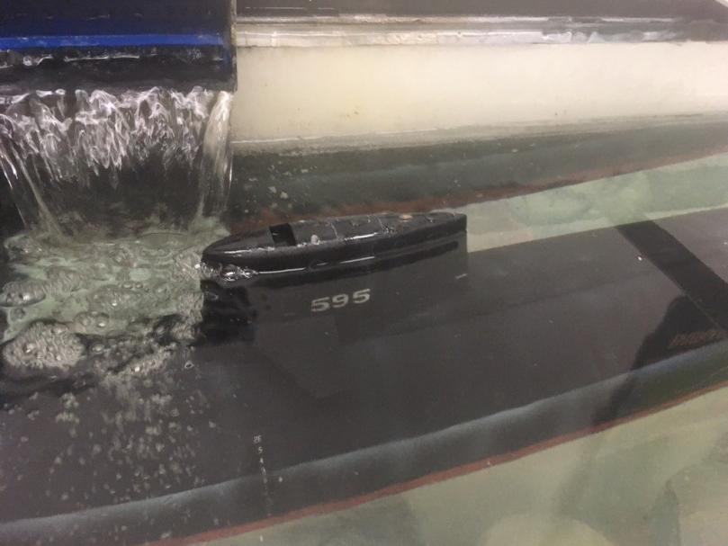

                    Next week it will be time to add water to the test tank at the studio and trim this boat. I have a large fish tank that is big enough I was able to trim my Skipjack in it and some other smaller boats. Makes it nice to test and trim at the studio not to mention the great video I'll be able to get.
