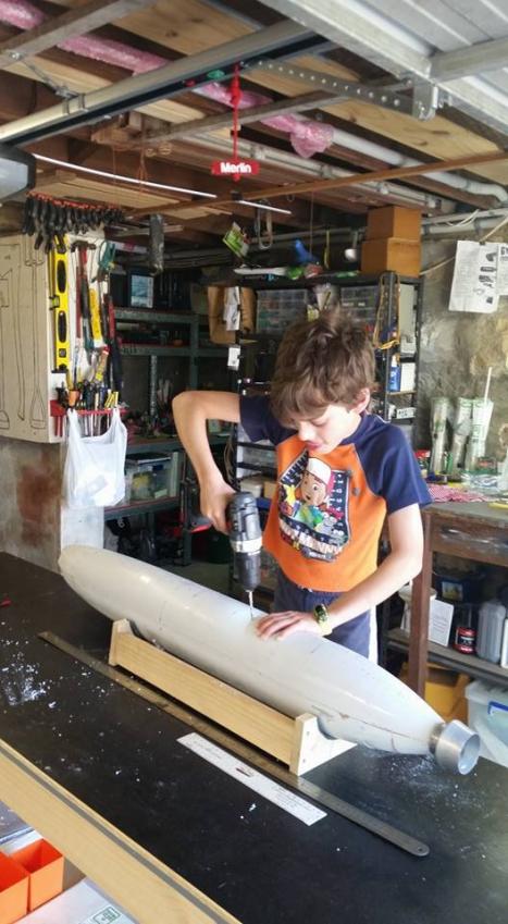

    I'm back at the hobby - my Phd (DBA) is passed and I can get back into having weekends etc. 5 years of "trying" to find and not finding hobby time sucks, but hey I'm glad got the opportunity (read scholarship and tuition) to get a great grad school education. Here in this thread is some work that my son James now 11 and I are working on - 2 OTW subs Trafalgar class (being built as HMS Talent) and OTWs other 1/72 kit of the Valiant. Both are somewhat advanced in the build as we moved house / interstate for a new job I commenced after I handed in my thesis and we did and advance as much as possible on these but not record it.

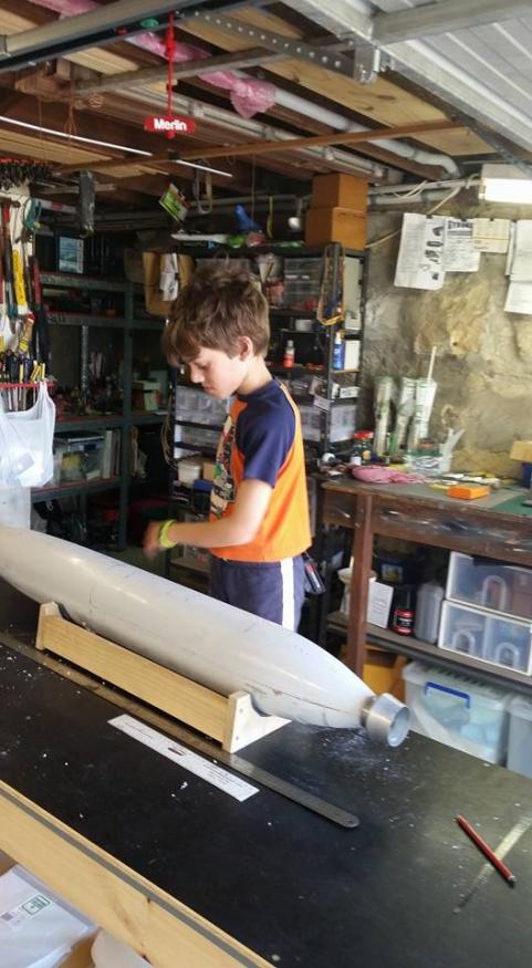

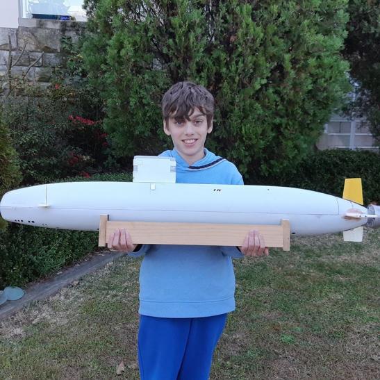

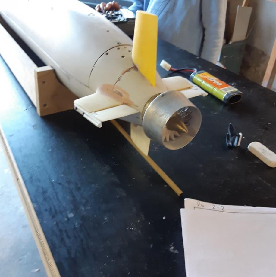

    Talent is being built by James and I have to say the only thing I have touched so far on the boat is the adding the really beautiful pump jet. My son's boat has lots of dings / scraps / drill cracks etc, and he's rapidly cleaning these up. He started building this on his own at aged 7 under my limited time supervision. I'm proud of what he has done so far.
    Conqueror (Conks) has 2 R&R engineering gas torpedoes installed - these shoot tubes 1 and 3. Churchill and Valiant has 3 tubes across the bow. I am utilizing the R&R torpedoes - these are not 1/72 scale, and the best I can make out is that their around 1/48 scale in length and around 1/60 scale in diameter. As the external doors (square / oblong) on Conks is larger than the inner doors of the tubes I can fire the over-sized fish through the 1/72 scale outer openings.
    I have had David's fine 1/72 torpedoes previously. They worked flawlessly. However, I'm going with bigger over-sized fish in this model as I can simply see them better in the water!
    Photos below - James starting off and finishing the basic boat building (appendages etc).

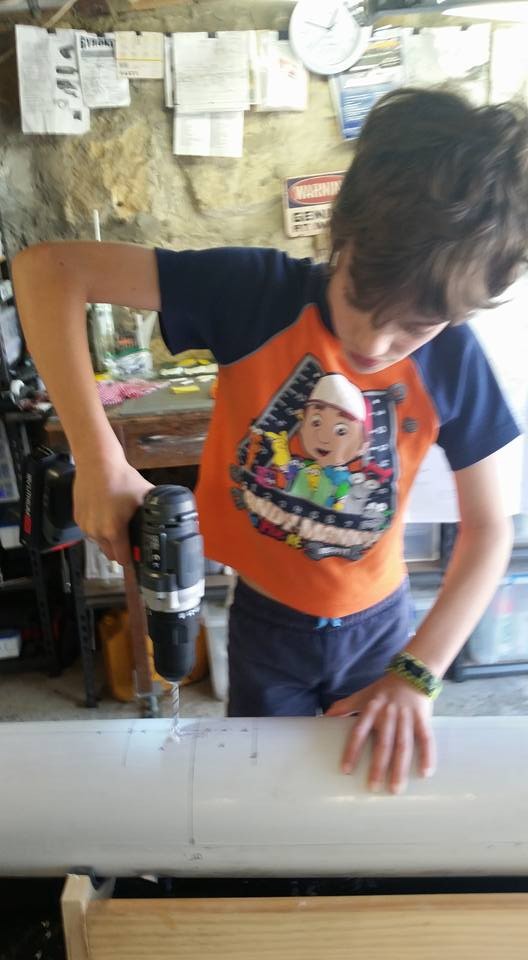

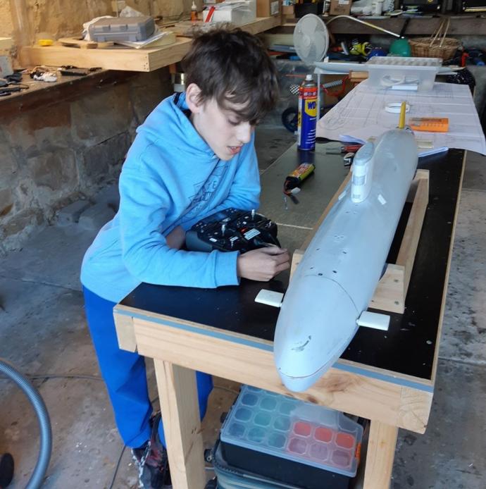

    Some Conks photos
    On the bench in the new workshop in a new state!!
    Doing some planning on how to make the cut for the demarcation between pressure hull and upper casing.
    This whole structure has triple duty.

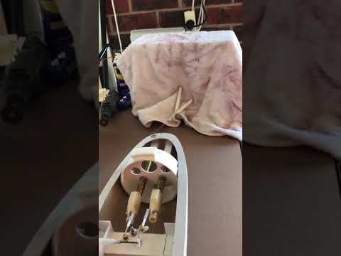

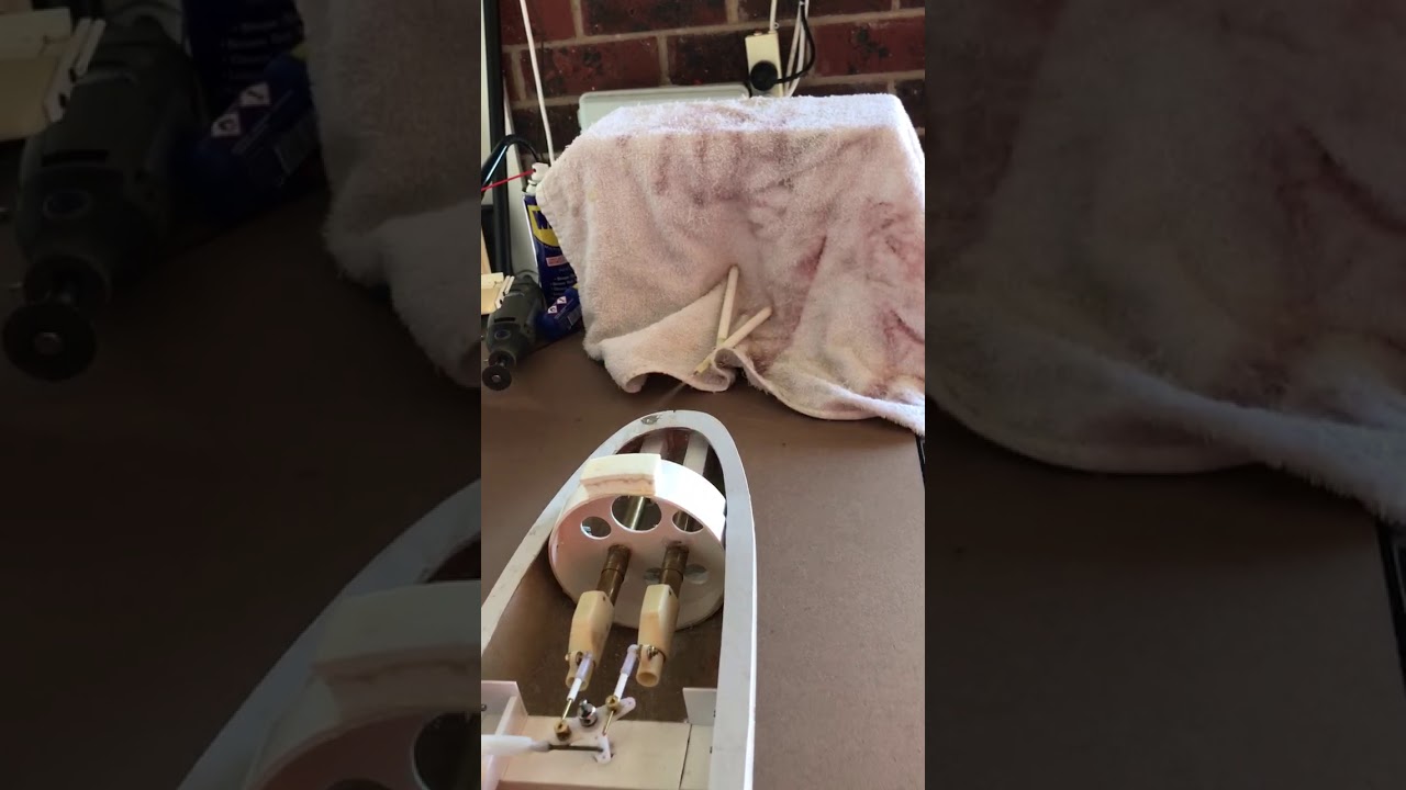

    The mechanical fire control - uses a simple servo push via magnetic mechanical safety (yes there are 2 other electronic safetys built into the radio)
    The structure aft captures the valves that hold the torpedo in place and are released at the back of the tube. The upper structure holds the top hull half master stainless screw.
      More Conks - the torpedo system
      Video test firing:
      Here is a test video on the bench of firing Tubes 1 and 3 (Conks had 6 across her bow).
        More work on the casing and details James jumps in to lend a hand

        The casing cut was made with a Dremel along a pre-drawn line. A flat file expanded this joint. Finally a fresh layer of throughly wetted out fibreglass was applied inside the hull to span the join and strength the weak point caused by the cut.

                  Here is the test of the torpedo system

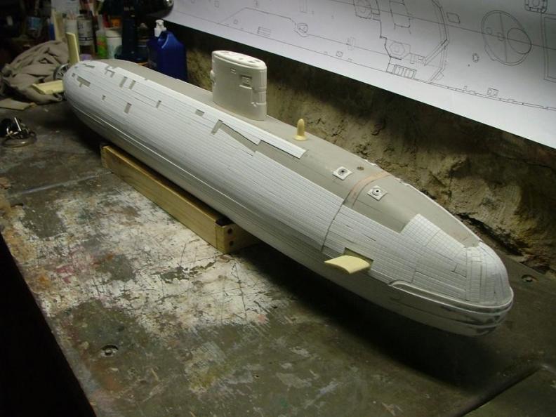

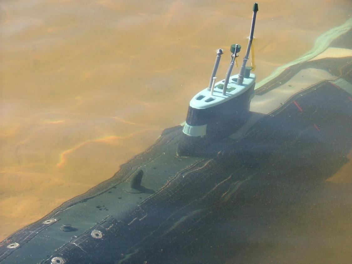

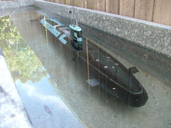

                    uploading these old photos of Trenchant - a former OTW Trafalgar build of mine. Just testing how to post photos.
                    James won't be going to this trouble on his of gluing tiles, we will use a paint mask and airbrush away.
