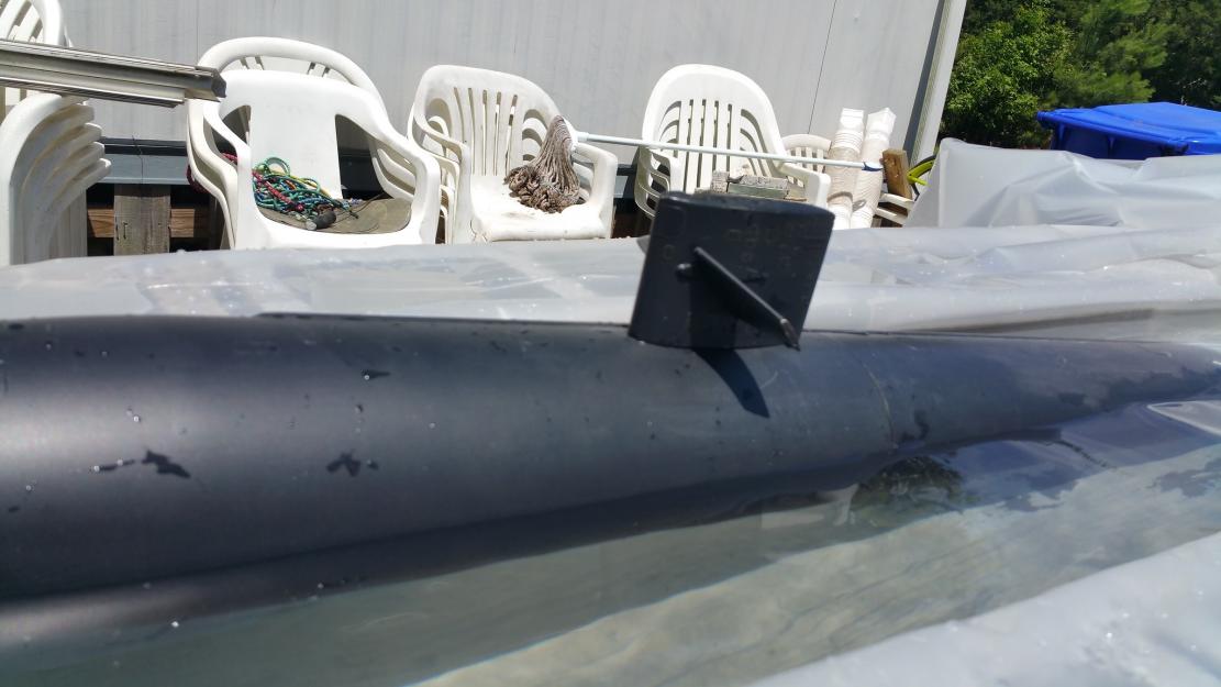

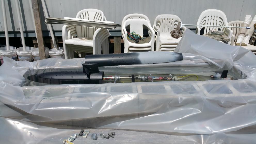

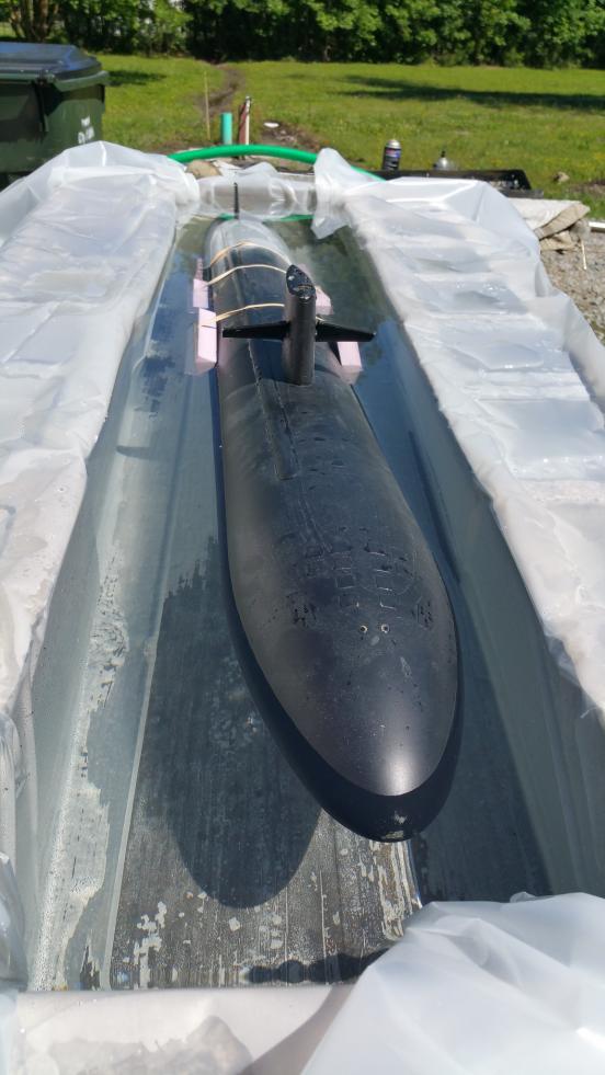

    After a small amount of thinking, I came up with an idea for a test tank. perhaps not the greatest, but it worked. Cinder blocks and plastic sheeting... easy. Only issue is it's only about a foot deep, which should be all I need. I took a guess at what kind of ballast I would need. Judging from the 4 or 5 lbs I had to put in the tugboat to get it to sit at the waterline, I put all the lead I had on hand in the keel, and dropped the boat in the water without the top hatch.
    Sank right to the bottom. Ok then.
    I put a more reasonable amount of weight in and dropped it in. Got this, and if it's not obvious from the picture, there is zero roll stability, as expected:
    That's not a bad waterline, though... but once I put the hatch on, it was a whole new ballgame.. that additional weight didnt' work in my favor, again, as expected. If you look at the bottom of the picture, you can see the weight I've removed. Just for ****s and grins I submerged the boat to see, and not surprisingly it went right to the bottom of the tank and sat there. Hard. I blew ballast, and it came right up, in fact, it didn't take more than a few seconds for it to get positively buoyant and broach. I kept blowing, expecting to see air bubbles, but apparently the escaping air filled the hull and it got really buoyant:

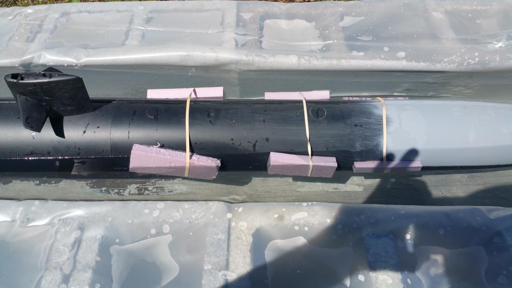

    It also didn't help that the weight slid around, and went aft when it took the up angle. Let's get some roll stability... so I cut some pink foam and worked it around a bit..
    And that's where I am right now with the waterline. it's got the good LA lean going, prop is entirely underwater. Roll stability is very good on the surface, it's a little more tender under the water but that's expected. Submerged it's just barely positively buoyant... it does sit on the bottom of the tank but it's very light there. I wish the tank were a little deeper. it does seem to submerge stern first and rise bow first. I'm going to hold what I have here for now, I'm certain some trimming is in order but I have other things to do and I am going to add another layer of cinder blocks to make the tank deeper. One thing that really surprised me, this is all the ballast I used:
    I thought it would take a lot more.

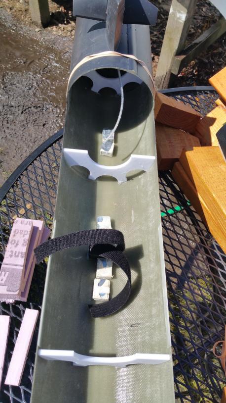

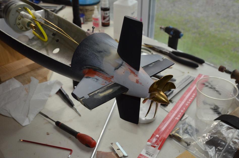

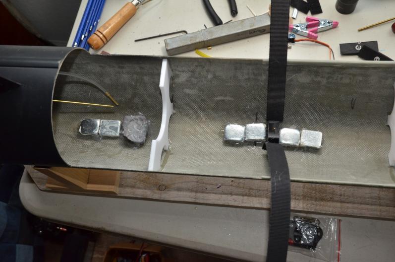

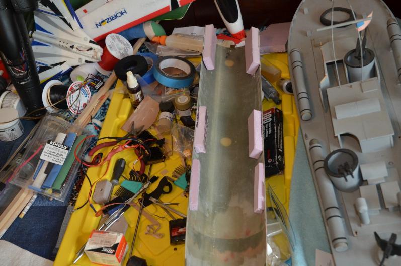

          Busy doing other things. My how time flies when you're having fun wrestling with machines. Mechanically, only small details remain until the maiden voyage. I affixed the lead and foam (and not very much of either!) with hot glue, which should allow for repositioning as required. I know, the cool guys use silicone, but I've had good luck with hot glue, and it's easy and fast.
          I had to relieve the foam to clear the locator tabs on the lower hull.. nothing to it. I installed the stern planes and rudders, only thing left to do is to secure the free half of the adjustment sleeve and lock the adjustment in. I was considering using a wheel collar to do that, it will require some thought and some soldering. I'm trying to decide if it's worth it to leave it adjustable, there's no real reason to think that the alignment will change unless bumped. So I'll just keep it simple and secure with some super glue. Simple is good.

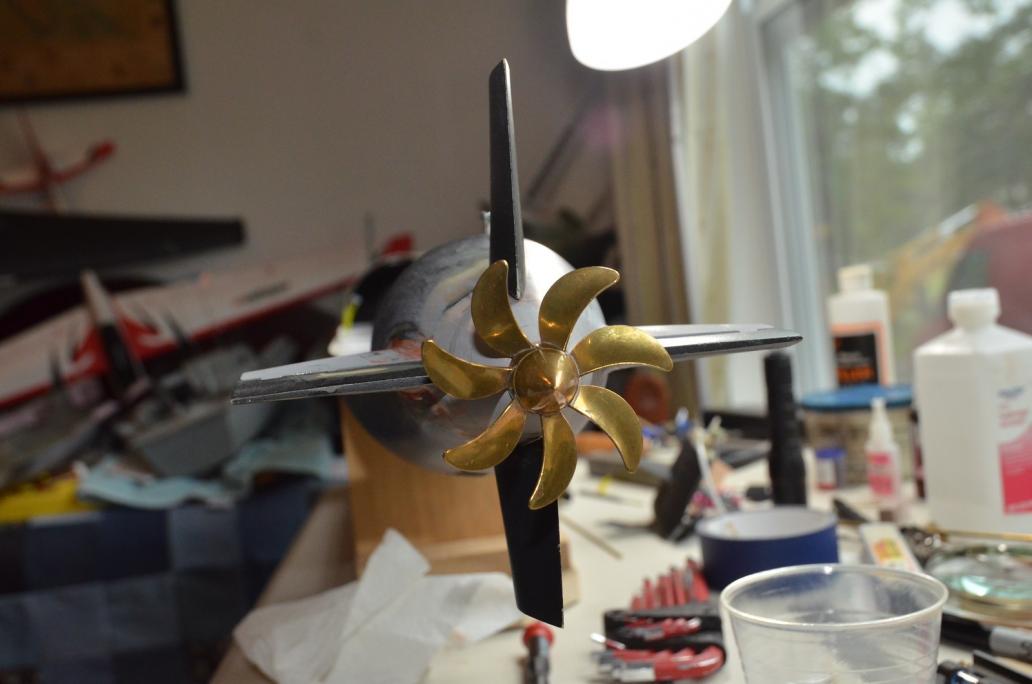

              Hello,
              I take advantage of the subject to ask you the question about the propeller.
              I plan to build an 1/72 LA Class, and I already have a 3.75" 7 blade scimitar OTW propeller purchased with an old Upholer hull.
              Do you think it's suitable for this boat or too big ?
              I searched everywhere on the web, I did not find the size of a real LA prop (probably classified).
              Nothing specified on 3D printed kit.
              Your opinion ?
              regards

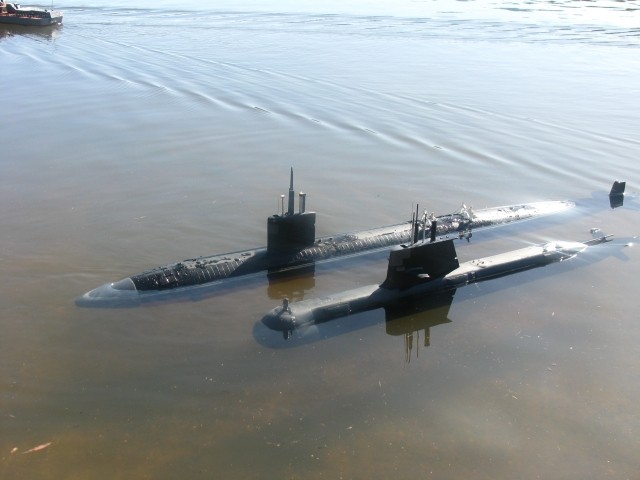

                Here's a pic of a later VLS armed 1/72 LA class from a few years ago up in Sydney...
                .Click image for larger version
                And with a Collins class RAN boat..

                  I have a propellor on mine that is just at 2.25" in diameter. At what appears to be proper surface trim, to me, the propellor is completly under water, as it is on most U.S. boats. I'd have to suggest that your 3.75" prop is going to be just a little too large. If you have scale plans, you could make an estimate based on where you think the waterline would be, and gauge a prop size from that. I can't say whether or not my prop is too big for the motor I have, it's a little larger in diameter, but not much, and generally subs aren't hot-rodded around anyway.
                  I know I've been slacking... have some other projects that require more immediate attention. Thats life...

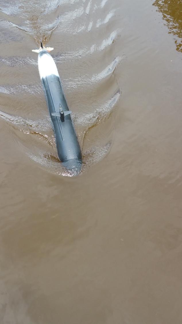

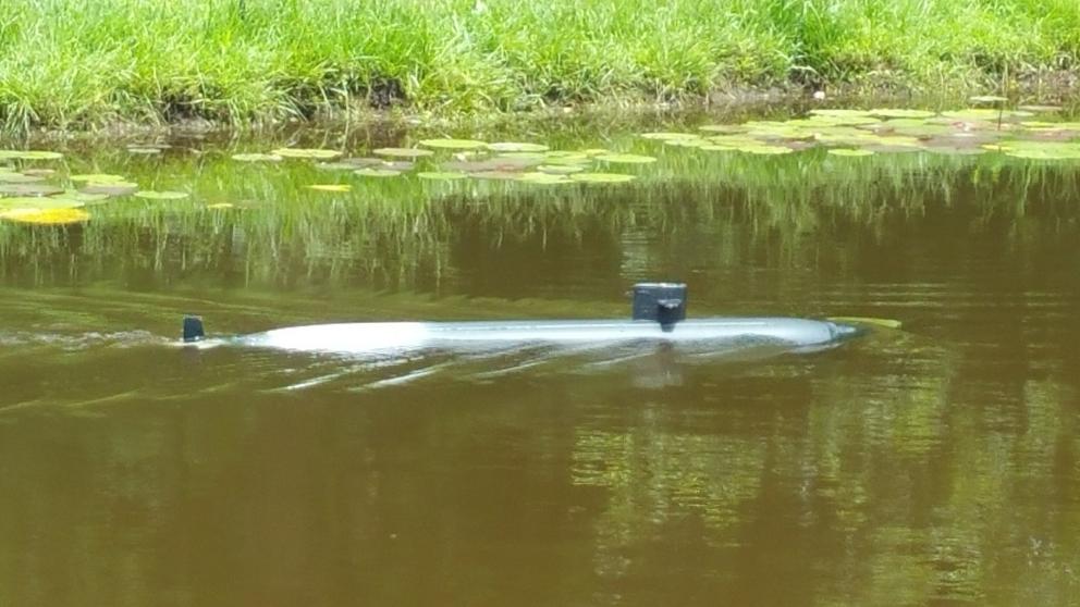

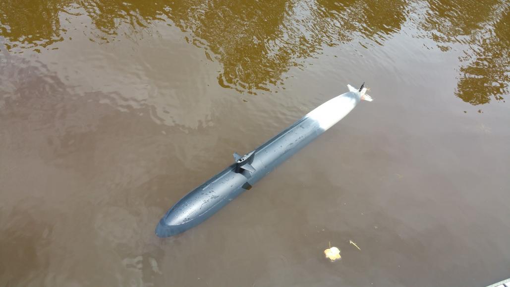

                    Back in the water! After a carefull, educated guess about where to put more weight and foam, I did so. No test tank this time.. right into the open... pond. Anyway. Surface trim looks pretty good:

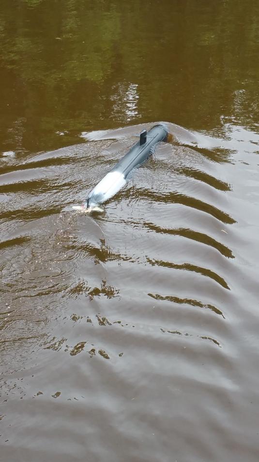

                    So lets get underway. First thing I note is that stability is much improved. I did some full ahead crash asterns, and while the boat rolled significantly, it came back to vertical very rapidly. So no worries there. I also note that the turning circle is very large... very very large. Even on this giant pond I had to back down and to a couple J-turns. I need to get more rudder throw, and I think the only way to do that is a longer horn on the servo.. more on that later. Other than the gray section, it looks pretty good in the water moving around. 2 clicks of throttle are all it takes.. any more and the prop starts to cavitate. More than enough power, I think. It is apparently very heavy, as backing down takes a fairly scale amount of time, even with full throttle.
                    Now.. the bad news. I did a static dive pierside. Went down stern first. I mean straight up stern first, and wound up with just the bow above water. On a plus note, it seems to have some positive buoyancy, so there's that. I don't think I can redistribute any foam, really, so some lead right in the bow and we'll see what that gets me. I can still put some foam way high, where it will only affect submerged buoyancy. But that's another day. I also note that backing down on the surface it showed a tendency to drive the stern down with some way on. Probablly related to the previous issue. Kind of hairy, really, when it happens.. but the pond is, at worst, chest deep where I'm running so I'm not terribly worried...
