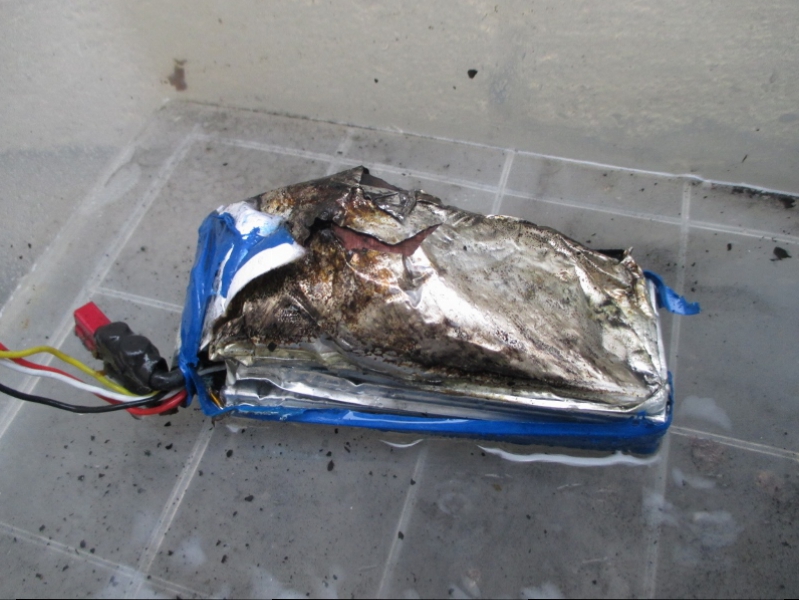

    I've seen enough scary vids of these things going on fire, so seeing one of them was developing a bit of swelling, I decided to dispose of it.

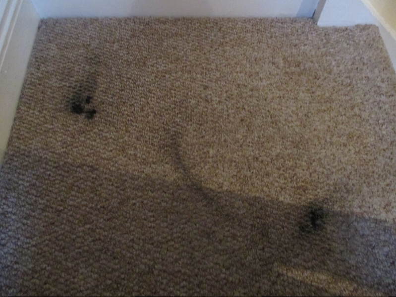

    As I was bringing it downstairs, perhaps I squeezed it, but it went on fire, igniting within a second and setting off the house fire alarms. Luckily I dropped it before it burned through my fingers, but it did a fair bit of damage to the carpets. Managed to kick it into a tiled bathroom where I could get some water onto it. The top two floors of the house were completely encased in noxious smoke for about 10 minutes.
    Here's some of the damage...............around 600 bucks of new carpet will be needed.

    And here's the remains of the little b*****d........................

          Most lipos will puff, if I binned every lipo pack that swells i’d go through them like smarties.
          You were unlucky. Sadly lipos are highly flammable if the plates short- many think it’s the lithium causing the flames, but there’s only about 2% lithium in the pack, the electrolyte is the chief culprit that burns. A lot of effort is going into creating a solid electrolyte for lithium batteries, but they’re not there yet. Manufacturing is reaching the limit of lithium battery technology in current forms, which apparently hasn’t altered greatly since the batteries were first introduced to the market in the early 1990’s by Sony. When they do perfect a solid electrolyte, manufacturers will be able to use more lithium in the batteries, which will hugely increase capacity, believed to be up to ten times what is available today.
          With present tech, increased capacity has been achieved by moving the plates closer together, but this makes the battery more vulnerable to shorting if it’s physically damaged. Remember the furore over the Samsung Note 7, with new phones combusting in handbags and pockets? That lead to a total recall and cost Samsung billions, and the problem was down to a very high density battery, combined with insufficient delicacy when assembling the phone.
          Physically tougher lipos can be found in the cylindrical 18650 cells (the first four numbers dictate the dimension in mm e.g.18mm diameter by 65mm long) These are made in very high volume for use in laptops, electric cars (e.g. Tesla) and the good thing is, they’’re a standard size. Capacity wise they tend to top out at around 3.5Ah , some have better c ratings than others mind you. Higher capacity batteries are available in larger sizes, but the choice is lower and the price higher, because they’re not made in such high volume. So for instance you can get 26650, and Tesla have developed a new battery with Panasonic for their Model 3 car, 2170, which has high capacity and c rating for its size.
          These cylindrical batteries have a strong case like the more traditional Nimh and Nicad packs. They find less favour in the modelling community partly because of extra weight, which is a big deal for performance use, especially in aircraft, but also partly becuase many modellers are unaware of the alternatives.
          Lithium iron phosphate is an alternative chemistry. These are far more stable than lipo, but have a lower energy density. They have a higher upfront cost, but a longer cycle life, so work out the cheapest battery technology long term. A123 had the finest LiFe batteries, the sad demise of that company demonstrates the best tech doesn’t always win, but you can still buy their batteries. They have excellent C ratings, as they were designed for electric cars from the outset.

            Don May gave a very informative talk on Lipo batteries at the Carmel Funrun. I learned that if the battery has swelled to cut the leads off, one at a time, and dunk the battery in a bucket of water. In a few days the water should neutralize the battery so it can be disposed of. Also, always balance charge the battery and discharge it so it is at no more than 60-70% charge for storage.

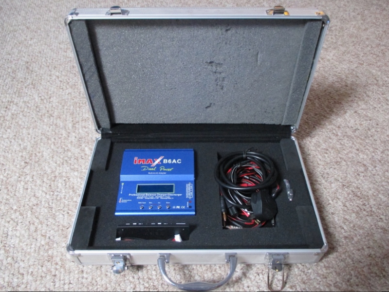

                      Thanks for all the good advice, and just to confirm how 'anal' I am about this stuff, here is the storage case for my charger and leads, so they don't get damaged.
                      I've ordered some fire retardent Lipo storage/charge bags.
