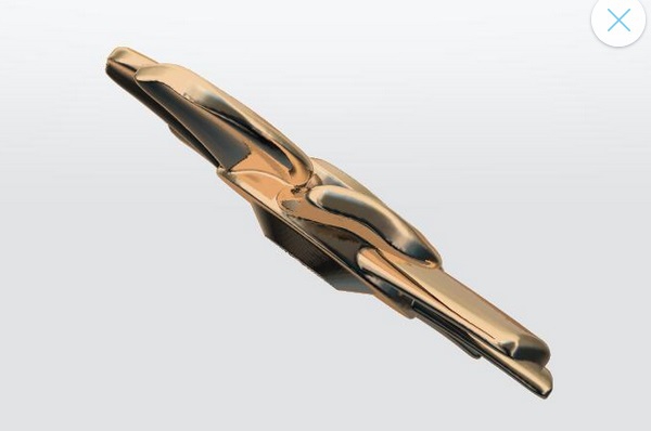

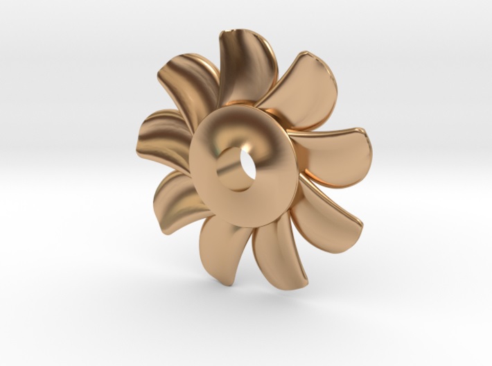

While we're at it, I have a question for the headmaster... Do you recall when you fabricated the impeller for the 1/144 Seawolf what the overall diameter was? I finally hooked up my setup and was beyond pleased to see it works, but I'm curious how my prop compares to one that's proven. Mine was designed by a fellow from Spain on Shapeways who intended it for RC use, but to my knowledge has never tested it. Attached are a few 3D photos. It measures 35mm and is cast in bronze. I've done some hunting for 35mm props / impellers, and while there are a couple out there, the options aren't great. I'm size limited due to the dimensions of the impeller shroud, which is also a 3D printed component. I could use the kit supplied impeller shroud and a slightly bigger prop, but it would require some redesign of how it attaches to the stern on my boat.
A few observations:
* Whatever poor handling characteristics the stock Trumpeter Seawolf exhibits are made even worse when you stretch her into Jimmy Carter.
* All testing thus far has been with an un-shrouded prop, for what that's worth. I intend to attach it with some RTV sealant so it can be removable if need be in the future.
* My prop, as is, with the stock 2" SD motor does power the boat forward. Not achingly slow, but it's not also not a rocket. I suspect if it were faster, the rudders and planes might exhibit a bit more control authority. I also realize it's nearly 4ft long, and those little rudders can only do so much at their scale size.
