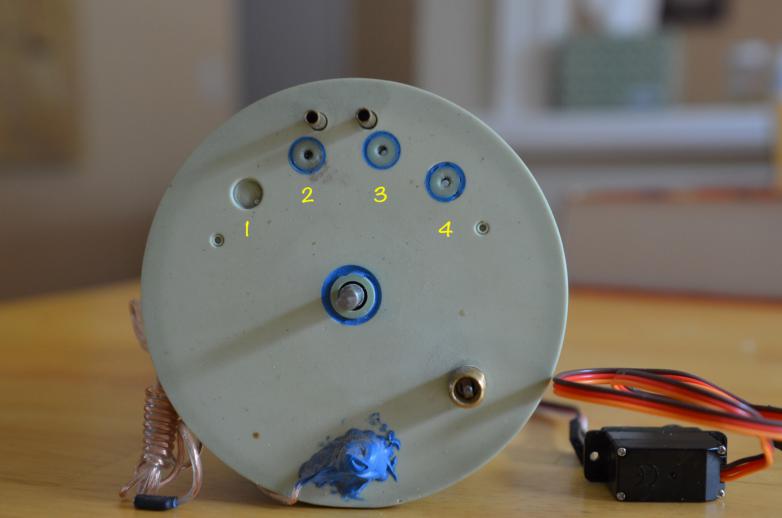

          Couple of questions. I have these EMax servos, they are micro yet places out there call them mini. They sufficient for the Skipjack? I'll have to make a few adjustments to have them fit properly.
          Secondly, what is the proper arrangement for the rudder/planes pushrod output thru the bulkhead? I have one which is blocked and I will drill and add a seal for something I'm planning, so will use all 4 positions.

            • 13094
            Yeah, those servos have enough ass to 'em to move the control surfaces without problems.
            #2 - rudder, #3 - sail planes, and #4 -stern planes.
