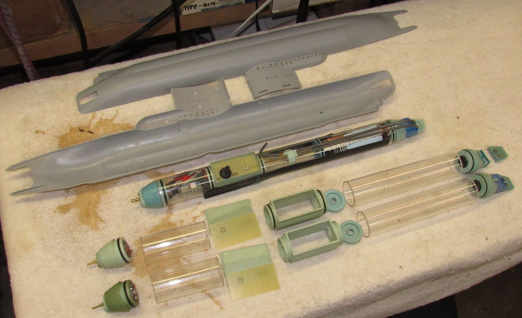

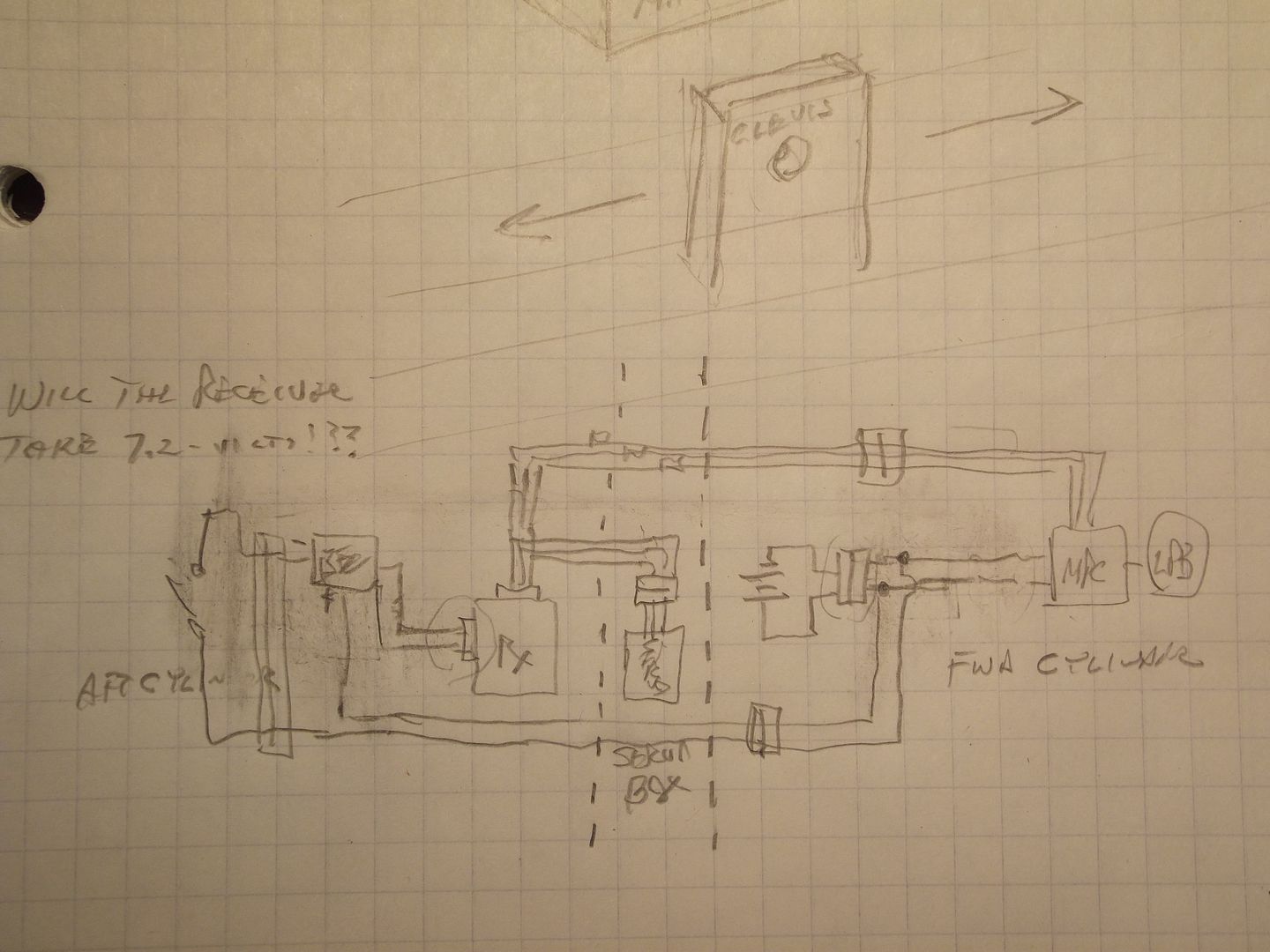

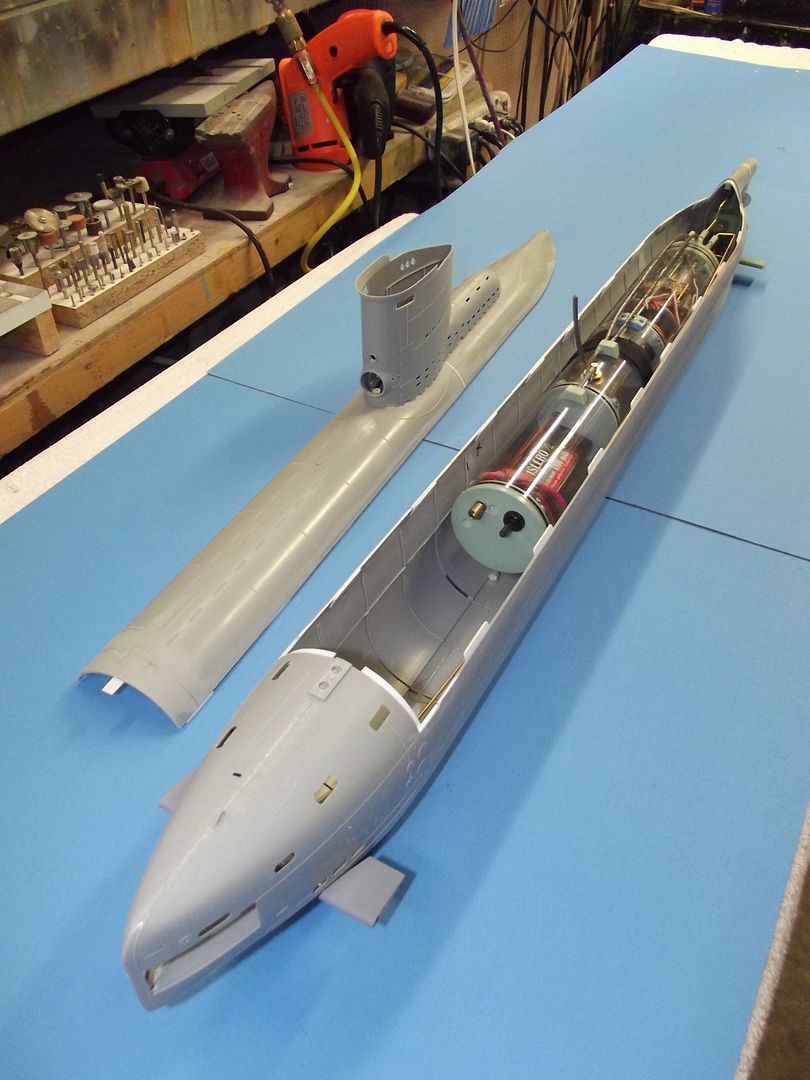

                I've started in on the two SD's for the 1/72 Type-23. Tonight I'll glue the two halves together and later in the week cut the hull equatorally. Follow along at home, Matthew.
                A little bit of scale for you:
                A rough of the wiring involved and the devices:
                The SD will eventually look something like this:
