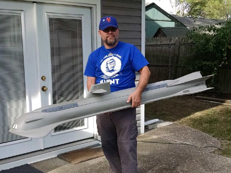

        I am pleased to say the yard crew have arrived and the long awaited refit on the USOS SEAVIEW has begun!!

        So with all this help, I'll have NO excuse not to be ready come the spring for the launch.

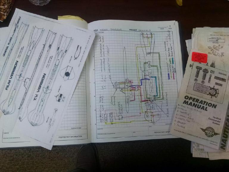

        The initial planning stages for the refit is almost complete.
        This included (but not limited to):
        1-Hull Discrepancy list (dings, cracks, old running gear hardpoint removal, cleaning etc.)
        2-Design Goals
        3-New Equipment design and layout.
        4-Budget and purchase schedule.
        5-Build Schedule
        On thing I like to keep now (now that senior moments are more pronounced) is a dedicated notebook to plan and record what I do.
        I'm finding things from the original build I can't for the life of me remember what was for! lol
        This goes a long way in planning and remembering why you did what.
        FWIW, I've conducted some initial testing the new pumpjet system and it looks quite promising, Over the holiday I plan to finish a test bed and do a comparison between the old 2" fixed prop and the new design. You can see the new nozzle in the 1st photo, the brass/copper affair just fwd of the sanding block.
