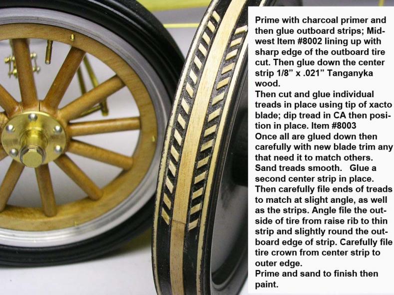

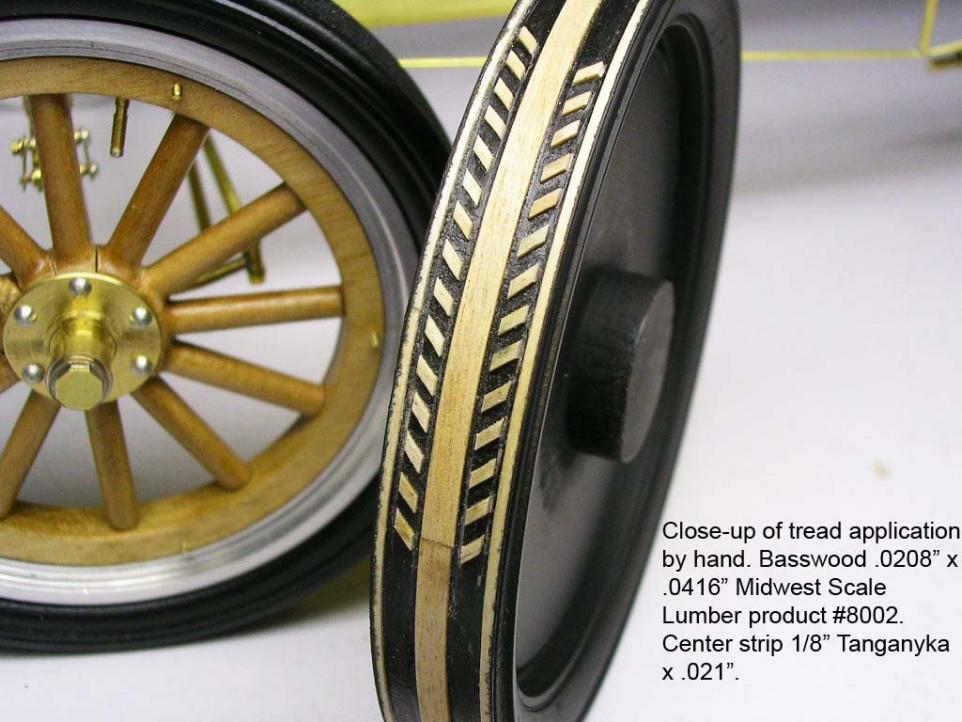

FWJEFF, the tires for the T were made from wood. If you wish to cast rubber tires then follow this link to what you need to use. http://www.micromark.com/TCR-40-TIRE...2-LB,8300.html
You will still need to make a master pattern and mold to cast into. If you are just making two try the wood route and paint with satin black. Here are a couple of images of the T tires.
Ken
