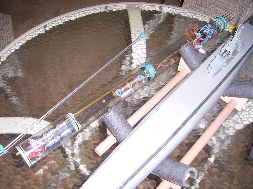

Got the sub driver together and working on detailing the outside.

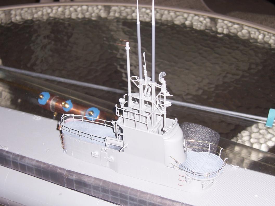

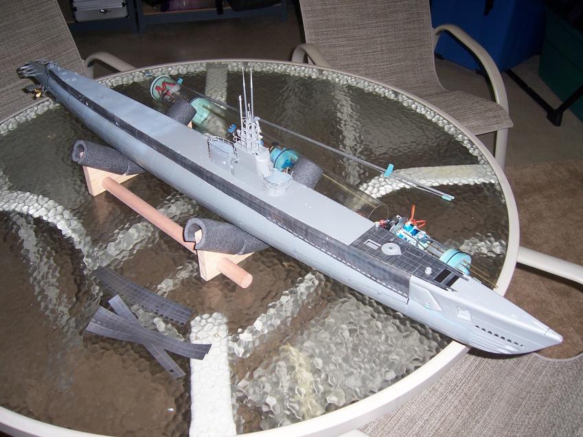

Is the black material photo etch? If so, what kind and how much are you going to use? (i.e. Are you going to add more to the hull? How about the superstructure?)
Screws look to be brass? Are they? If so, which ones?
Any comment on the drainage hole you cut? (i.e. Did they follow a scale-accurate pattern or were these cut simply for good performance?)Comment
Outrider, yes the black is photo etch, I have put some on the superstructure, but have painted it gray already. The props I got off of e-bay, and the drainage holes were from the patterens from Caswell. Mustangbob51 the wtc is from Caswell for the gato model.
