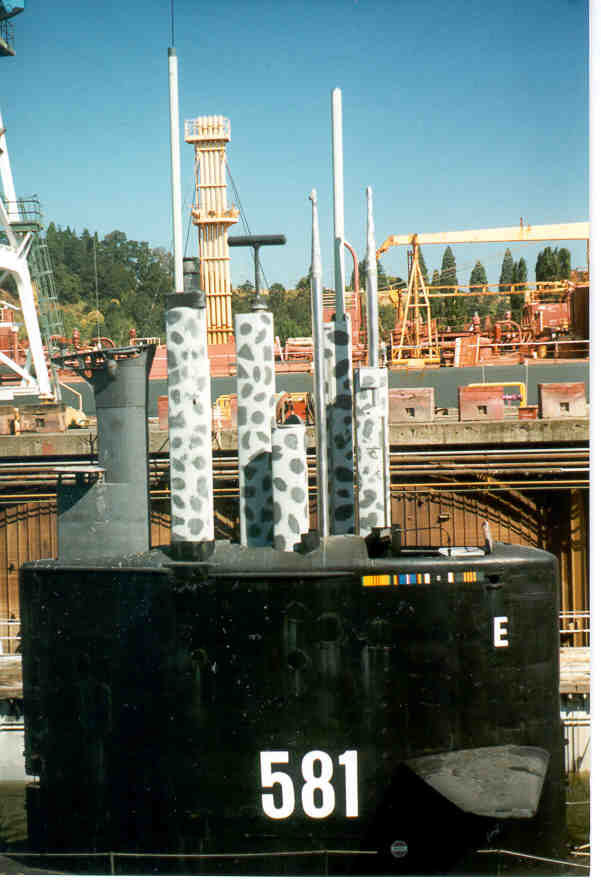

The real BLUEBACK is on permanent display at the Oregon Museum of Science and Industry in Portland. I discovered her in '97 while on business there and have visited her several times including while she was on drydock for overhaul in '98. I've photographed her inside and outside, topside and underside. Even managed to get a set of drawings for building the model in 1/96 scale. It took about 2 years to complete and she was displayed at the Maritime Museum in Vallejo, California during the submarine centennial.

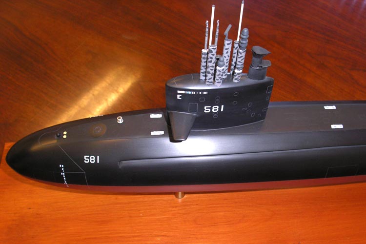

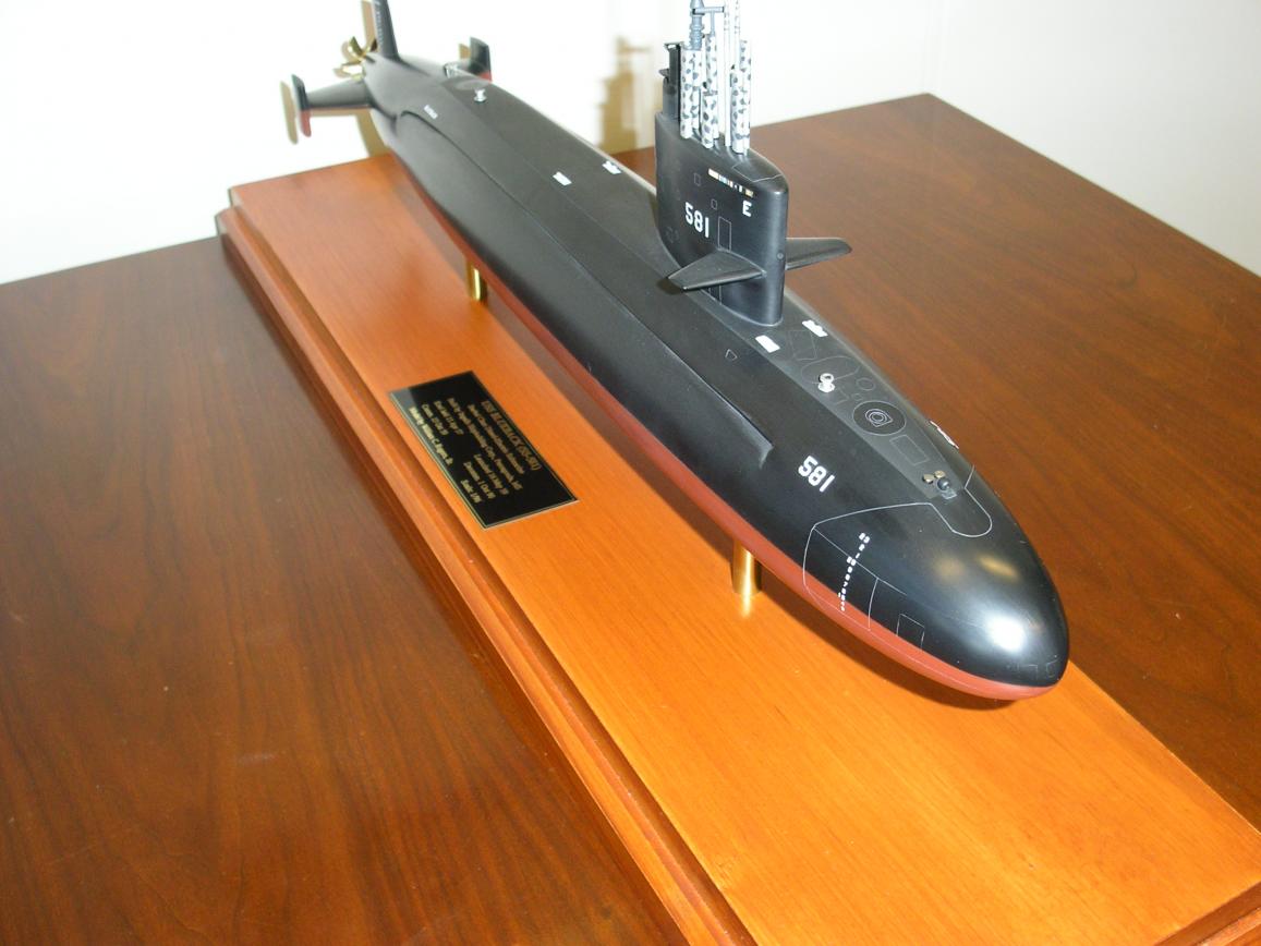

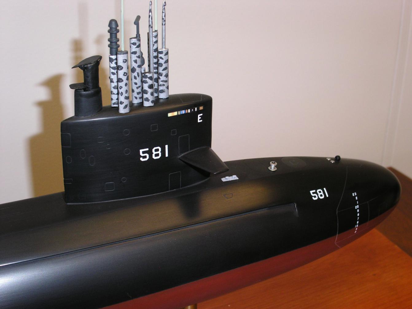

The hull is laminated poplar and was turned on a lathe using a template and duplicator. The sail was shaped from plywood and the planes and rudder cast from wood masters. The masts were made from brass and aluminum stock as well as various odds and ends. The snorkel is brass.

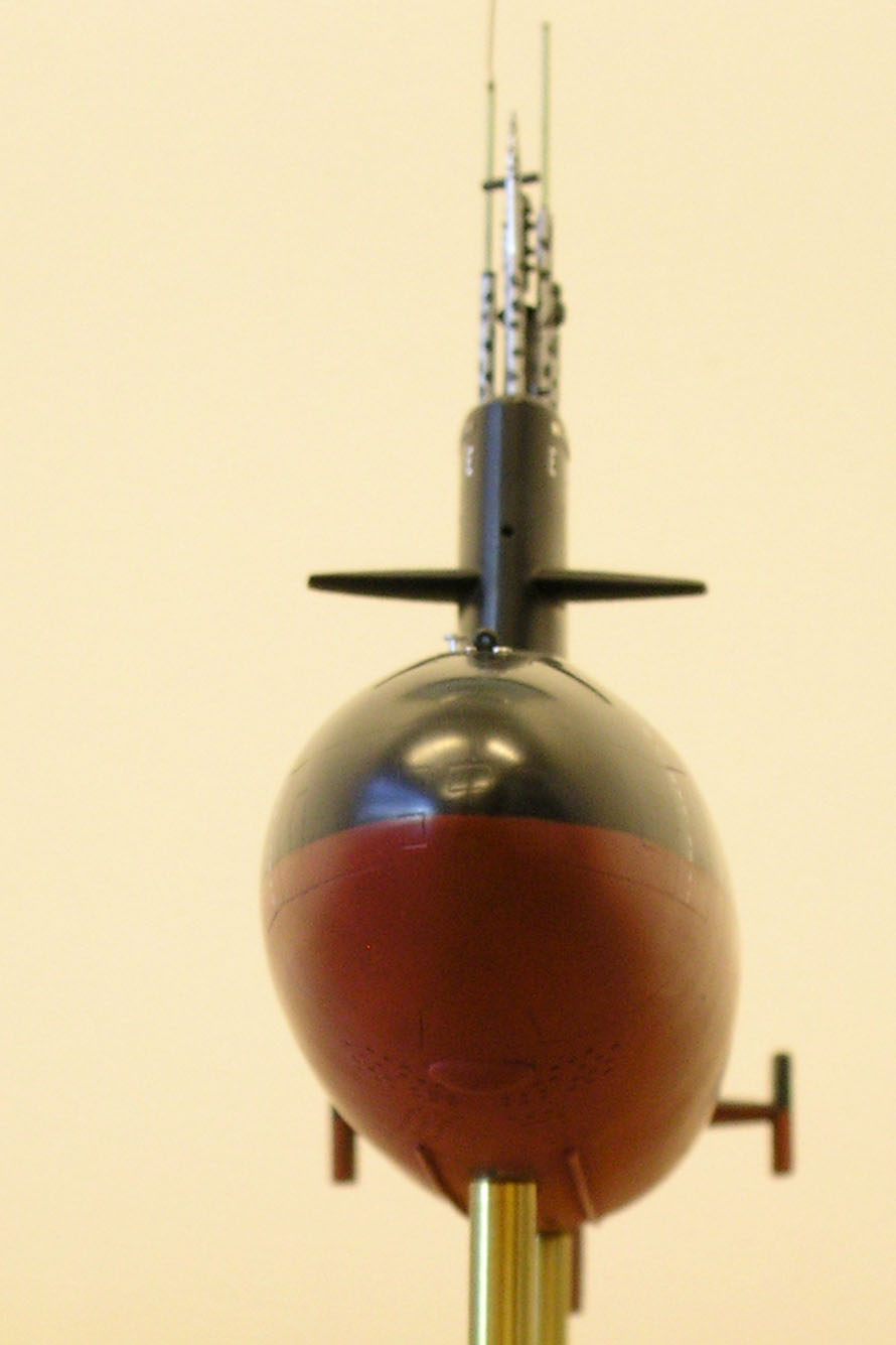

The underside of the hull has the seawater intakes and overboards as well as the anchor and ballast flood holes. In addition, the TDU (trash disposal unit) overboard is shown on the port side. Finally the Masker Air System, rather unusual for subs, is also modeled using styrene round stock.
The only part I did not make myself is the prop. This came in a trade with a well known maker of RC hulls in southern California. I gave him a set of drawings and a pictures of the prop on display shoreside at OMSI. He had a prop made to scale for the model.
