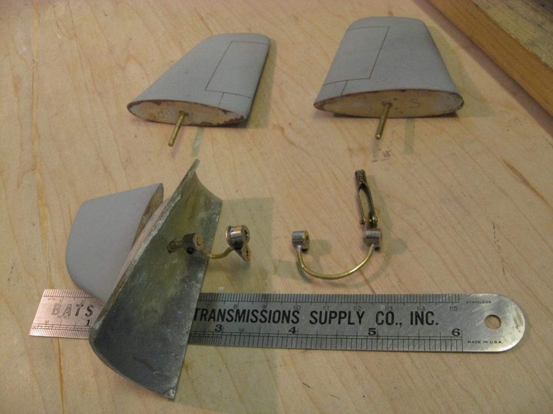

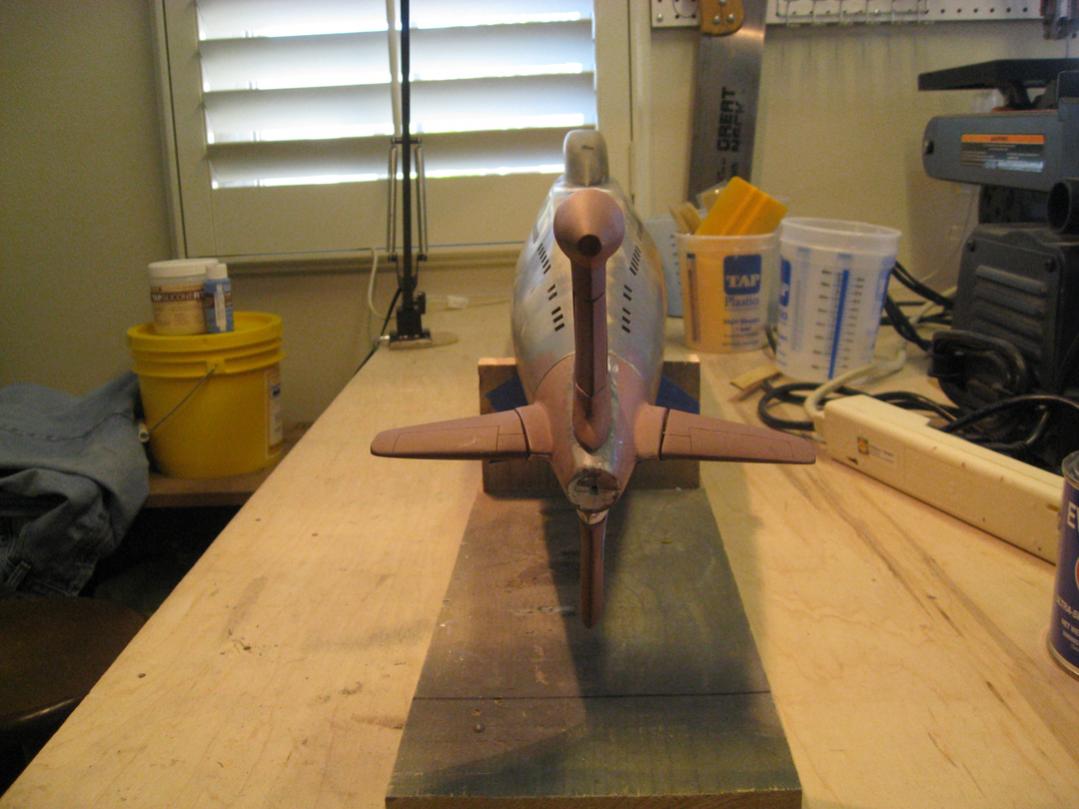

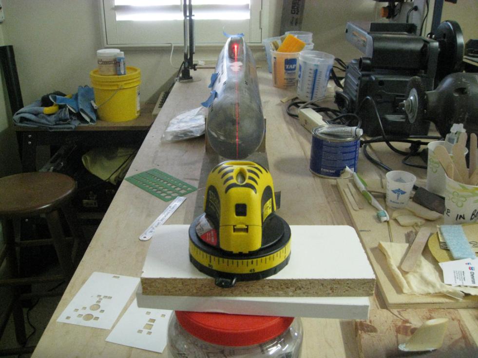

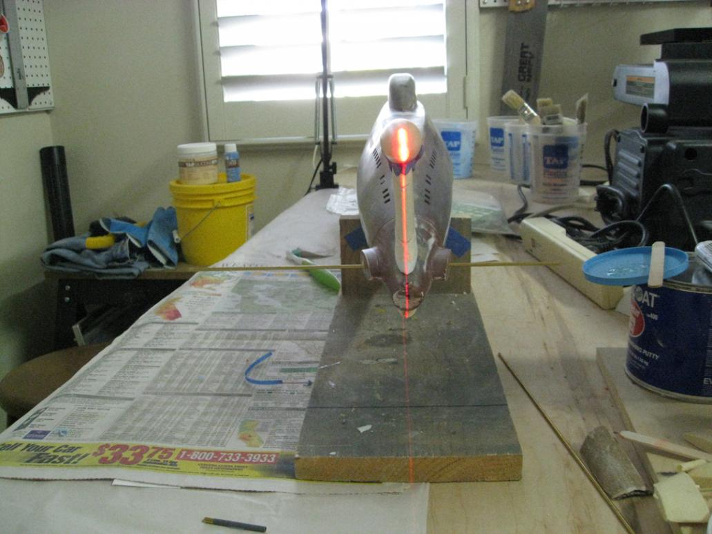

      In this post I show a photo using my laser level to check alignment of the rudder and stern planes. The laser level has been very helpful in this and other important alignment tasks such as establishing and maintaining a centerline on the hull as the work progresses. I’ve marked the centerline with a Sharpie and sometimes have driven in finishing nails along the line to maintain it. The nails can be removed and the holes filled as the project nears completion.

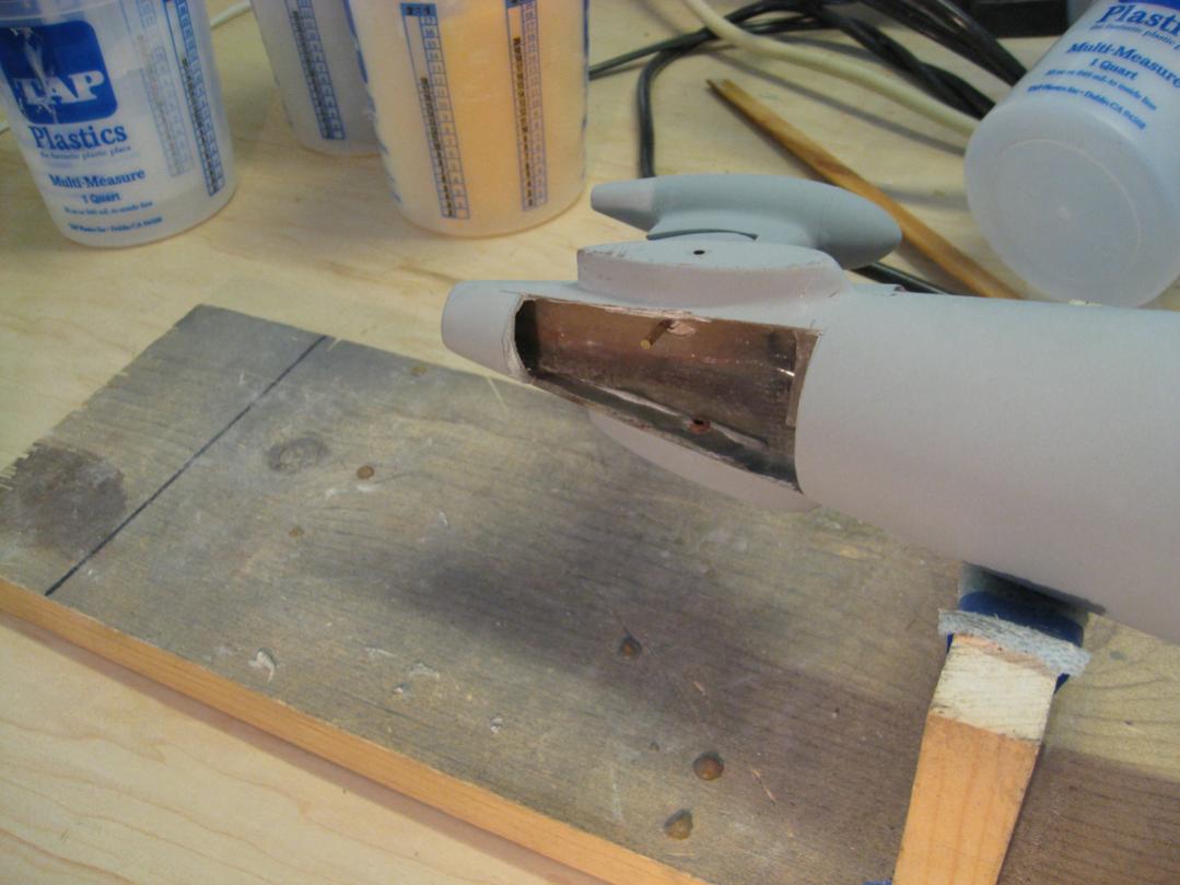

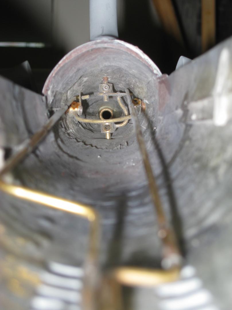

      Installing the linkages for the rudder and stern planes can drive you up the wall, especially on the Soviet boats with the long stern taper. One way around this at first seemed a bit drastic, but it worked. I cut out a hull section and made ready to install the linkage as shown in the photo below. Once the linkage was connected it was easy to epoxy the bottom hull piece in place.

        I’m jumping ahead here for a moment to show what the linkage looks like after several runs. I wouldn’t have been able to get it all in there if I hadn’t cut out the hull section.

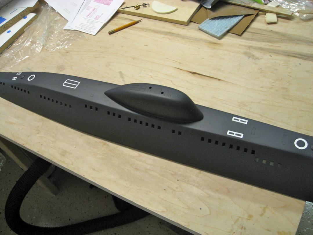

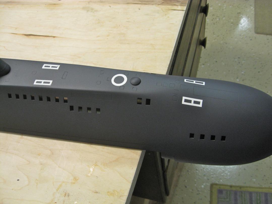

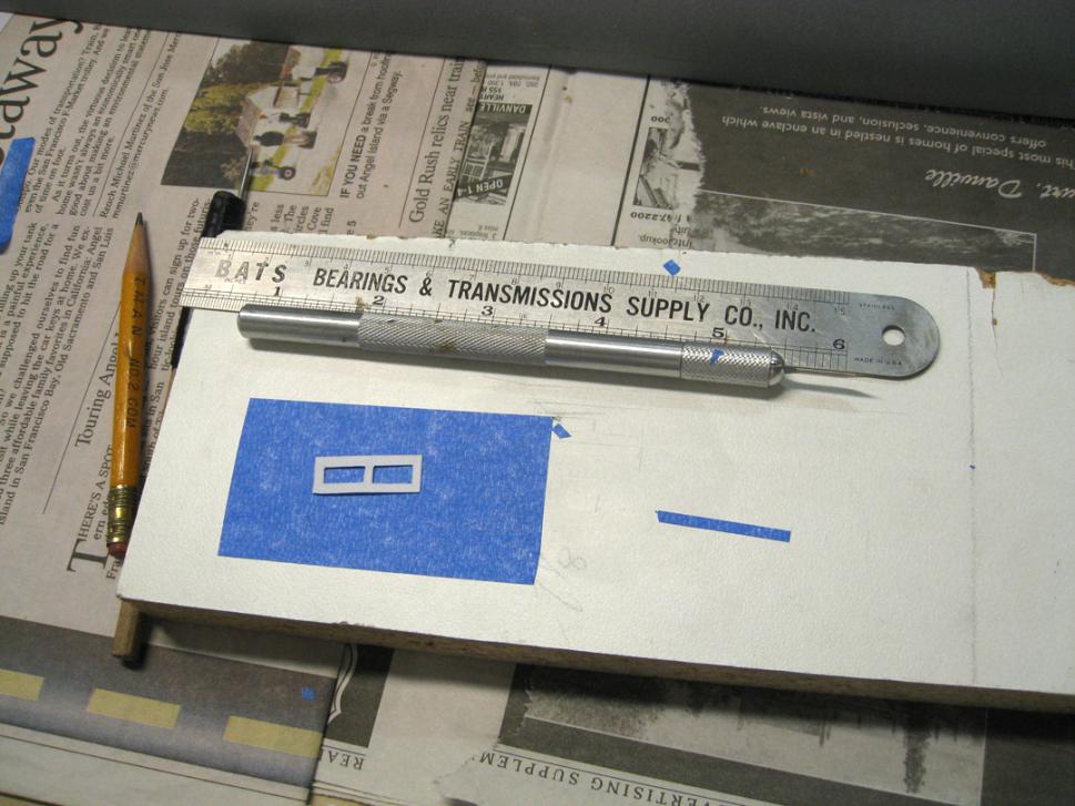

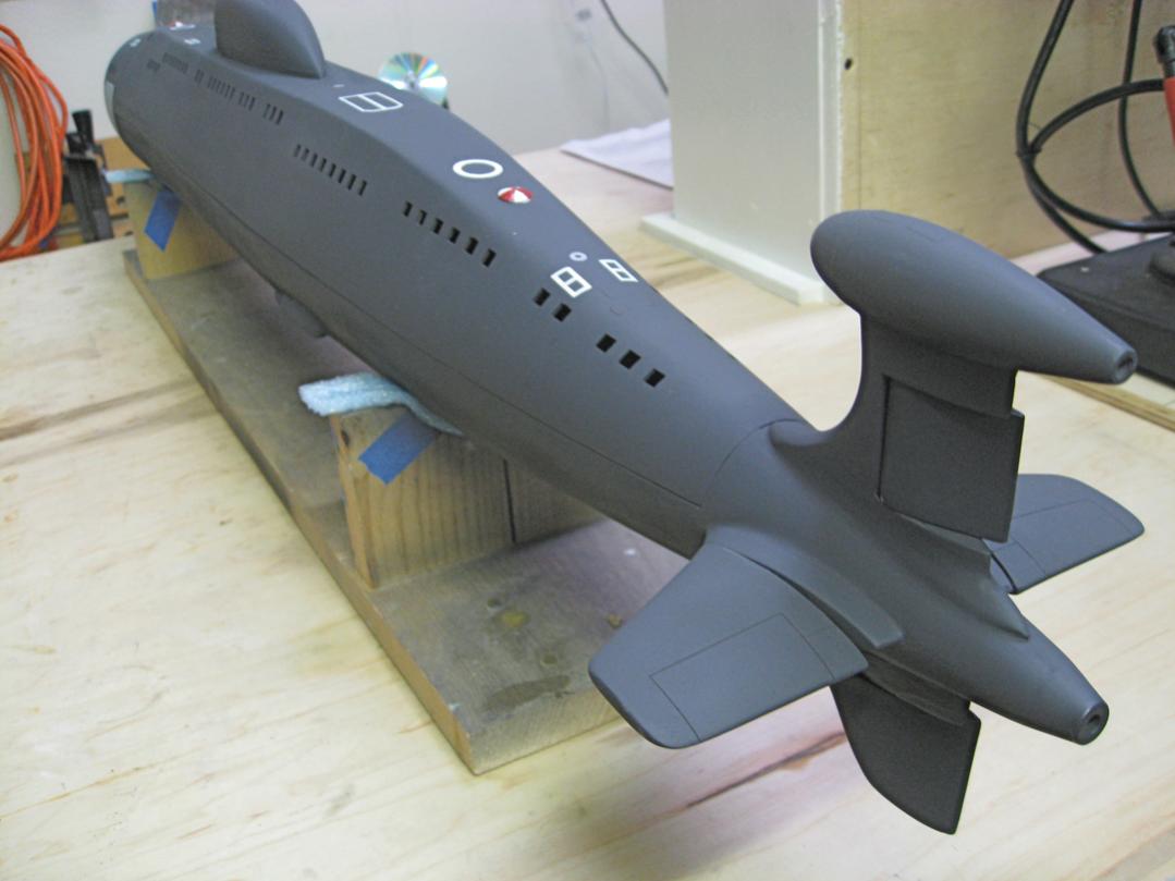

        Now, on to painting. I experimented with blue tape to mask areas that would end up white after painting the hull black or dark grey.Click image for larger version
ID:	82968Click image for larger version
        It took a couple of times before I got what I wanted.

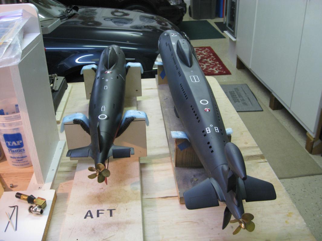

        Building this boat was a real challenge because it was my first attempt at a scratch build RC model. If I were to do this boat again, which I’m not, I would try to build the contra-rotating props that I’ve seen in several pictures of the Victor III. That would be an even bigger challenge. Right now I'm doing a major overhaul of the Alfa you see in the last photo. Perhaps more on that later this Fall.
