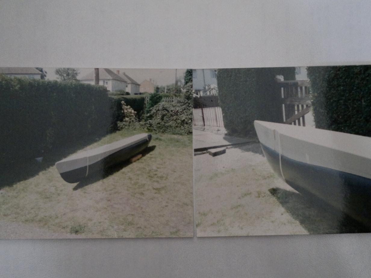

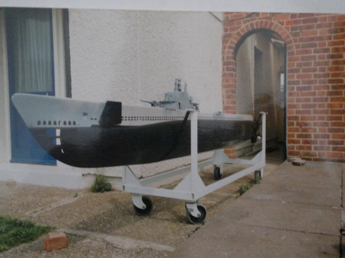

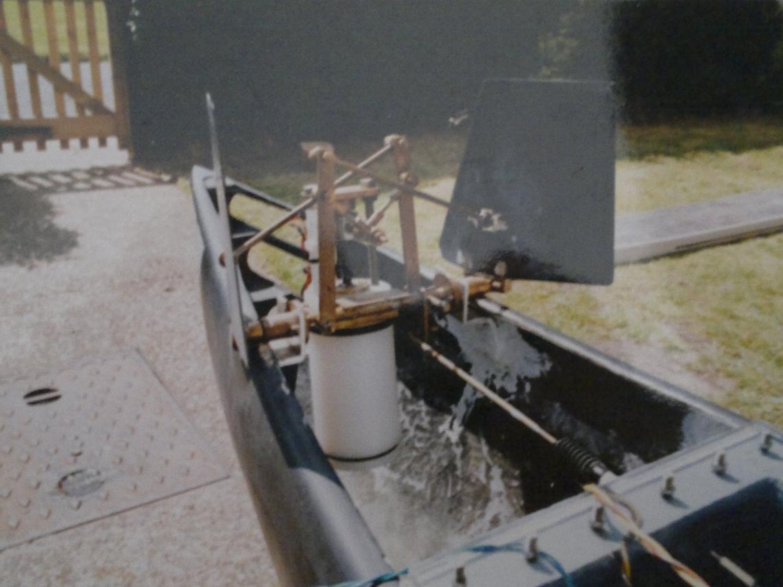

    here is two pics of the hull after it had been made 24 years ago
    here is a shot of the bow after having the torpedo holes cut to shape

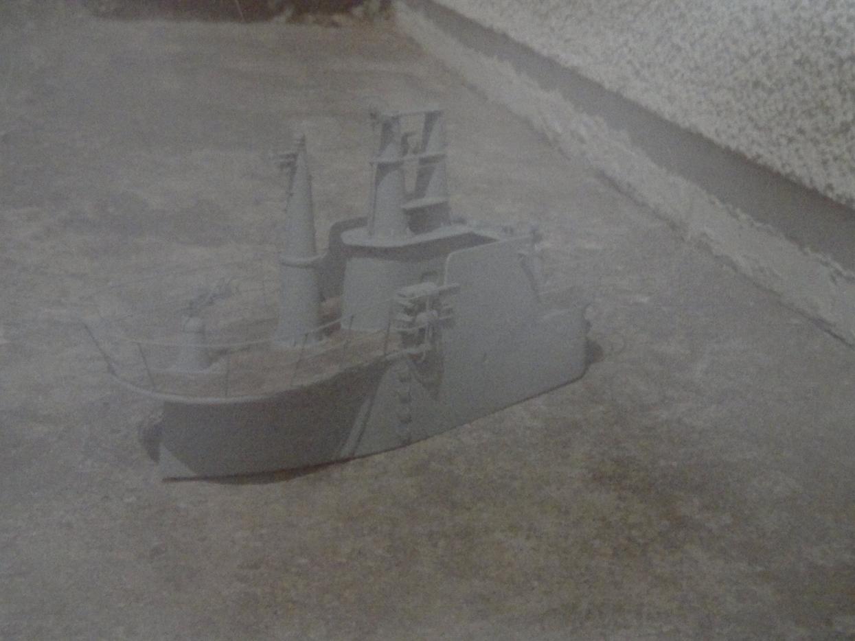

    this picture is of the coning tower that i made from scratch with plastic card sorry adout the picture quality as is a very old photo its as old as my son

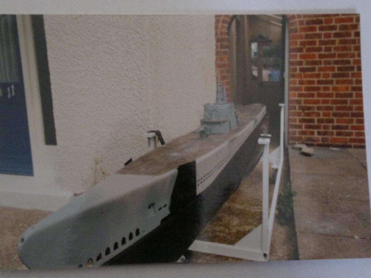

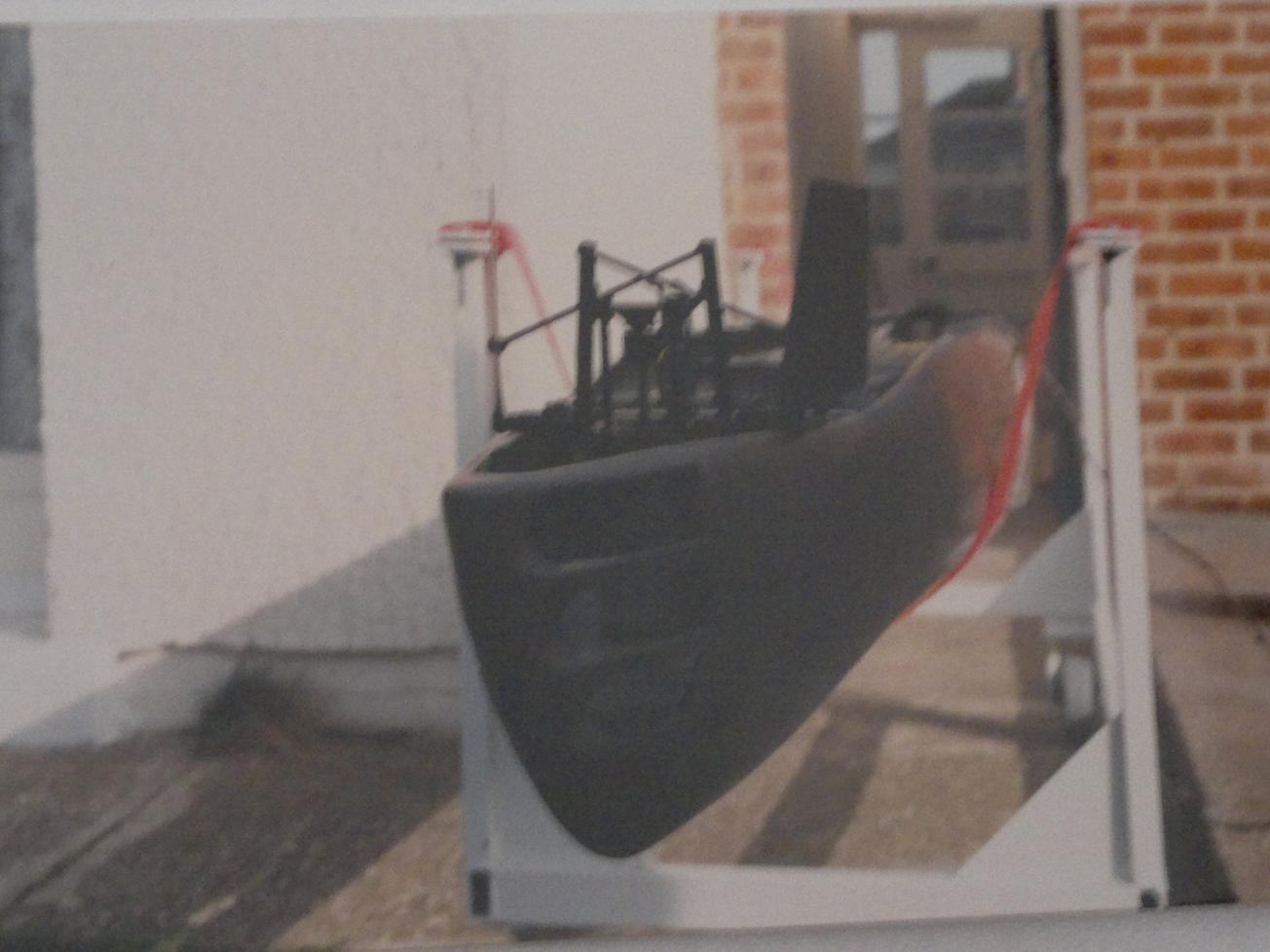

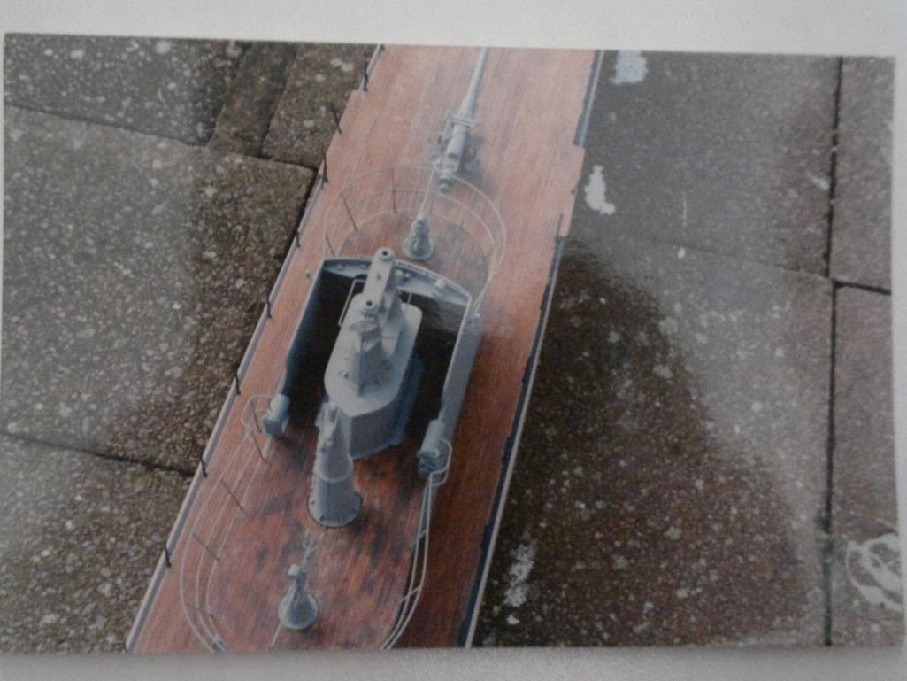

    here is a picture of the sub with the coning tower on the beck and the beck on the sub notice all of the holes have been done and the spraying and railngs need doing still
    this picture shows me starting to put rails on the boat eg on the back of the coning tower and also finishing the decking

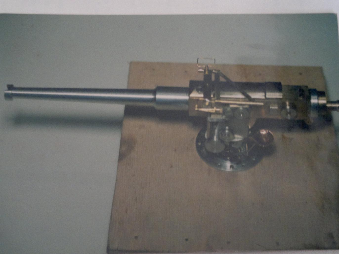

    here is the deck cannon that was made out of brass aswell as stainless steel and it fires .22 blanks this is a picture be for it got sprayed and fitted to the sub !

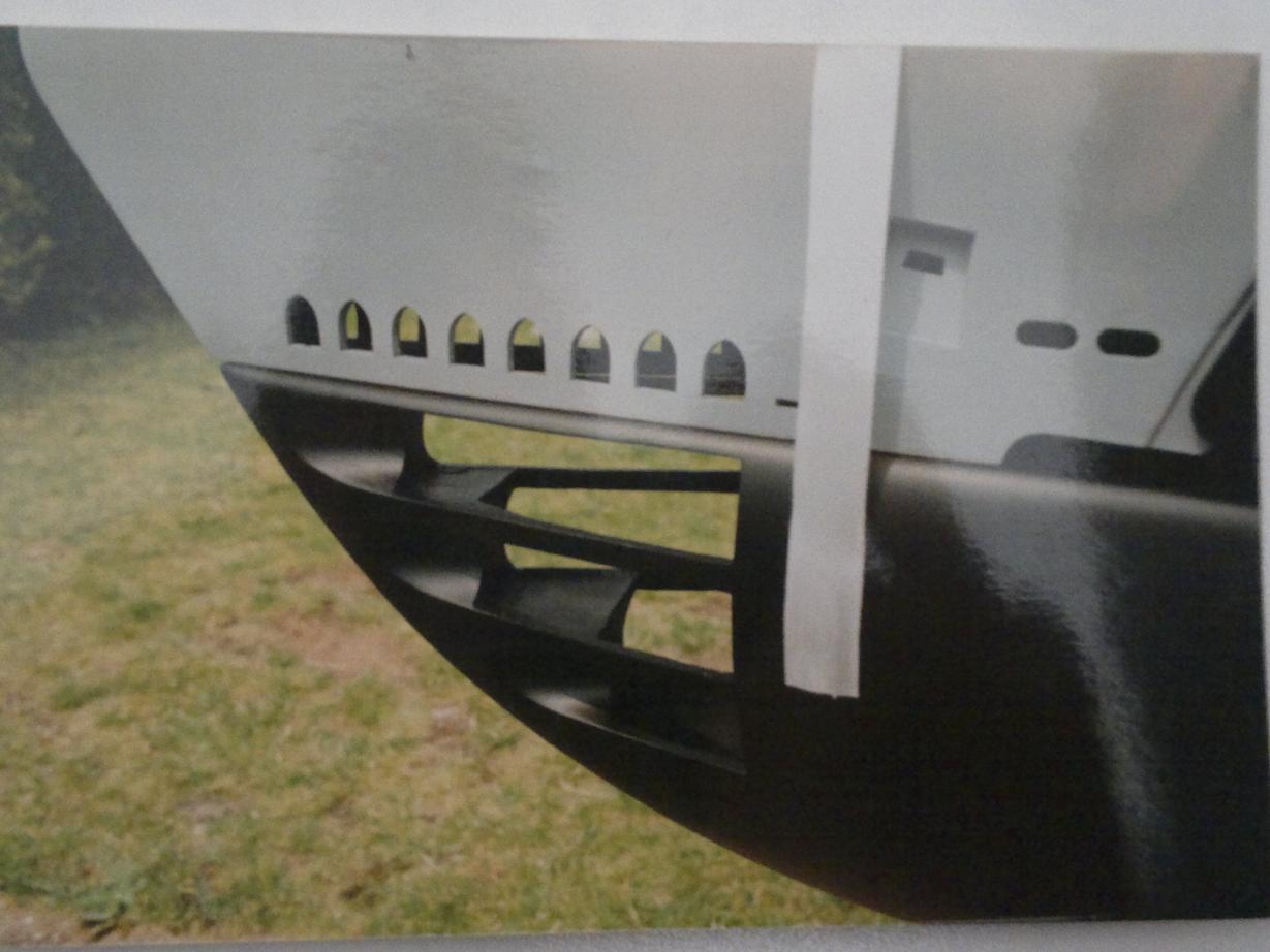

    here is the frount hydroplanes on the sub they have just been made at this point and are awaiting to be sprayed
    this is the hydro planes sprayed fitted and fully working

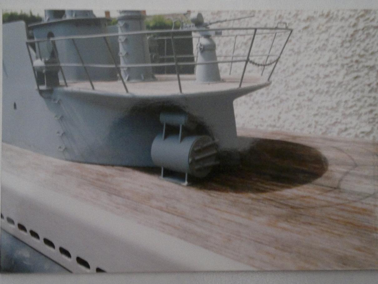

    this pic i have tuck the deck of the boat it has been fully sprayed and all of the railings and all the little extras that add detail to it are all finished

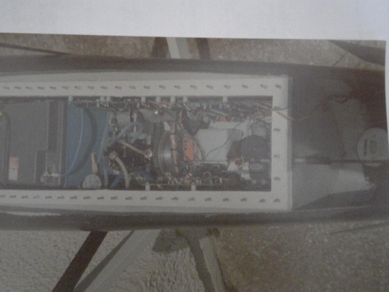

            You asked what work was in progress well where do i start first when i took the sub out of the trailer it had been in there for 18 years and never touched. When i took hatches off the sub all the gel type battery's had split and through acid every where what a mess it was. So i have spent the last year and half redesigning quite a bit of the electronics in side of the sub .
            Now to the good bits one of the units that is to go inside of the sub is what the call a OSD unit standing for on screen display and what this unit does when you have live video picture coming back from the sub it super imposes on to the video picture one of the things is compass heading, real time info, also displays voltage of battery's temps inside of sub, depth of sub in the water, this unit can also be linked to auto pilot which has got to be built yet which means you will be able to set way points so it will do a presset course sub can be programmed to what depth you won't it to be at

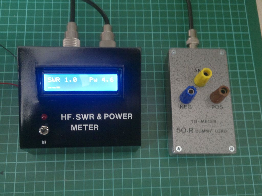

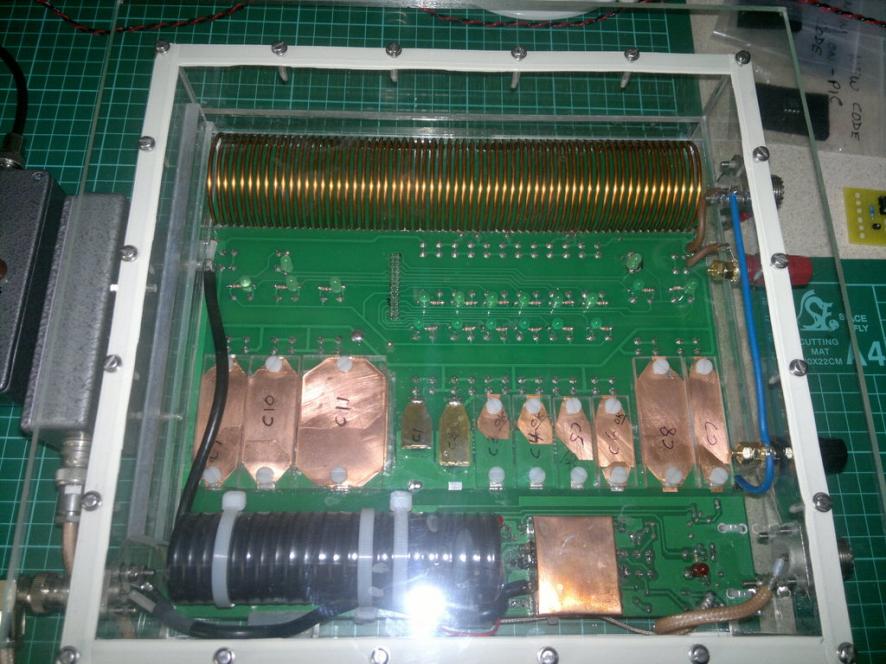

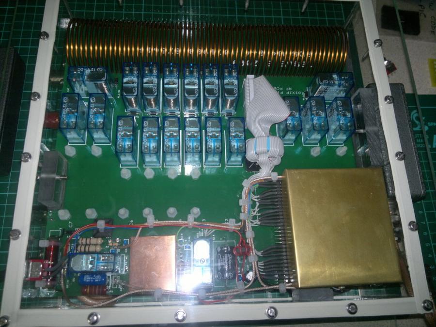

              here are a couple of picture of a auto antenna tuner software controlled for the radio link to the boat
              also this other picture is of the swr - power meter for checking atu matching of the antenna for the sub

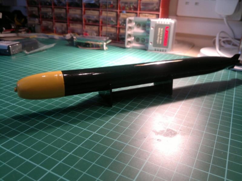

                Gato's torpedoes...at over 12" in length and packed full of nasty stuff that goes bang, you don't want to get in the way of these... torpedoes run on electric motors and will be fired out with compressed air hope to have them fitted later in the new year

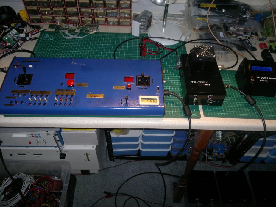

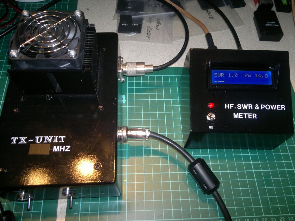

                  this pictures are of the low frequency radio link for the sub with a power meter to the right hand side of the pic giving out adout 15 watts of RF because it is lf the range under water will be greater than that of a higher frequency plus the tx areil will be in the water ariels have taken a long time to design

                    You mentioned that most radio signal is lost bouncing off surface of water. Would signal
                    strength benifit from a signal booster that floats in the water, recieves the air bound
                    signal and re-transmitts it out on a underwater transmitter?
                    Scott
                    Also your work on the submarine is very impressive!
                      • 2625
                      That's quite a transmitter, matches the scale of the rest of the boat.
                      • john robinson
                        • Jan 2011
                        • 19
                        HI Scott, Thanks for comments on sub, problem is with what you are surgesting you would have to set up a thing called a repeater so you could go in at one frequency and come out at another as you can not have the same frequency going in as coming out,the thing is Scott the transmitting Ariel for controlling the sub sits on a float pointing vertical down it does make a lot of difference to range for controlling the sub also has a low frequency video link that i have been doing TX Ariel will be in the water on the sub i can switch between 27MHZ and LF which is low frequency both these systems have a thing called a ATU which is soft ware controlled and brings the Ariel in the water tuned to be in the water. Unit can remember 100's of settings for different ANTENNA'S to be in the water or out of the water

                            picture of atenner matcher software controlled
                            this picture is the otherside of the atu unit
                            picture of the swr power meter digital

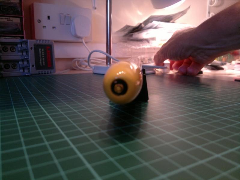

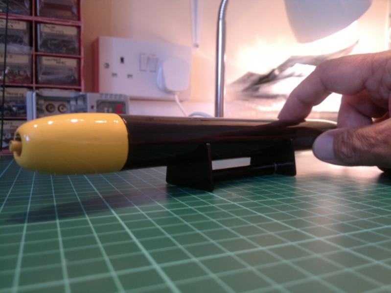

                              these are pictures of working torpedoes they explode on impact and are reusable hope to fit these to the sub early next year please please please put all your boats in the water i need target practice The Titanic
                              these torpedoes are 12 inches long and almost a inch wide
