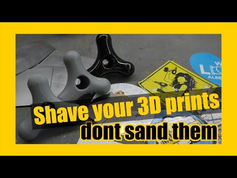

    Bear in mind it doesn't sand terribly easy unless you put fillers in. If you're looking to use it to get a better finish on FDM prints and smooth out striations, you may want to consider shaving the print, then finishing as you would any other plastic or grp hull with putties and primer. e.g.
    Where the epoxy would really be helpful would be laminating the inside of the print with some lightweight glass cloth, as that will really add strength. The weight of cloth will depend on size of boat you're making, but would suggest some 4oz would be adequate unless you're making something enormous.
    Using resin it on the outside may dull or even wipe out details, if there is any.

      Roger Roger I will give this a try. the scraper that is. I was also kind of looking for the epoxy to protect the sub some heating issues but that may not be possible. Anyway the scraping is very exciting.

                  Another good trick I learned is to use a scraper and simply scrape the print lines... this is rather easy, it doesn't generate a lot of sanding dust and it is quicker and effective as well. ​
