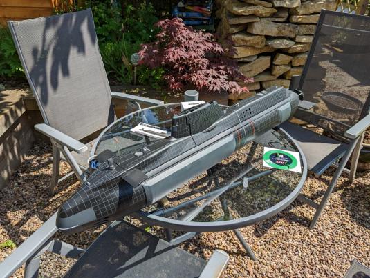

The original files (from here) were a bit too small so upscaled to easily accept a 100mm diameter x 800mm long low pressure pumped dual tank WTC.
Printed in PETG on an FLSun QQS Pro delta @ 90 - 120mm/s so all done quite quickly .. well relatively quickly.
Just need to make a new test tank as it's too big for the old one and too big for the bathtub too.
