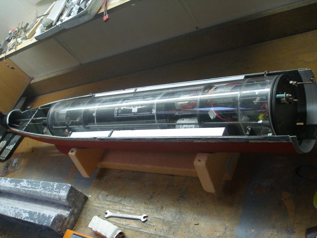

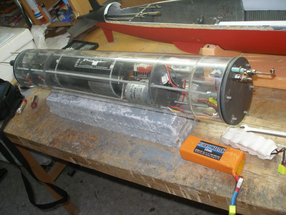

    How about some close up shots of the innards of that thing?
      • 2641
      It uses an Engel piston tank, Dave.

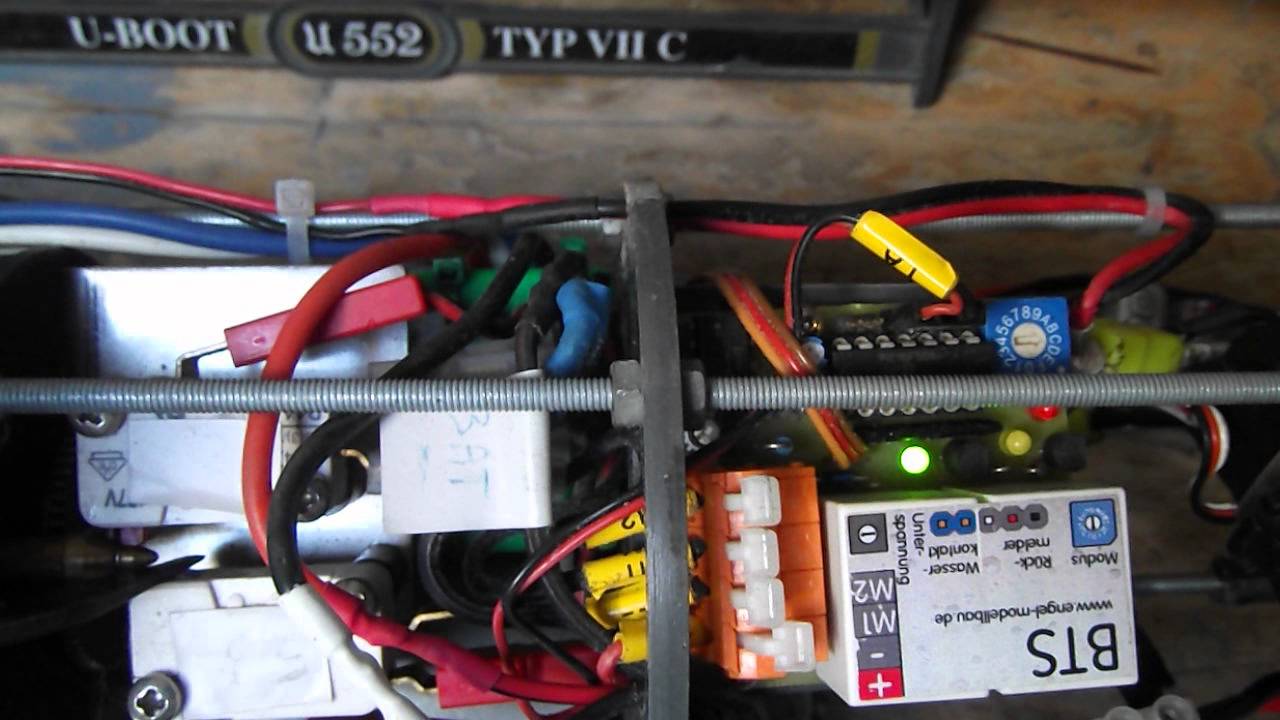

            Yes, it's an ENGEL piston system and the WTC is a copy of Ramesh's one (thank you again for your unvaluable thread about its building). The system was refurbished last winter due to a failure in the BTS, and tested a bladder system with a water pump. Went good, but you had to be very careful not to overfill the bladder. When piston system worked again, reinstalled it an rebalanced the submarine. Dived control improved. Click image for larger version

            As you can see, surfaced waterline is a little bit higher than optimal one, but have to say she performs good enough surfaced. Trimming and balancing took it's time but its worth to do so, cause then you´ll have good perform also dived, as HHSNBN always recommend. Also thank you for that lesson. Have to say that witout the information and experiences learned in this forum, this results wouldn,t have been possible, so, to you all, pals.
                Was it the relays that failed? This seems to be the most common point of failure, and is cheap and easy to fix. I prefer transistorized power switching, which is much more dependable. Engel don't do transistor boards. A chap in Germany makes some nice boards which are proportional via magnetic encoder, but about 75 euro, so not cheap. Another alternative is Pololu who do a feedback controller, this one is very high tech in that it offers full PID tuning, but some might find setting it up a bit daunting.

                  No; have no idea about what failed. I checked and cheked, but no way. Then sent the tank and the BTS to ENGEL; they deeply checked and, surprisingly, told me everything was OK. So I mounted again and now is nicely working. Electronic mysteries.

                    There are no mysteries in electronics, they work, they don't work or they intermittently work/don't work.
                    I personally like to find something wrong if something fails, especially on something pretty hardcore like a model sub, because sods law says the next time that unit fails, it'll happen when you're down at the bottom of the lake.
