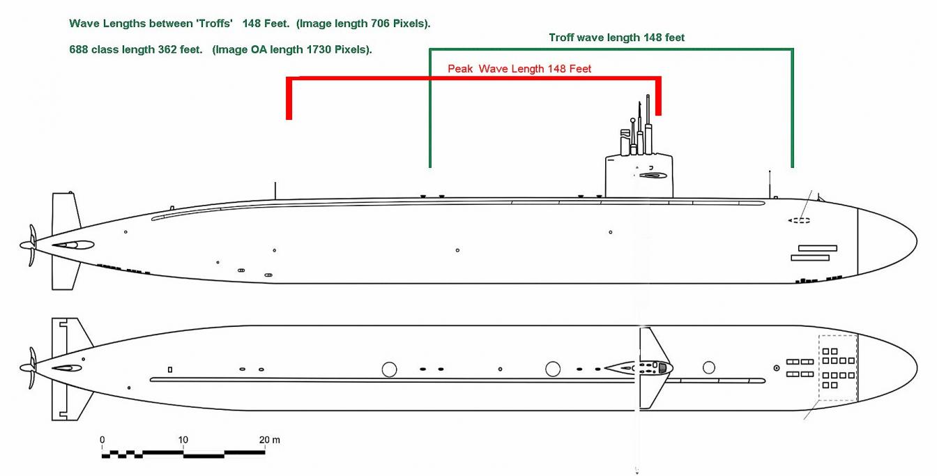

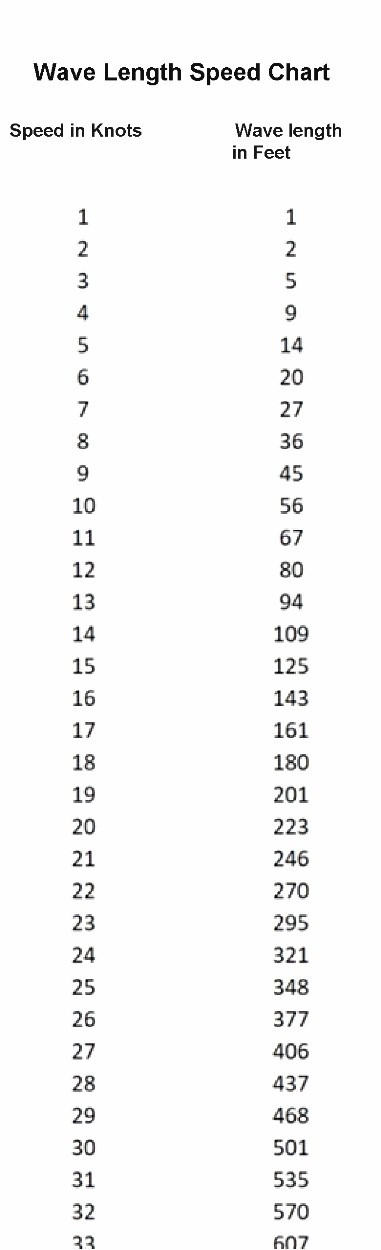

    Based on the Video Chart, and measurements estimate this 688 is doing 16-17 Knots. This was a fun exercise. The Peak and trough wave lengths should be consistant
    Click image for larger version  Name:	wave length 688.jpg Views:	0 Size:	55.0 KB ID:	194869

    Click image for larger version  Name:	wave length speed chart.jpg Views:	0 Size:	49.7 KB ID:	194871
