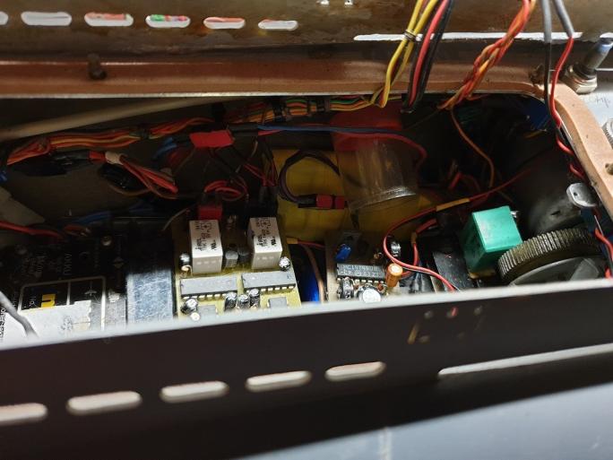

                              To give me more room i had to take out the balance cart, complete with speedcontroller, everything is modular and with plugs, noted down the colours of the cables and the position of the plugs.

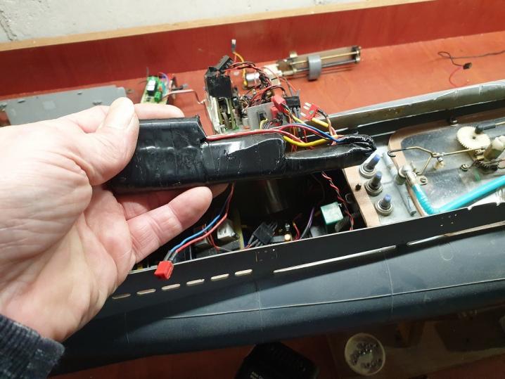

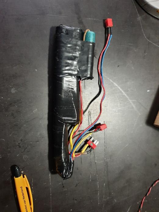

                              Once this room was cleared i could take out the compressorpack and receiverpack, unplugged it from it's connections.
                              The receiverpack was pretty straight forward, it took some more effort to get the compressorpack out.
                              I was allready warned by the amount of plugs on the pack, peeled off the insulation and documented the web of cables, crawling ahead no hurry needed.

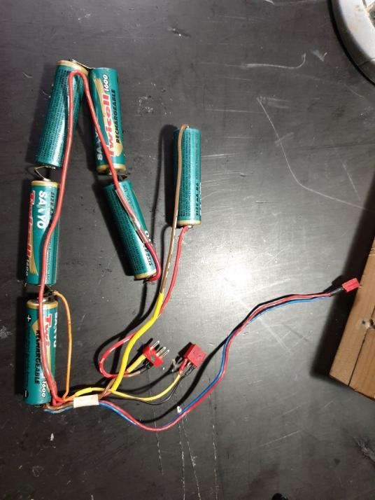

                              Receiverpack had no nasty surprices other that the Amperage was higher as estimated, have to order some new batteries to replace them.

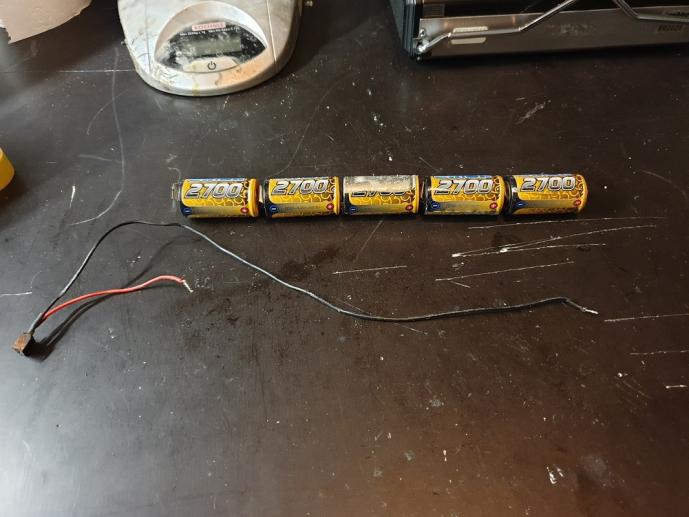

                              Re-inserted the compressorpack after cleaning up the connections, the only thing i noted was, he has splitted up the pack into two parts, have to search and document where the rest is placed inside the boat.
