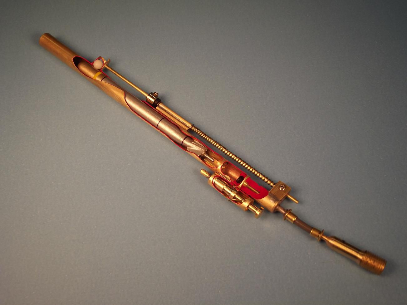

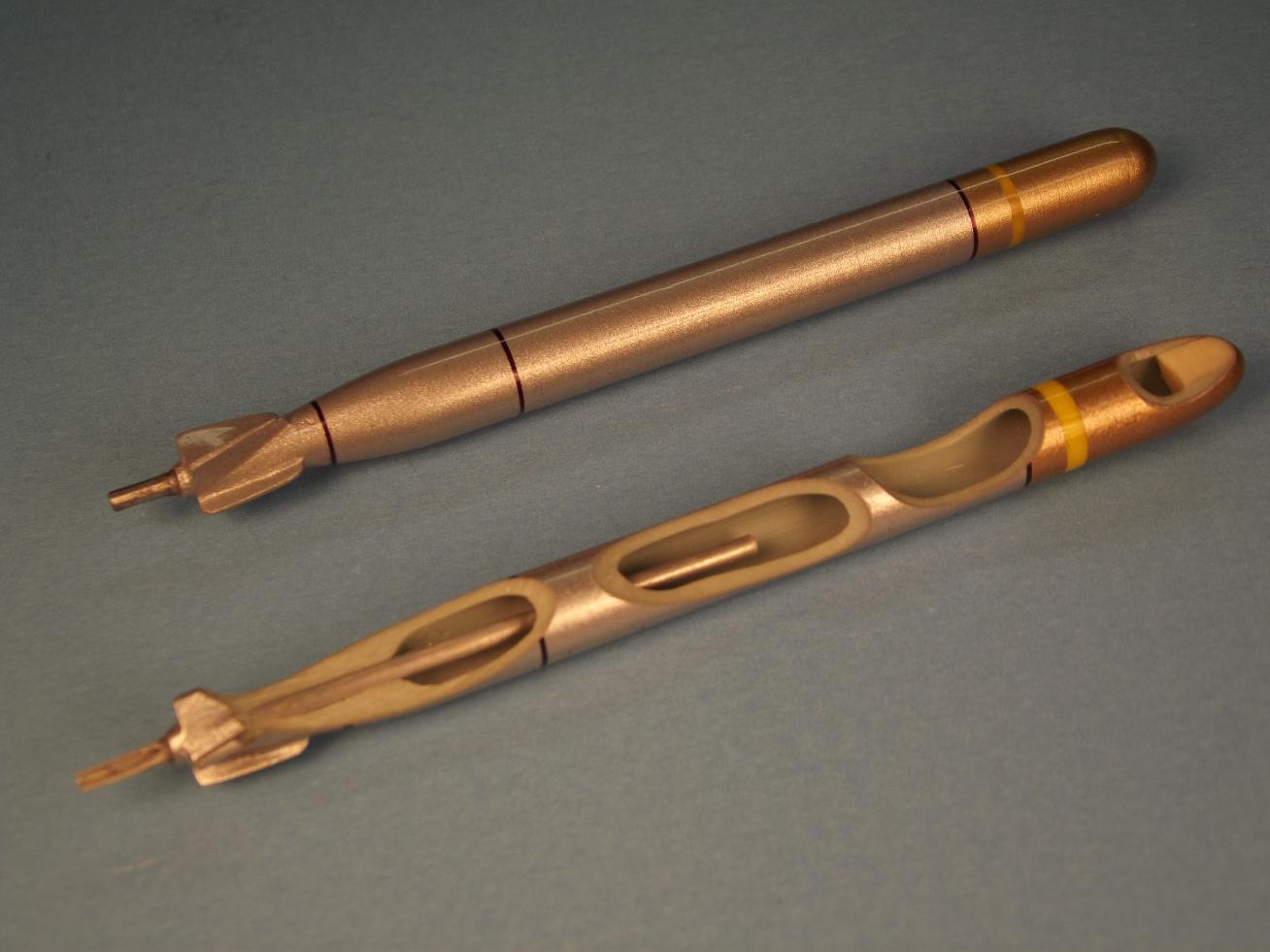

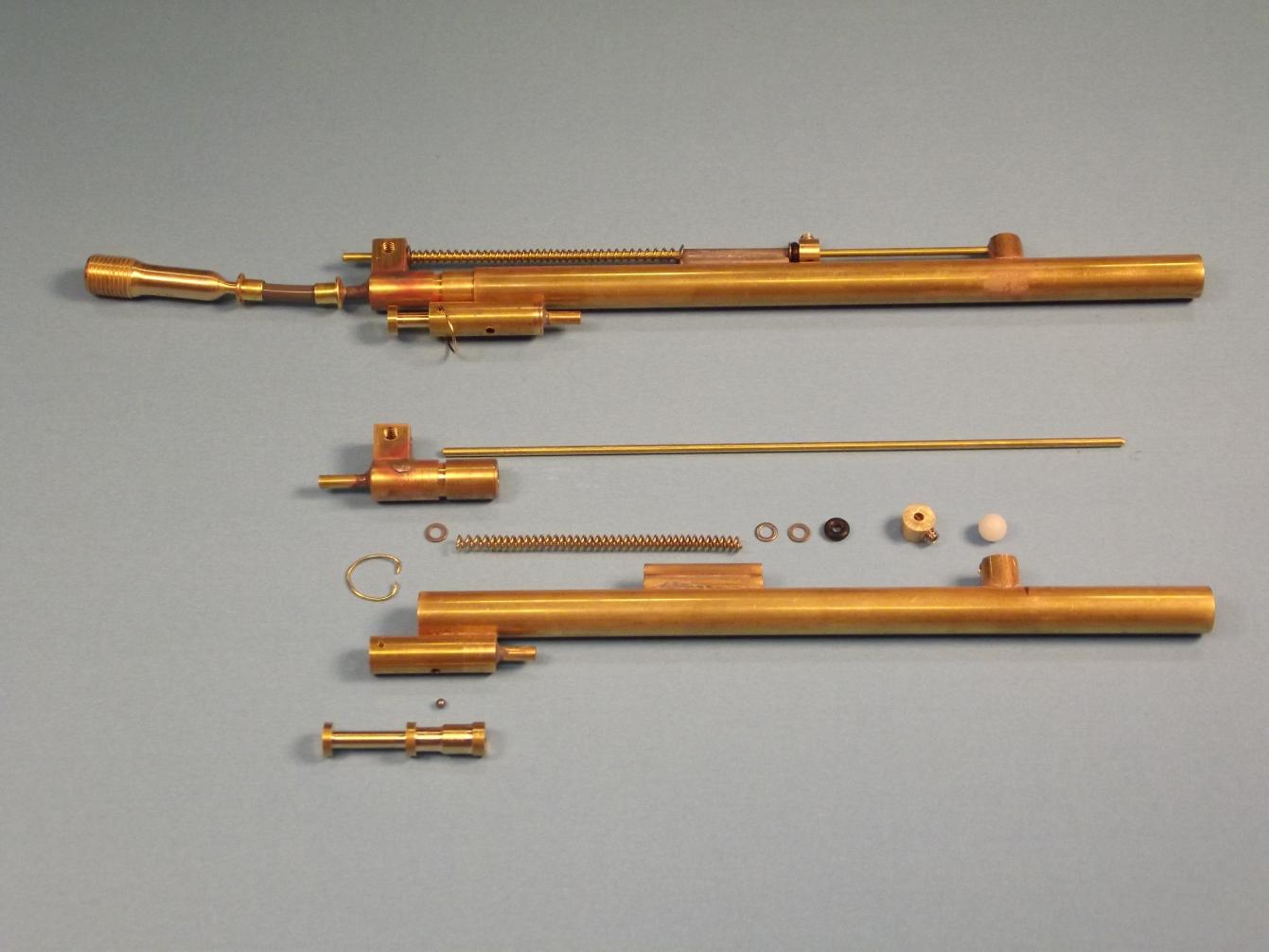

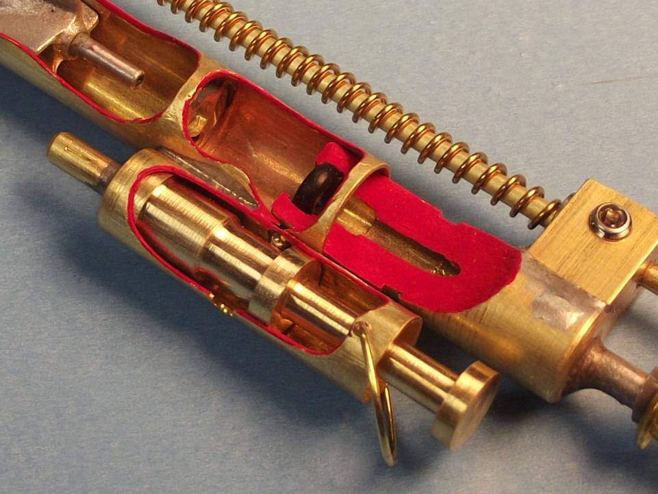

        That's why I cast my weapons from a single substrate. The different expansion rates of your different materials (aluminum body, resin ends, let's say) causes cracking at the sub-assembly unions. You bang up the body with liquefied gas. Discharge some of the gas. Big, sudden temperature change, the different materials shrink/expand. And ... Boom!
        You can't play that bass with one hand, pal!
        What happened to you is the reason I designed my gas-powered torpedo system so that the charged weapon can not be hand-held -- it must be charged and contained within the launcher till time of launch.

              [ATTACH=CONFIG]20092[/ATTACH][ATTACH=CONFIG]20093[/ATTACH][ATTACH=CONFIG]20094[/ATTACH][ATTACH=CONFIG]20095[/ATTACH][ATTACH=CONFIG]20096[/ATTACH]
              You're so right David as usual !!! To be honest I never thought about the different materials and the way they behave! Stupid me!!!
