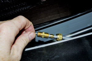

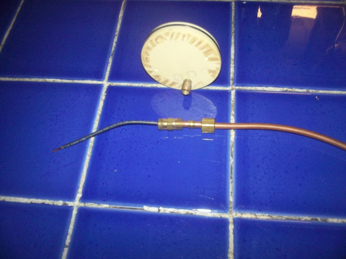

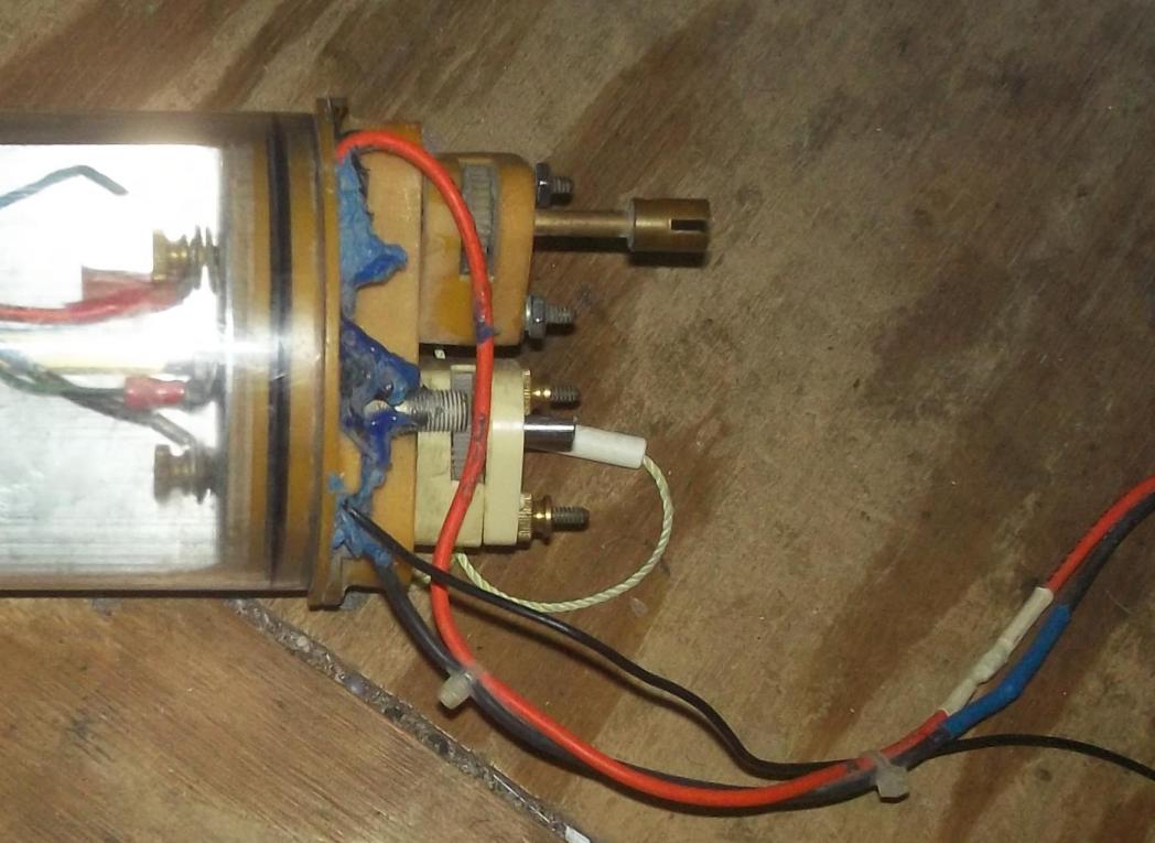

    sounds like an oxymoron, but its what is done to wiring that has to be sheilded from the elements. In this case, wire connections and water. I picked up the idea of running wire thru tubing, from the Navy's Flightline refueler trucks. Cant have bare wire anywhere basiclly because of possible sparks and fuel in the proximity. We had to run wire thru a non ferrous conduit, so at the time copper was the answer so all the wires for all the lights on the tanker trailers were individually routed thru copper lines and brass fittings. Rather expensive endevor to comply with the NATOPS instructions, for the entire fleet of trucks, By the 80s they switched from the liquid conveyance copper tubing to the new vinal air lines for compressed air brakes and such. Either way, it a great way to run wire thru a watertite bulkhead from space to space ect. I was looking at the connection on this unit Click image for larger version
ID:	103189 and altho I put that blue rtv goop on the back my switches on the dash that are on the fishing boat, On my motorcycles I used copper to match the oil lines for asthetics. On the subs however I plan on using The vinal hi pressure air lines and ferril fittings system used on trucks air brakes. Hi pressure is not the reasom as there is none but the lines are flexable and easily routed where the copper has to be pre bent and fitted for the spacific application. Looks prity, shiney or platina but the vinal is what I,ll use. Cheaper and just as efficent. rhis is an example of the copperset up with the bulkhead and a fitting tapped into itClick image for larger version
Name:	Copper ferril.jpg
ID:	103190Click image for larger version
ID:	103191 typical vinal line with brass ferril connector. You can use the waterline for the refrigerator ice machine repair kit which is a large enough diameter to put more than one wire through for power lines ect. They are inexpensive.
