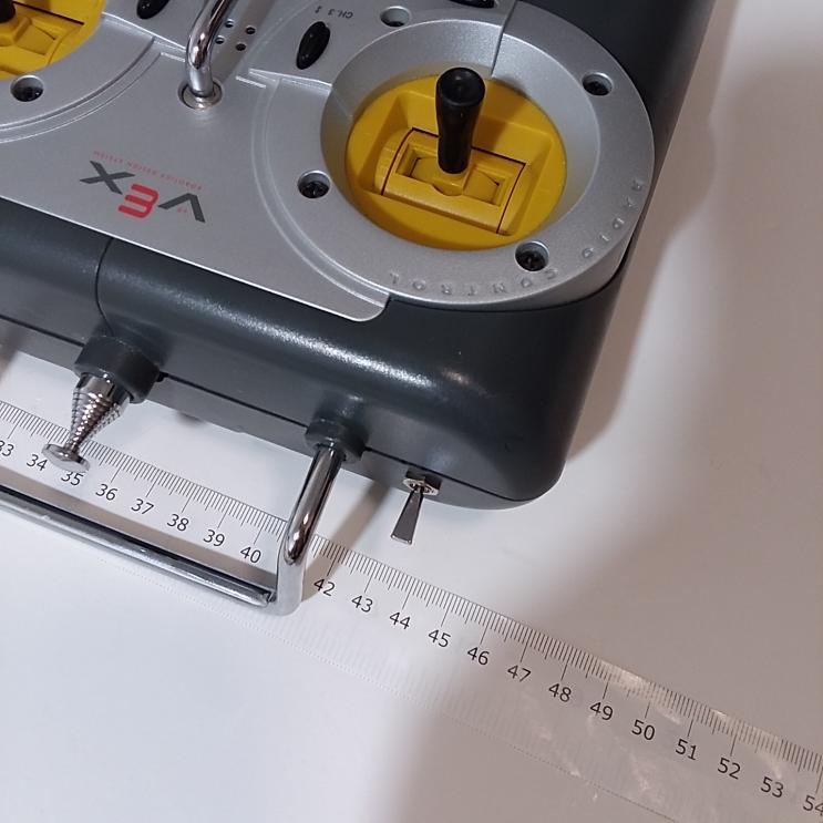

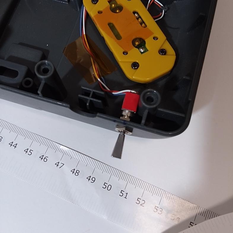

    It takes forever for the pump to finish pumping!
    replace it with a 3 position switch.
  • Sinksalot
    • Mar 2020
    • 365
    Thanks, I was wondering if that would work. I have a few new Vex radios that I wanted to do that mod to. Now that I know it works it gives a better option
    • cheapsub
      • 193
      Get the switch for RC TX, others doesn't feel right, it doesn't slap back to center correctly, frsky switch ok (what I have, cheap), futaba better $10 a pop.

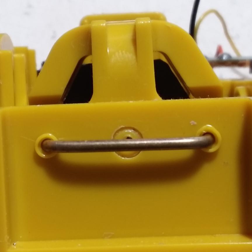

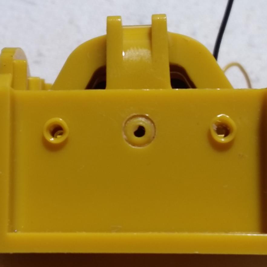

      Also if you don't want the left gimbal, move side to side, and use it on other function. You can lock it down with a pin. Click image for larger version
ID:	169685Click image for larger version
