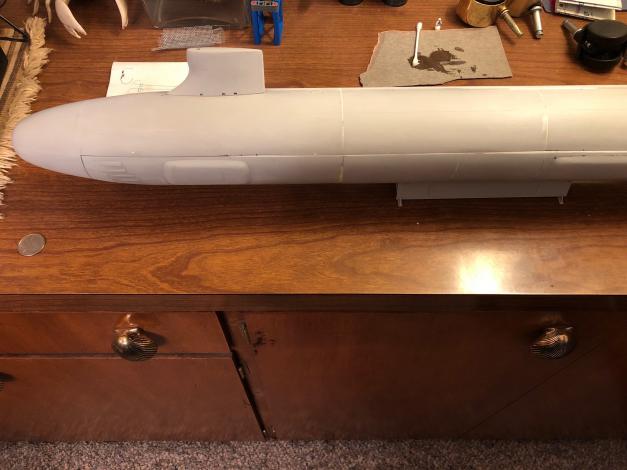

      I've had so/so luck with Bondo, but that was forever ago. I'd like to give Evercoat Metal Glaze a try. Milliput did a splendid job filling in the cavernous gaps between the pieces of hull that I joined to lengthen Seawolf into Jimmy Carter.

      Appreciate the pics, as always, Mr. M.

        Milliput is a two-part epoxy filler -- more stable than polyester auto putty, but hard to get these days and expensive as hell. Bondo is fine. It's all about surface preparation.
        Tip: if the model will be exposed to water (duh!) you coat the finished filler with thin formula CA to seal the porous filler and strengthen the substrate.
