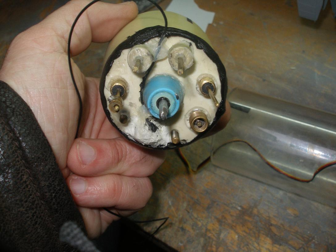

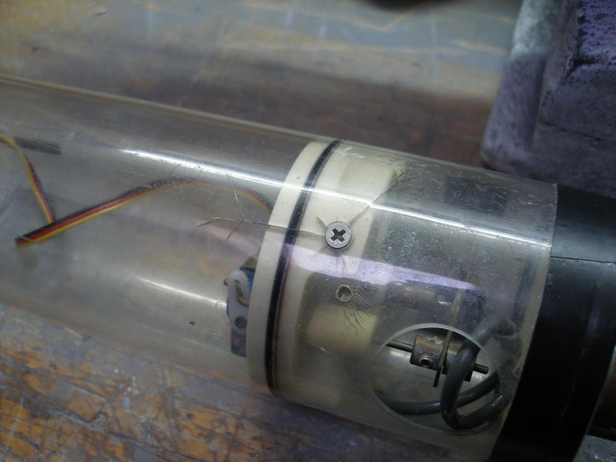

          The on / off and rudder pushrods seals were the ones that leak and, also trhough a crack in the fore part of the tube, right by the o ring between the dry space and the ballast tank. The problem with the seals easy to solve changing the leaking seals, but How to repair the leak trhough the crack in the tube.
            • 13987
            Is the crack originating from one of the securing screw holes machined into the cylinder? A picture would help here. An interim fix is to place some Electrician's tape over the crack.

              Yes, right over one of the screw holes. I'll take a picture.

                  HEre Are some pics of my subdriver wwith the cracks.
                  I also send you a pic of what I've done with the rear bulkhead. I've changed two seals with own made. No bubbles now through them. The black sealant cord is to avoid the tendency of this bulkhead to move when closing the sd, even though you operate the schrader valve at the time.
                  It looks like the water leak is smaller but keeps coming from the rear, because when I balance the sd fore and aft, the water appears coming from the rear. But THERE ARE NO BUBBLES now from any of the items astern, and I've made the check with the motor running.
