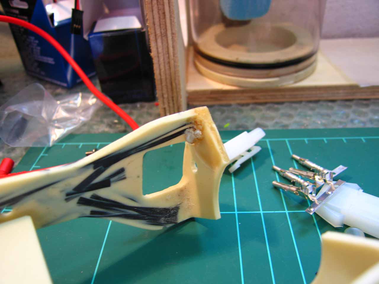

    Hi Guys,
    I don't know if I should be worried about this or not, but there is some discolouration and crumbling on the interior tray of my 3.5in subdriver where it attaches to the aft plug.
    Given that there is not a huge amount of load passing through this area, I'm guessing it's ok. I thought I'd run it by you all to be sure. (I am a newbie after all)
    What's the opinion, should I replace / reinforce this part or leave it be?
    Cheers,
    CT.
    Last edited by ConcreteTurtle; 09-27-2009, 08:04 AM. Reason: Adding clarity, removing typos.
    • 14010
    My fault -- that's a short-shot pour of the equipment rails which was fixed by quickly mixing up some topping-off resin and pouring it into the tool before the initial batch of resin could cure. The discoloration is a result of a slight difference in ratio between the two mixes. Don't sweat it.
    Fix it only if it breaks. Not a biggie. If you have too, cut slots across the bridge line, fill with baking soda and squirt on thin formula CA -- that'll bond the two areas up good.
