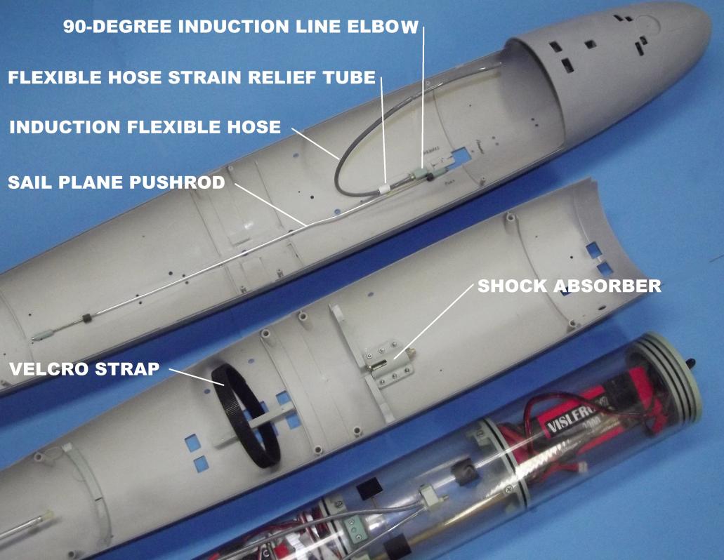

    Get the SAS SD and there will be no need to ever look back.
    In submerged trim the boat, dead in the water, will float with about half of the sail sticking into the air -- this represents about two-ounces of reserve buoyancy. Box compression will reduce this the deeper you go, so don't count on it to bring your boat up if it goes deeper than five-feet.
    When using the 2.4gHz gear, as soon as the periscope-antenna goes under the motor will stop do to loss of signal. The boat will slow, and because it is slightly buoyant, will once again stick the periscope-antenna above the surface, where the radio signal is once again received by the model and you're back in control.
    Additionally (and this is the direct answer to your question), when the signal is lost, the model slows, the fail-safe kicks in and the SAS operates and uses some of the air within the SD's cylinder to blow ballast water.
    Keep in mind: if the model slows when completely underwater, without your direction, the fail-safe kicked in and the LPB starts sucking air from within the SD's dry spaces and dumps it into the ballast tank. This creates a slight vacuum within the dry spaces. You are then compelled, once you regain control, to broach the entire sail so the open snorkel induction valve can admit air into the SD, breaking the partial vacuum produced during the fail-safe event.
    The manual you need to study is a PDF. You'll find it here: http://support.caswellplating.com/in...l-instructions

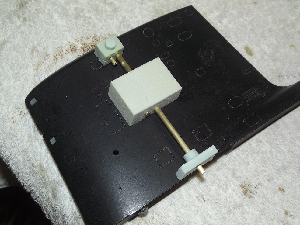

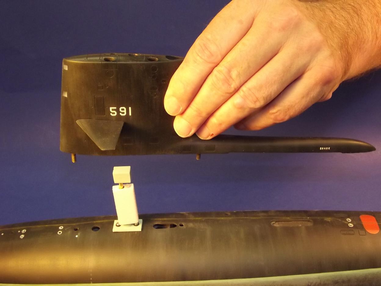

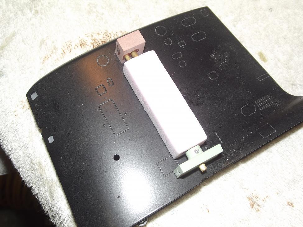

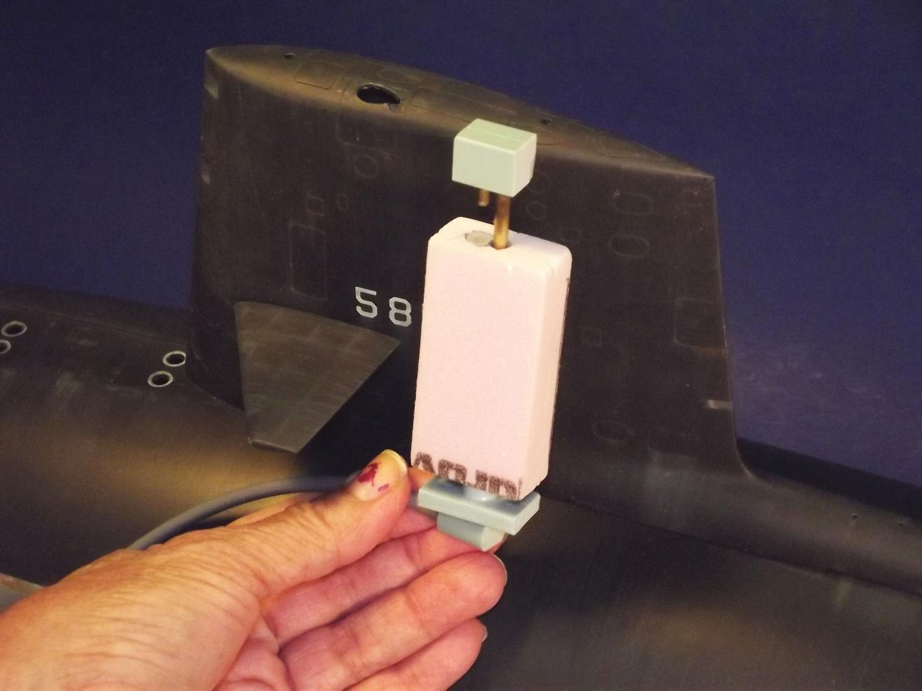

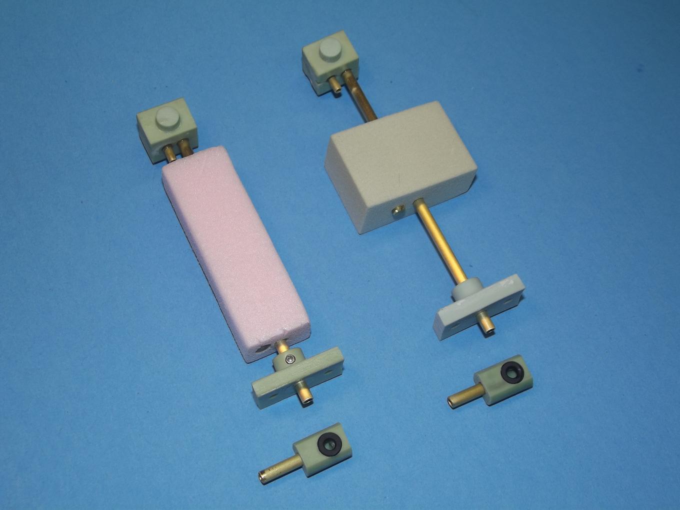

          Now I have the 3.5 sub driver I have a query about the snorkel float, reading greenman's excellent build thread there seems to have been an updated float (grey colour), the one I have is the longer (pink colour) float which seems to have some problems can anyone clarify this for me
            • 13950
            What's the problem???? Can't help you if you don't explain!
            Both versions of the vertically oriented float work.

              The pink foam version works great. If you are concerned you have an earlier version, do not fret. I used the pink one in my Skipjack and it works great.

                I don't have a problem yet as I am just about to start on the build up of the sail, I was just a little confused after reading Greenman's build thread about which one was the current float it was appearing to be the grey one in my reading of the thread but of course it looks as though I was wrong (not for the first or last times I suspect) thanks for helping out guys��
