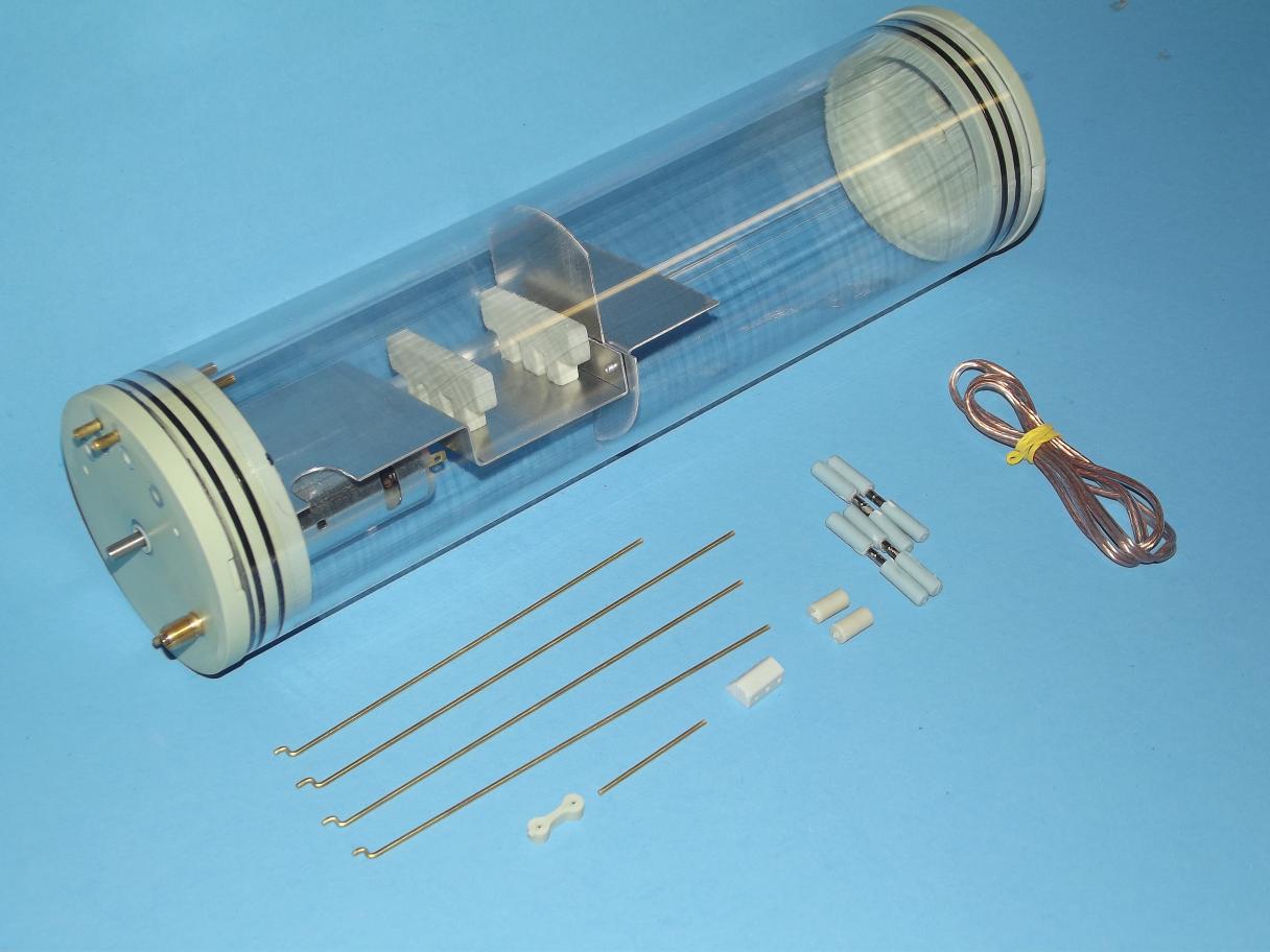

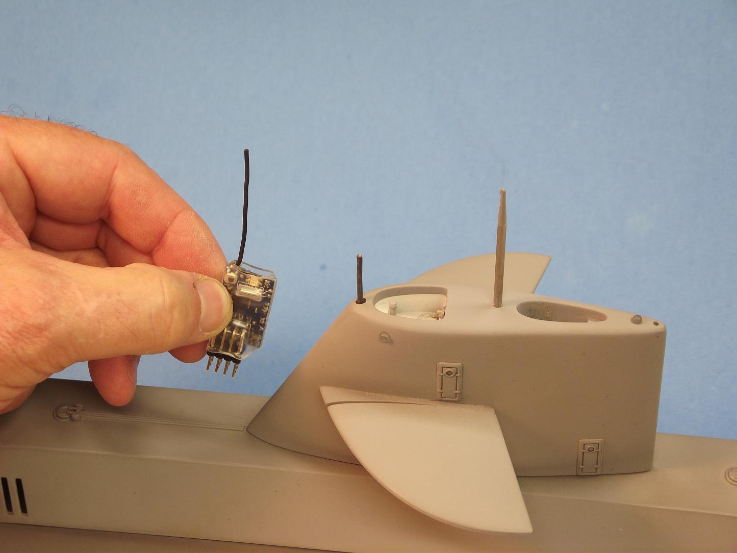

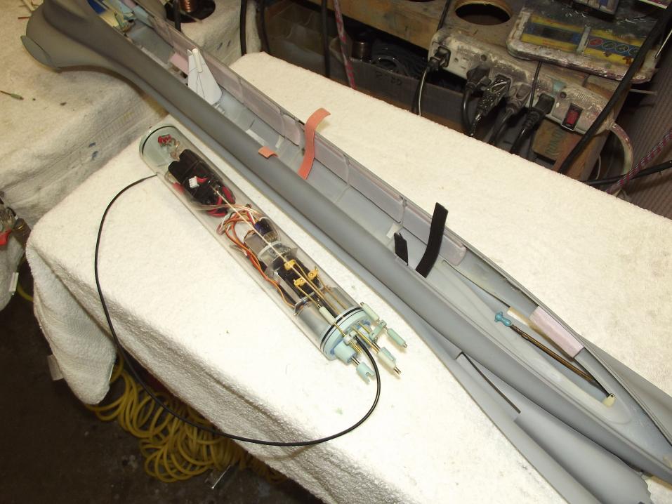

ID:	92734 (Shown here is the 2.5" Easy SubDriver, I don't have any shots of the 3.5" version yet) When using the 2.4gHz r/c system you will be compelled to run a length of small gauge coaxial cable between the receiver and antenna mounted up in the sail. I use one of the periscopes as the antenna location -- way up high. Once the antenna dips under the water, all servos fail to their 'zero' positions and the positively buoyant boat slows and floats back up to the surface where the signal is re-acquired and you're back in business.

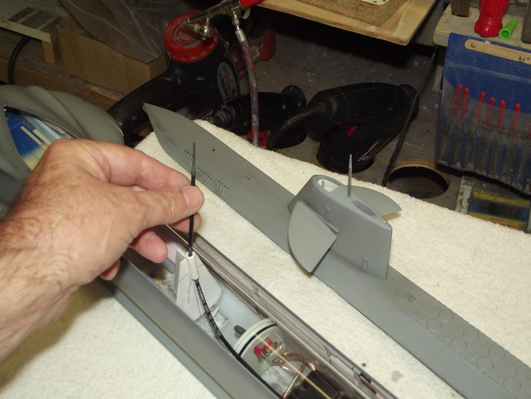

ID:	92735 Click image for larger version
ID:	92736 Click image for larger version
ID:	92737 Here's how to run the coax cable (with short 2.4gHz antenna atop) from the SD to the top of the sail. This example being the Moebius SEAVIEW kit.

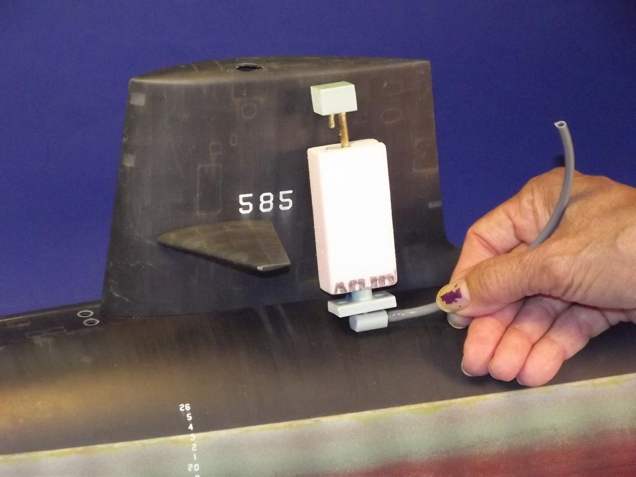

      Thanks for that Dave, do you know if it is possible to get the snort fitting for the SAS system on its own so that when i build the Sail all the internals will be complete for the later addition of the SAS type sub driver
        • 14010
ID:	92738 Click image for larger version
ID:	92739 Click image for larger version
ID:	92740Click image for larger version
ID:	92741 Click image for larger version
ID:	92742 Click image for larger version
ID:	92743Click image for larger version
ID:	92744 Click image for larger version
ID:	92745 Click image for larger version
ID:	92746 Click image for larger version

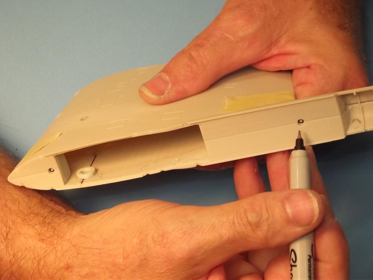

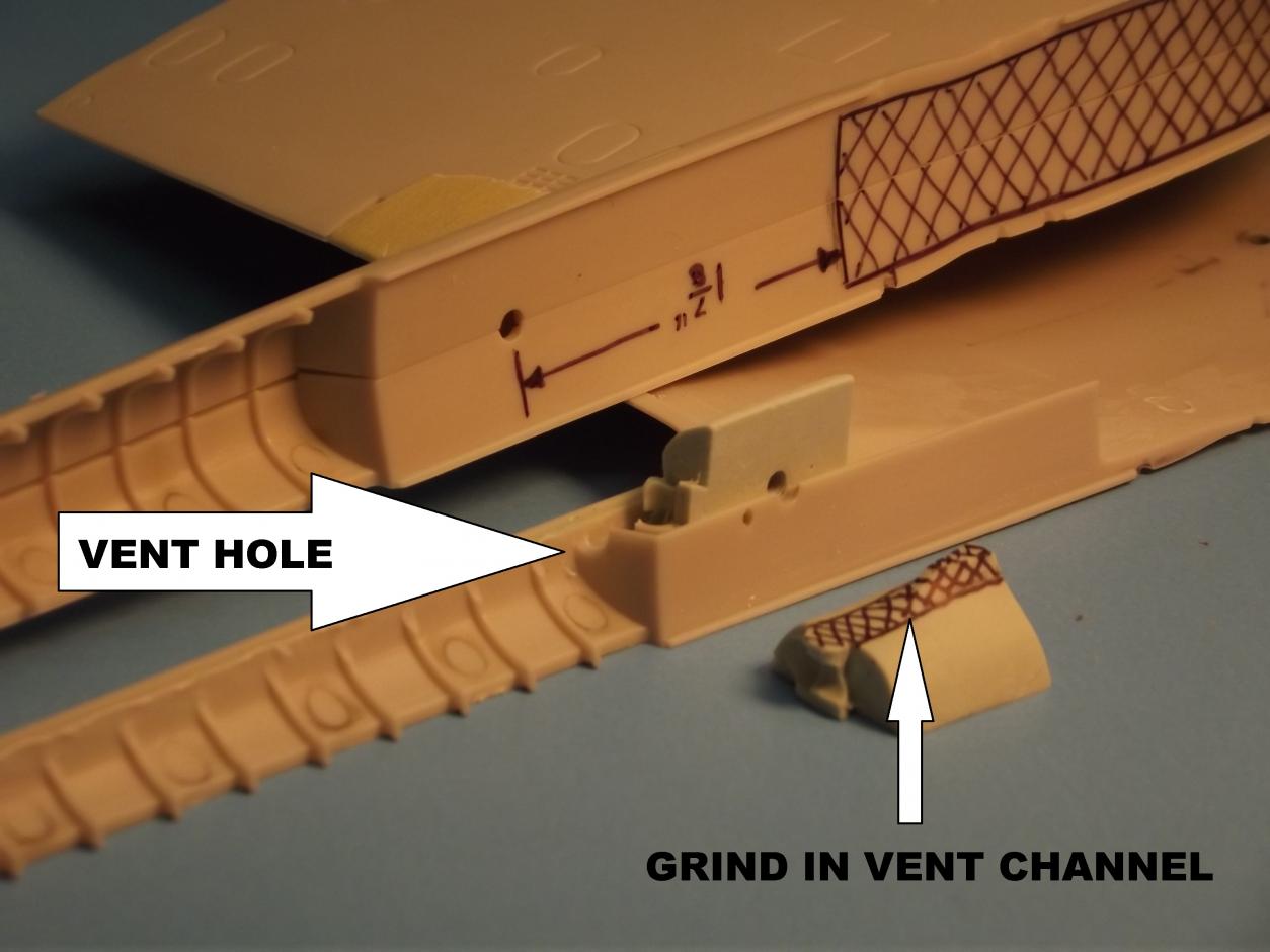

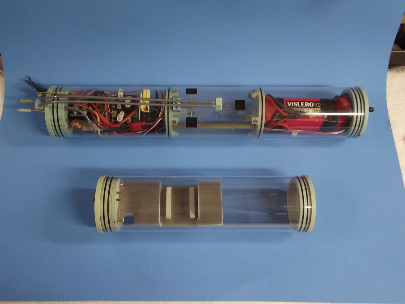

ID:	92747 If you follow the SKIPJACK WIP (a dedicated thread published here) you'll see that the snorkel assembly mounts directly atop the hull, under the sail. Make the sail removable when you assemble this kit and you will have no problem retrofitting the assembly when you upgrade to a SAS type SubDriver.
        Glue the sail to the hull and you're screwed!

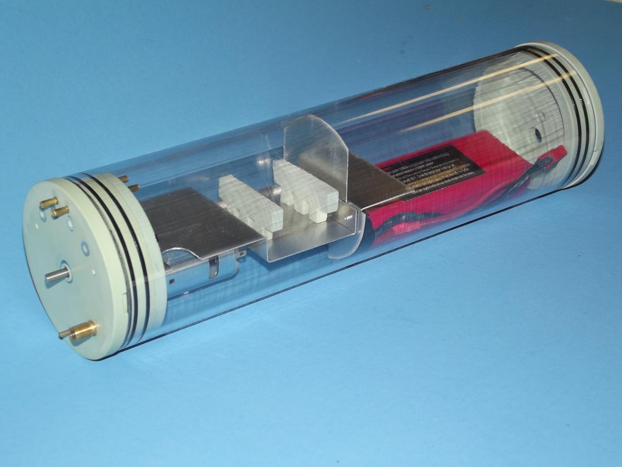

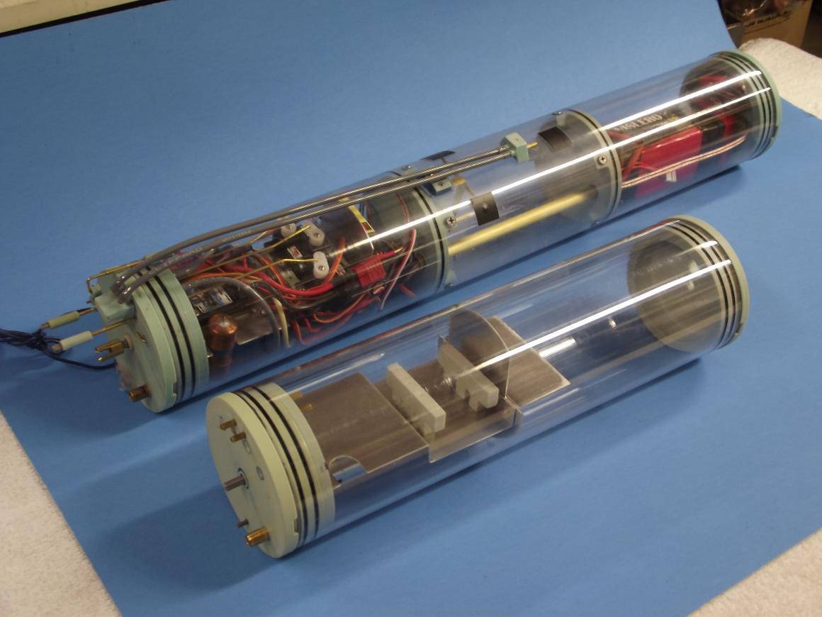

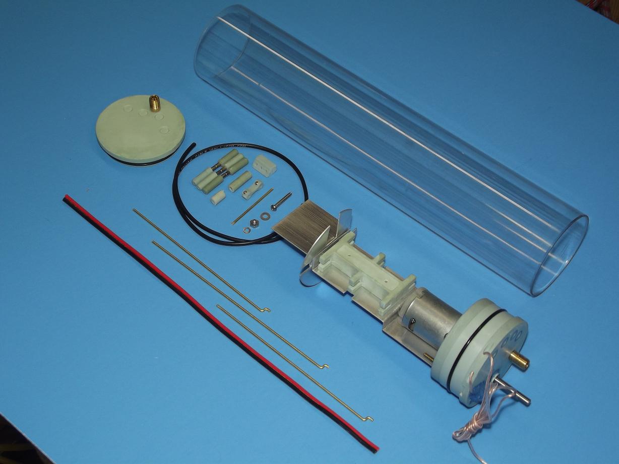

            No upgrade kit to convert the Easy SD to an SAS SD. Two different animals. As illustrated below:

                Let's try that again:
ID:	92748 Click image for larger version
ID:	92749 Click image for larger version
ID:	92750 Click image for larger version

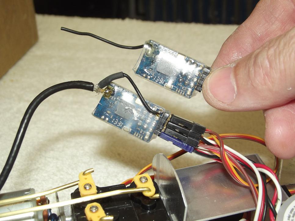

                      just a quick question about an earlier thread re the antennae for 2.4g system in one of the photos showing the coax cable at the receiver what is the shield wire connected to on the receiver , sorry I'm not very up with this

                        You want to keep the shield-to-negative(ground) run as short as possible (thank you, Andy and Kevin!). Trace the foil on your receiver and find the closest negative point to the antenna pad you can find and make up the shield to that.

ID:	93085 I did it the dumb-ass way on Mike's SEAVIEW (hey! ... it ain't my boat, who cares!). Note the long lead from coax cable shield to receiver ground. Bad hockey! Should have kept that leg short by finding a pad closer to the antenna pad. But, damned thing still works, but likely the range is shorter than it could be -- a big deal to flyers, not so big a deal to we submarine drivers.
