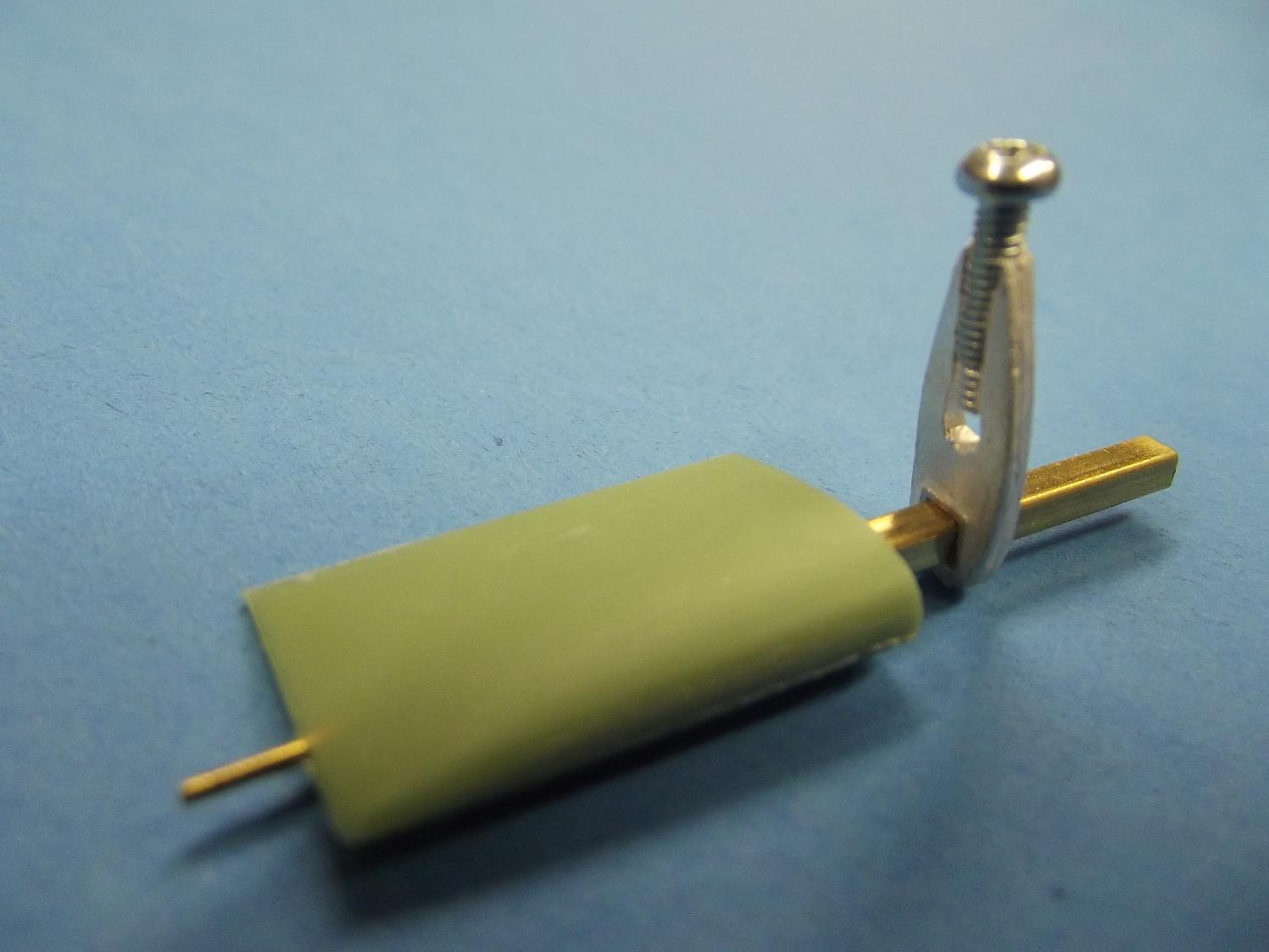

      2 on the new VII fittings kit I bought 2 of the stern planes now have a square hole they used to be round..is there a modified way too get the center of travel for the stern planes? as I see it with the white metal stern plane and brass square bar set at center of travel you would have 15 degrees rise???? im at a loss and feel stupid help the dumb one out....

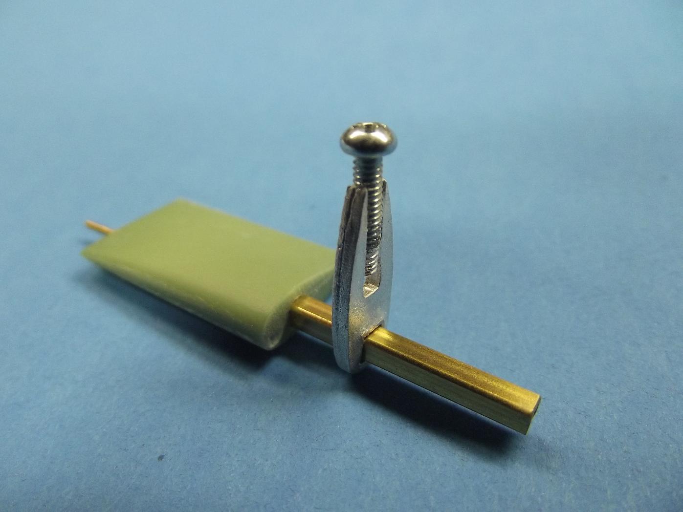

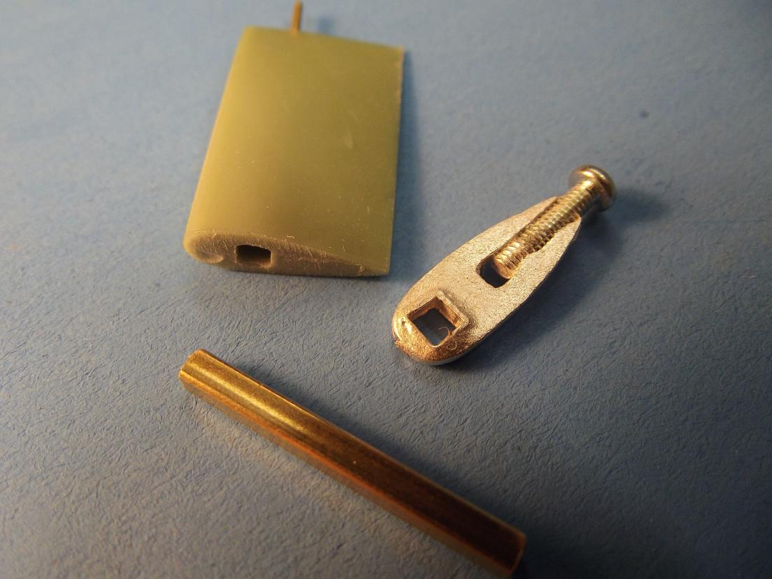

          OK, just grabbed some production parts -- what's this 15-degrees you're talking about?
          However, if you got a set of planes with the square holes oriented wrong, bore them to a round with a 7/64" bit and jam the square section operating shaft in there so that the bell-crank sits 90-degrees to the cord line.

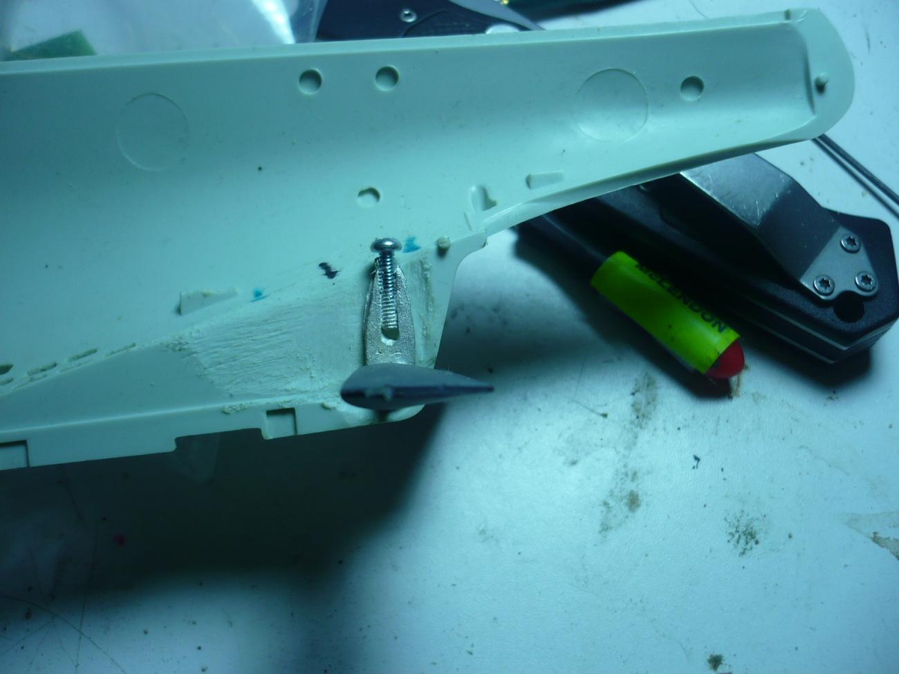

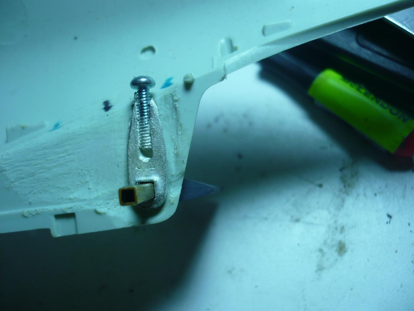

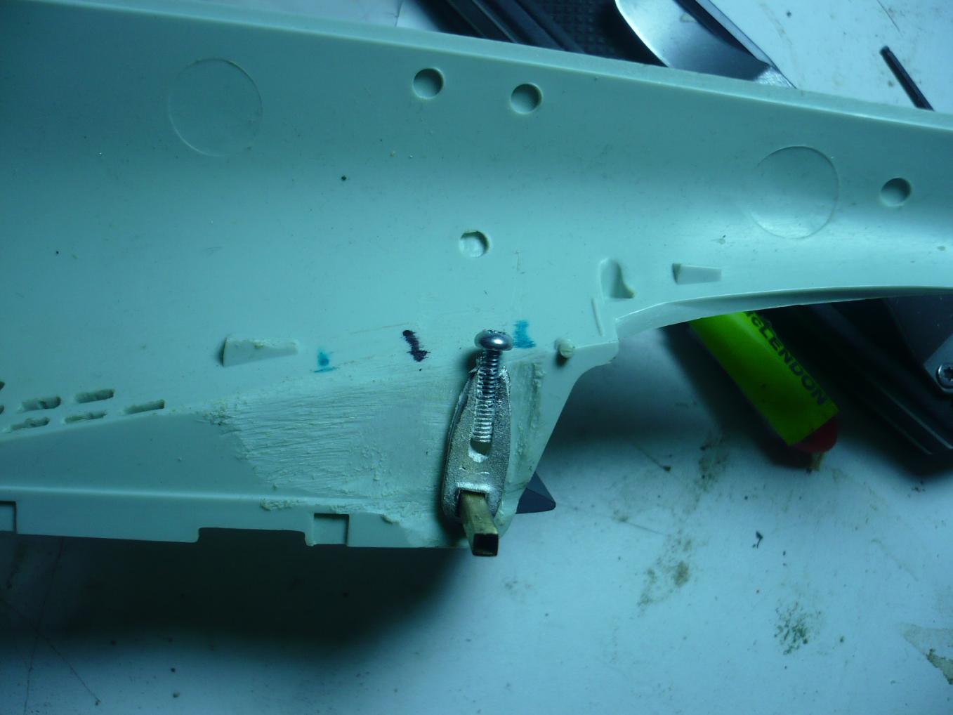

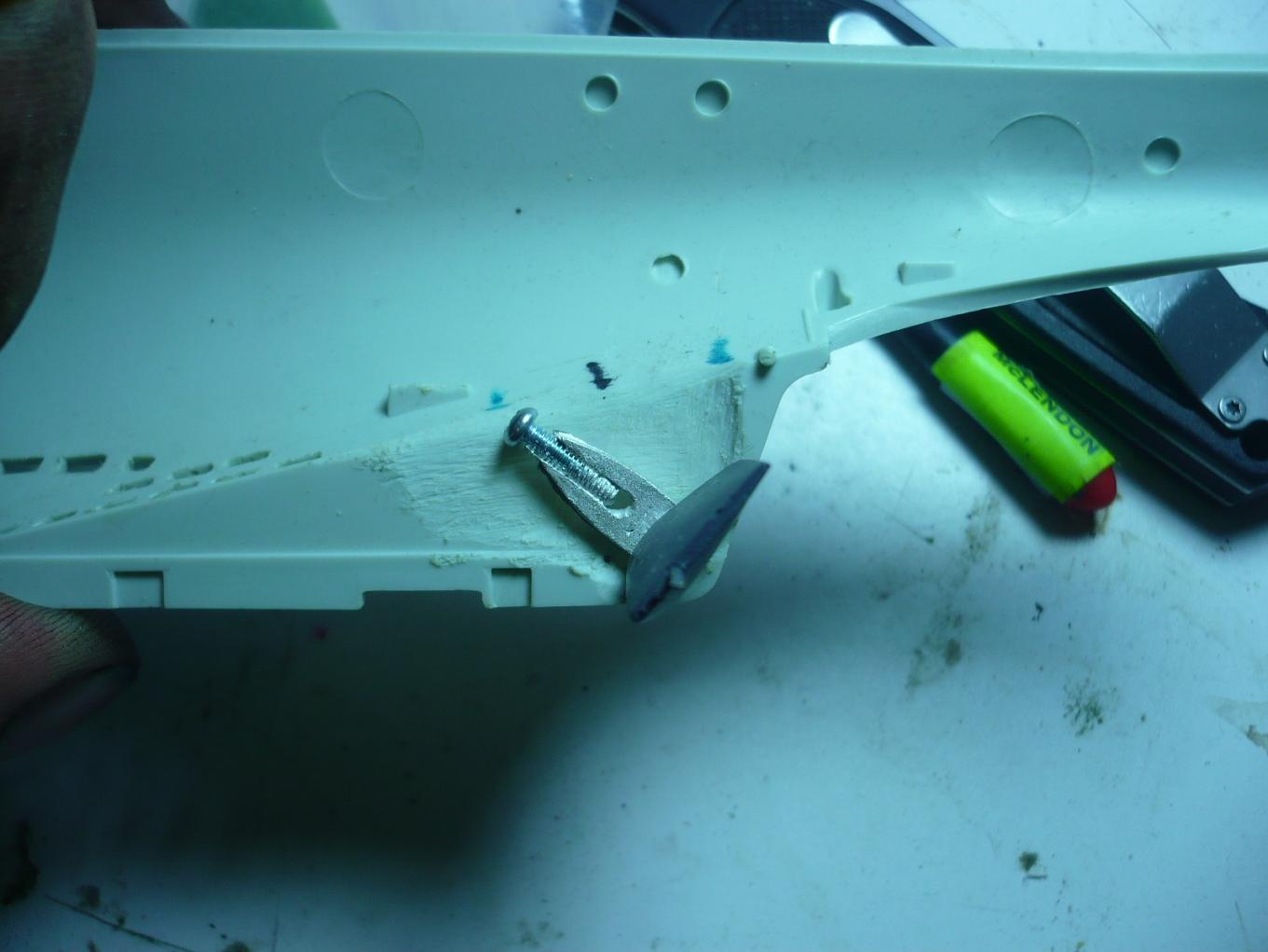

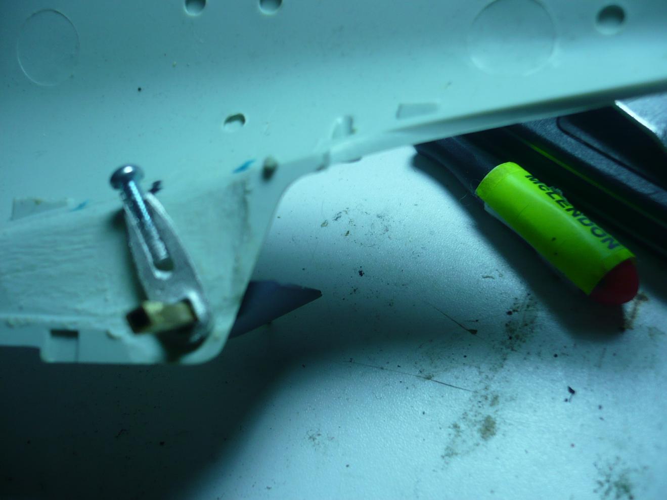

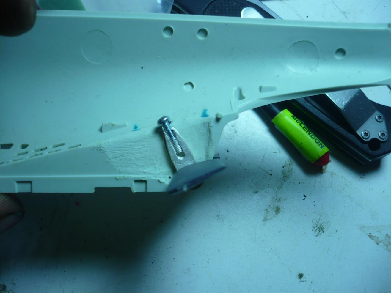

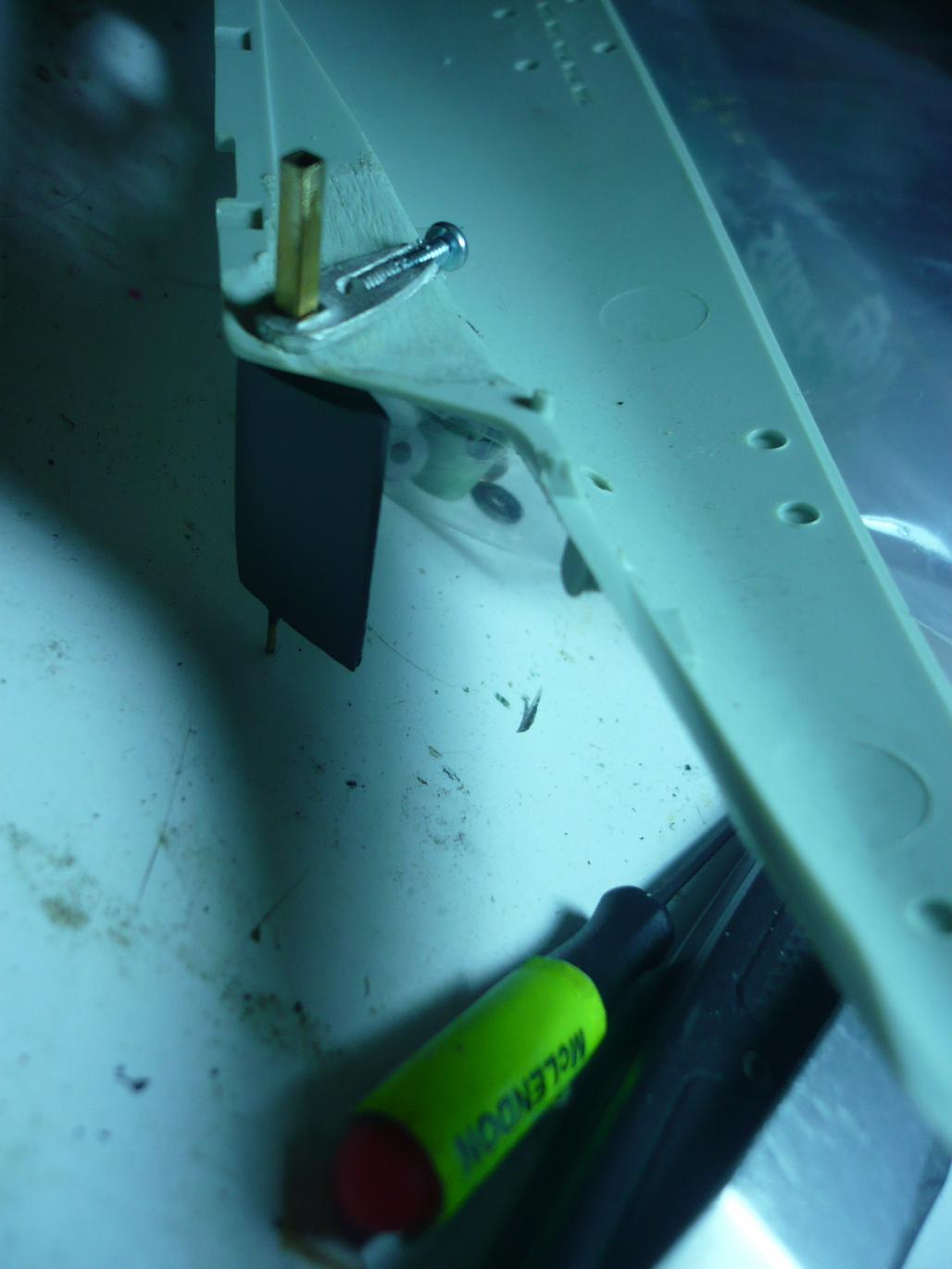

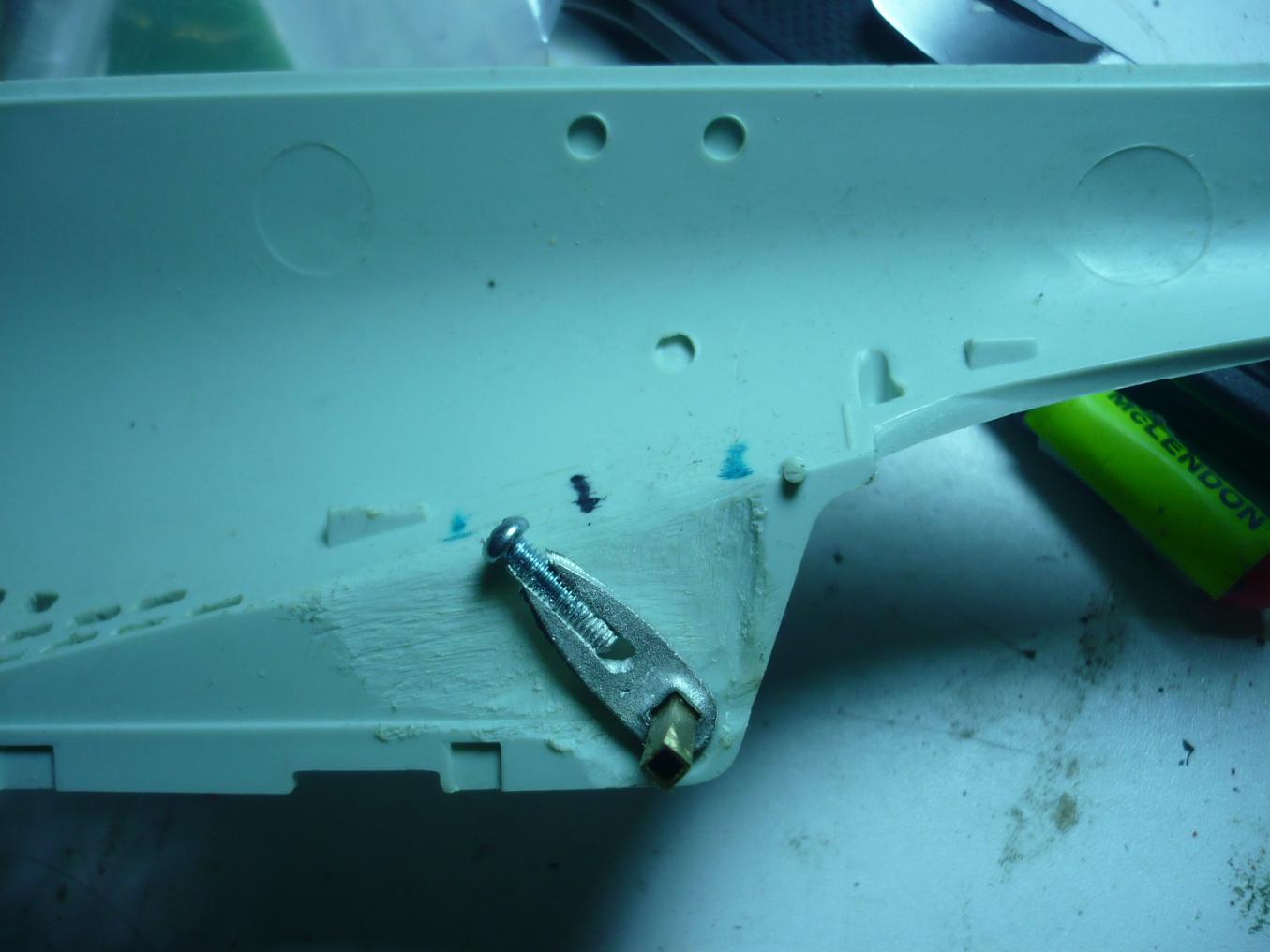

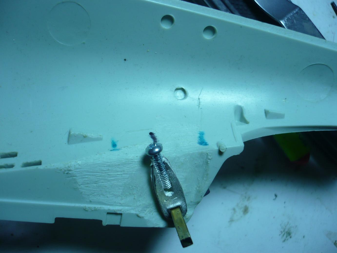

            ok when I ground out the keel area..i set a mid and end points...so at mid travel my square brass tube is not flat it is standing like a dimond shape and the planes are level if I go full rearward throw then the trailing edge of the plane is down and the square tube is flat side down so maby I set it up wrong..i followed the revel fittings kit pics as best possible..but I hae no issues with making the holes round I just wondered if there was a production change and if the fittings insalation had changed. any..

              so hopefuly this clears up what I mean about the 15 degrees when the square tube is level ..what have I done wrong? or is this right???

                First off, very good job with the photo-essay. Cleared up what's going up very quickly.
                Secondly: You idiot!
                Your datum line in not the hull-skeg interface line (upon who's edge you've put your pen marks denoting bell-crank travel). It's the boats longitudinal centerline! Plane angle is referrenced off the boats longitudinal center line.
                You people!!!
                OK, here's what you do: keep carving away plastic from the skeg, all the way to the trailing edge of the skeg, so you can get more 'dive' out of the planes. All you need is 20-degrees of dive, and 20-degrees of rise -- gotta live with the fact that this mechanism will give you no more than that in the dive direction. But, it's enough.

                  uhh this is what I ment in my e-mail..****** jim im a hybrid trans tech not a navy engineer/master craftsman..can you slow it down enough for dumb people....if I intertperate what you said right I need to grind more back for more rearward throw correct..????will have to live with what I got on my learner hull..but there is time to correct this one....pics would be nice if you have any....the revel VII info lacks compared to say the gato???? story of my life I enjoy the underdog..it why I do hybrids

                        Yes, keep grinding aft of the bell-crank. You're almost there.
